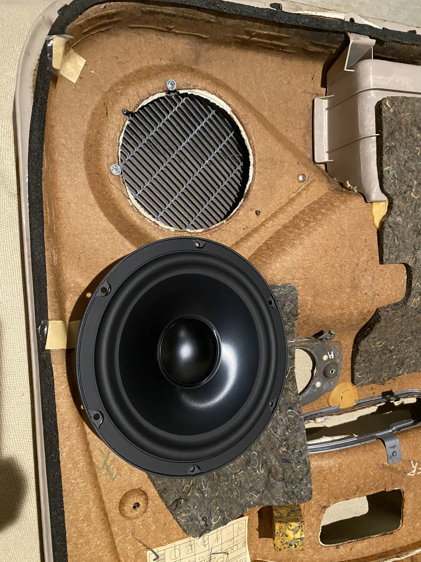

I have an extra door panel so I took a couple of pictures of how it might fit.
I never have much free time to wrench so I am waiting on supplies to be delivered before I start. I bought a bunch of different size spacers, gaskets and etc. to see what fits the best.

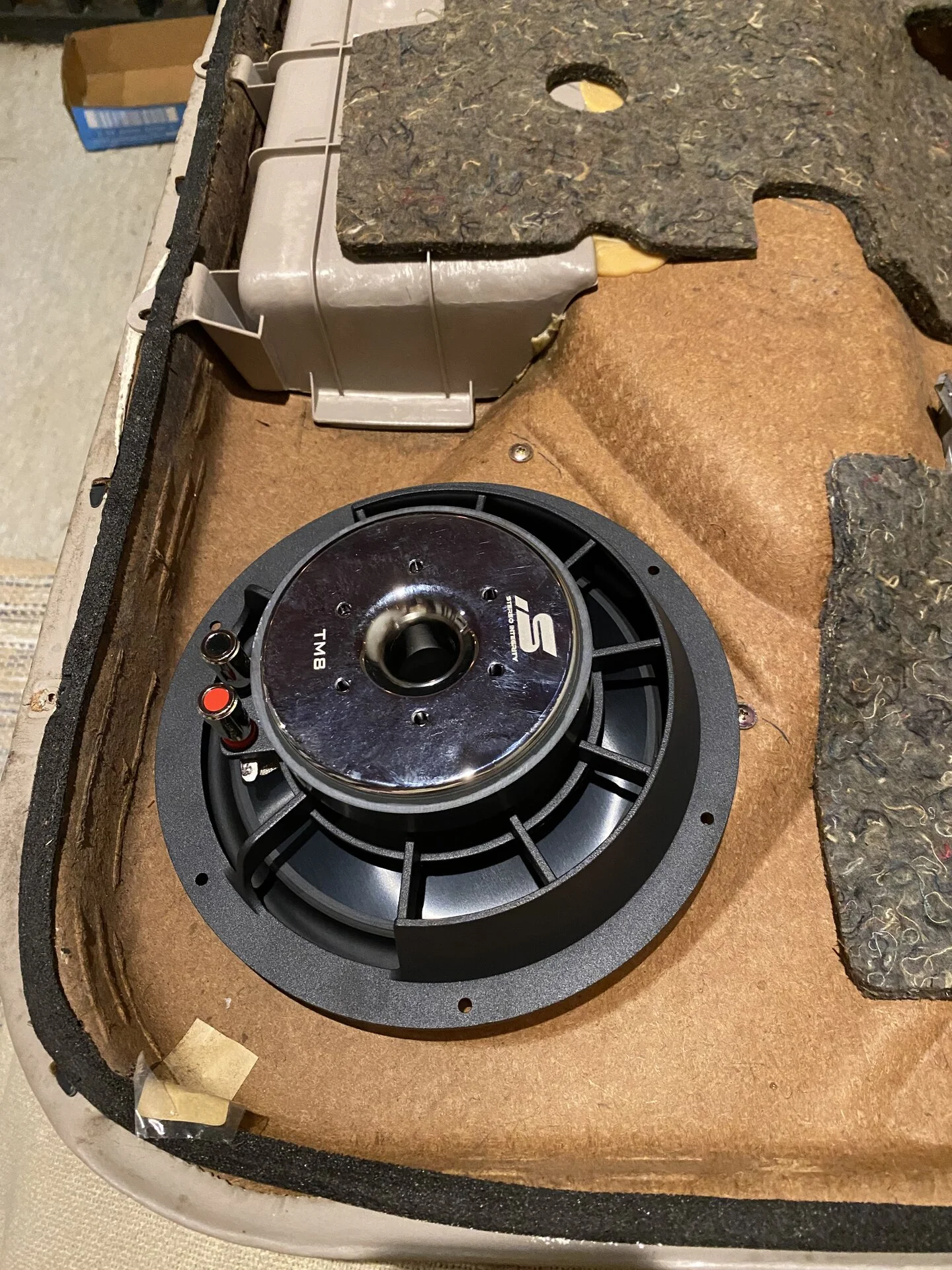

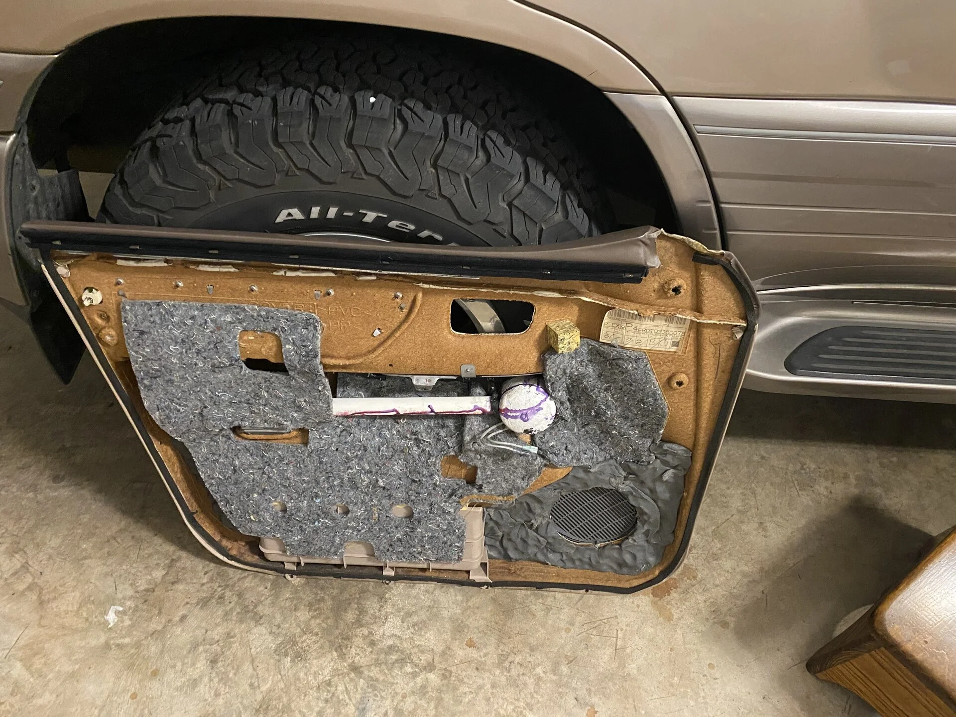

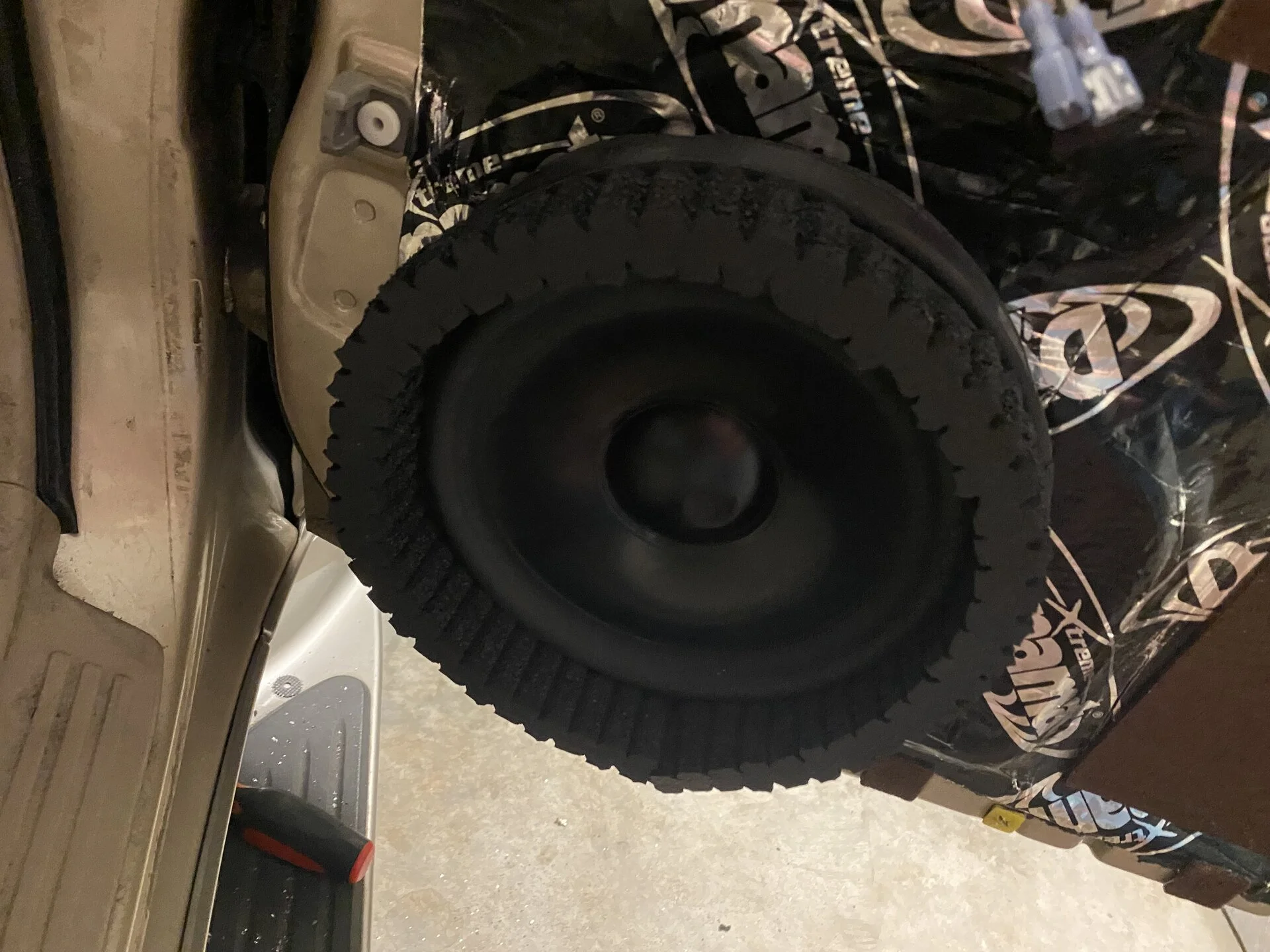

Passenger side is done but, I was frustrated & didn’t get many pictures. Hopefully I will have a chance to do the driver’s side tomorrow.

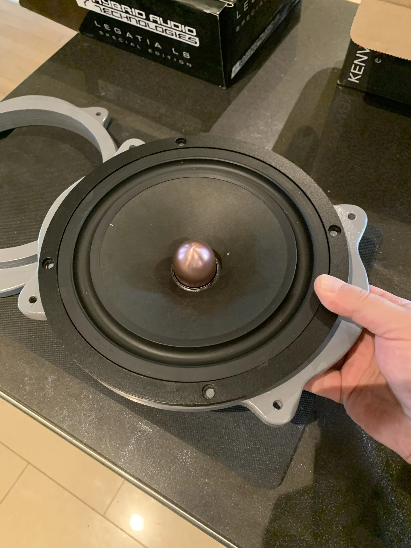

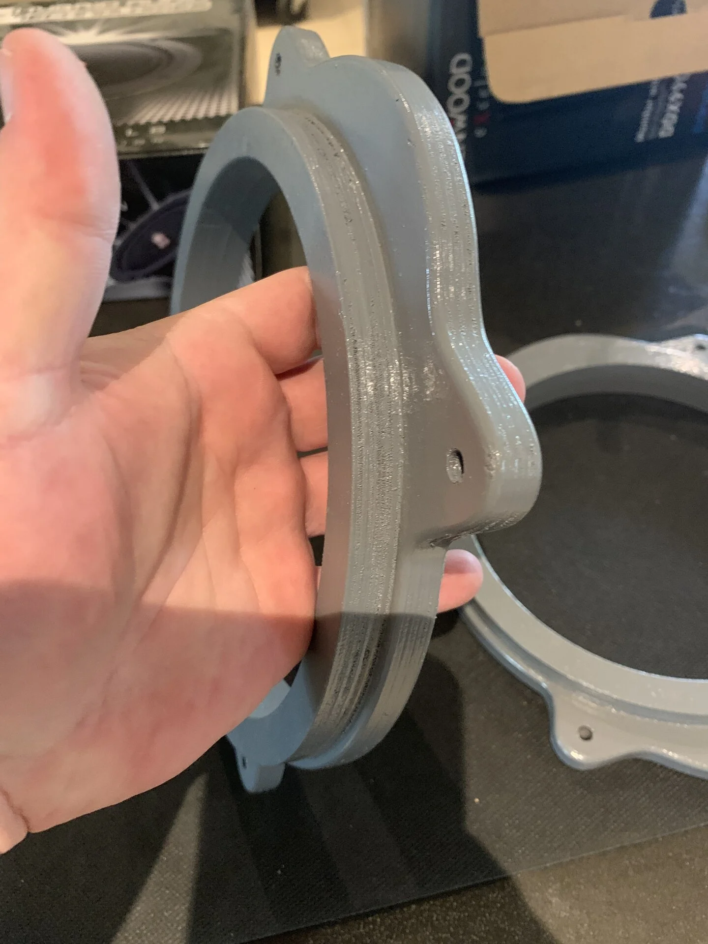

These are the birch spacer/adapters that I had made for my 07 Tacoma front doors. Mr. Marv on TacomaWorld made them for me and I’m hoping they can be modified to help install the HAT 8’s in the front door.
I am almost finished with my driver’s door now. I am taking a break before I put the door card back on.
In my opinion, if they are much thicker than 3/4” you might run into clearance problems with the door card.
P.S. Before anyone says it, I was using 1” thick adapters with my 6.5” speakers but, the 8” might hit the door card quicker.

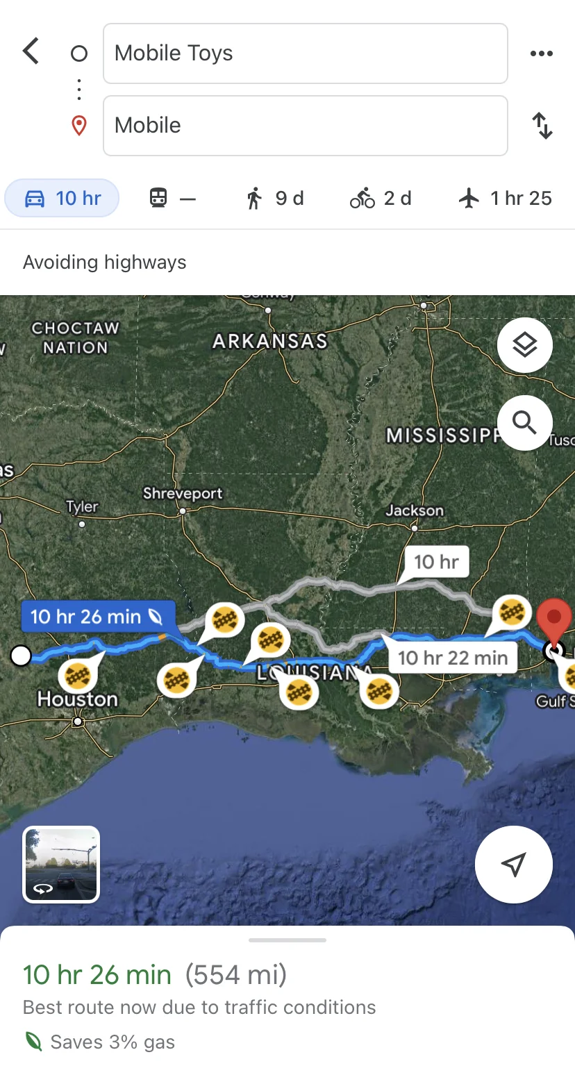

The easy answer, for me, is to take the LC and equipment down to Mobile Toys in College Station. Let them deal with it and I’ll just sell a kidney, or two.

Just to update this thread in case it helps someone in the future. I think I have solved my rattle problem by trimming the door card as much as possible but, still be able to get the 4 screws to fasten the factory OEM grill. By looking through the door card, you can see at least 90% of the speaker in the open grill area.
Then I used 10 pounds of Duct Seal per door card to add mass and to seal up any air leaks and cavities. Then I applied foam sheets that I purchased from ResoNix. It stays clear to louder than I can safely hear and I listen pretty loud!
