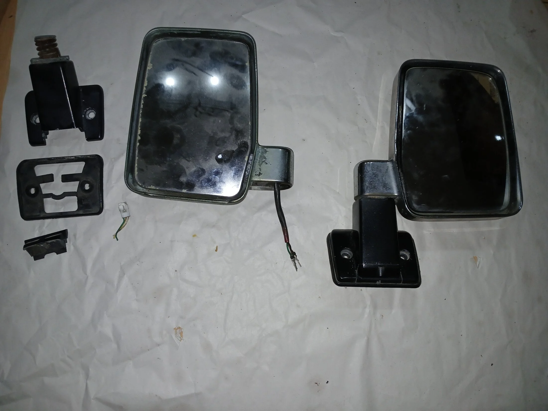

I've got one in pieces, I'll try and get pics later today, of the internal guts

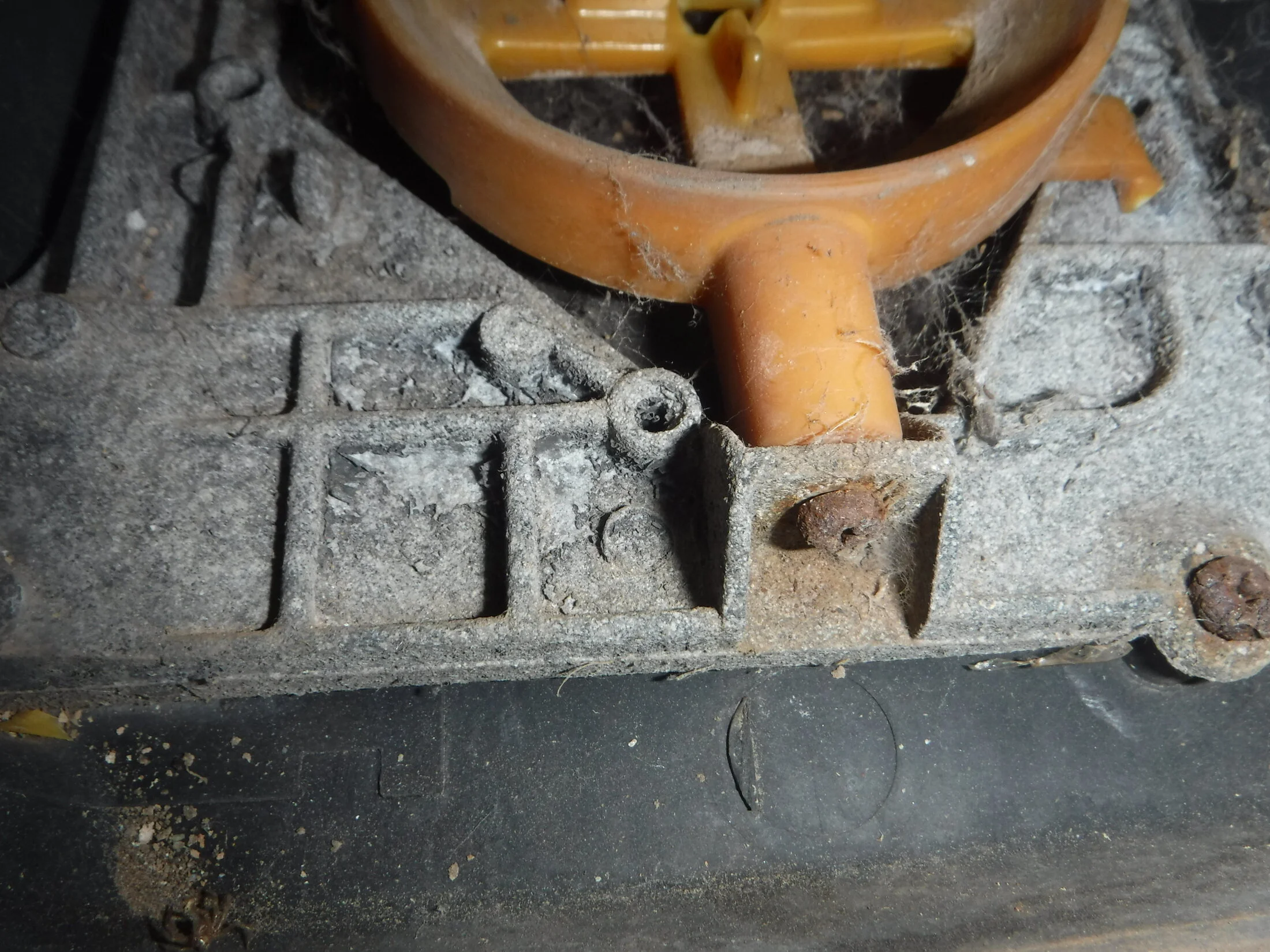

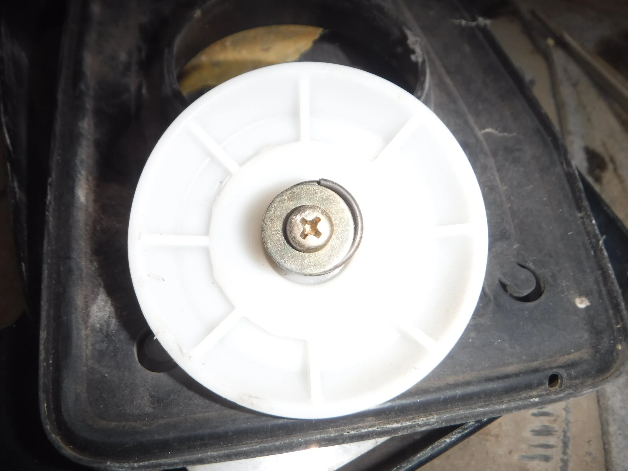

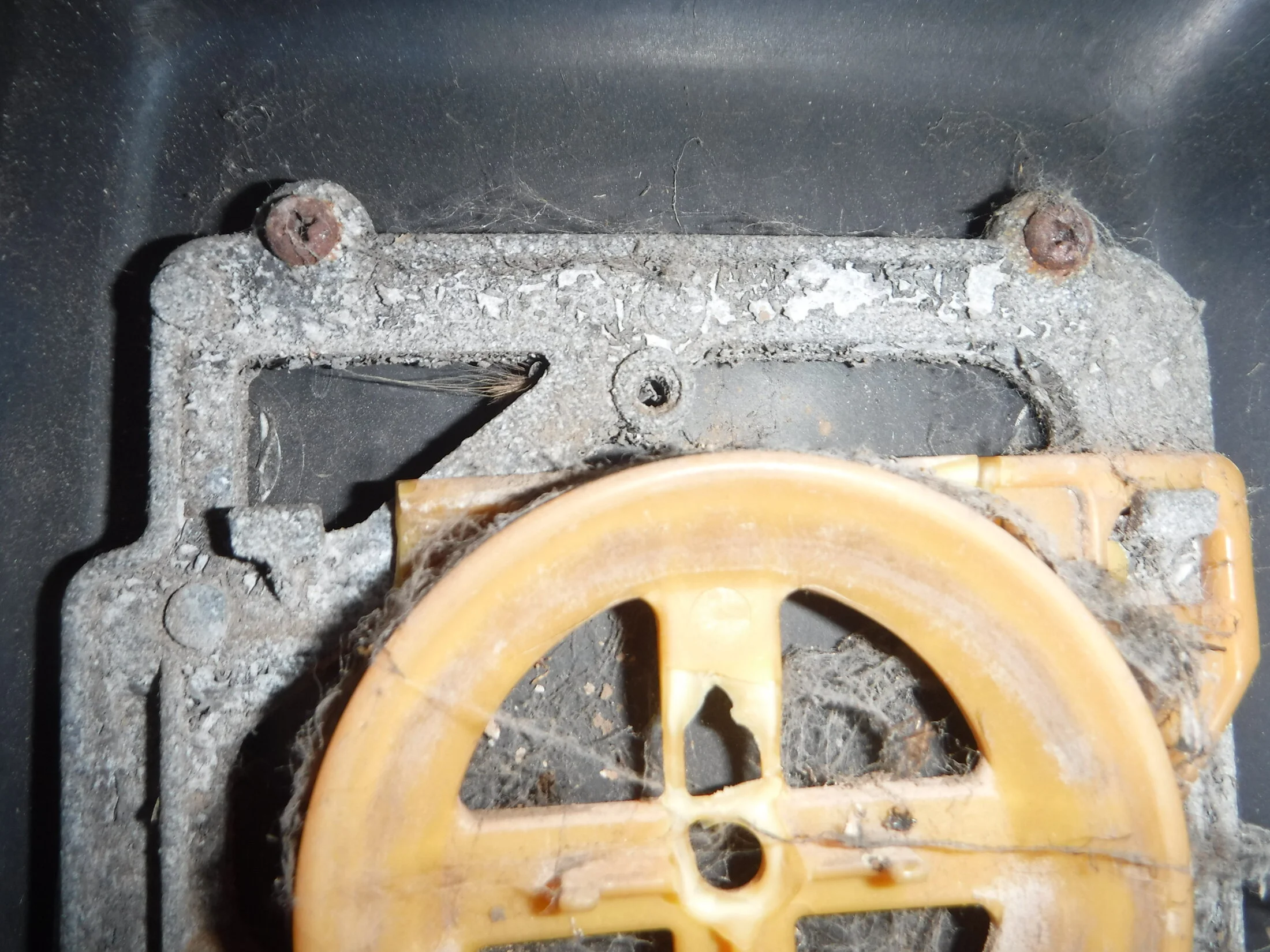

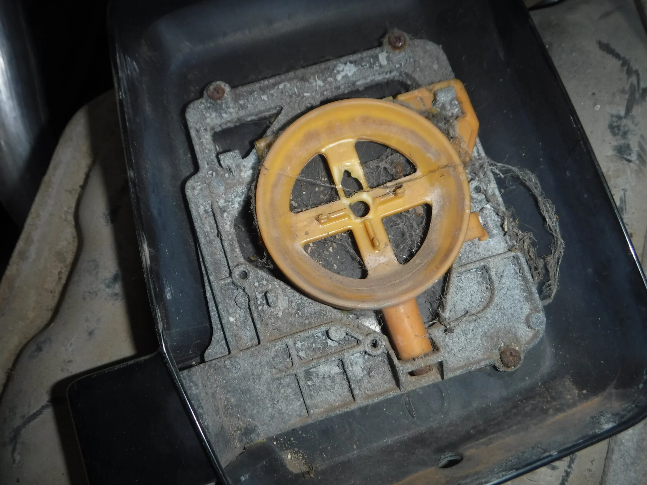

underneath the mirror housing is an access hole, unscrew the phillips head screw, then the mirror and bracketry with ball will slide up and out of the housing
there is no way I can see to remove the ball from the bracketry, as there is a screw holding the ball to the bracketry hidden under the mirror
Thank you very much! Clearly the mirror pad and the mounting mechanism are completely different on a motorised vs. manual mirror so my plan to swap my existing pads into new manual mirrors will not work.

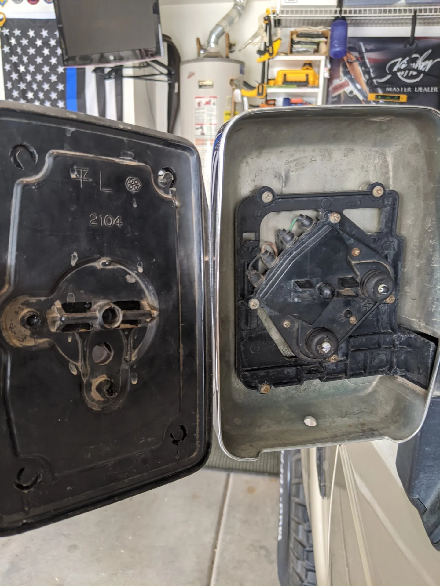

I found the following by @tonka az showing the insides of a motorised mirror:
Credit: tonka az FJ62 mirror disassembly? - https://forum.ih8mud.com/threads/fj62-mirror-disassembly.466012/post-13023314

the mounting assembly can be removed from the chrome piece by 3 or 4 screws
yes the mirror needs to be removed from the bracketry to gain access to the screw behind it
