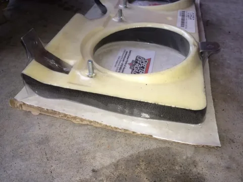

In light of recent 3D scanning and printing advancements, along with relatively economical (can't say with certainty yet) small production runs of injection molded plastics, has me thinking about reproduction of the many NLA interior parts, including the instrument panel, glovebox door, dash pad and interior door handles.

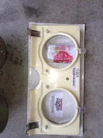

What promoted was the discovery and observations of SOR's repro gauge surround, which is hard plastic with the texture built into the mold.
It's very rigid with absolutely no give, looks like plastic, but could be good foundation for a vacuumed on thermo-vinyl, or even a stitched vinyl covering, similar to Shane's 80 covers.
Anyhow, I know nothing more about than what Google results, so seeing if anyone has any experience with the overall process, input on the demand for rigid plastic parts, ready to cover, paint, liner, whatever.
The gauge surround and the glovebox appear identical, short of the cutouts for gauges and recess for handle on the glovebox, so thinking the one I have could work for both, possibly doing both solid to allow for easy, clean aftermarket gauges to be used, without being confined to the OE gauge diameter (though there options that DO fit are very cool).

It's what SOR did to create these, but they were probably hand tooled and made in China for a fraction of what this may cost, since they, supposedly, receive semi loads at a time.
They claim the glovebox door is constructed the same way. I'd just buy it and get on with life, but without the upper and lower dash pad offering, looses it's luster.
You can see the back being plastic, eliminating the metal backing on the surround, and gauges attach directly to the studs.
If the glovebox door is a mirror image, without holes and with depression for handle, I'd think easy enough to modify a CAD drawing.
