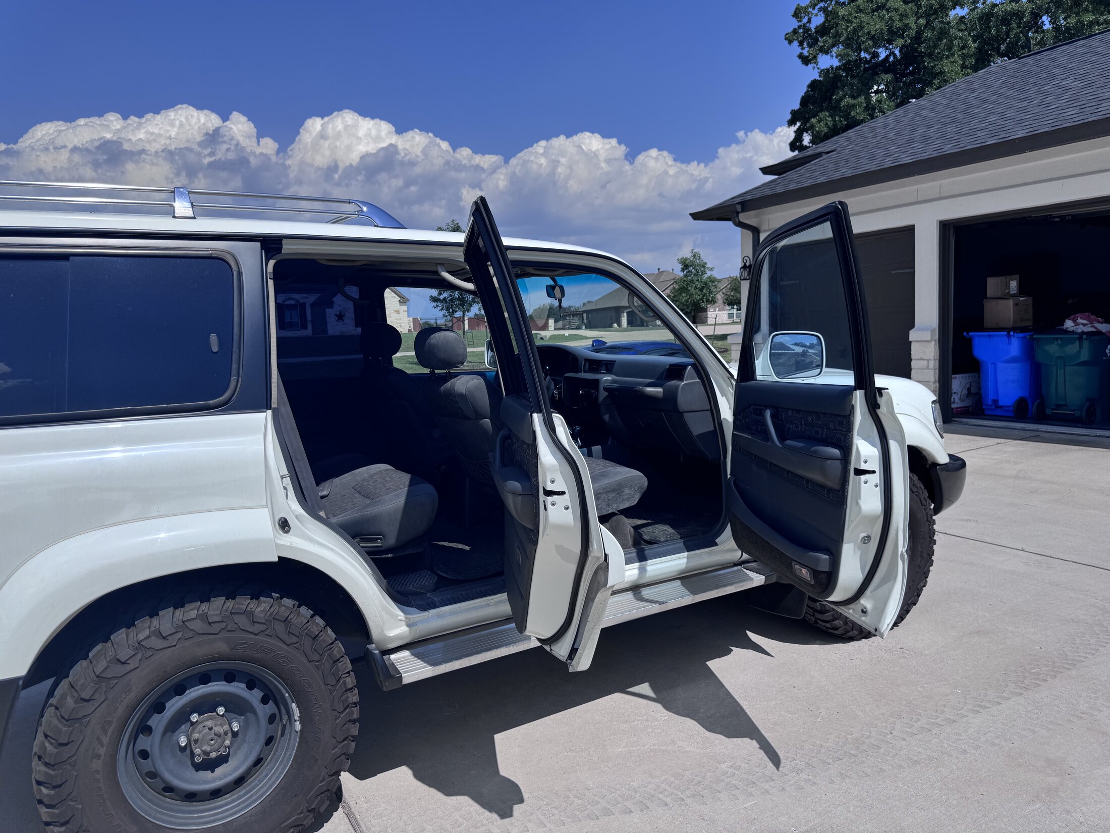

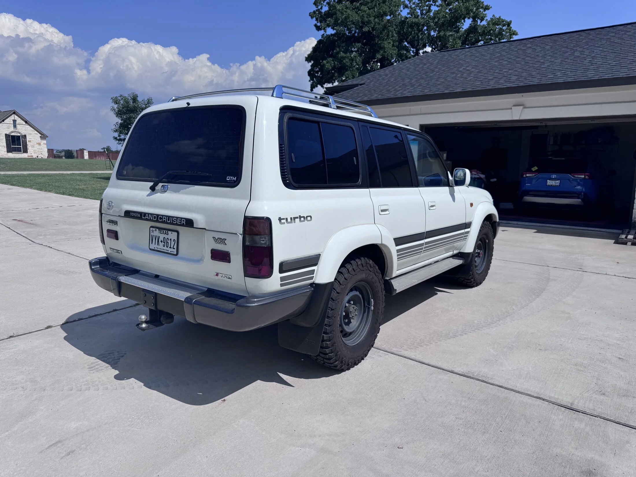

Feast your eye on this… my newly acquired 1996 HDJ80, with 5 speed manual transmission
This is my third, and hopefully final, Landcruiser
They say third time is the charm and this is essentially everything I wanted when I previously bought what I could afford at the time

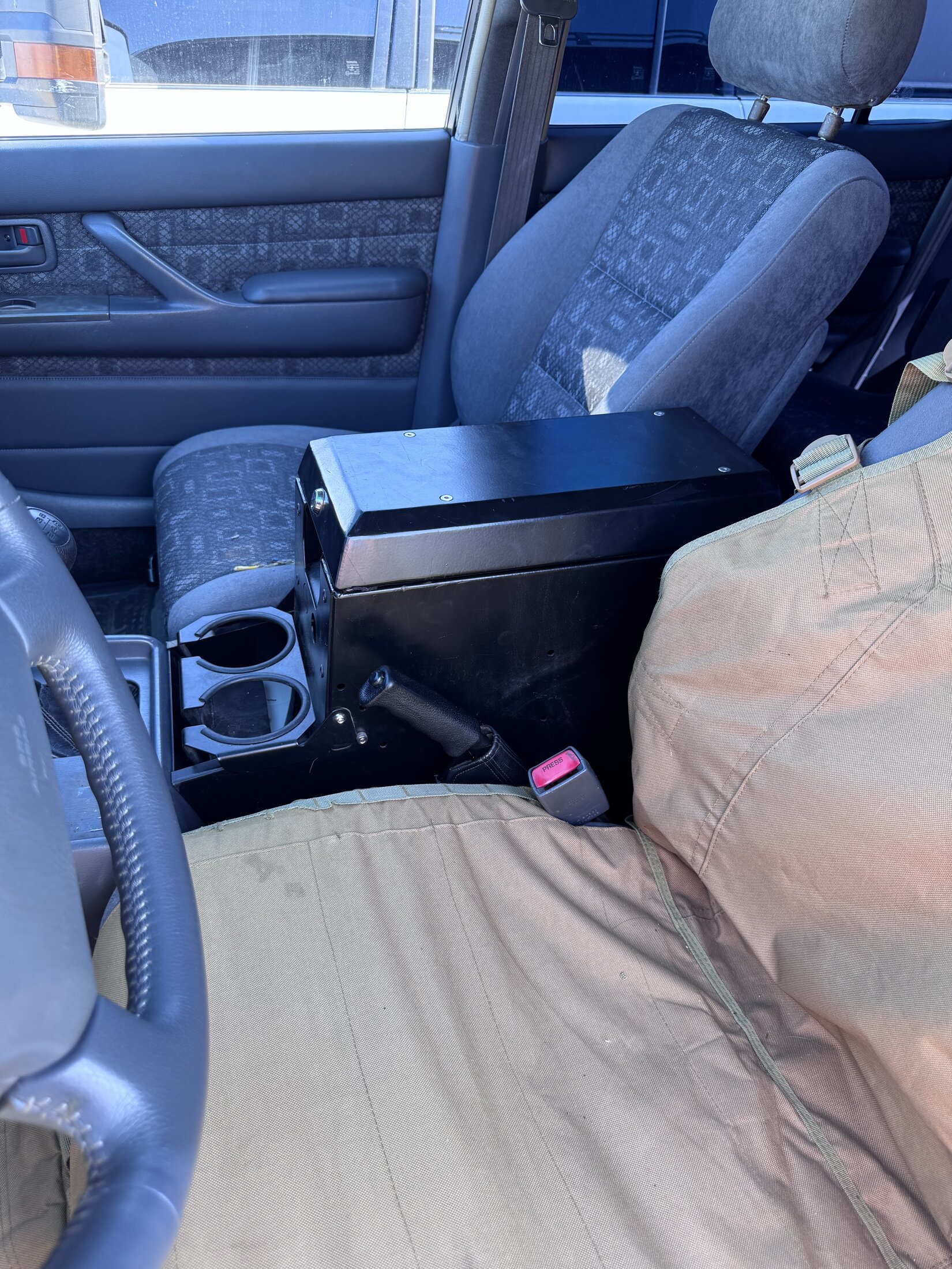

-Delta center console

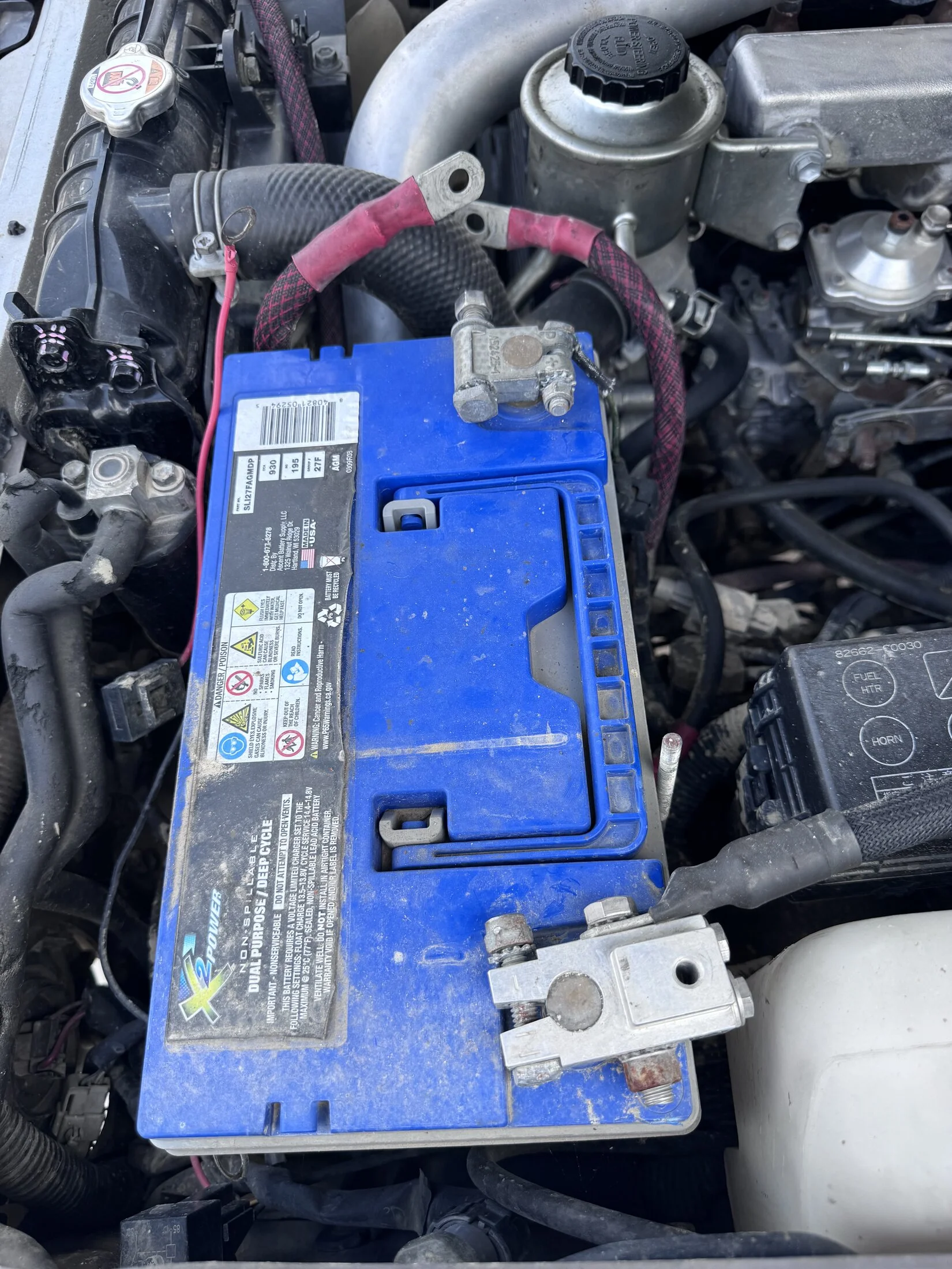

The wife and I agreed to 2 hour/day for each other to do whatever we want while the other watches the baby so I’ve decided to start tearing down the 81.

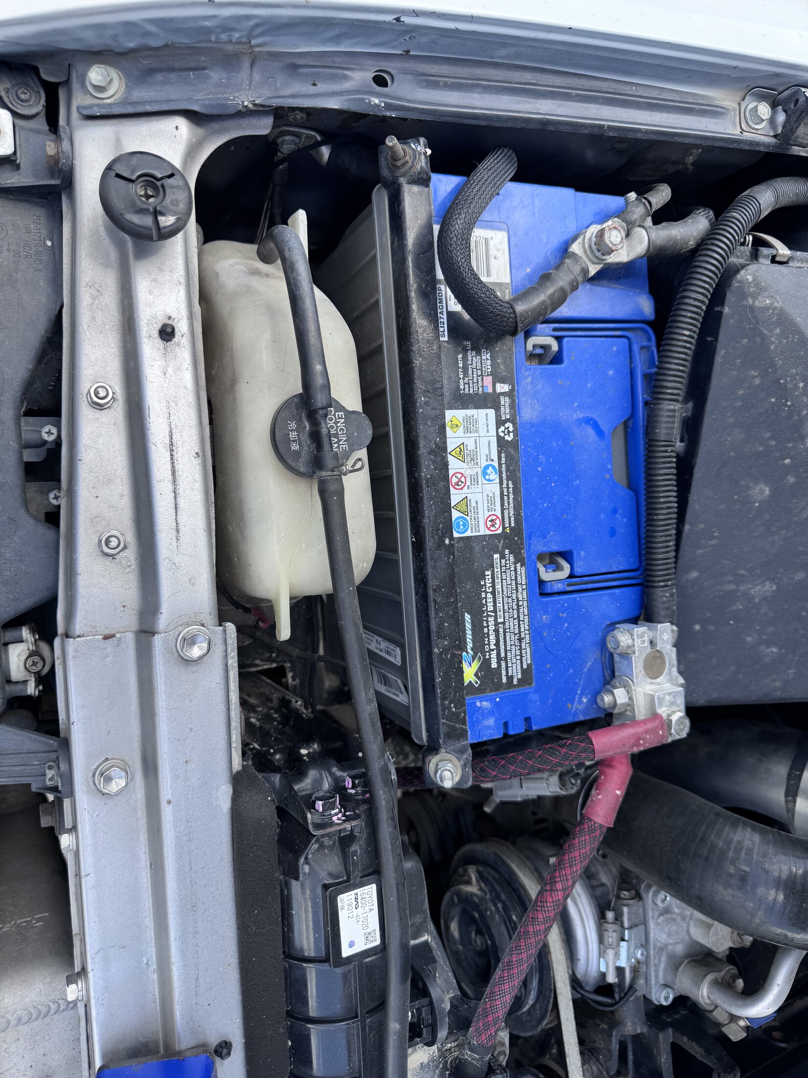

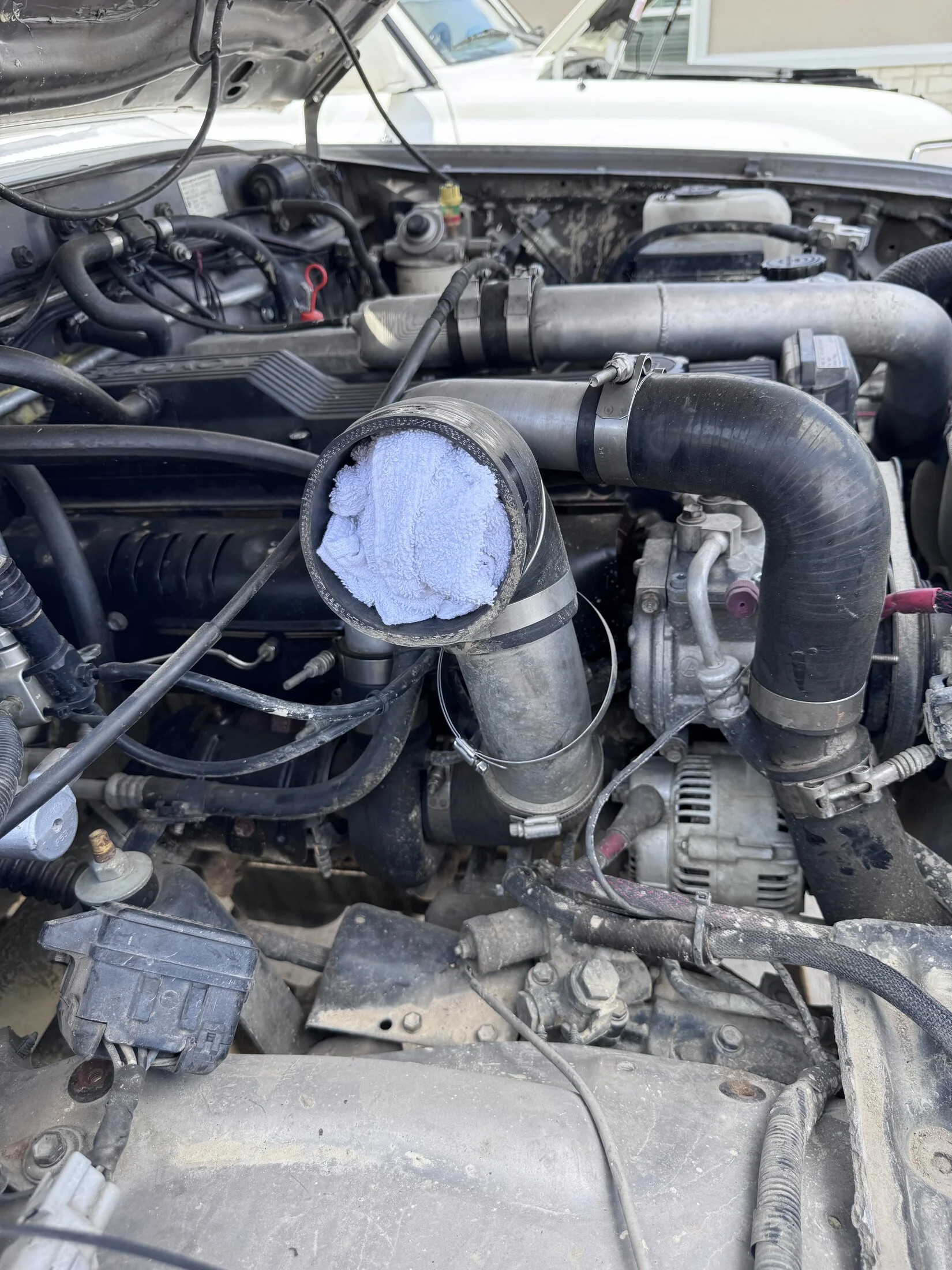

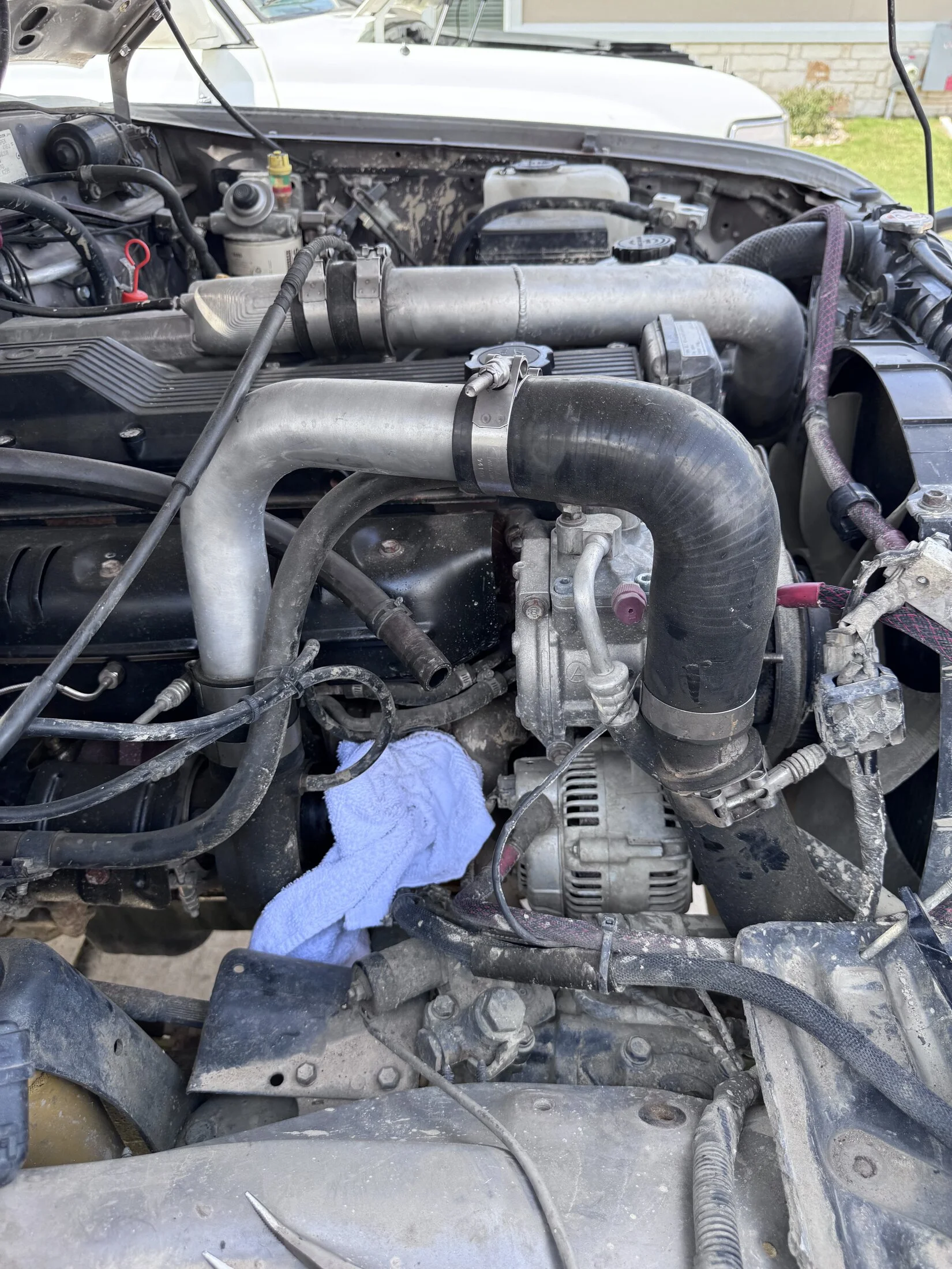

The intention is to pull everything off, clean it and paint it where necessary so I started with the batteries (12v converted system) and intake system
One note: Anything I take off the 80 is NOT for sale, I’ll be keeping everything in case the day comes I want to return it to stock condition

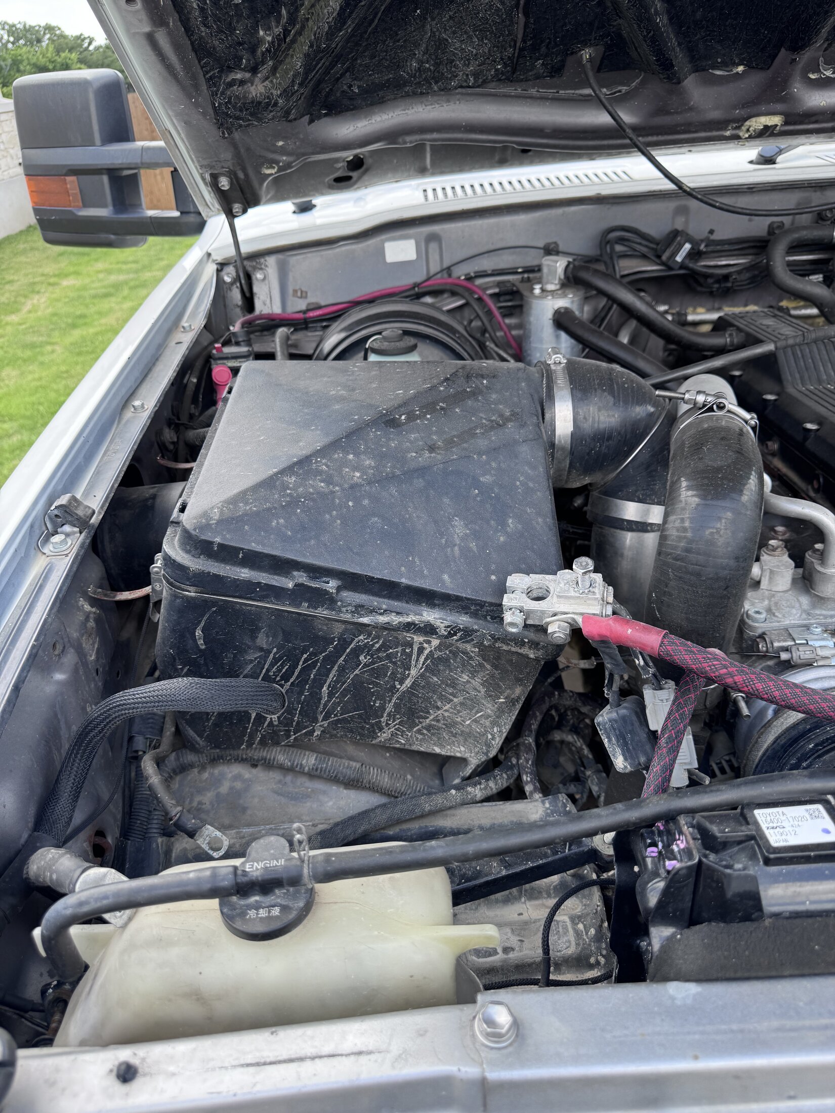

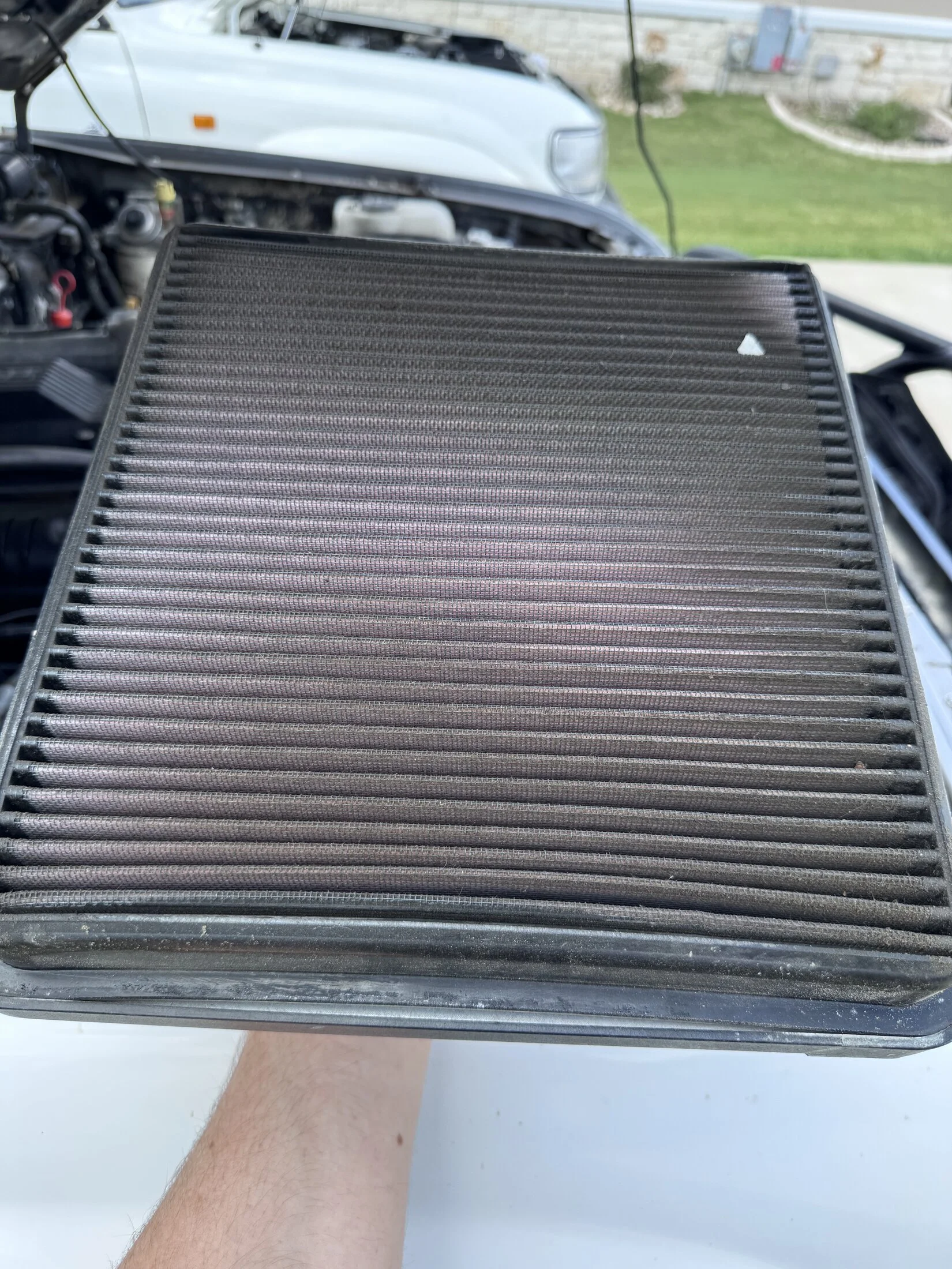

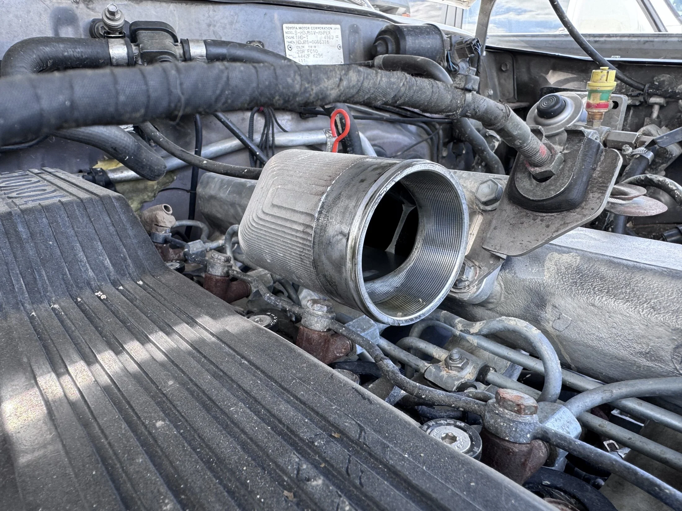

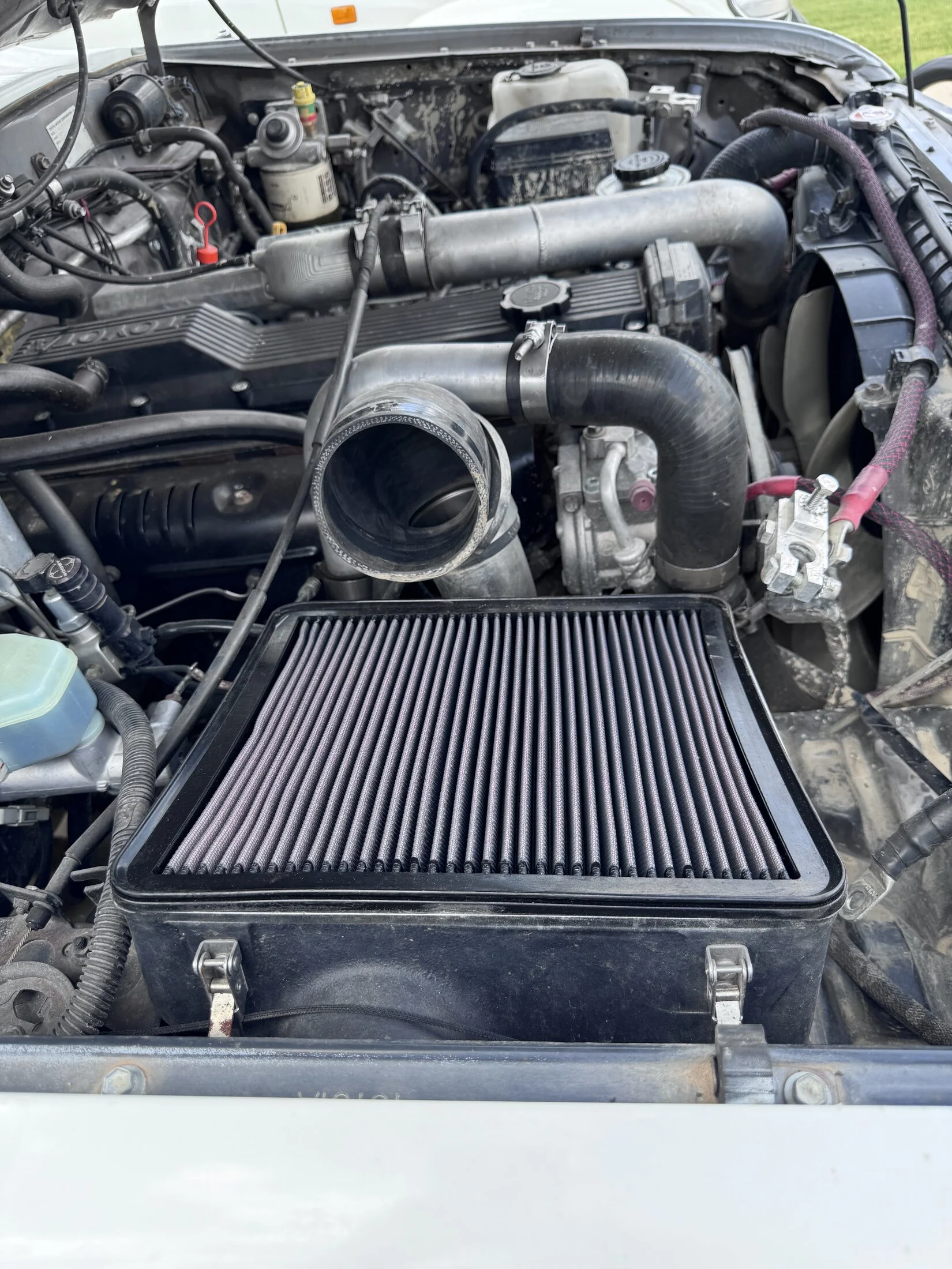

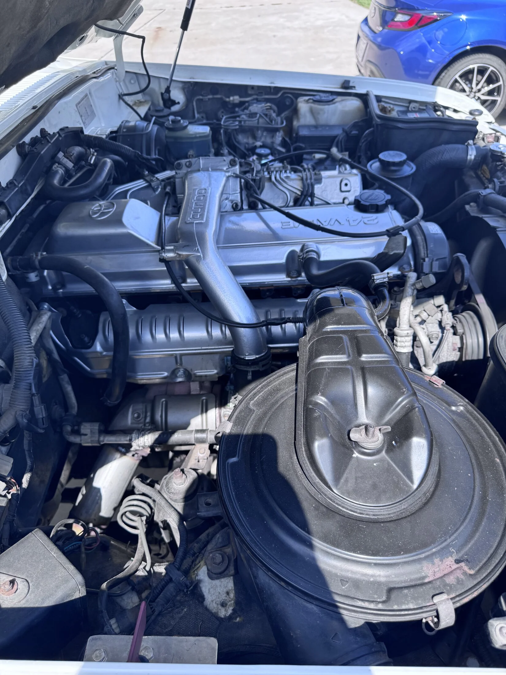

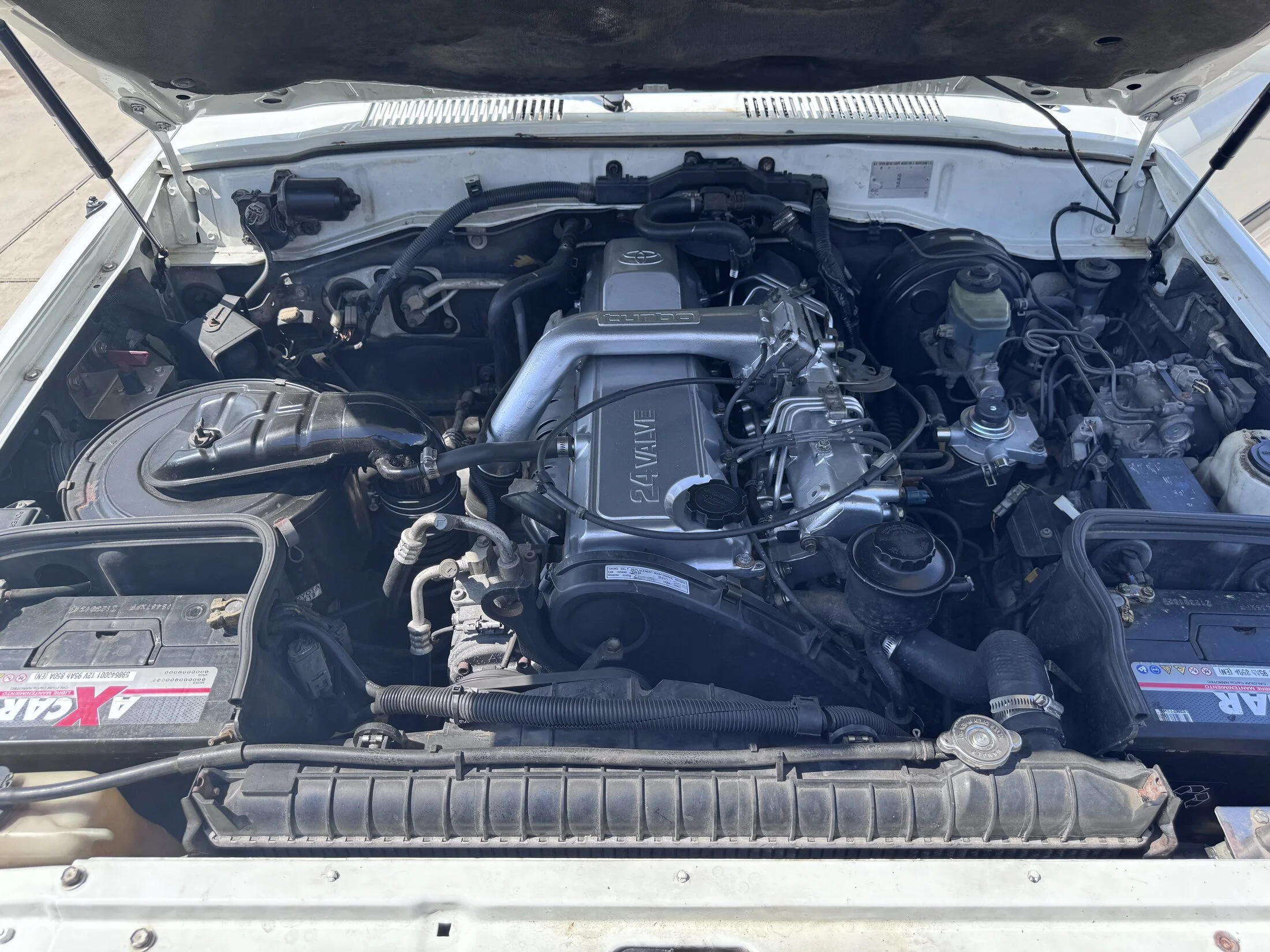

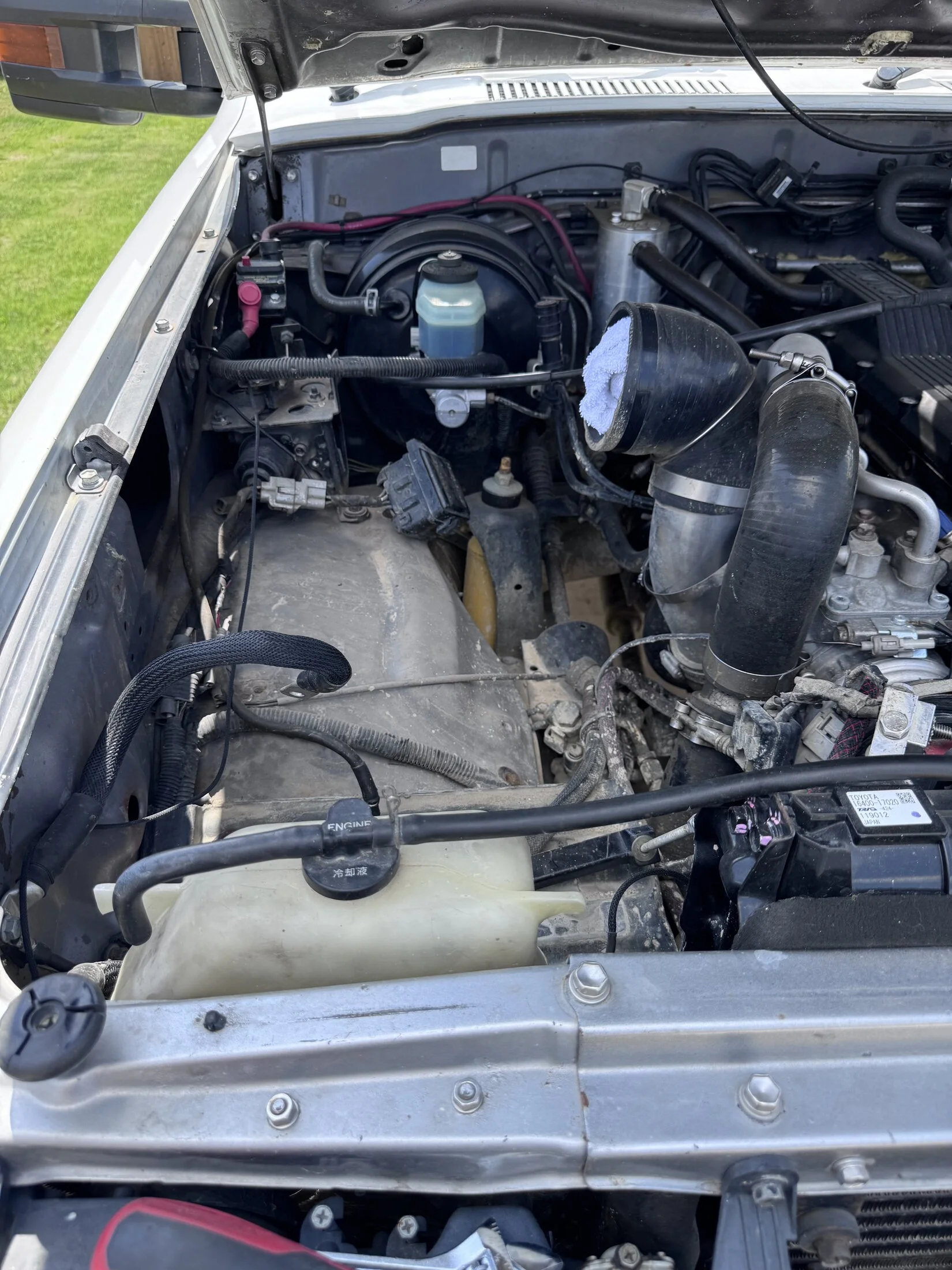

PDI air box allows the 200 series filter and a ton more breathing capacity… if everything looks dirty it’s because I took the ol girl out for one more adventure before decommissioning
I will be parting out everything I don’t use from the 81… of which there are a lot of goodies and good condition stock parts

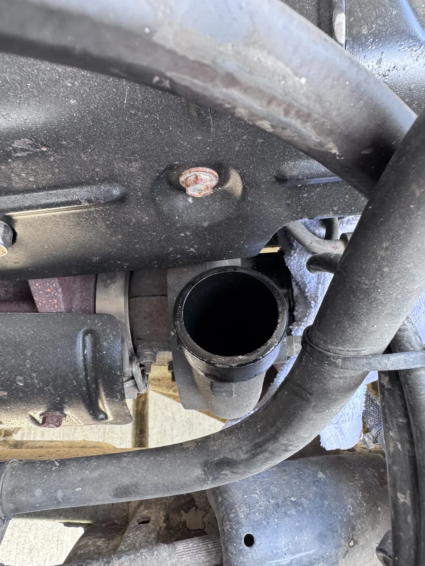

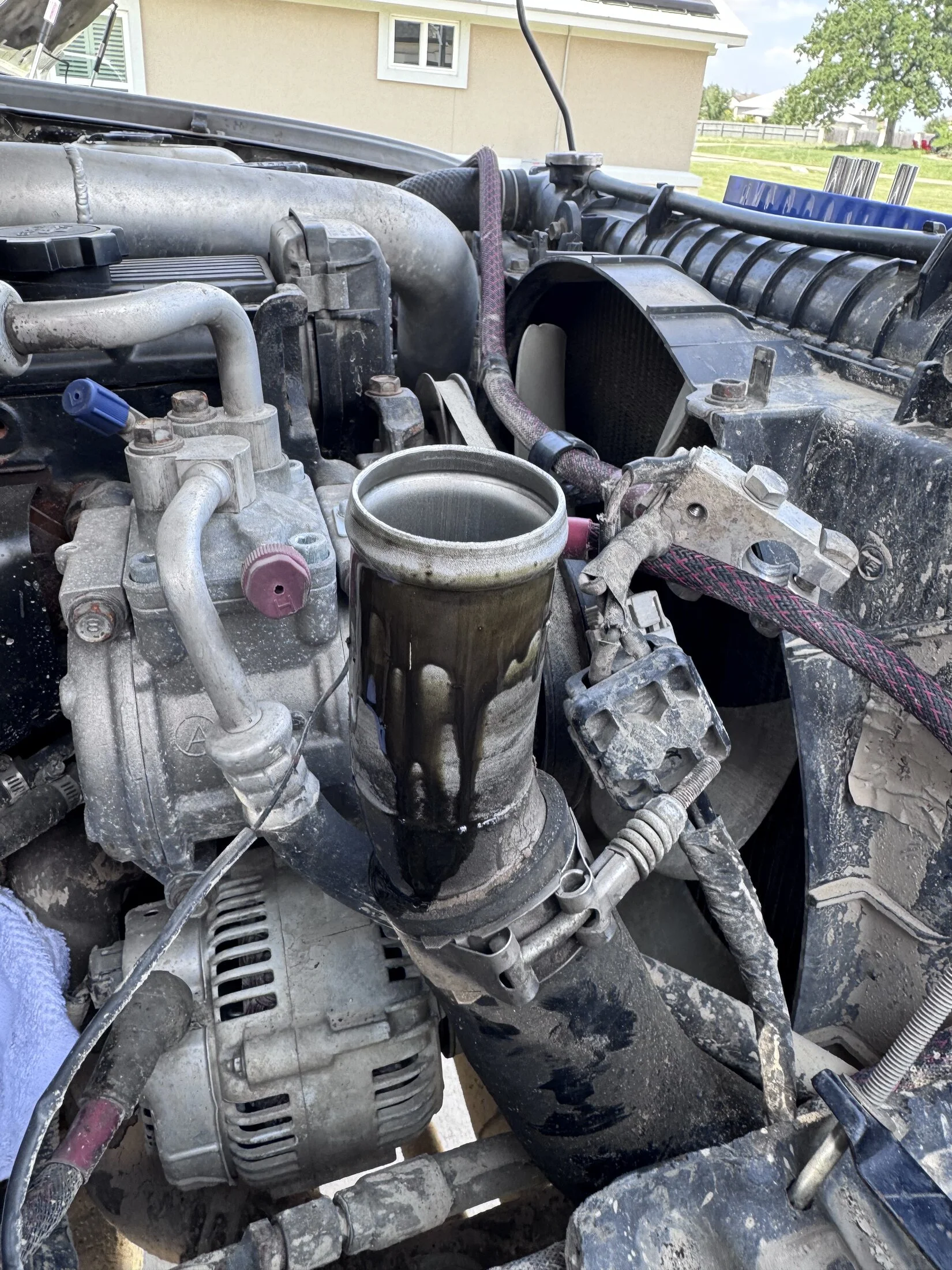

Taking off the cold air hoses, looks like I got a good amount of oil in there…. A little bit of neglect I suppose as the catch can was full

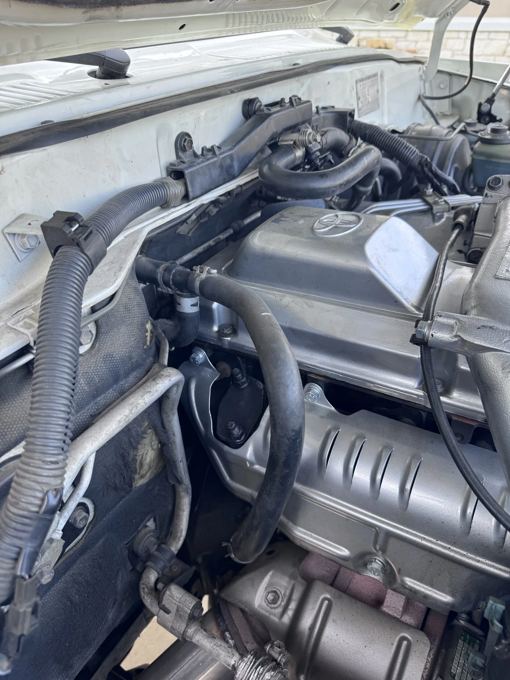

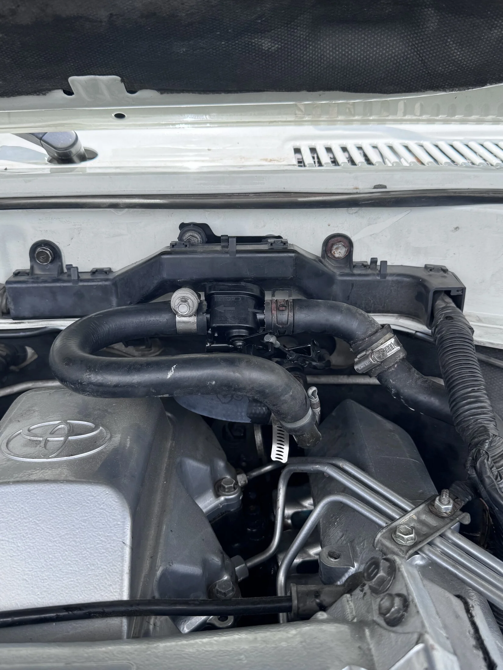

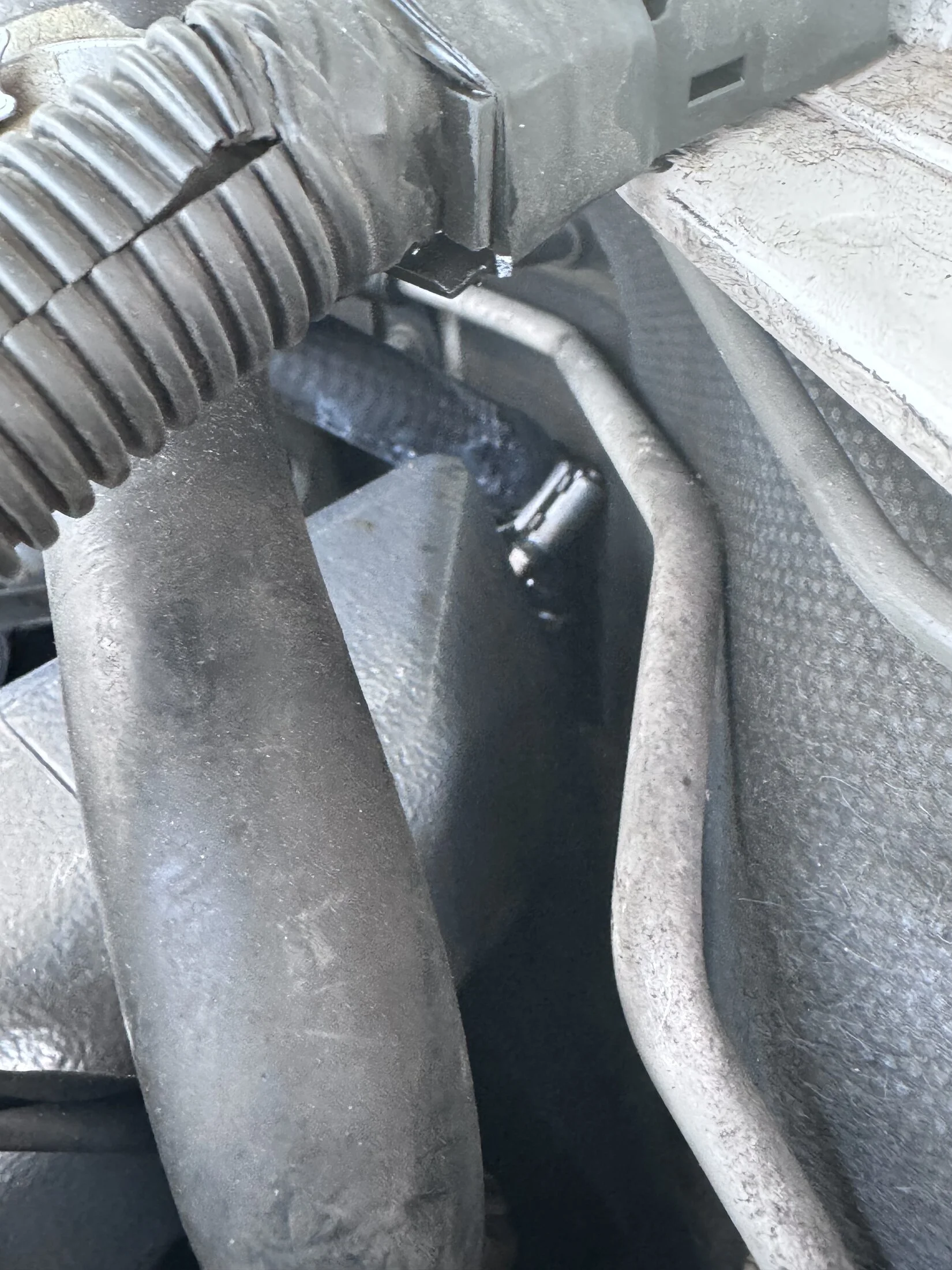

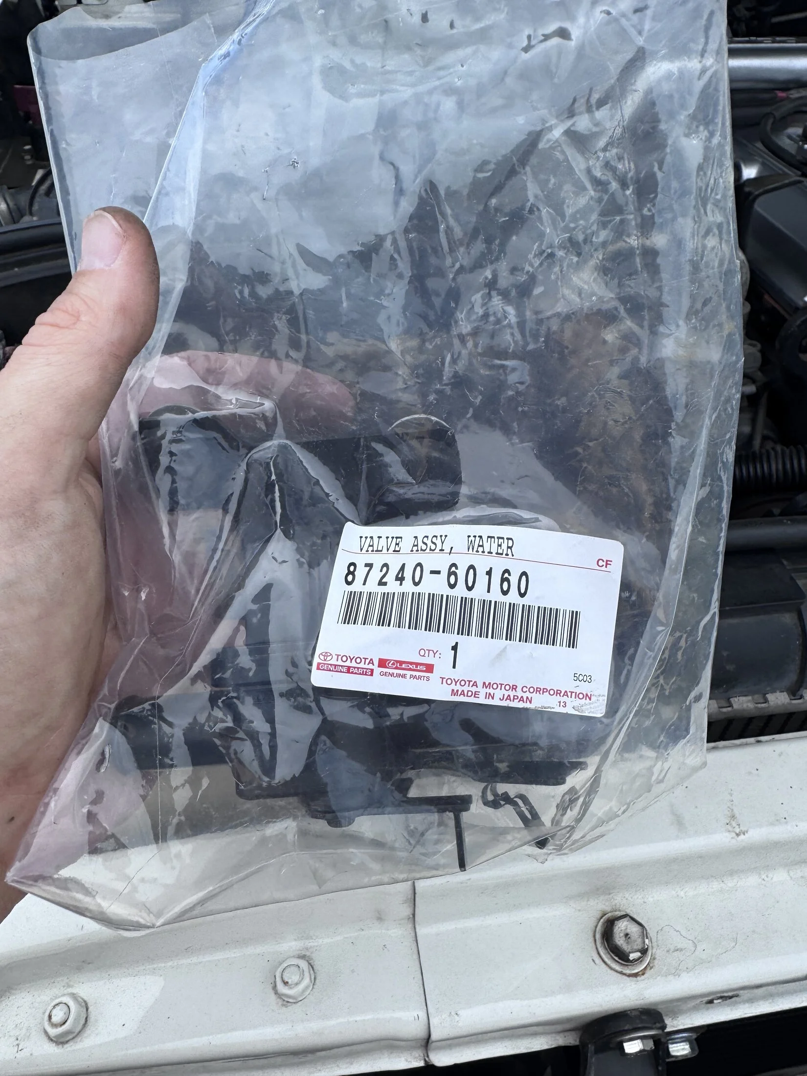

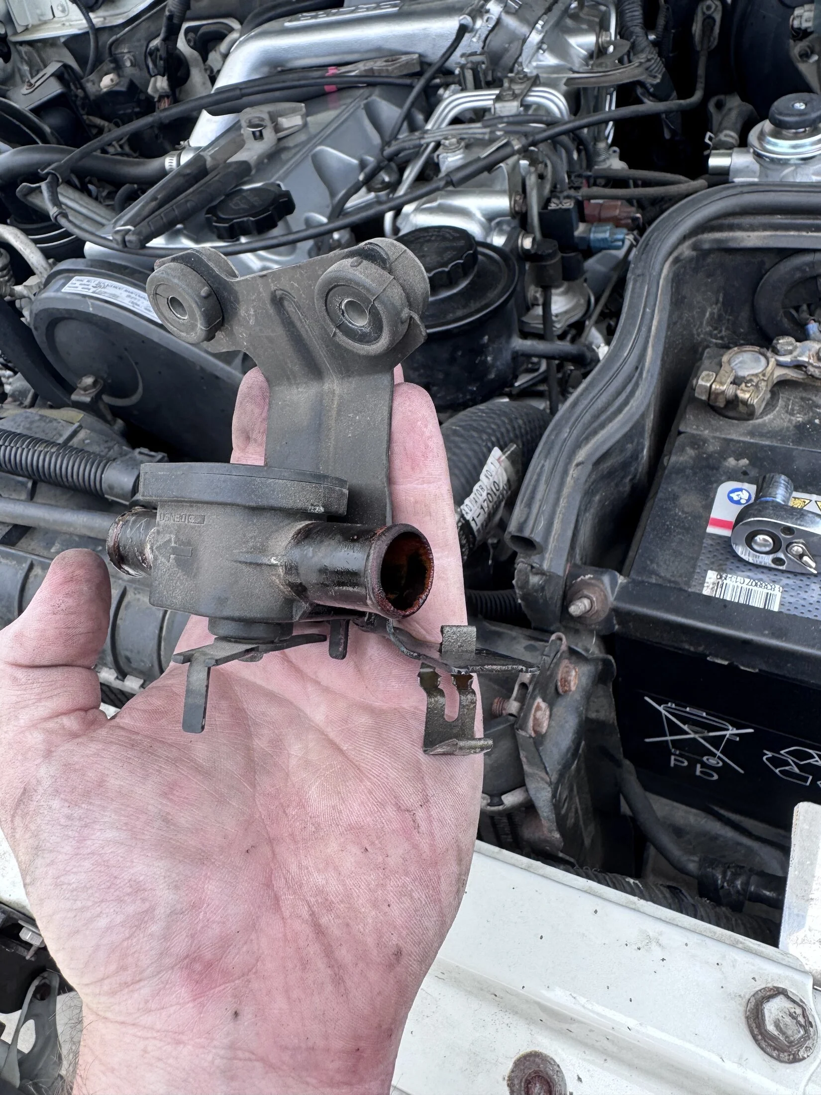

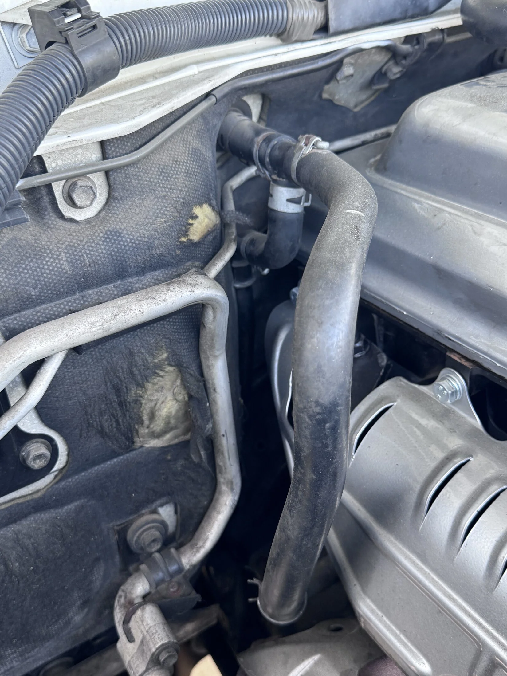

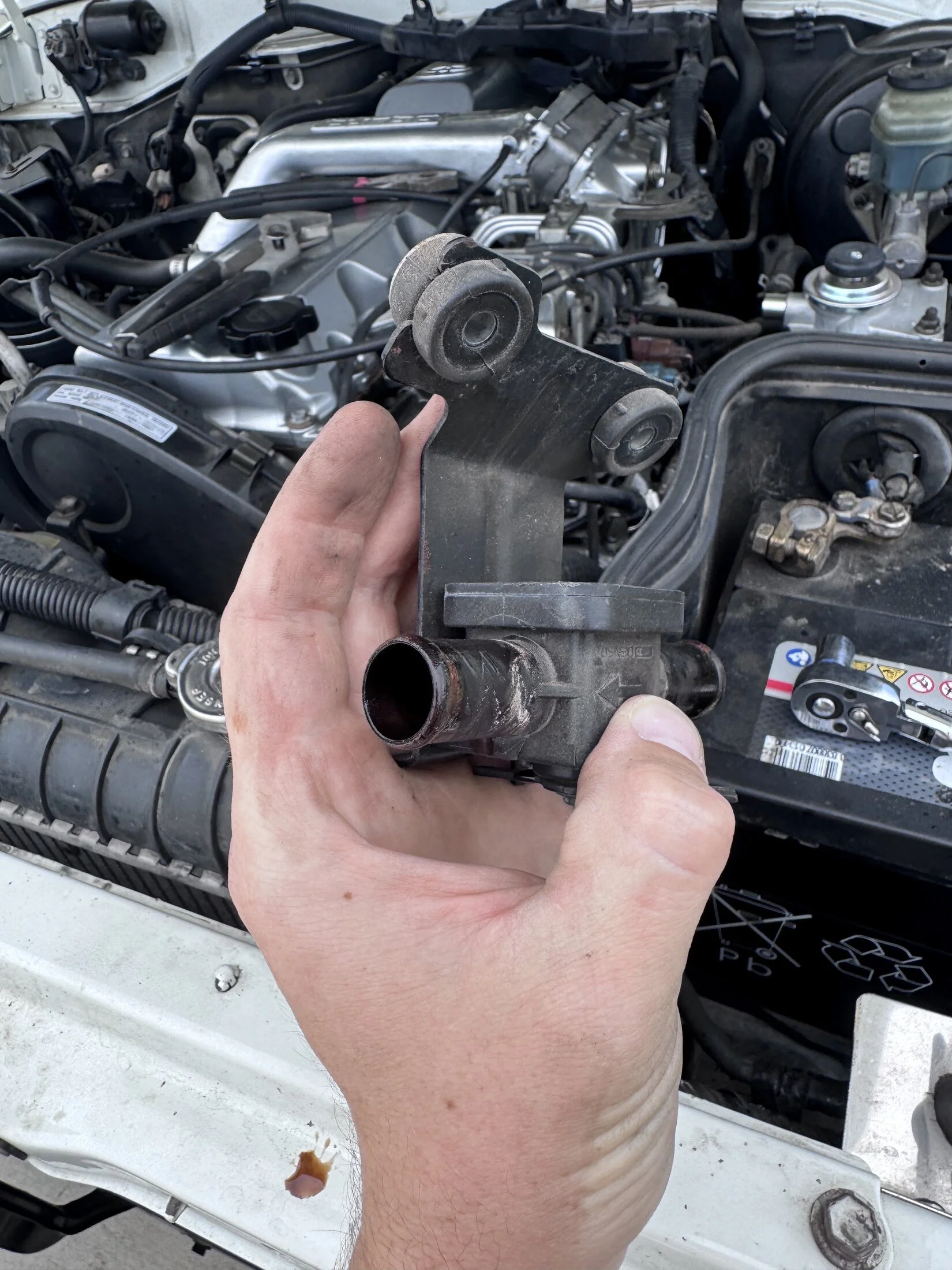

With my time today I changed the heater control valve, the previous owner was recommended to do this asap so he bought the part and sent it with the truck.
The hoses are in sub par condition so will need to change those out too but will need to search for those part numbers unless someone has them on hand. The search function only works well if you got the time and if I didn’t mention it enough already I have a new born and as soon as I try searching a binkie falls out of place and all hell breaks loose haha
I also change out the cotter pin style hose clamp as it got destroyed in the removal process

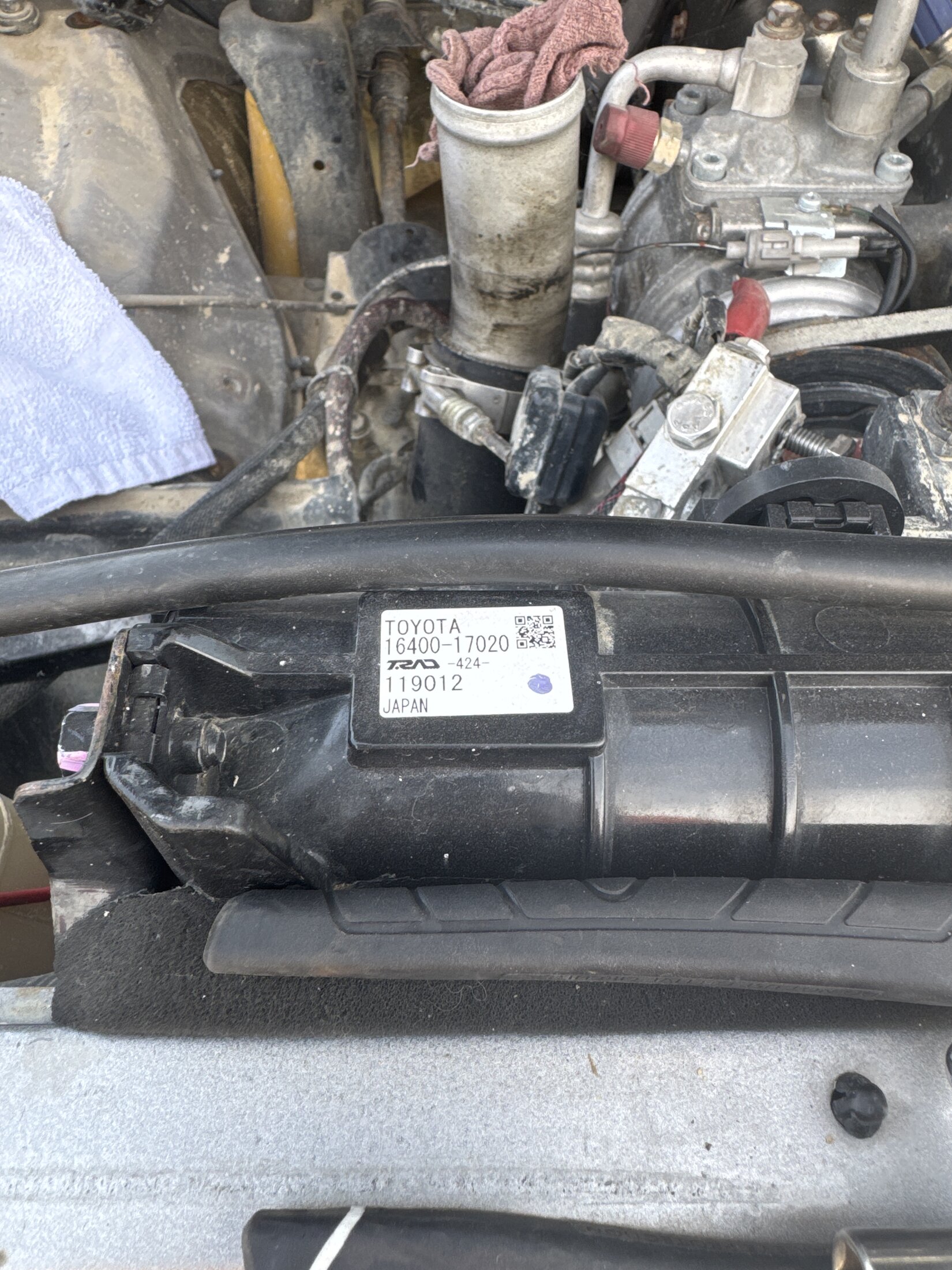

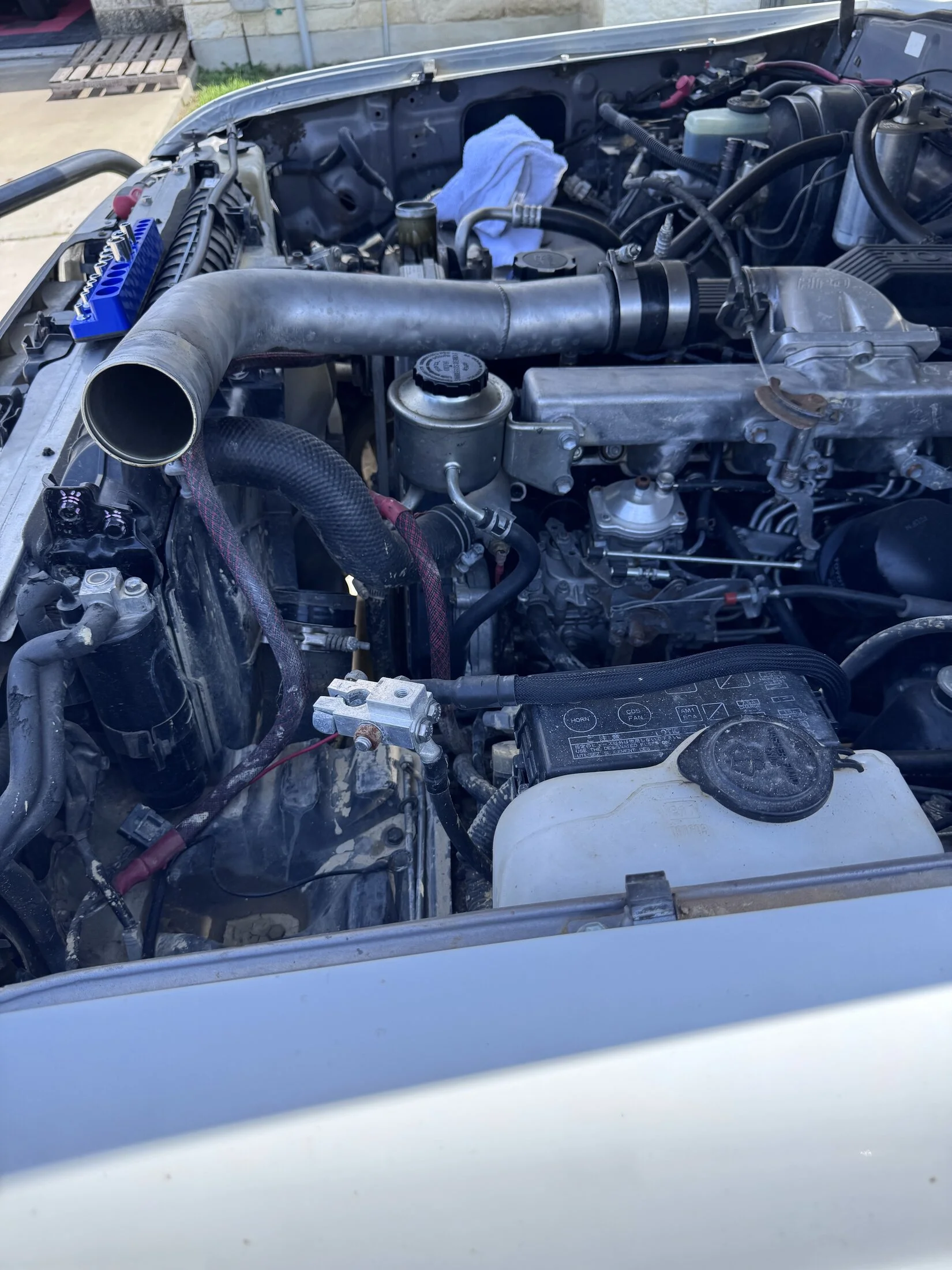

Since I introduced an air pocket I decided to do a mild burp on the coolant system. Looked inside the radiator and see some build up…. Luckily I have a brand new one in the 81. That part number is 16400-17020. I think they are a direct swap but have different radiator cap pressures. If anyone could confirm that would also be great
Update: was able to find the correct p/n for the radiator which is 16400-17040, but the -17020 is a substitute
Hard to tell from the engine photo, but it does look like you have a rear heater in the cabin. Seems like the hoses have been altered to make it work or bypassed. A closeup would help.
Heater control valve to heater core:
If you have rear heater then: 87208-60320.
If no rear heater: 87245-60420
Block to heater control valve:
87245-60320
Heater core to block (includes the tee for rear heater core)
87209-60360

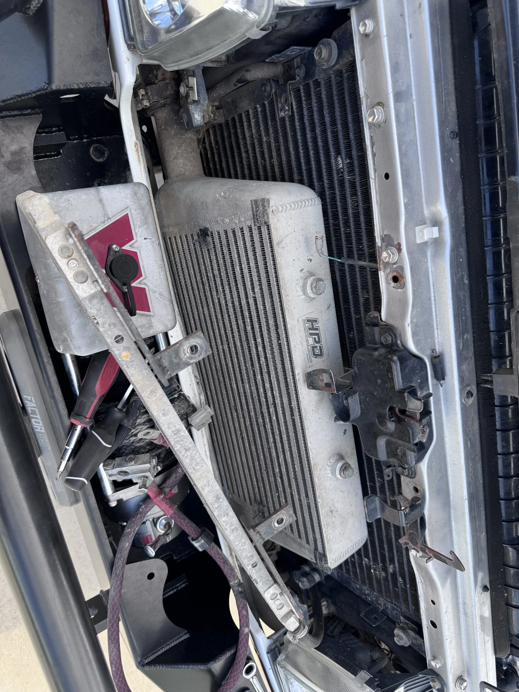

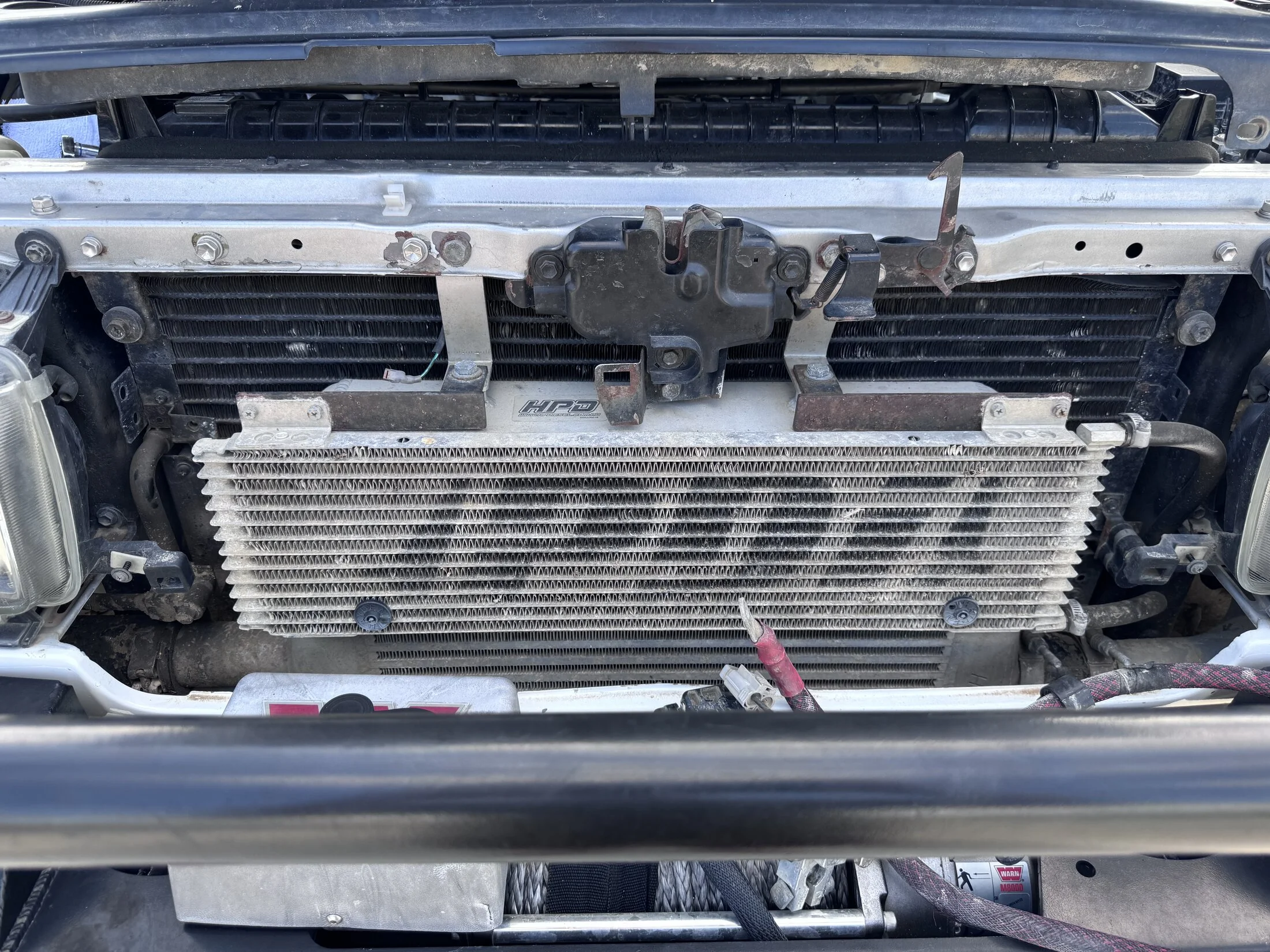

I was able to get the HPD front mount intercooler off the 81 today. I have the automatic trans cooler from PDI not sure if there’s any adaptability or point to pair this with the manual trans so it will go up for sale soon

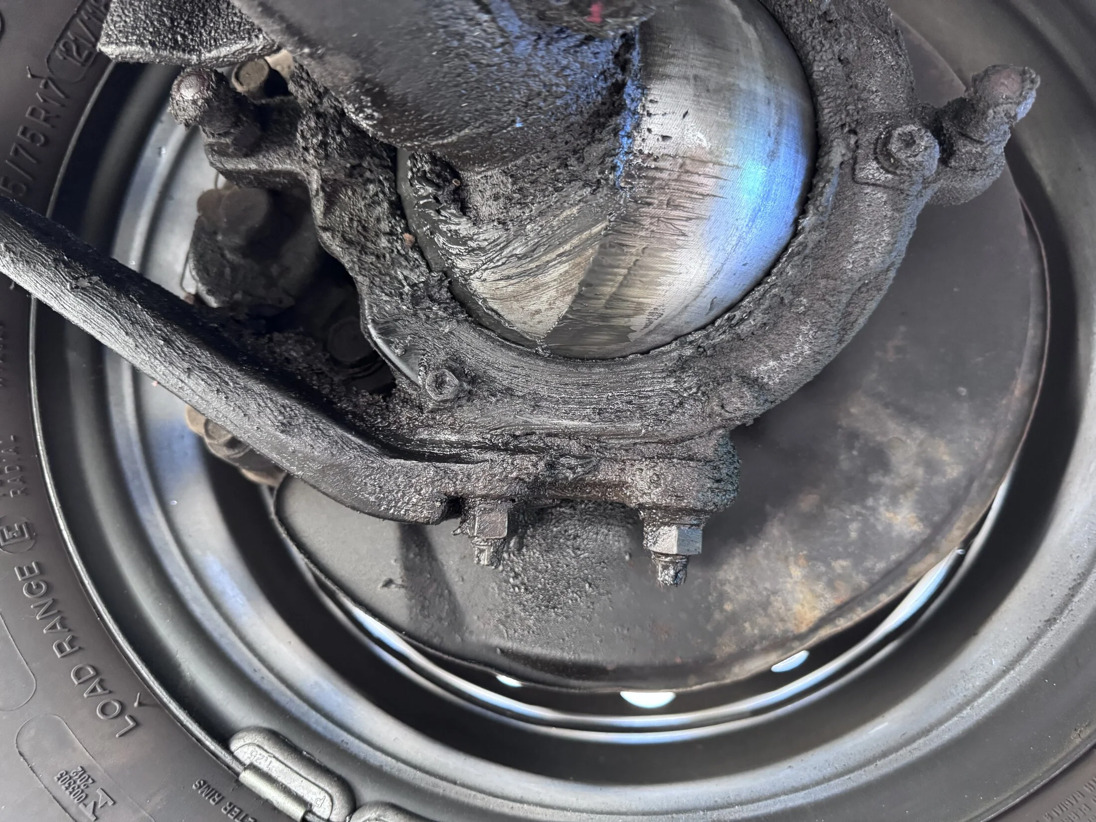

I also took a look at the front birfs and they are leaking, not news to me the guys at OTM let me know before I bought the truck. There’s a part time kit on it already so just the excuse I need to go with longfields
