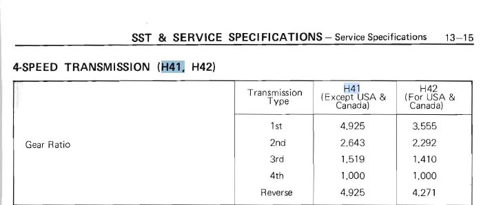

Ran across the H41/H42 transmissions when looking for parts to request on the Heritage Parts Program. I bought my current 1976 FJ40 Cruiser a year ago, and my previous Cruisers I bought in the late 70's thru the late 80's, and they were still selling the Fj40 new or at least selling new parts then. From what I understand the H41 has a very low first gear compared to the H42. Is that correct, and is there any way of identifying which one a vehicle has? At this point its just curiosity, I'm not having any problems with the clutch/transmission.

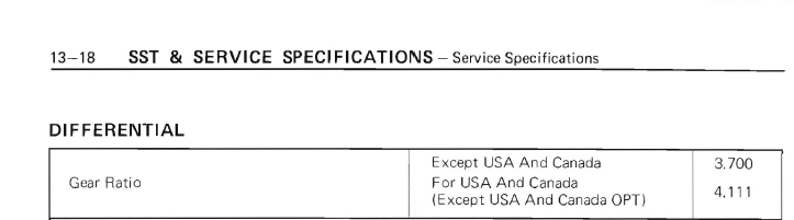

One thing to note on the gear ratios, it seems the H41 was intended to use with a 3.7 diff and the H42 with a 4.11 diff, which brings the total ratio of the first gear closer (but H41+3.7 is still lower).
On this forum we often see people that fitted a H41 on a NA spec FJ40 with a 4.11 diff, which gives a very low 1st gear.
