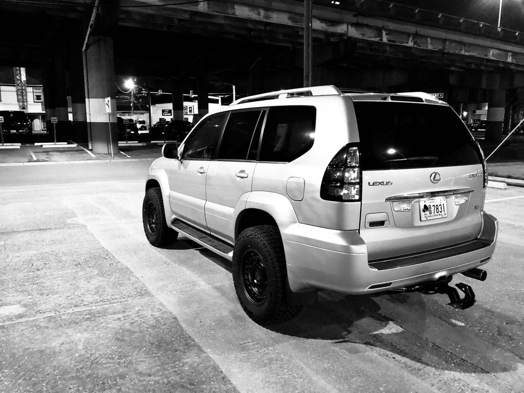

2004 GX470
Black Rhino Armory 18x9.5
Falken Wildpeak 275/70/18
JBA UCA's
MetalTech body mount hack
OME 2.5" medium
As soon as she comes out of the shop, she's going on the chopping block to fund my endangered FJ60.

I'd like to see pics of that one during the day if you don't mind.
Don't mean to be a pest but if they're 0 wouldn't that be 4.5" backspacing? If 5" backspacing, that would be a +12.7 offset, no?
I checked an online offset calculator and they claim to take into account the lip on the rim which adds another 0.5” to the offset. A 9” wide rim with zero offset was reported as a 5” backspace.
Yeah, after some googling I saw some formulas add .5" to the calculation...and some don't haha. I guess I'll stick to offset. Anyhow, thanks for the specs. Exactly what I'm looking for.
