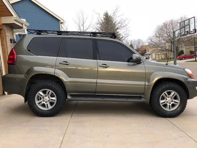

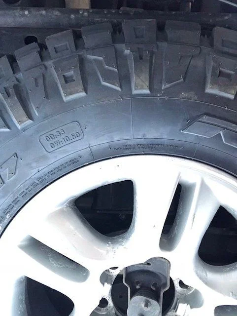

Alright I'm in. OME lift, whatever the shortest springs they make in front with SPC arms, OME shocks. Nitto Ridge Grappler 255 80 r17 on stock rims, no spacers. I was able to get the spare to fit, barely, once I aired it down to about 16psi. It most definitely would not fit otherwise, unless I wanted to remove the receiver hitch, which isn't happening. it's still right up against the panhard rod, don't love it but will keep an eye on it to see how it goes.
The fronts rub in the back of the wells at full lock and compressed, I think I can heat up that plastic though and just mash it in a little. Backs don't rub at all, and I had it flexed out pretty good to test. I think I need it taller in front, even though I like the CV angle right now.
You were able to fit a 33.3” tire in the spare location at 16 psi? How is that possible? I thought 32.2” is the max diameter of the spare location.
Your front lift looks a little low with those tires. Can you share the OME part numbers you used for your shocks land springs?

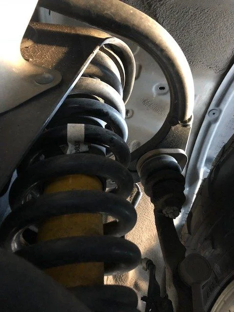

Looks good! 884 springs up front? Did you happen to do a before and after measurement from hub to fender?

that is correct, it's up there. Will see if I can get a picture.
I did not, at the time it was the wife's ride and all I was after was replacing the failed airbags with whatever was low and readily available at my neighborhood Toyota 4WD specialist. I figured one day this truck would be mine, and I'd be dealing with the suspension again, and here we are.. :)

Ok my front springs are labeled 883X. here's a picture... also a pic of the spare up against the panhard rod

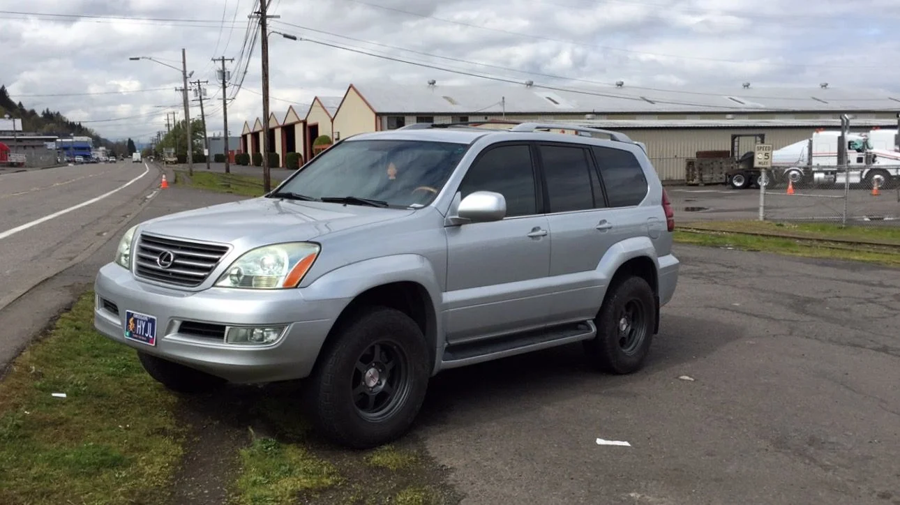

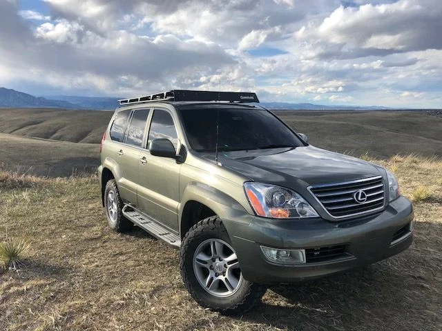

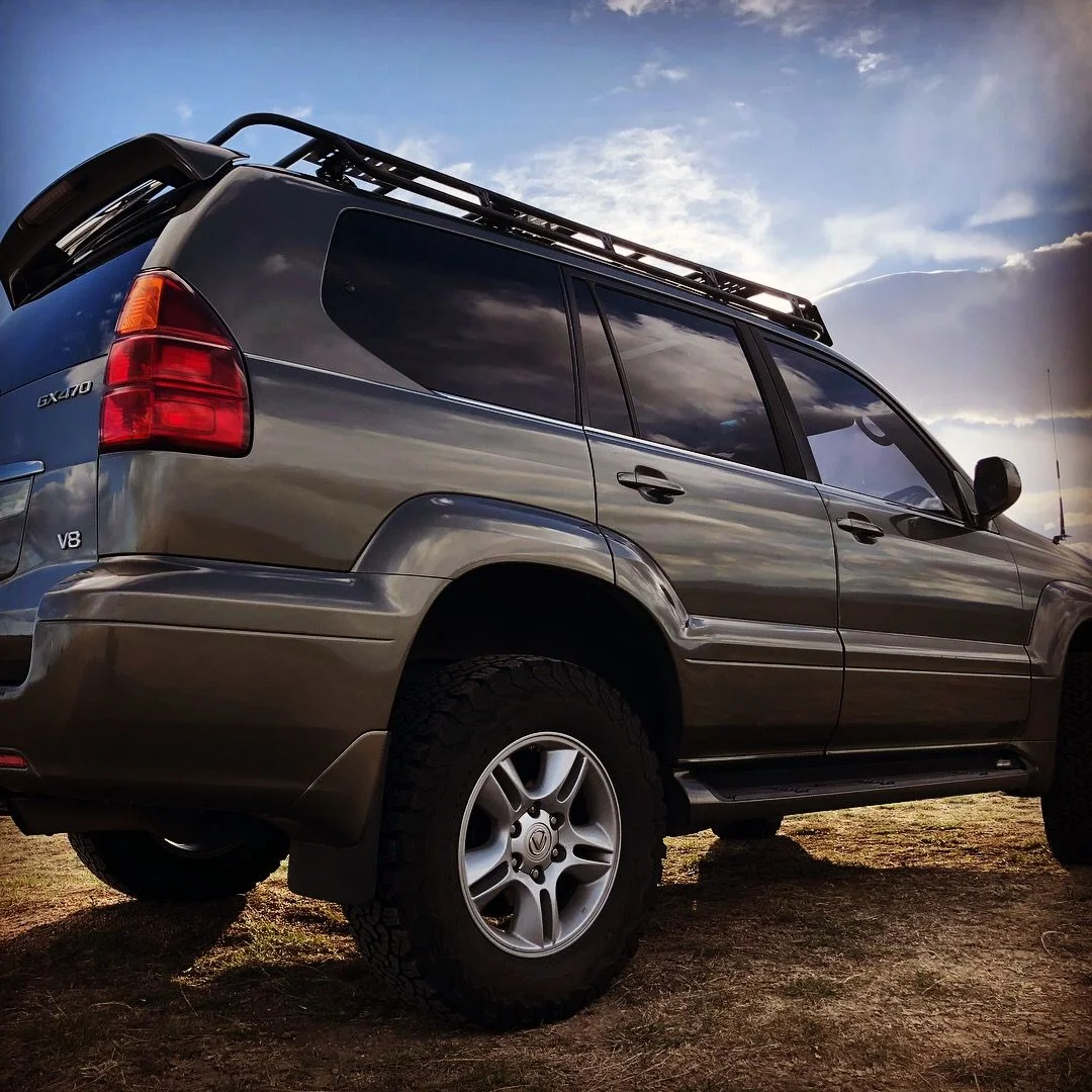

@addition33 some more pics of the truck front and back. Smaller BFG's though, so staying with tire content here those are 265 75 r17 BFG's, same suspension. :)
You were right...you went with the shortest OME front springs that are considered stock height
Front Coil, Wire Diameter, Free Length, Spring Rate (lbs/in)
OME 883 0.67 14.76 590
OME 884 0.67 15.16 590
OME 885 0.67 15.55 590
OME 886 0.71 15.83 660

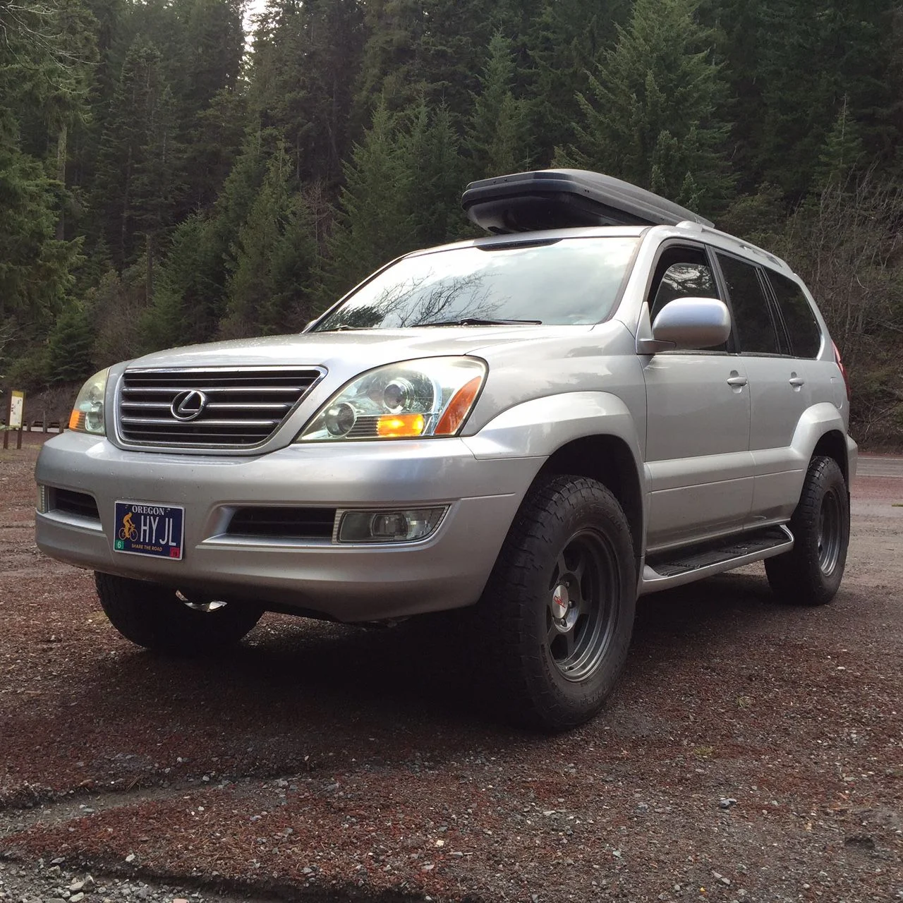

Front = Toytec 2.5 w/ 5100 on bottom perch
Rear = Moog FJ w/ MT conversion (stock struts for now)
265/70/17 terra grappler on FN countersteer wheels
Torn on if I like the tire size or want to go bigger. Trying to stick to a "mild" setup as it spends 80% of its time in urban settings and my old lady drives it a ton.

The 265's look good with your wider wheels but of course bigger would look great as well. I basically have the same suspension setup and torn between 265 and 255/80. Trying to keep a mild setup as well...
