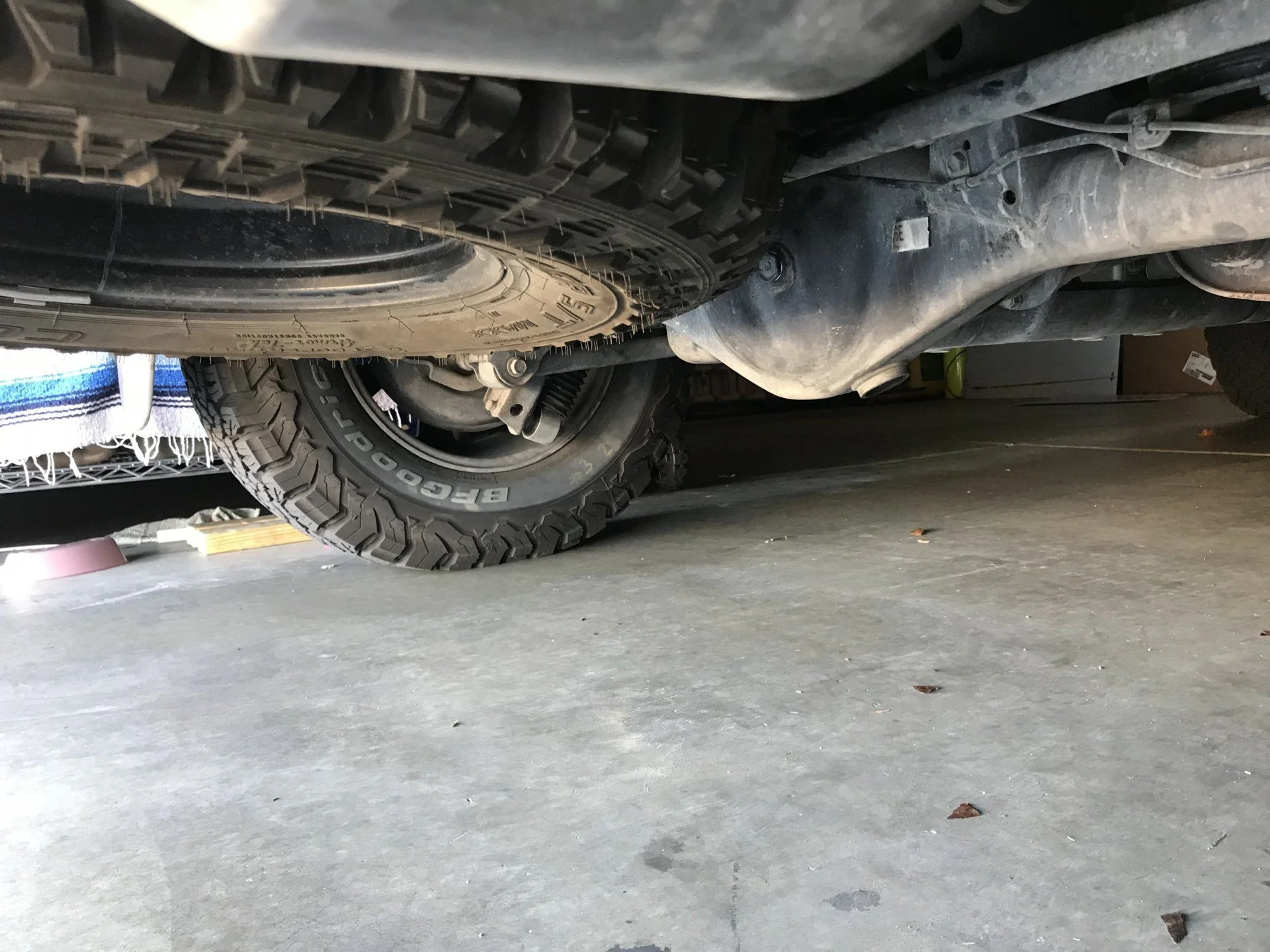

Does this tire size/wheel combination fit in the spare tire location? I have read conflicting accounts if it fits or not.

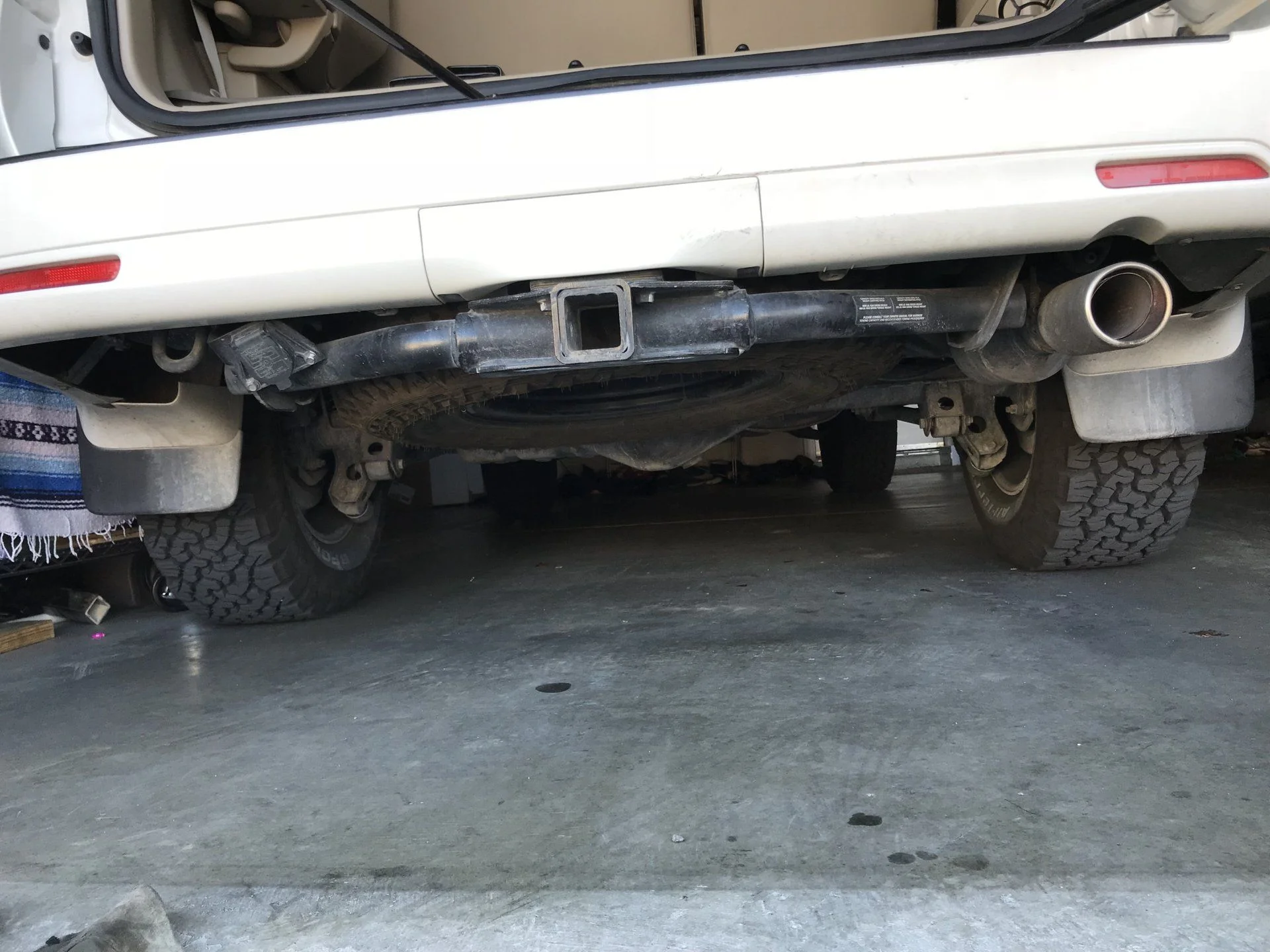

No. I tried stuffing one in and I am short about 3/4-1" I have compact hitch and KDSS so it might fit non KDSS.
The one I read fit on 5th gen 4runner with cooper ST MAXX. That tire must run small. People also say they do not notice power drop with that tire while I definitely notice power drop as the gear always shift down with slightest incline. My highway MPG drop from 18 to 16 corrected also.

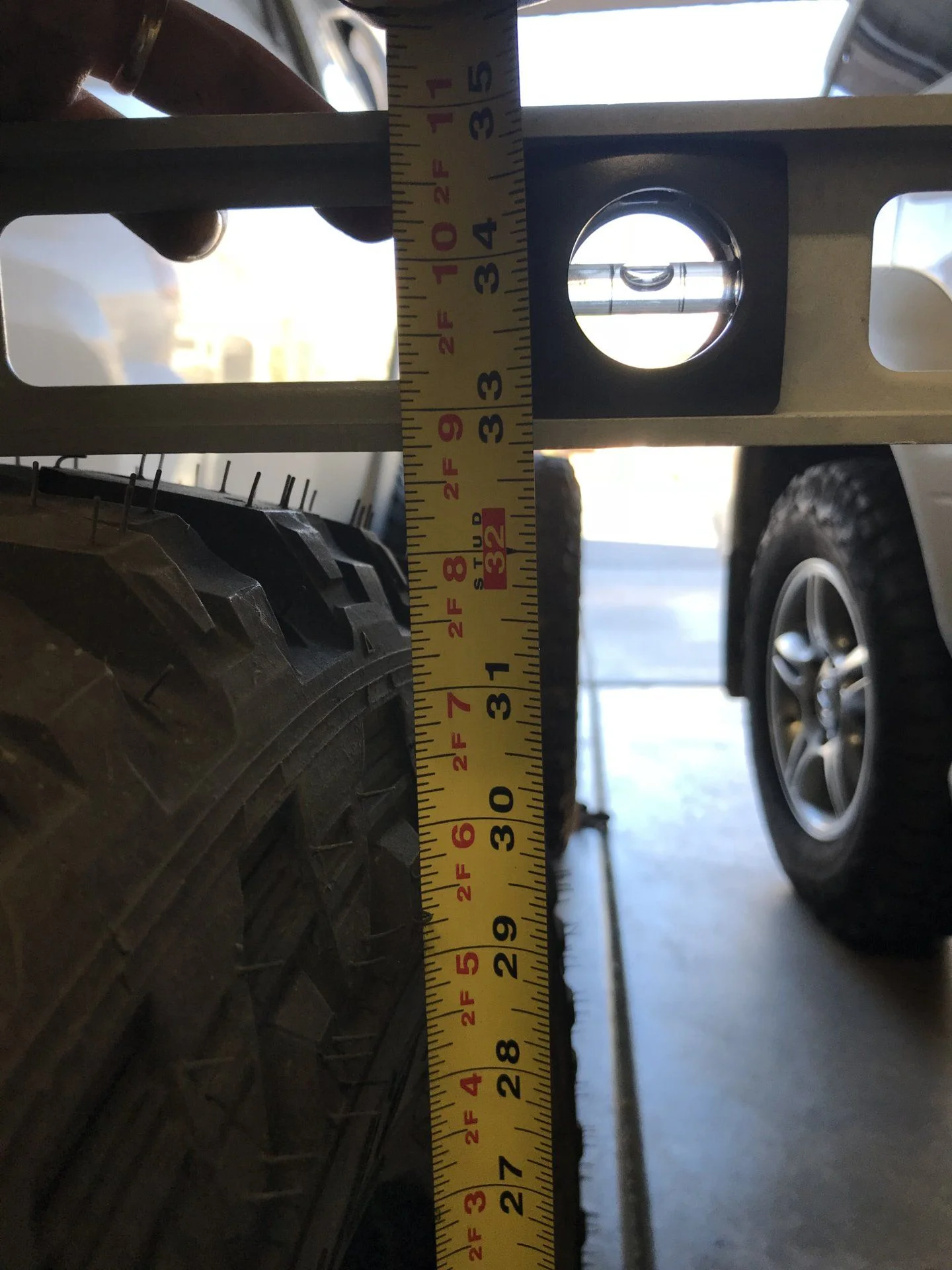

Here’s a ST Maxx 255/80, no KDSS but with factory hitch. Tire is about 32.75”
That is encouraging.

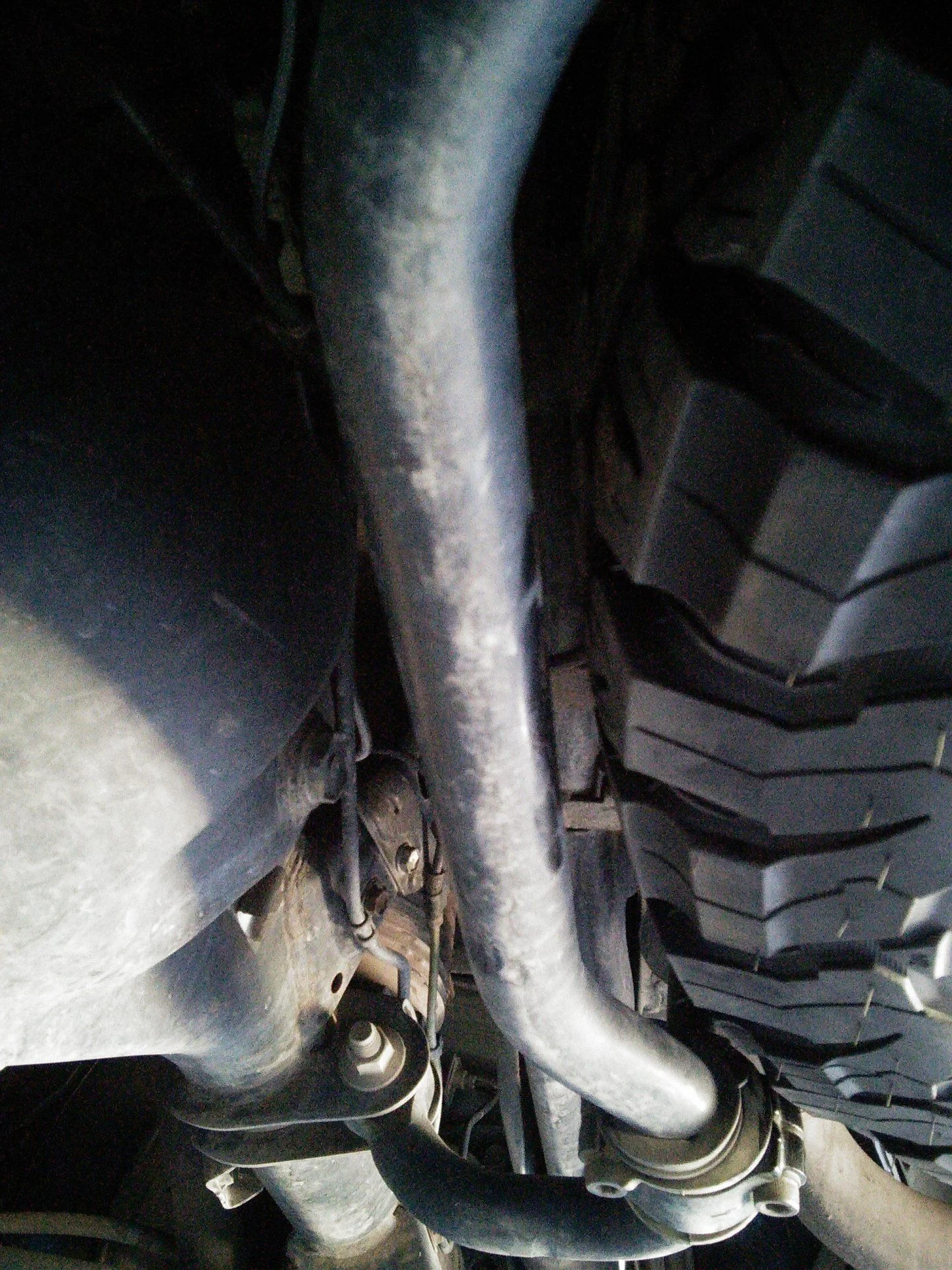

I am getting GX460 KDSS RSB. They seems to have much more clearance. Hopefully they fit.
new-spare-fits-3.56743

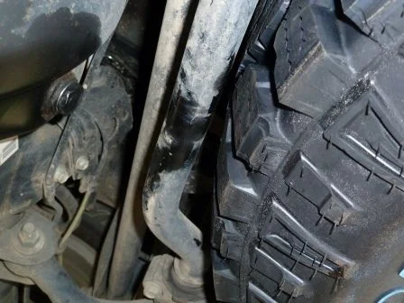

photo courtes @DRANGED GX470 KDSS rear swaybar
full
Picture below is 4runner trail that show much deeper bend.
Well I just wasted some $$ buying used GX460 KDSS RSB. It does not really fit.
First it's 30 mm diameter VS 33 for GX470.
The fixed side link location move outboard 1.5-2".i can make it for but require moving the bushing stopper to the outside.
The bend does not show much difference.
