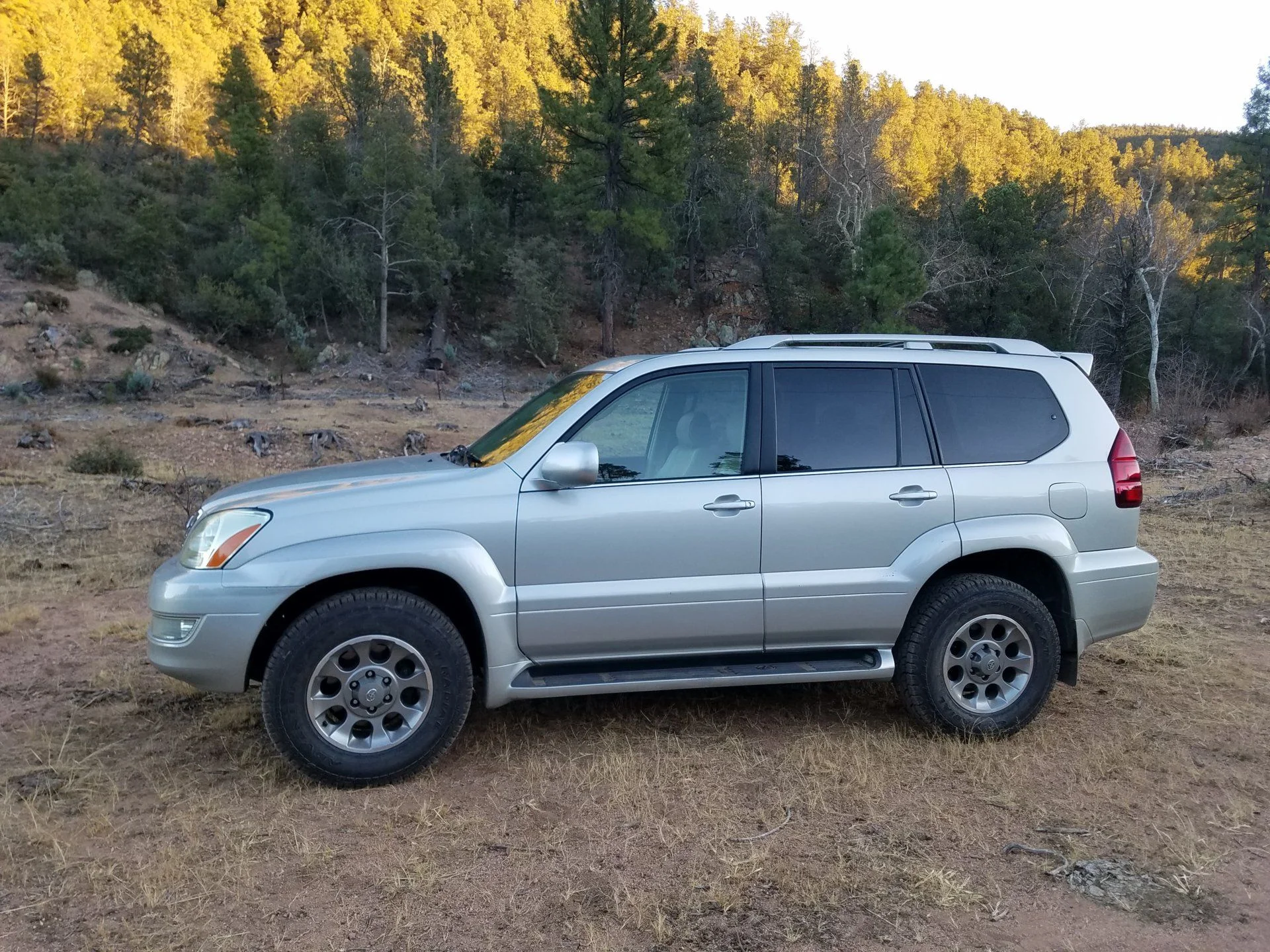

2004 GX
Stock suspension
FJ wheels/ GT at3 245/75/17

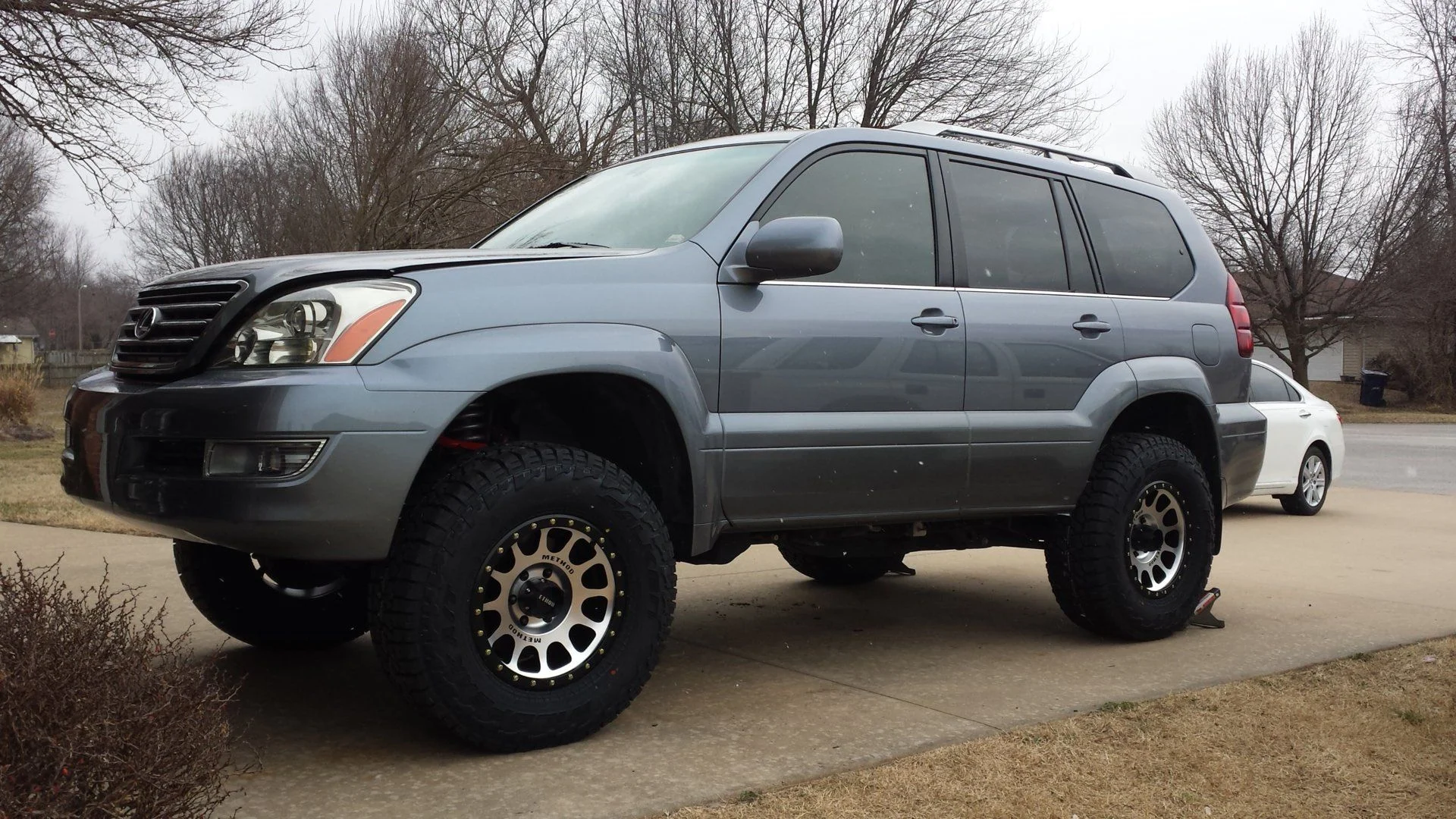

2003 GX470 Blue Ash Mica - Updated 8/09/2022
Front:
- Bilstein 6112 Coilover Kit 47-284142 with heavy coils 700 lbf/in
- TotalChaos UCAs
- OCD Front Sway Bar End Links
- Durobump front bumpstops
Rear:
- ICON 56550 MetalTech extended length shocks
- Dobinson variable rate coils CS59-675V
- OCD Rear Sway Bar End Links
- Timbren rear bumpstops

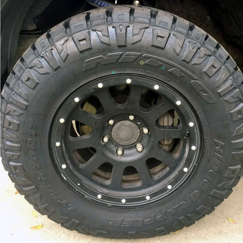

Tires/Wheels:
- Nitto Ridge Grapplers E-Rated 285/70R17 (32.7"x11.6")
- MB Wheels 352 17x9 with -12 offset

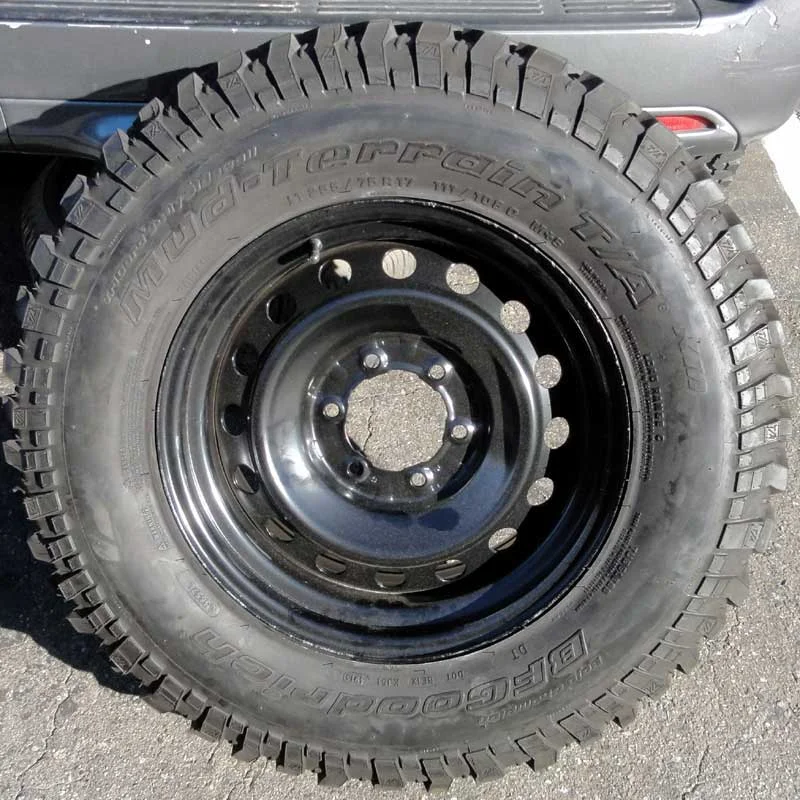

Spare in spare location:
- BFG MT KM C-Rated 255/75R17 (32.1"x10")
- FJC black steel rim 17x7.5 with +14 offset
Armor:
- OPOR rock sliders
- Rock Steady aluminum skid plates (front and middle)
I have a slightly smaller tire 32.1" (255/75R17) as a spare in the stock spare location even though I'm running 32.6" inch tires (285/70R17). Here's my thread...Spare Tire Issue under GX470
So, the options are:
1. Carry a slightly smaller spare in stock spare location
2. Carry the 32.6" full spare deflated in stock spare location
3. Carry the bigger spare tire inside the GX470, on the roof, on the rear bumper on a tire carrier

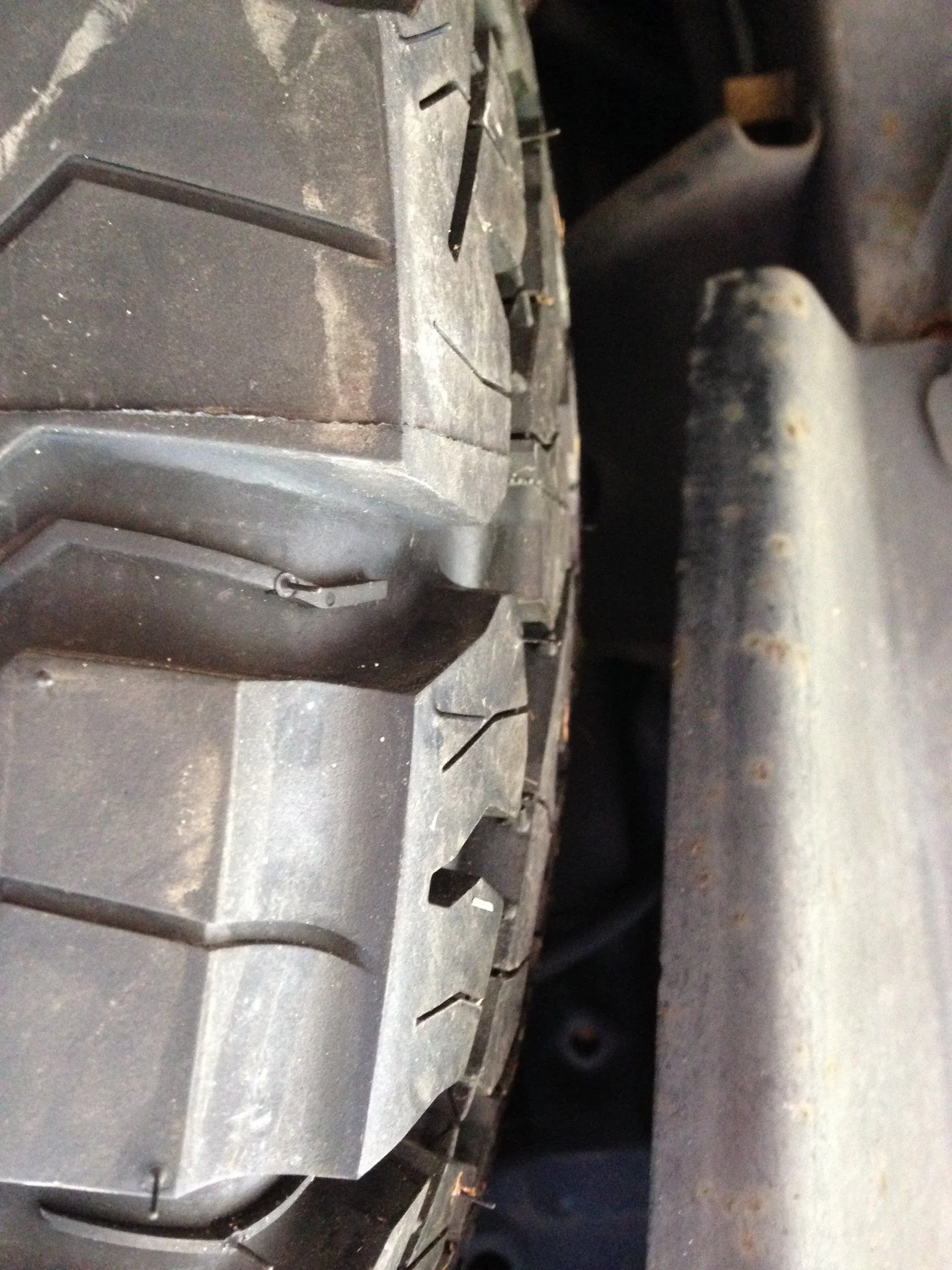

There's potential for contact against the tow bar edges. I'll drop the spare and check it out after I make a few trips and check it.

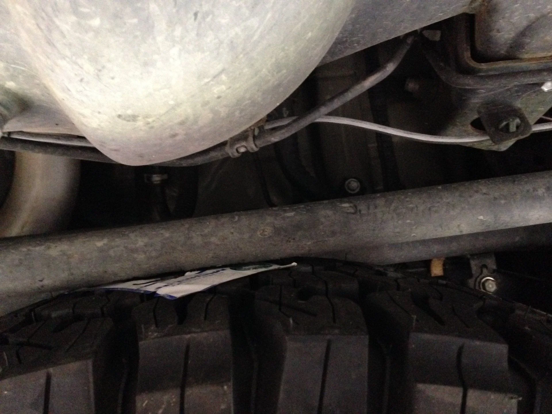

Literally a hair's width here. Another location to inspect later. Just so happened the tire sticker landed out right there when I winched it up.

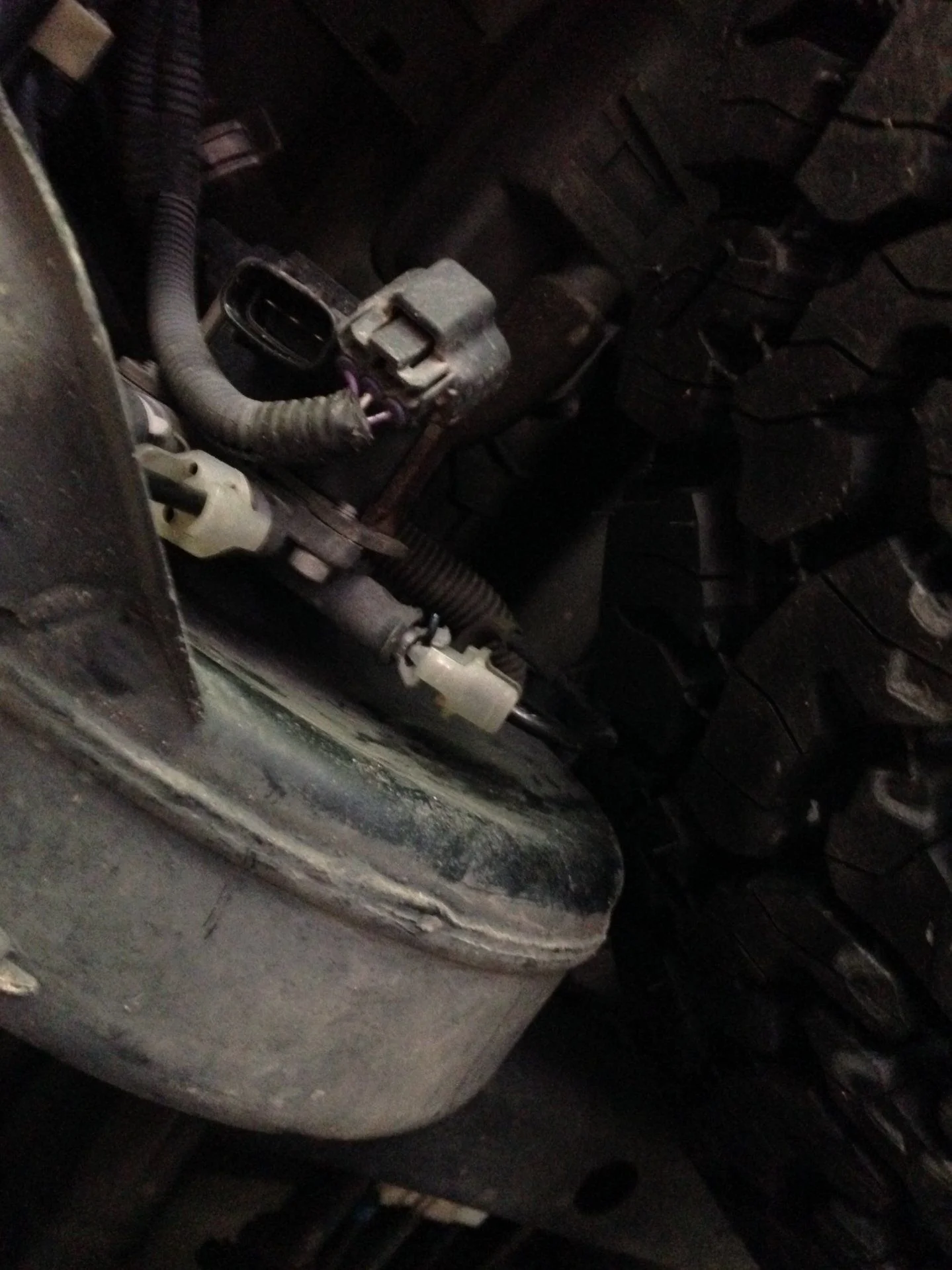

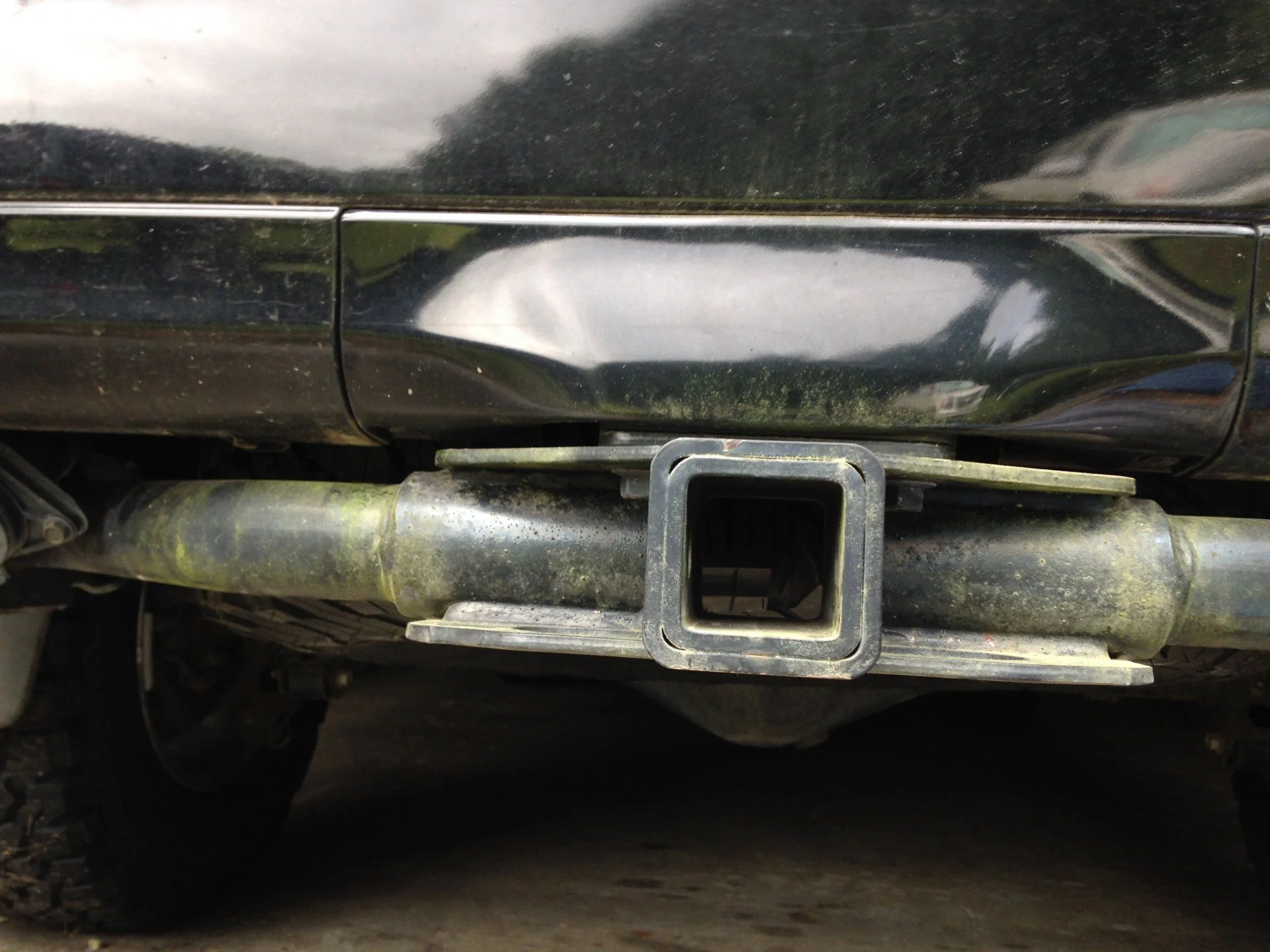

Tow bar mounts to frame clear on each a side.
I left the air pump on because I got lazy towards the end. I'll make a date next month to remove all that. For the record it clears, too.

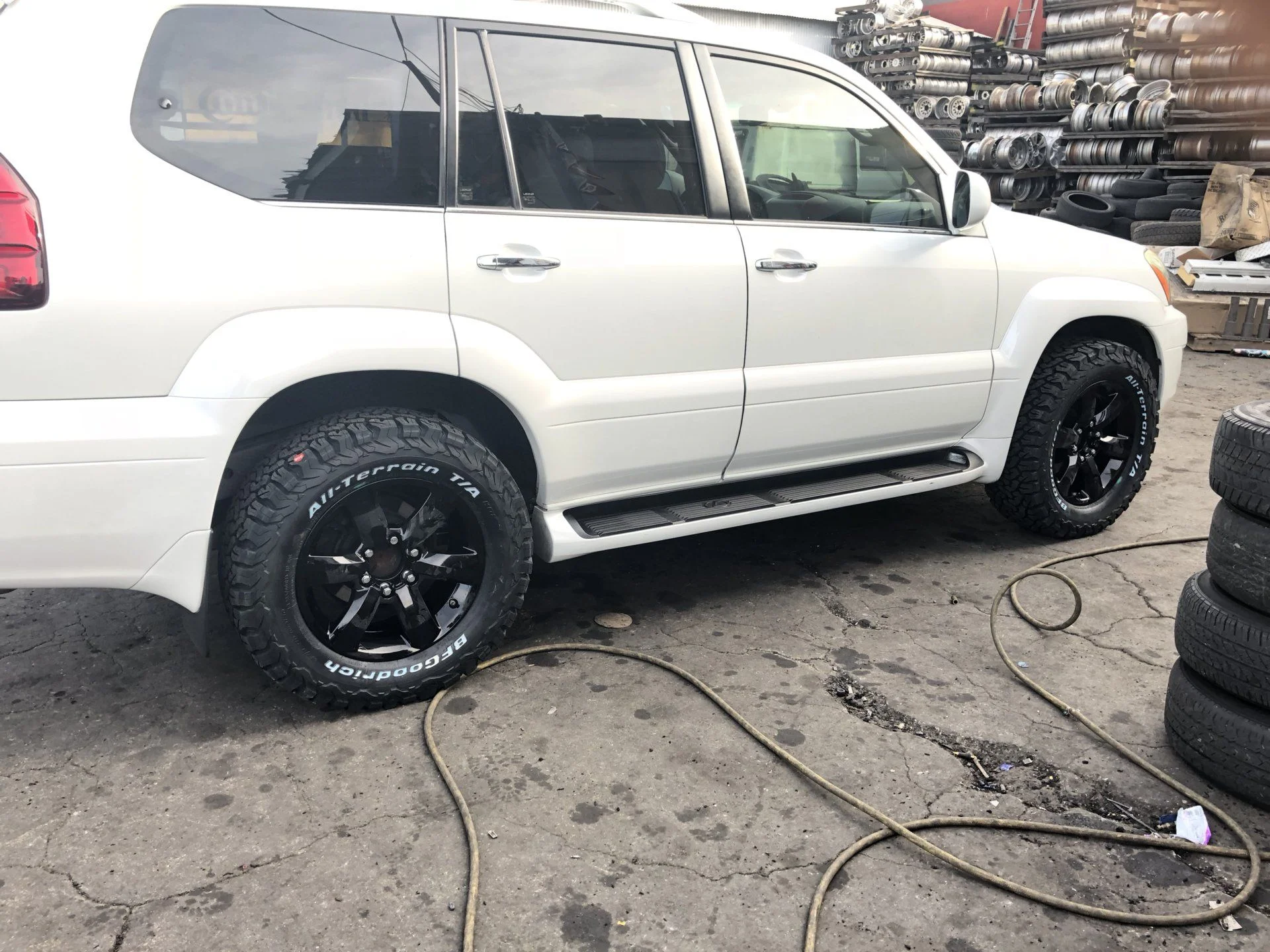

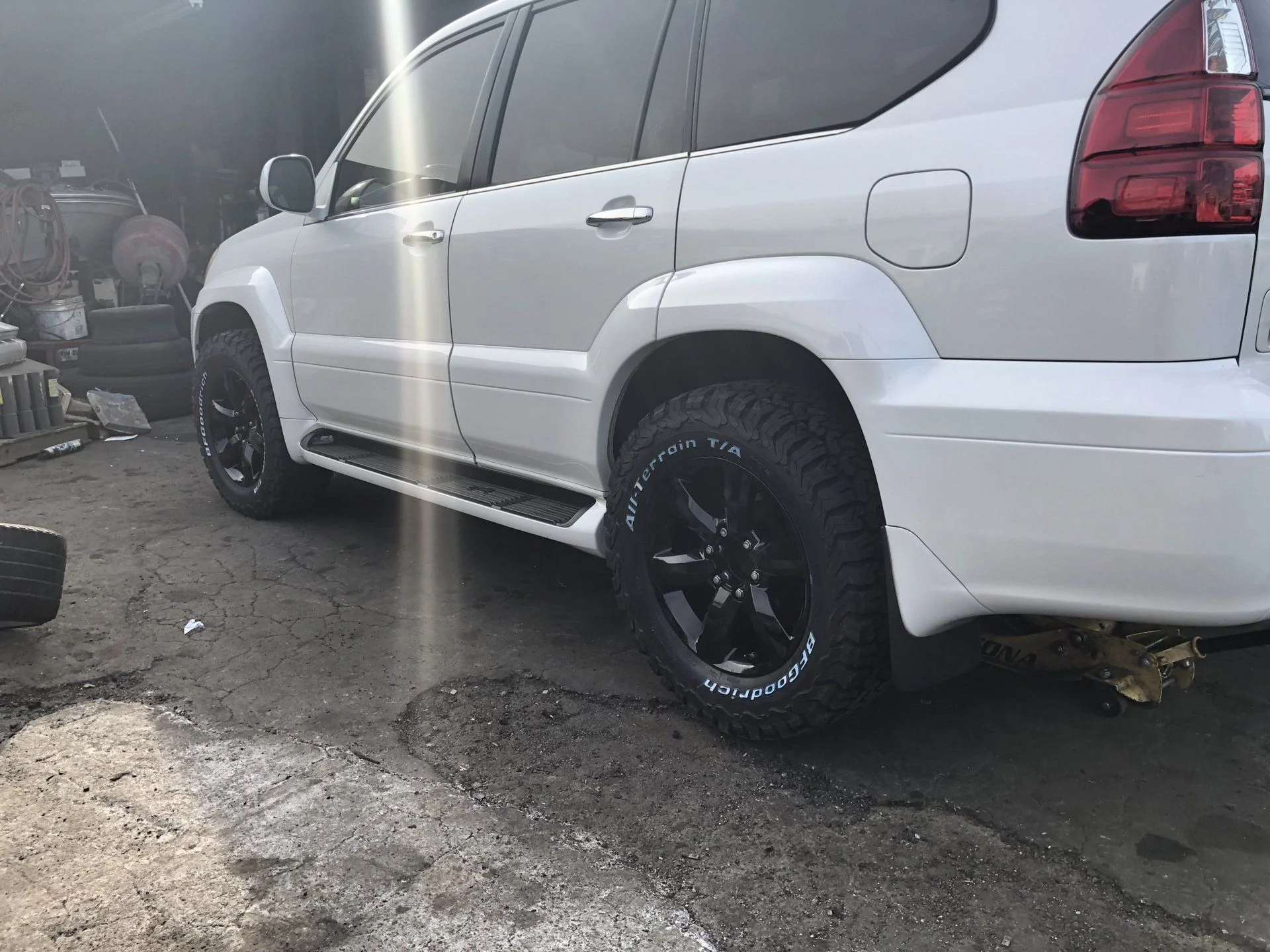

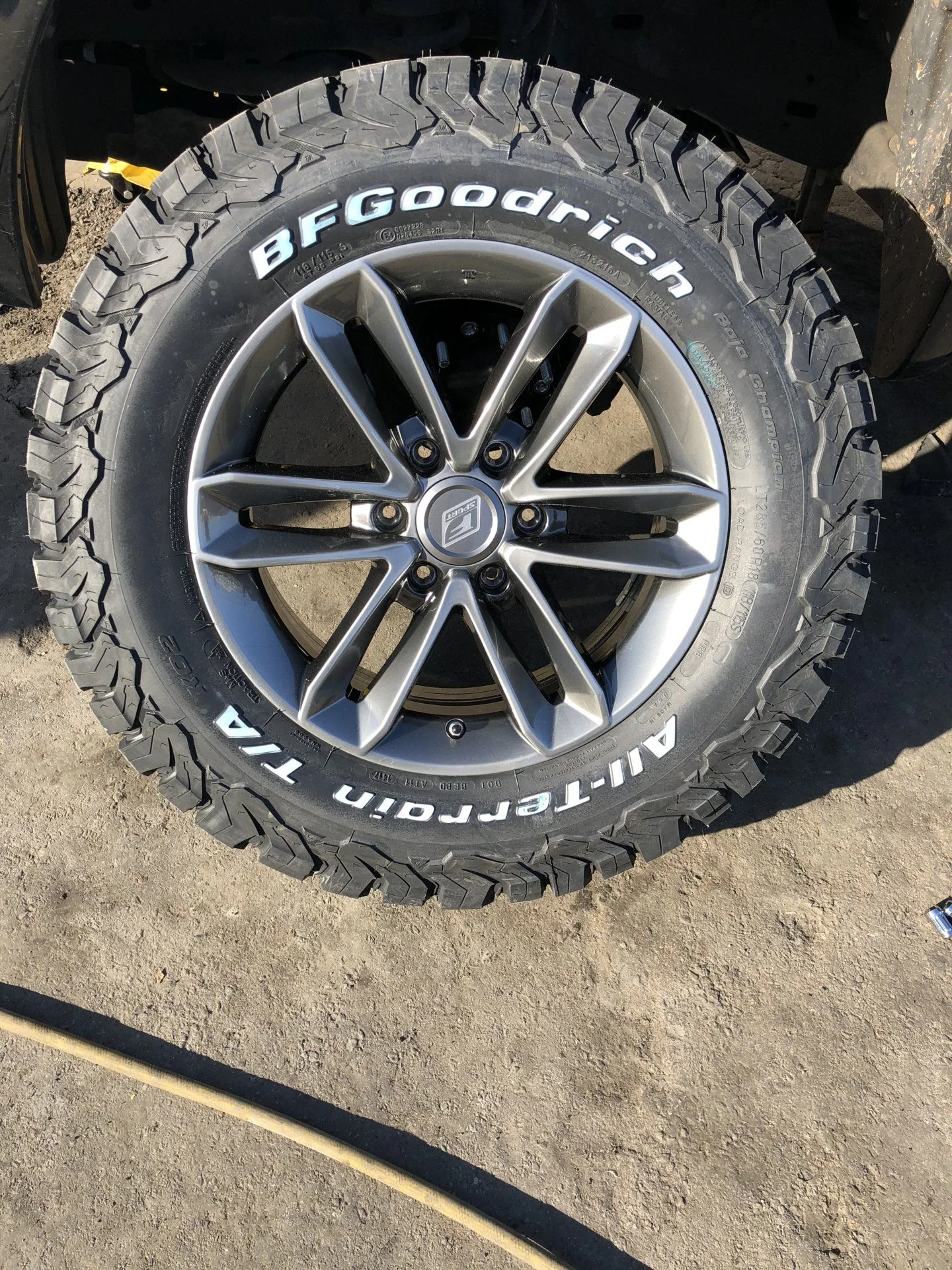

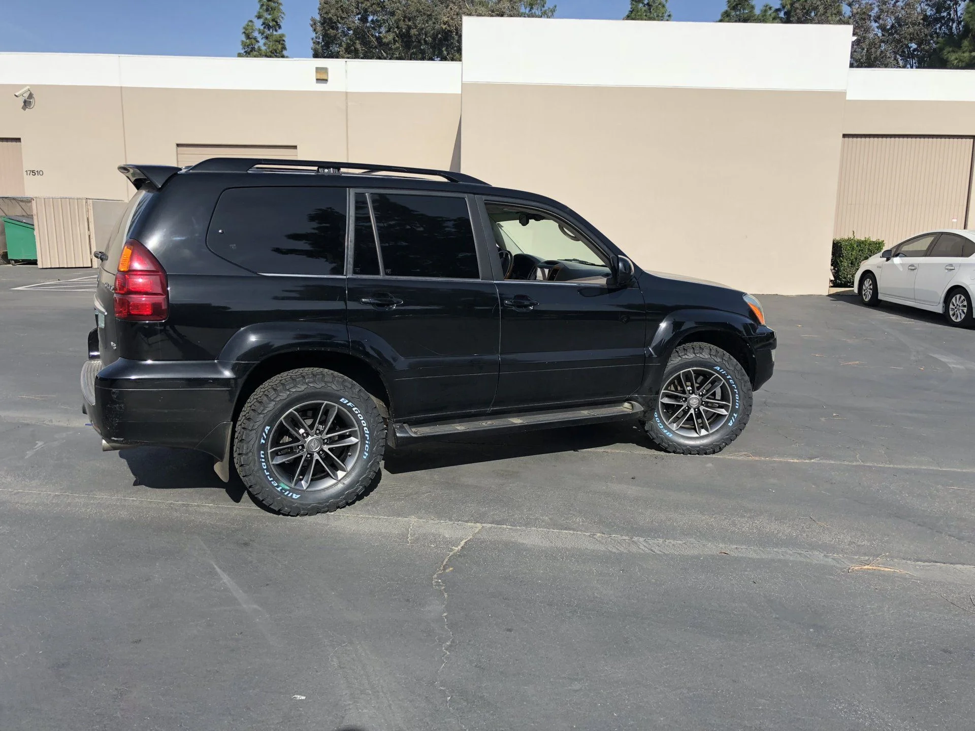

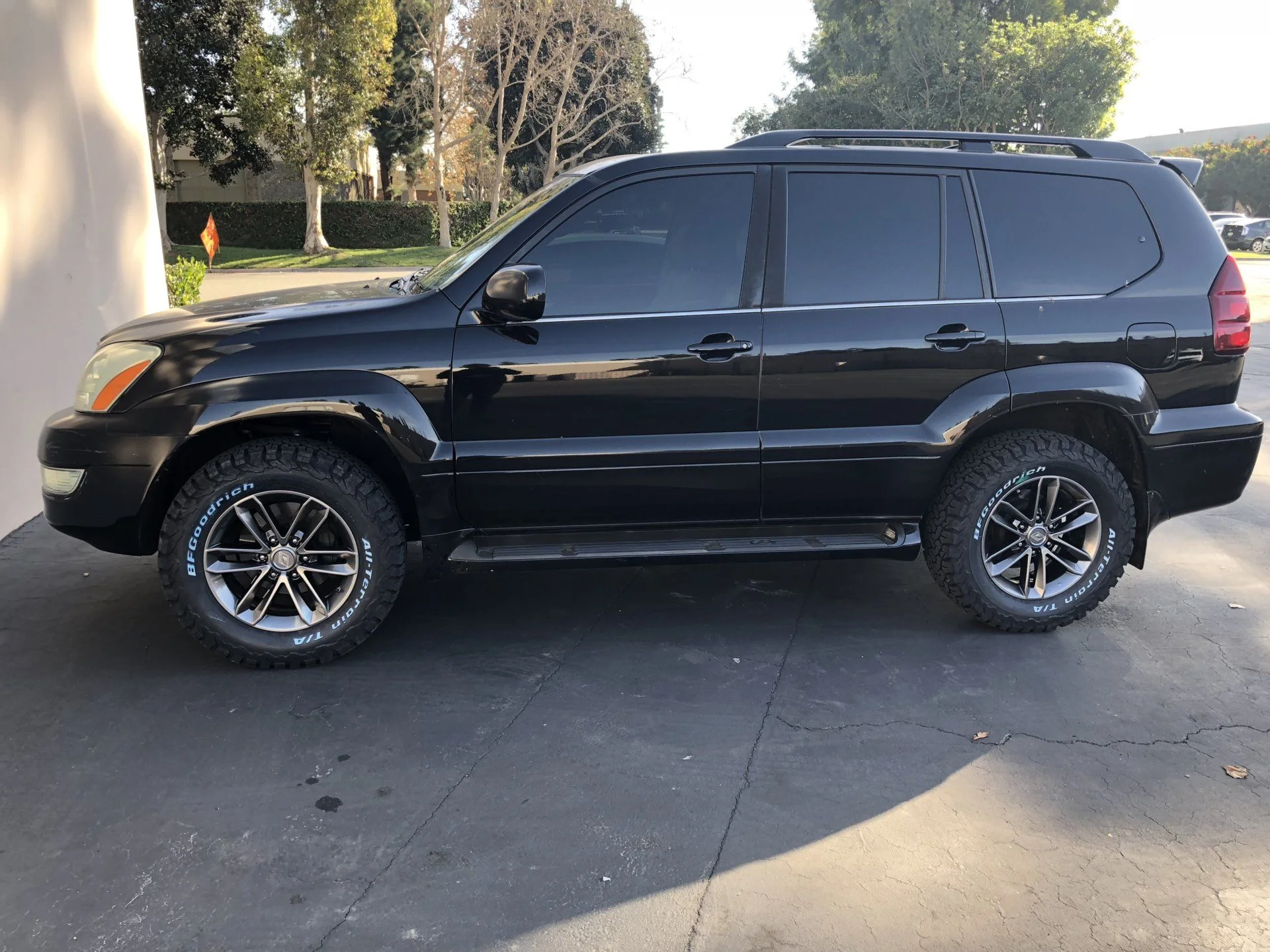

Anyone running a 285/60/18 KO2 on stock gx460 18’s with 1.25” spacers? We are about to on my brothers 08’ gX.
Wheels :2014 GX460 18’s powder coated black
With 285/60/18 BFG KO2 just installed.
spacers: 1.25”
Lift: none
Center caps are being painted

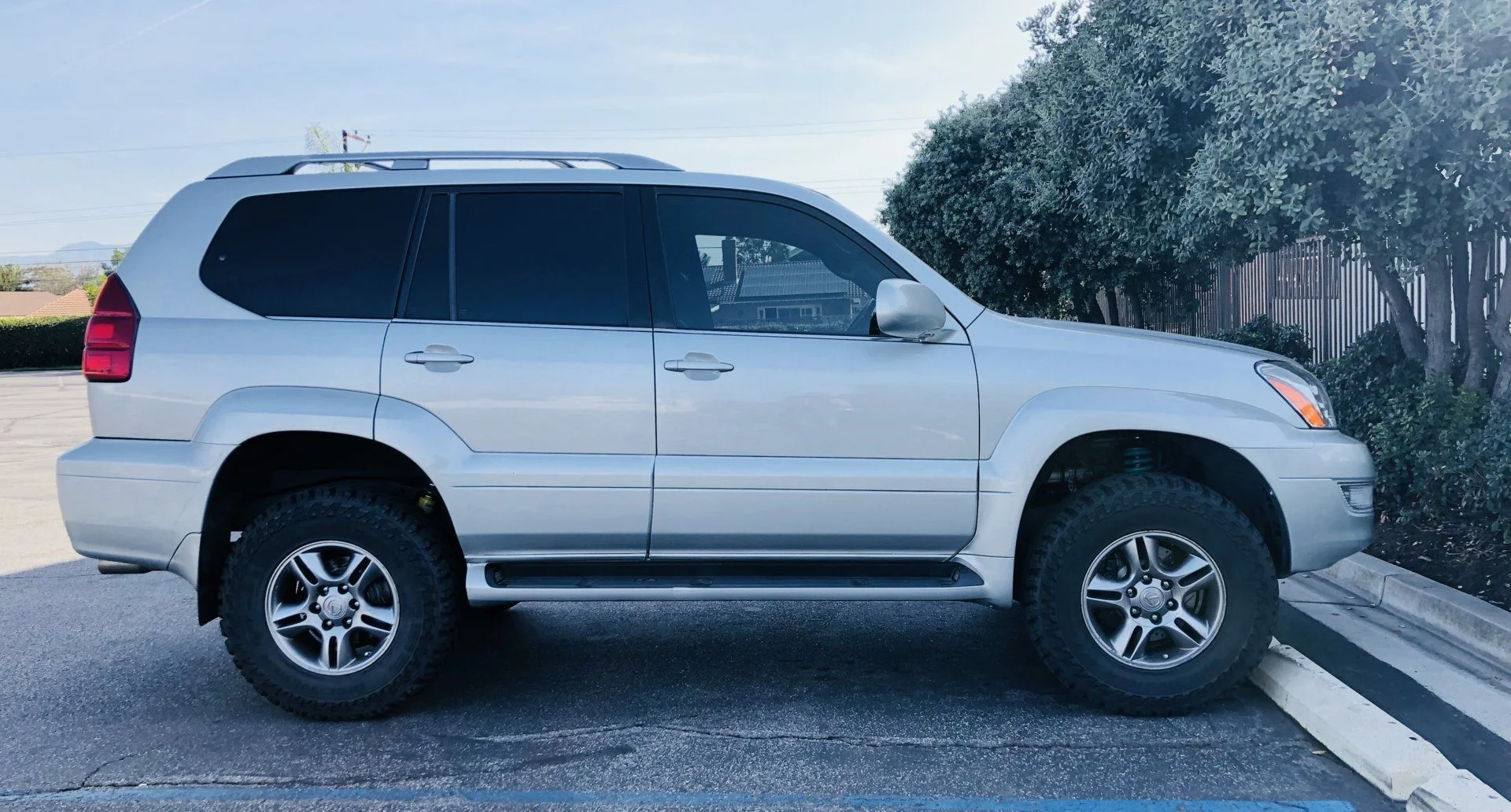

Toytec Bilstein 3" coilovers
4Runner SR5 wheels powder coated metallic anthracite
Goodyear Duratrac 285/70/17
Had to trim 3" off the inside of the mud flap but otherwise no rubbing.

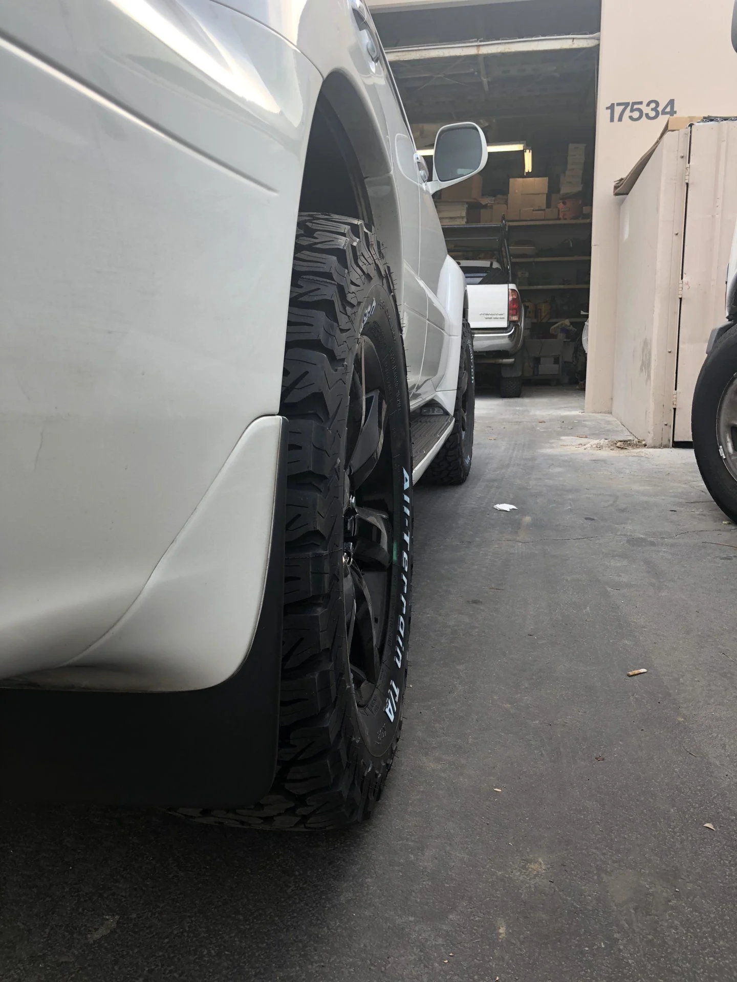

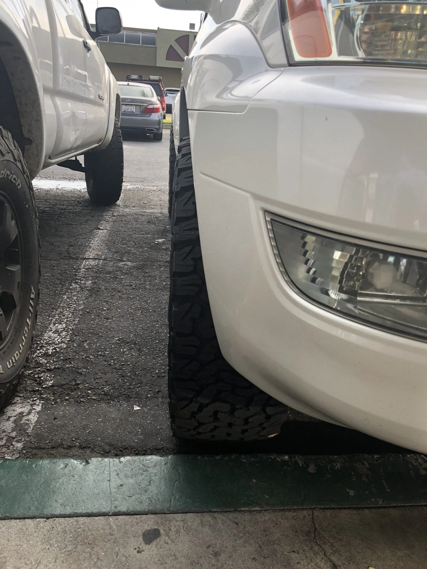

2014+ GX460 F Sport 18’s wrapped in 285/60/18 KO2 with 1.25” wheel spacers.
What you have a Black GX and a White GX?
My brother got the white 08’ about a month ago. I likes it so much, i started to look at used ones and decided to Get my wife out of her 2014 Audi Q7 and Into this black 06’ to “not have a car payment” since she was not going to be working
