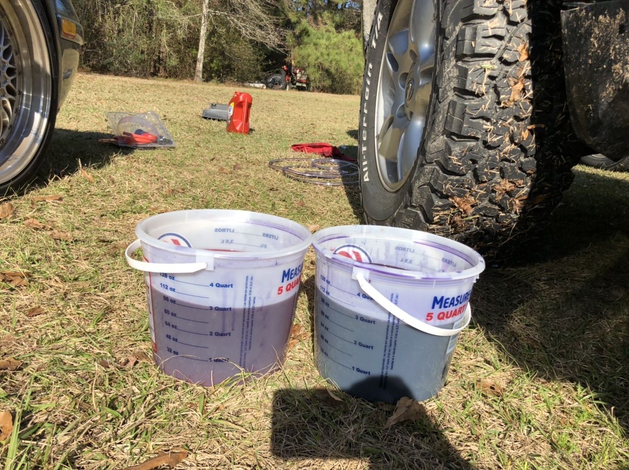

Flushed the tranny. I watched a few YouTube videos of various ways to do it and made up my own.

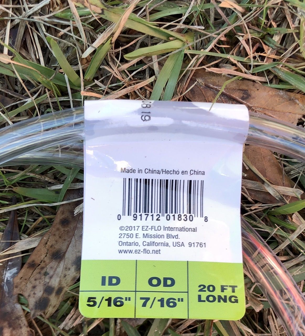

7/16” OD tubing from a hardware store, hand pump from Harbor Freight, and two paint buckets.
Pull the upper tranny cooler hose, insert tubing into hose, walk around to the driver’s door and set down a paint bucket, kneel down and hold hose in bucket while cranking Lexus under steering wheel, fill bucket until it spits then turn off Lexus. Fill second bucket with exact amount as first bucket and hand pump into open hose barb on tranny cooler. Let idle until primes good and run through gears. Be sure to 2nd start and stall the Tq converter some. Pump out and pump in as needed. I did 3qts two times and then did another 1.5qts to leave a little extra to top off if needed. Didn’t need it though. Used a laser temp reader on the tranny housing prior to pulling the full plug.

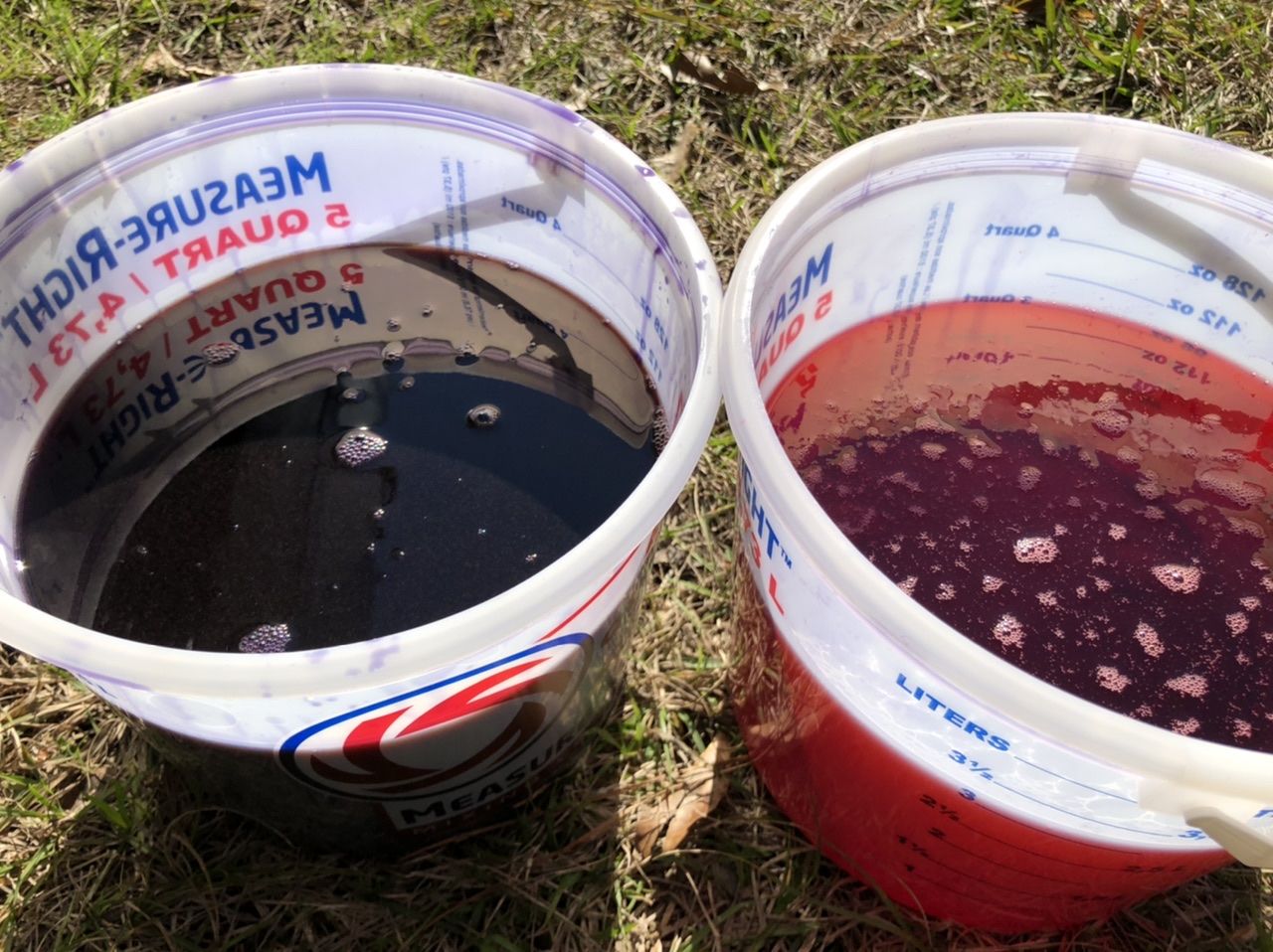

1 for 1 displacement and replacement.
First flush on left. New on right.
Hose used.
Last flush looked good in the tubing.
