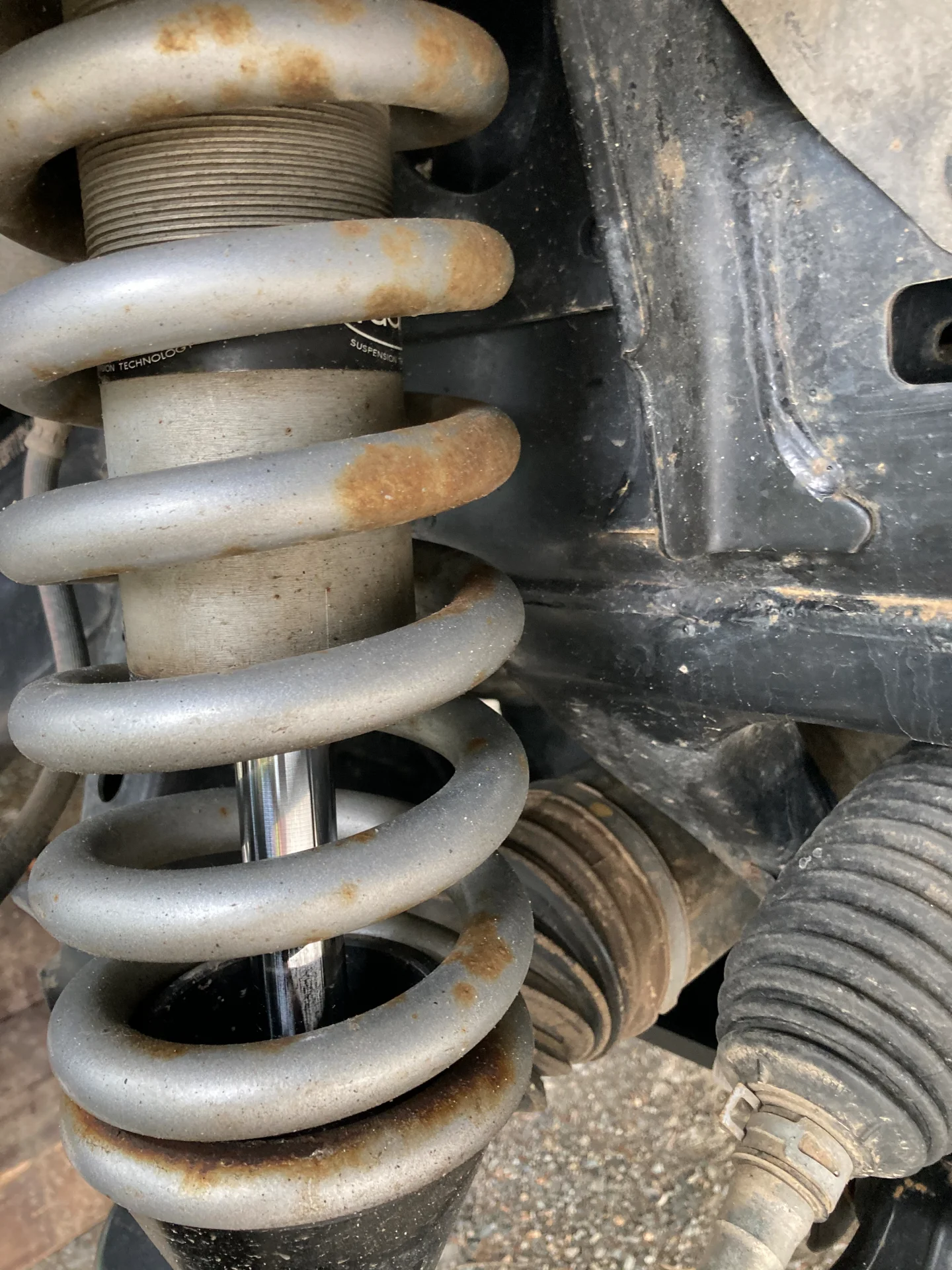

I've been running a CA/NV 2013 GX 460 (65K miles), and installed a Radflo coilover 2.5 in Dec 2019. This spring I started to hear occasional creaking from suspension over mild road undulations... and some months later it is a steady loud creaking sound over any irregularities in paved surface (and off-road, but still seems to function fine).
The only references I can find in search are on T4R sites with reviewing torque specs on key attachment points (and reviewing skid plate attachment - I've had RCI skid plate on and off with similar noises).
There does seem some unusual surface rust on the Radflo (Eibach) springs as pictured. (18months after install in PNW - wet low/ no salt on roads).
I'm due to have a heavier spring installed (700#) so will have it up on a lift with general mechanic (not a Toyota suspension specialist).
Does anyone have any experience with similar creaking or have a suggestion on what to dig into first?

The rust you pointed out would never cause any kind of noise. Rust will just continue to remove material until it fails and/or fuse components together (nuts to bolts).
