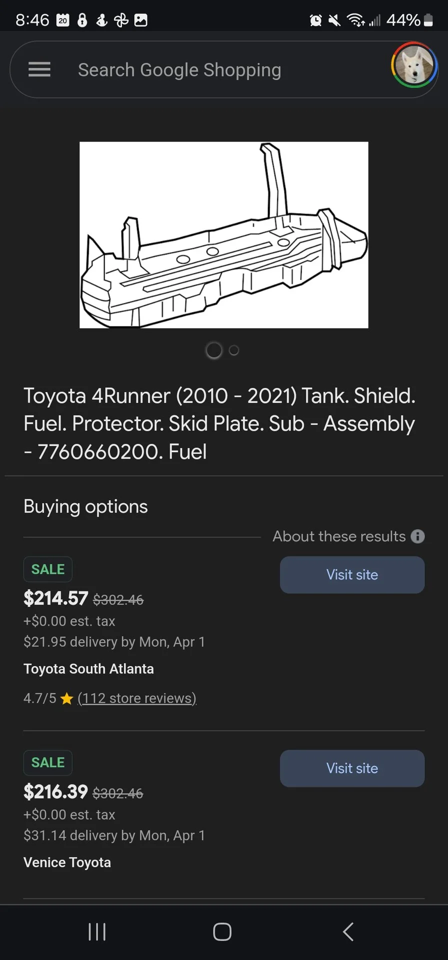

Could you share that skid plate part number? I've beat up my half tank one and don't really want to add the RCI tank skid.
keep an eye out on FB marketplace, lots of 4runner owners upgrading their armor. I managed to pick one up for $50
I think this is it?
Yea, I think I found the half skid. Was only 8 lbs.

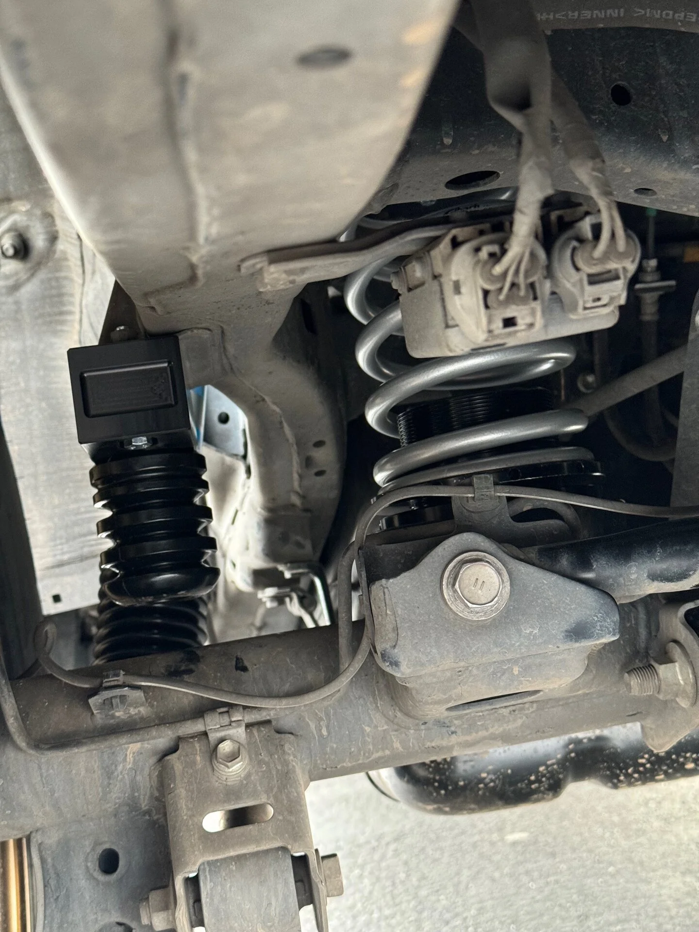

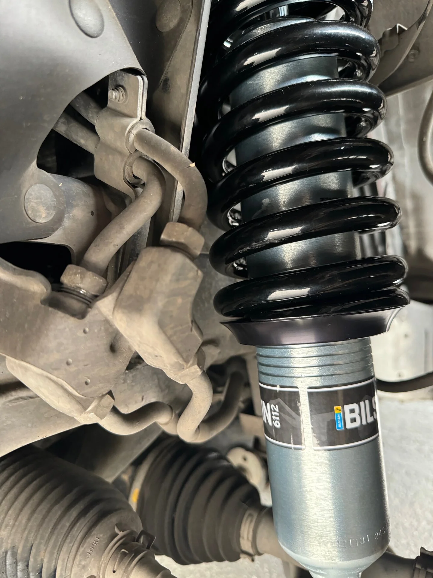

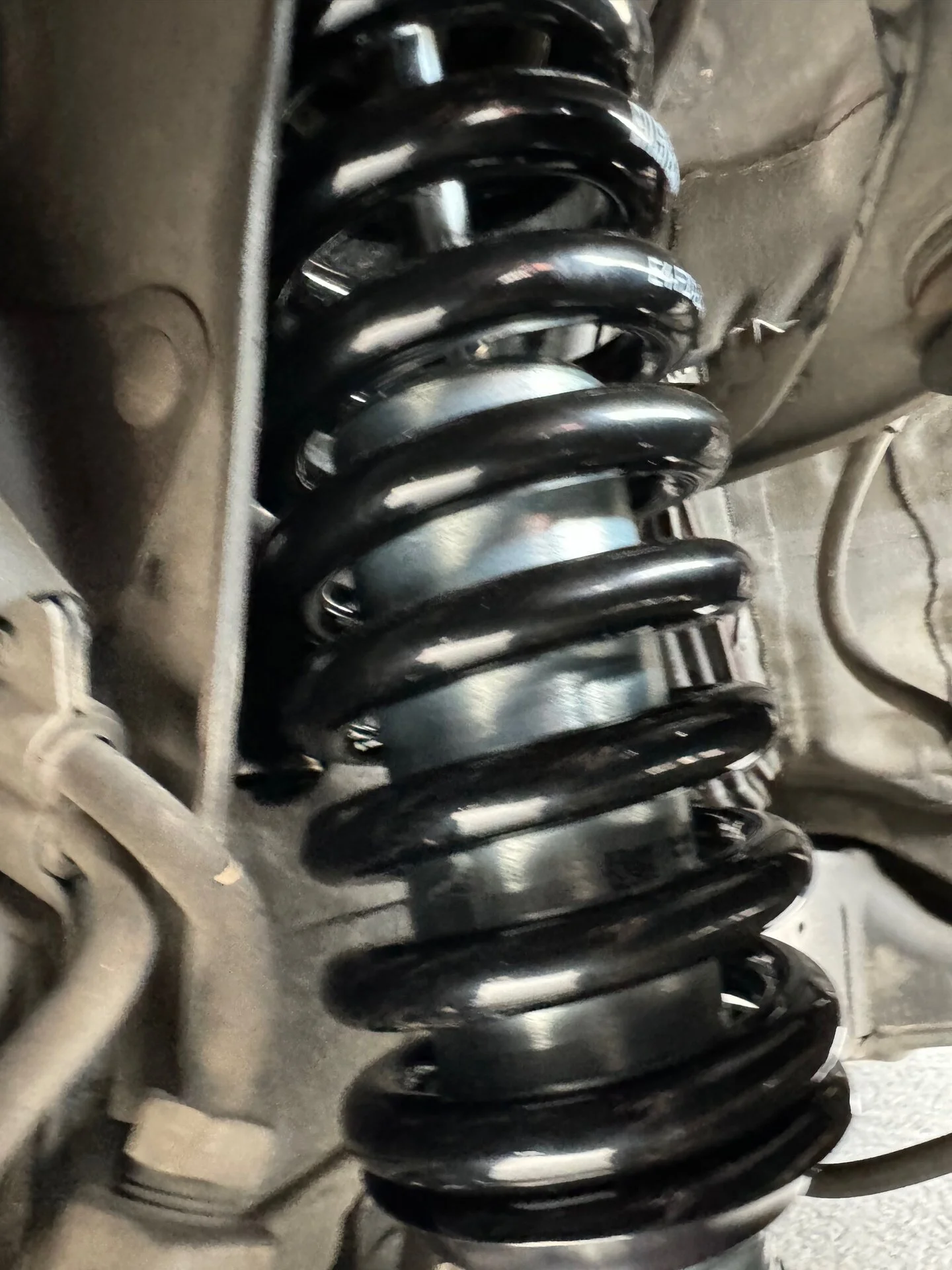

I picked the GX up yesterday from Wescott Design; they handled the installation and alignment and did a great job. I bought Billstien 6112s up front and 5110s for the rear. Standard weight Billstien spring up front with an Eibach load leveling kit in the back complete with new progress bumstops.
The truck now sits 22" up front and 22.5" in the rear from the center cap to the bottom of the fender before lift, measurements were 20.25" front and 21.25 rear.
80,300 miles and ready for some light trail duty.
Should be the perfect amount of extra lift in the rear for when you load it down it'll level out.
