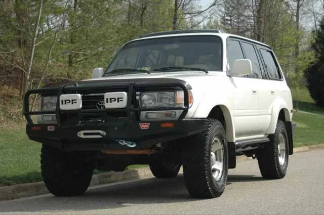

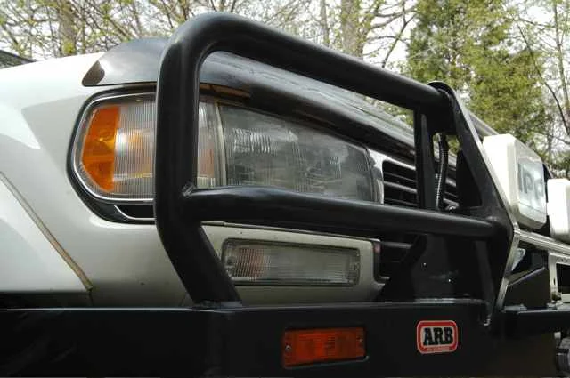

I have built my truck up over the last two years and I know it will never end. It all started when my front bumper got ripped off one night in DC and I put the ARB on. Then I had to add the lights and everything else just kind of followed.

ARB front bumper
OME 2.5 heavies up front and mediums in the rear

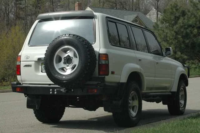

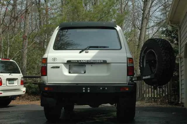

TJM rear bumper w/ swingout tire carrier

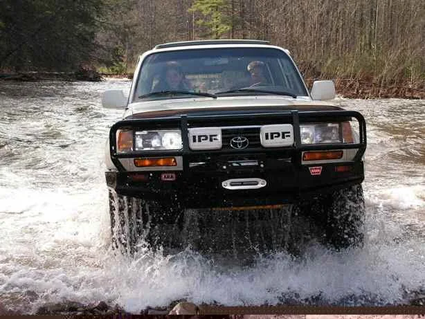

Warn xd9000 winch w/ synthetic line

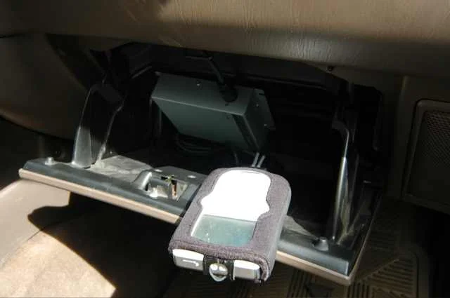

Alpine head unit w/ iPod in the glove box

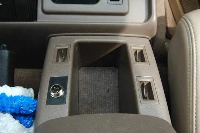

cb mounting
I think all cbs look bad no matter where they are, so I wanted mine out of sight. I also put an external speaker under the driver seat so I can hear the cb with my music on.

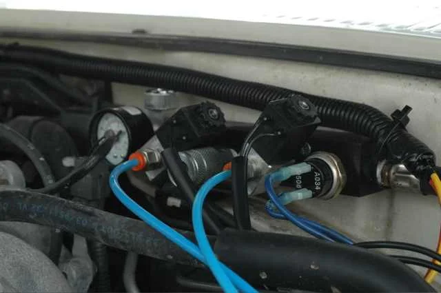

diff lock switch...
I wanted to keep the OEM look as much as possible so I had my ARBs retrofitted to the OEM switch. I didnt want an ugly ARB switch for my compressor so I bought a rear defroster switch that controls it to keep the factory look.

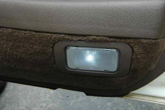

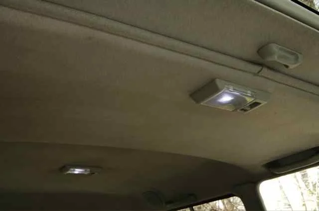

Leds
I was looking around at putting LEDs in the truck and I came across www.autolumination.com They were cheap which was a plus, I a figured that I would give them a whirl. I like them a lot in the door and the overheads are nice but not as bright as George's. Considering I outfitted the entire truck for the cost of one of George's I cant really complain right now.

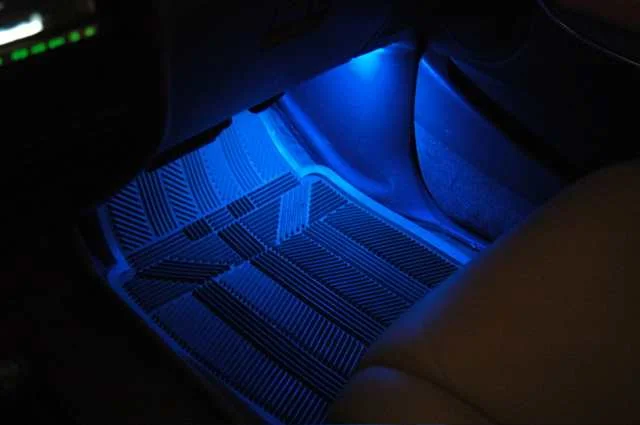

Foot well lights.
Because I drop stuff all of the time I decided I needed some extra lighting down there. I went to radio shack, got a switch and some $5 lights off of eBay shipped. Rates real high on the bling scale but very functional at night.

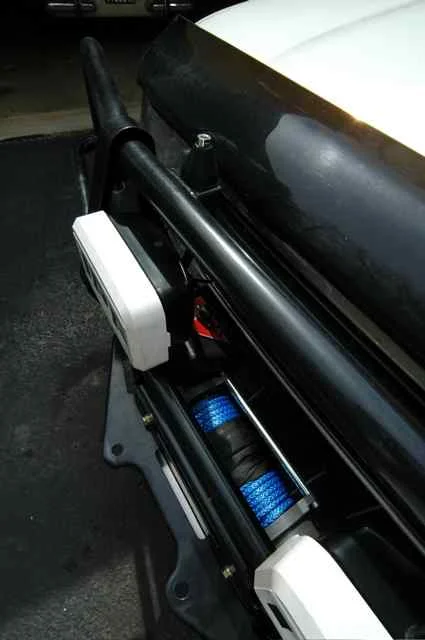

How do you like your winch (do you wish you went larger?) and what did you do to modify the ARB for the synthetic line?

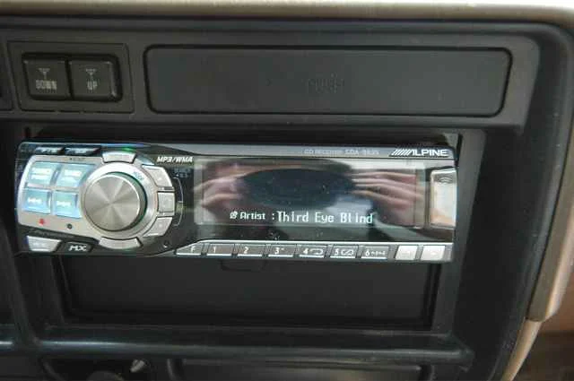

But one thing is bothering me about it. . .
Third Eye Blind?!?! :D
:cheers:
Thanks for the kind words. I bought a Marlin Crawler Hawse fairlead and that is it. I am thinking about chopping the roller fairlead guide off but cant make up my mind yet.
I also think 9k was the right choice and figure that and a snatch block will get me out of anything that I am going to get into. If not, I hope im wheeling with reffug and his 12k
