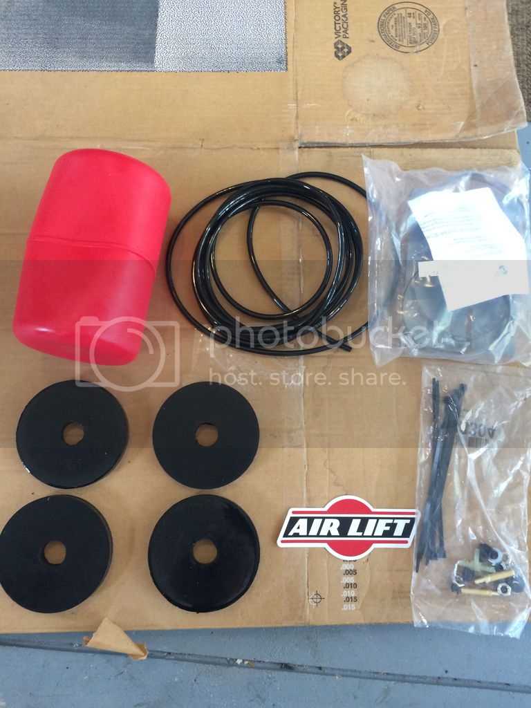

I received the kit a few days later.

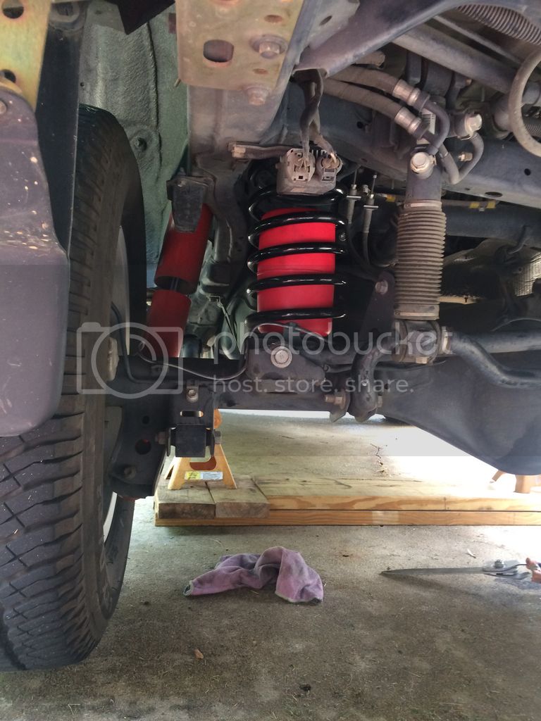

I installed it in the simplest way - no electronic sensors or compressors, just a schrader valve on the bumper, a single air line to the axle, then a T-fitting, and up through the bottom of the spring mounts.
First I jacked the truck up by the body until the rear wheels were off the ground, then jack stands.
Next, I rolled the bags and stuffed them into the inside of the springs. I didn't need to pull the springs or anything like that - quick install.
I only used two of the four black "spacers;" I put them on the bottom of each bag to protect the fitting on the bag that connects to the lines.
Finally, I ran the hoses from the bags, to axle, to underbody, then to rear bumper.
Air Lift recommends you put 20 psi over night to check for leaks; if it holds you are good, if it looses pressure check for leaks. I took my time with the fittings and didn't have leaks.
