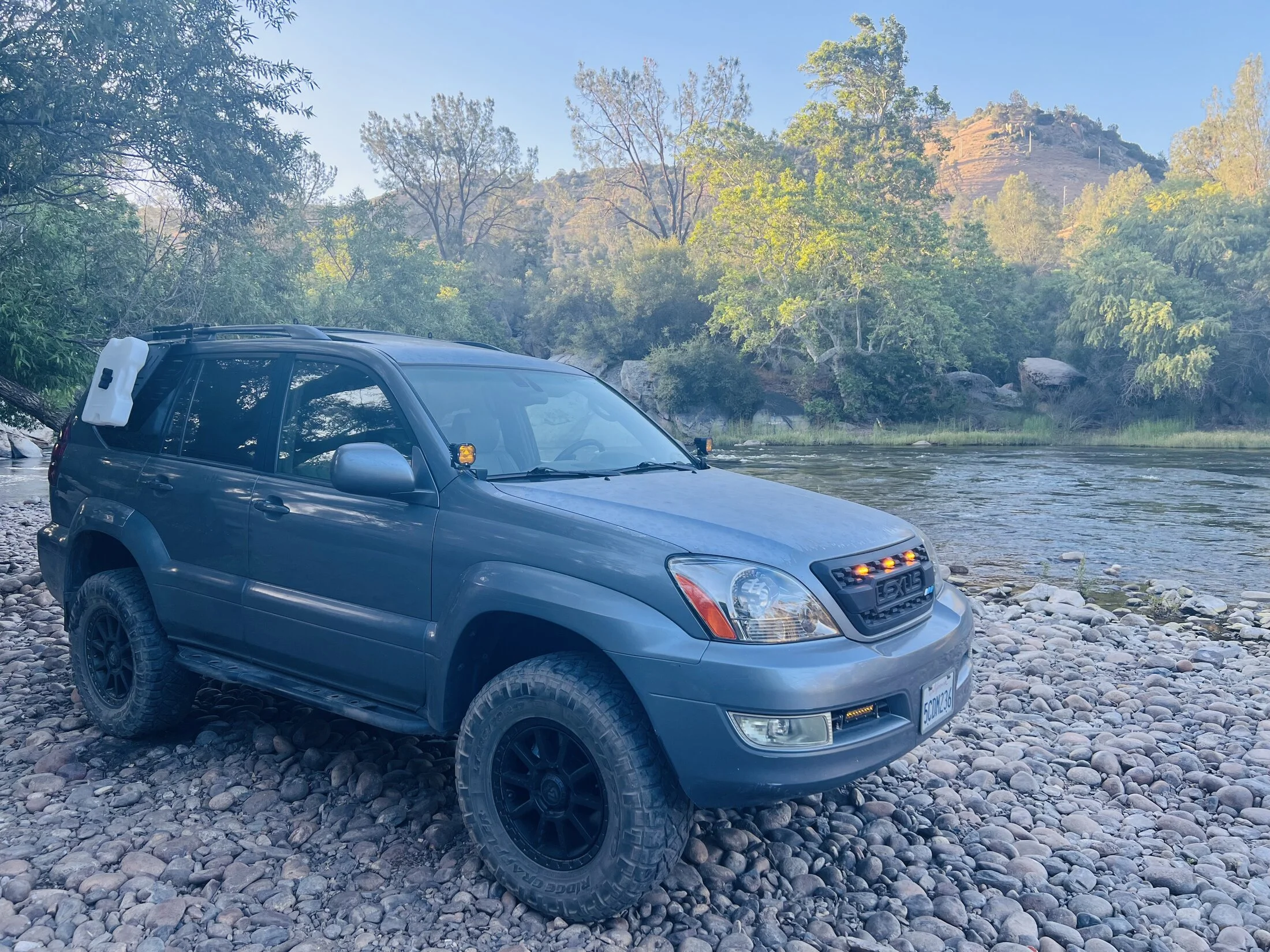

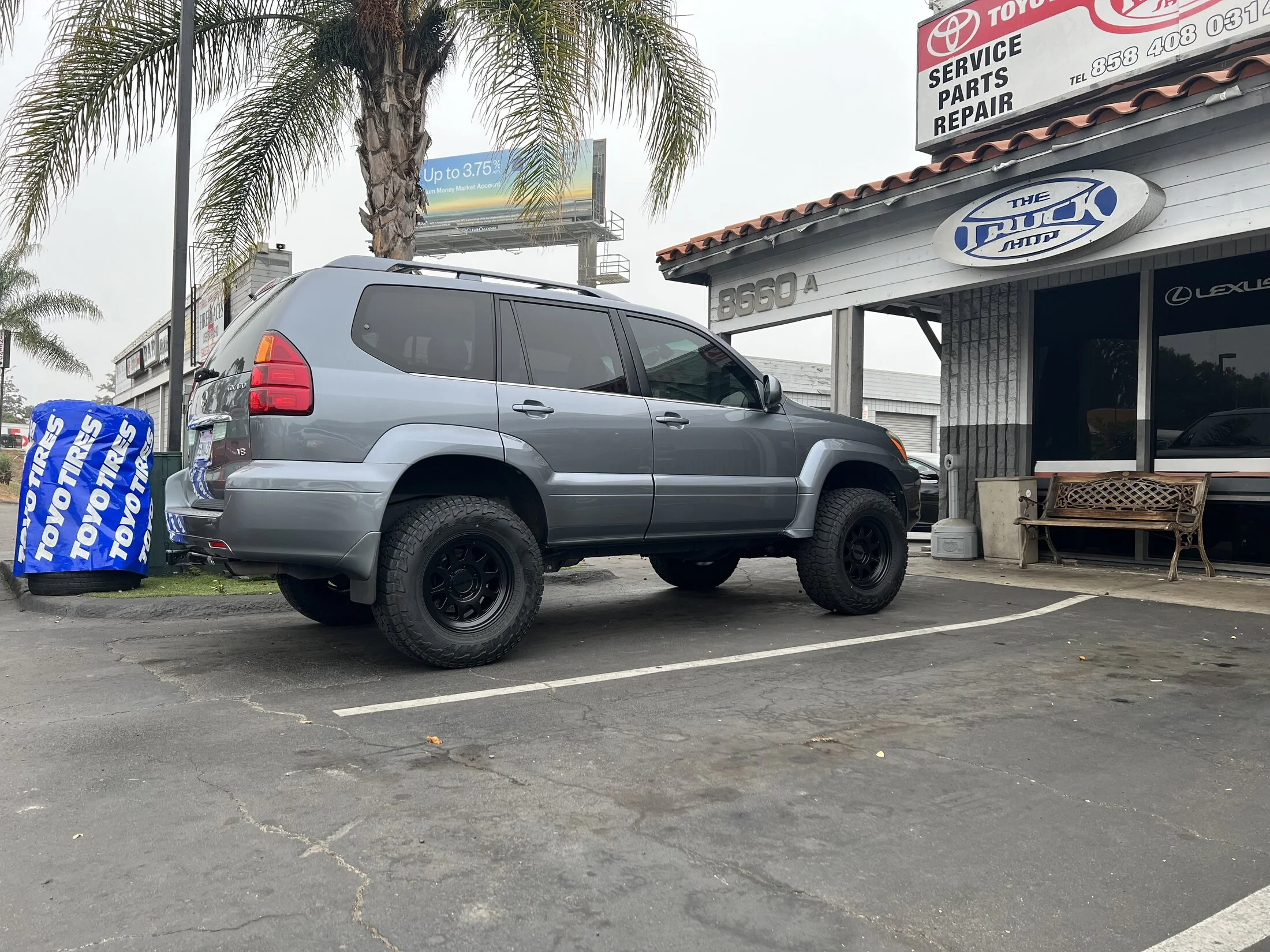

I’m also on 33s (285/70R17 Nitto Ridge Grapplers) with 6112s upfront and ICON 56550 LT rear shocks with Dobinson C59-675V coils.
No BMC. Stock front bumper.
3.7* caster with TC UCAs and stock LCAs.
17x7.5 zero offset Foxtrot
Wheels
I removed the front sway bar last year and the remaining rubbing went away. I have zero rubbing.
Caster, wheel width, and wheel offset play a bigger role in fitting 33s than a lift

No body mount chop. I'm on Method 17 x 8..5, 0 offset and Falken Wildpeak AT3W 285/70. Very little work with a heat gun on the liners was required. I really like the 6112/5160's. They firmed up the ride a bit, which is what I was looking to do. In fact I just put the same setup on my daughters 4th gen v8 4runner.
