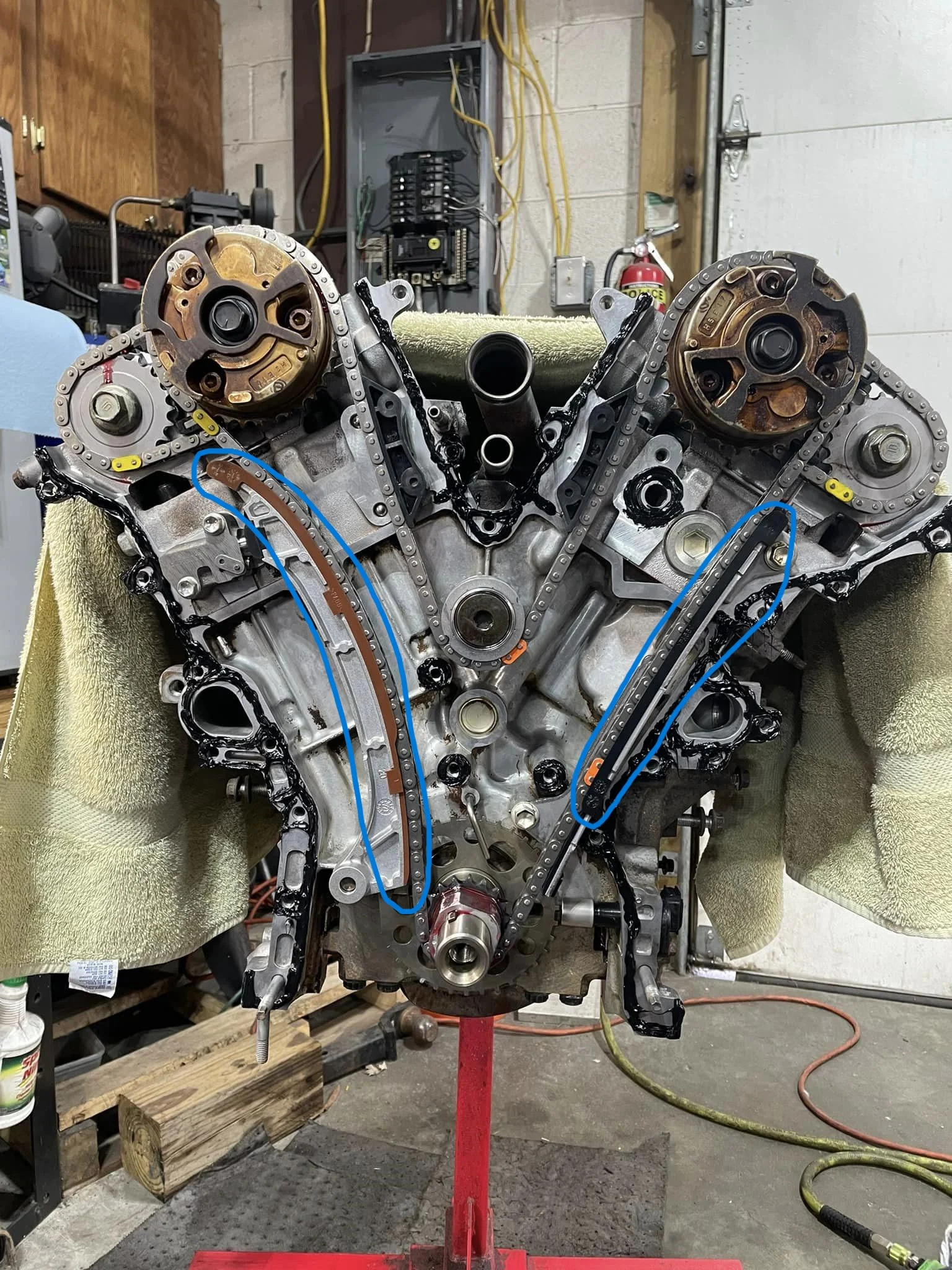

I'm at about 318K now. I've got a timing chain in my future, but only because I found a couple small bits of black plastic in the oil pan - plastic chain guide is breaking down.
Internet pic with brown and black guides circled.

Do you go about the service on these the same you would on a 22RE? I've always replaced the guides when I've had to dig into the front of the engine (water pumps, head gasket, etc.).
