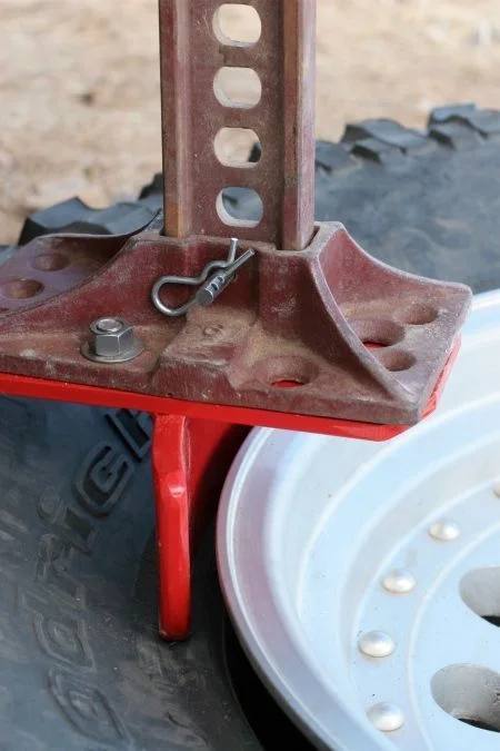

The Hi-lift bead breaker attachment is the way to go if you've got a hi-lift jack. I used it many times.

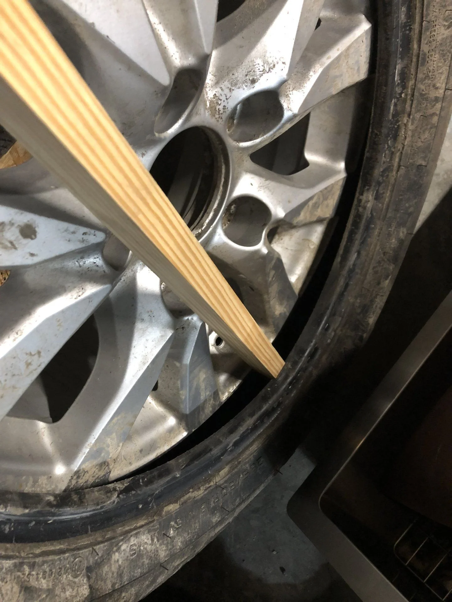

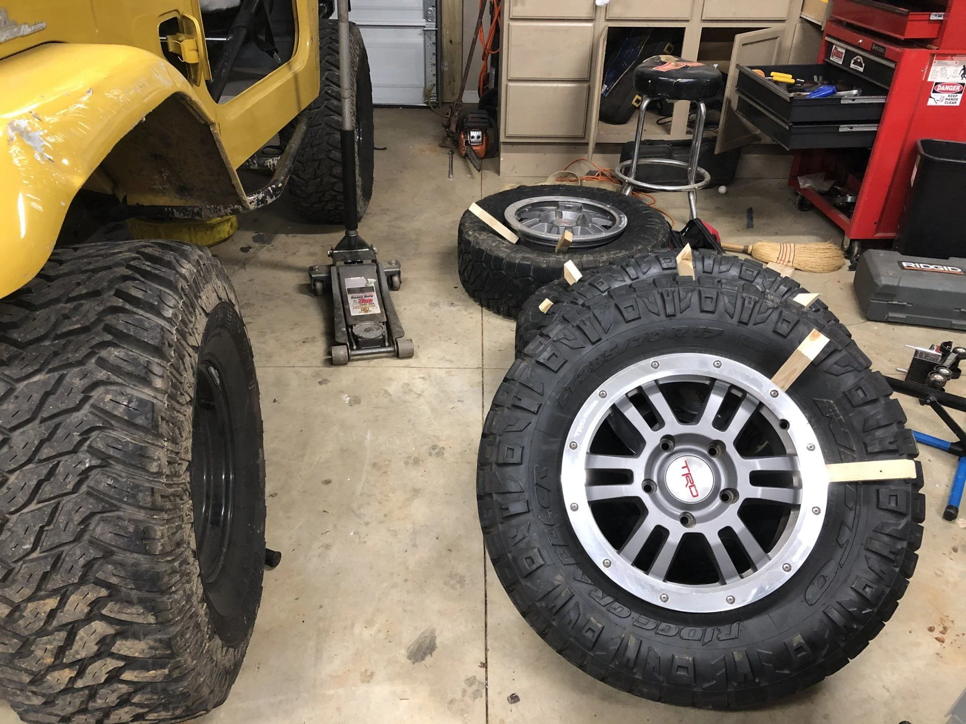

Also, specifically to work on TPMS sensors, I use a few blocks of 2x4 to hold the bead down between the bead and the rim, one on either side of the valve stem. So, break the bead with your lever, hold the bead down, put a block in, then let go with the lever. A block on either side of the sensor should let you sneak them out.

Just adding to this thread, if you have a hydraulic floor jack and a ratchet strap, there is another way that worked well for me. Another member posted a video of it. You basically lash the tire/rim securely to the jack with the jack pad on the tire rubber close to the edge of the rim. When you pump the jack up it presses against the tire and eventually pops the bead.
Also, I've never owned a hi-lift jack, since I've read all of the scary stories, but that bead breaker almost has me convinced to buy one now.
Did you find the bead breaker somewhere? I did a quick search and had trouble. Already have the hi-lift, but haven’t touched it since I did the v8 swap in my 80 so long ago.

. Maybe a good on trail option. The jack and ratchet strap worked well, and felt relatively safe.
