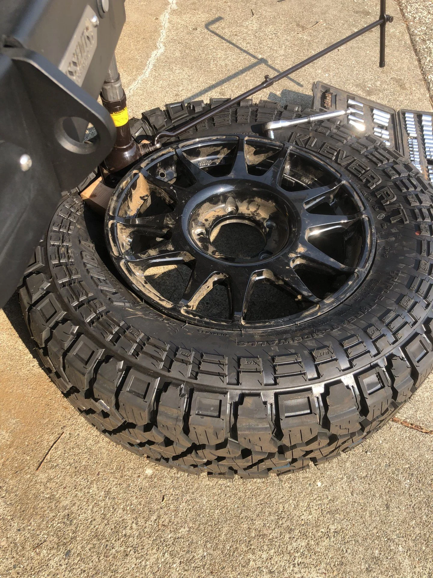

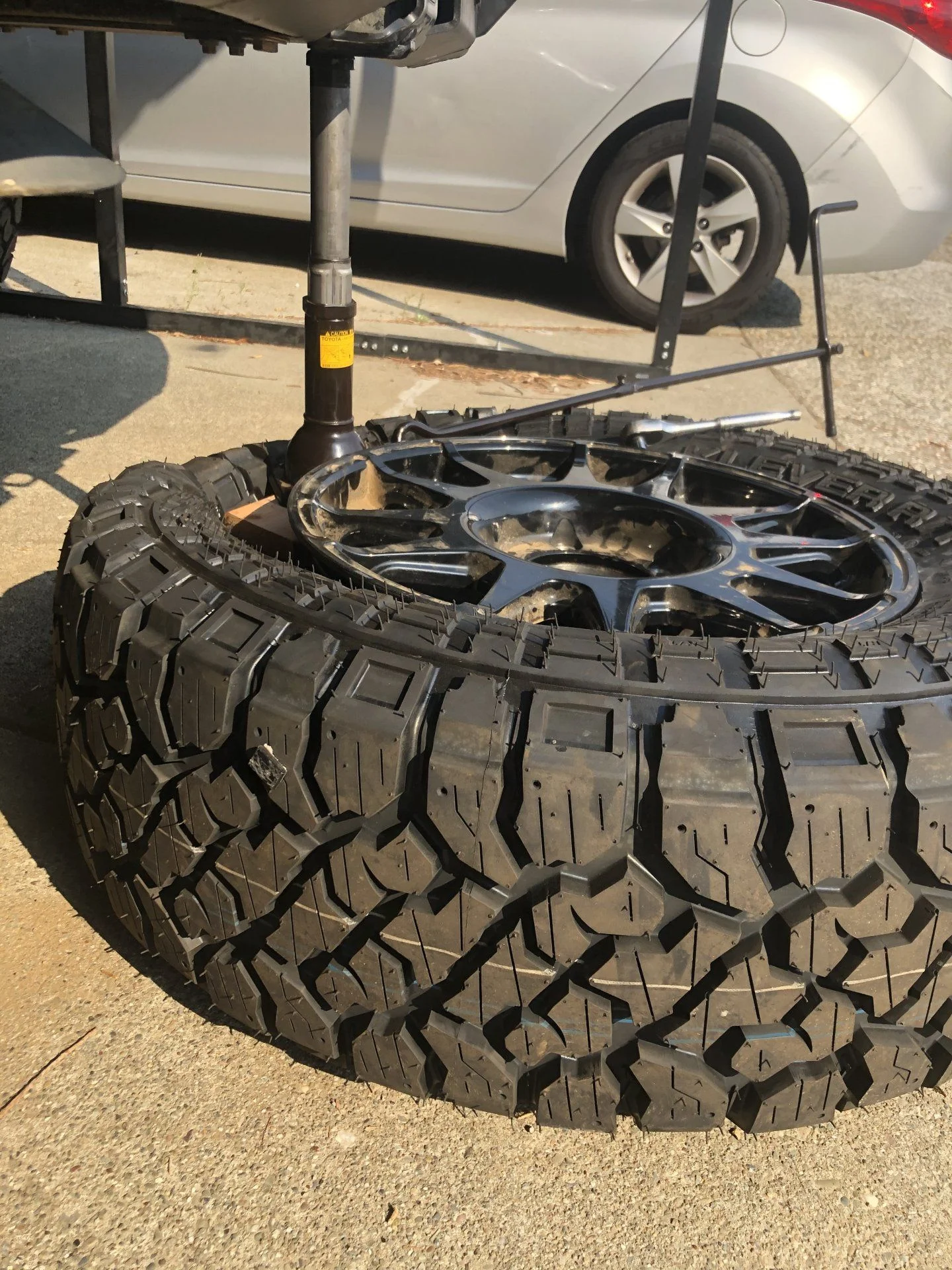

I had success using the Factory bottle jack to break the bead. I have dissent bumpers so the tow hitch is exposed and Is to apply downward pressure on the bottle jack and sidewall. I started by removing the valve core to deflate the tire. Info is in this post:
I used a softener to eliminate the metal on metal between the jack and tow hitch and also used a piece of 2x4 to distribute the pressure on the tires side wall. Make sure you don’t break the bead too close to the valve stem or you will snap off the sensor inside the wheel, royal PIA to fish out.

Here are a couple pictures of my process
I've done the Hilift trick with a friend on the trail, stick the snout of the jack into your trailer hitch receiver so it can't fly away from you. It's surprising effective, just be careful. Much safer if you can get someone to help you steady the Hilift while you pump the handle.

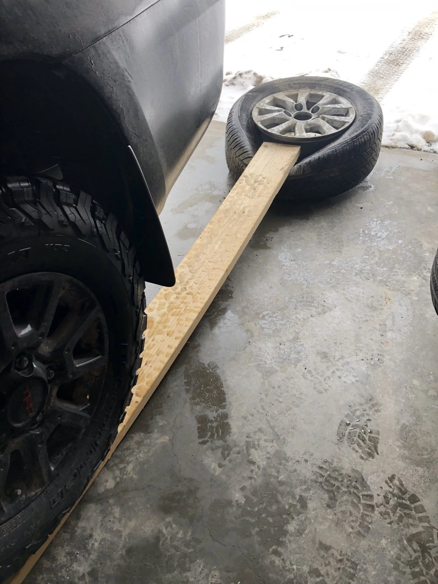

I tested these ideas on the spare. I'm guessing this is an original spare (Dunlop Grantrek) since it doesn't match the other four tires. The tire was ON THERE good.
Sledge - failed. Jack under trailer hitch - failed. High lift - don't have one to try.
What I got to work was a 2x10 used as a ramp backing the cruiser up onto it. I had to get the 200 nearly on top of it before the bead let go.
So the upside is that I broke the bead. The downside is that I had the board too close to the sensor and I snapped off the TPMS.

Nice job. Thanks for sharing the pic. Did you remove that valve core from the stem ?

Is your picture a good representation of the Position we should look for?
Alternate idea: use the truck on a 2x10 to break the bead 180 degrees from the sensor, then use the factory jack to more precisely push the tire down in the spot needed to do the work? Any issues with this method?

Yes, I removed the valve core and let all the air out before doing anything else. Not exactly what I was hoping for, but I learned a thing or two.
I would recommend against the position I used, so close to the TPMS sensor. Your idea sounds like a much better approach - breaking it 180 degrees from the sensor would have most likely preserved the sensor.
When the bead let go on this one, it let go all around fairly dramatically. Once it was broken loose, I could manually press down on any spot on the circumference, so I could have easily removed the sensor at that time.
In the past, using a manual lever based bead breaker, I've had them require popping the bead in multiple spots around the rim before it'd break the circumference loose. I guess the mass of land cruiser has a different result.
Yes, your idea sounds like a much better approach - breaking it 180 degrees from the sensor would have most likely preserved the sensor.
It also might be different on account of your spare tire being a P-metric road oriented tire with a very thin tread surface that can fold easily. Anything LT or AT/MT would have a much stiffer sidewall and tread area.. it would probably let go more gradually.
Plus, you had a ton of weight on that board, and the ground being the only restriction on how far it could go once the bead started to break. With a jack or bead breaker you are only moving small amounts.
