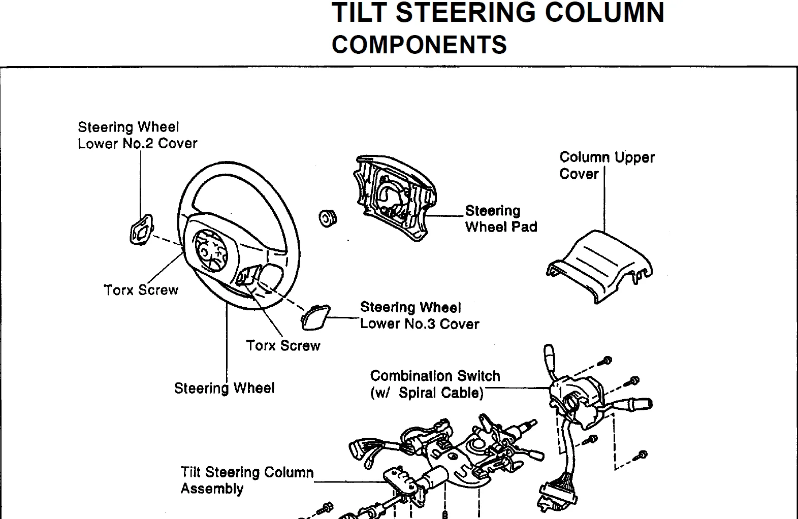

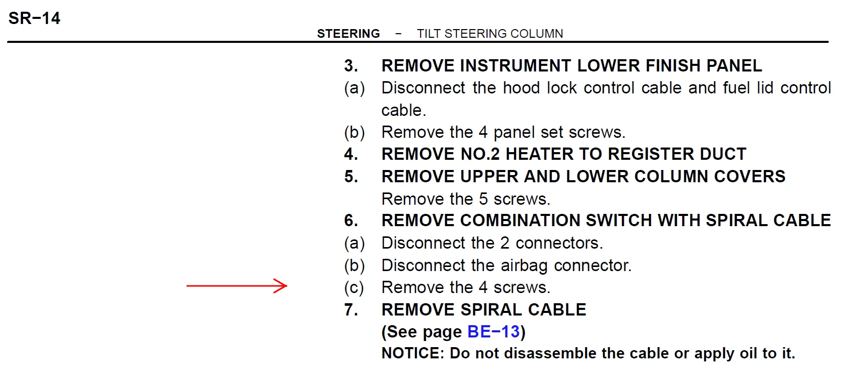

I couldn't see the screws in a quick look, so after marking the 12 o'clock position with a paint pen, I popped the steering wheel off and removed the four screws holding the switch assembly in place, then removed it from the shaft to se what I was working with.

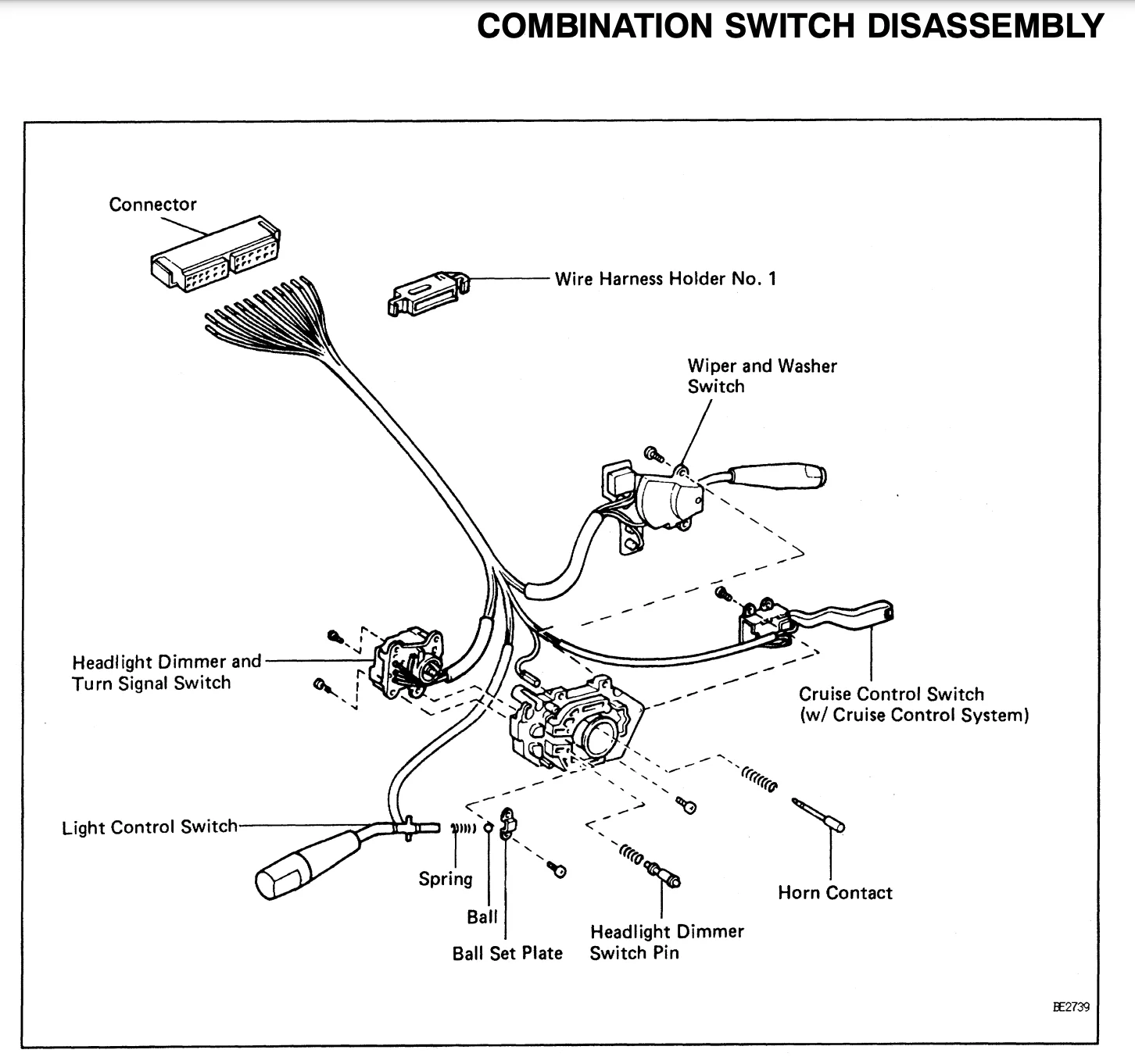

There are two philips head screws on the back that hold the cruise stalk on the assembly for the other switches. Once removed, the cruise control switch was free.
However... it is still attached to the wiring harness. I traced the wire bundle under the wheel to a connector that looks like it is shared with other wires. I couldn't easily see how to release the connector, so I left it alone until I do some more research (or someone here shares a tip).
It looks like I need to unplug that connector, and depin the cruise control wires, but that's just a guess.

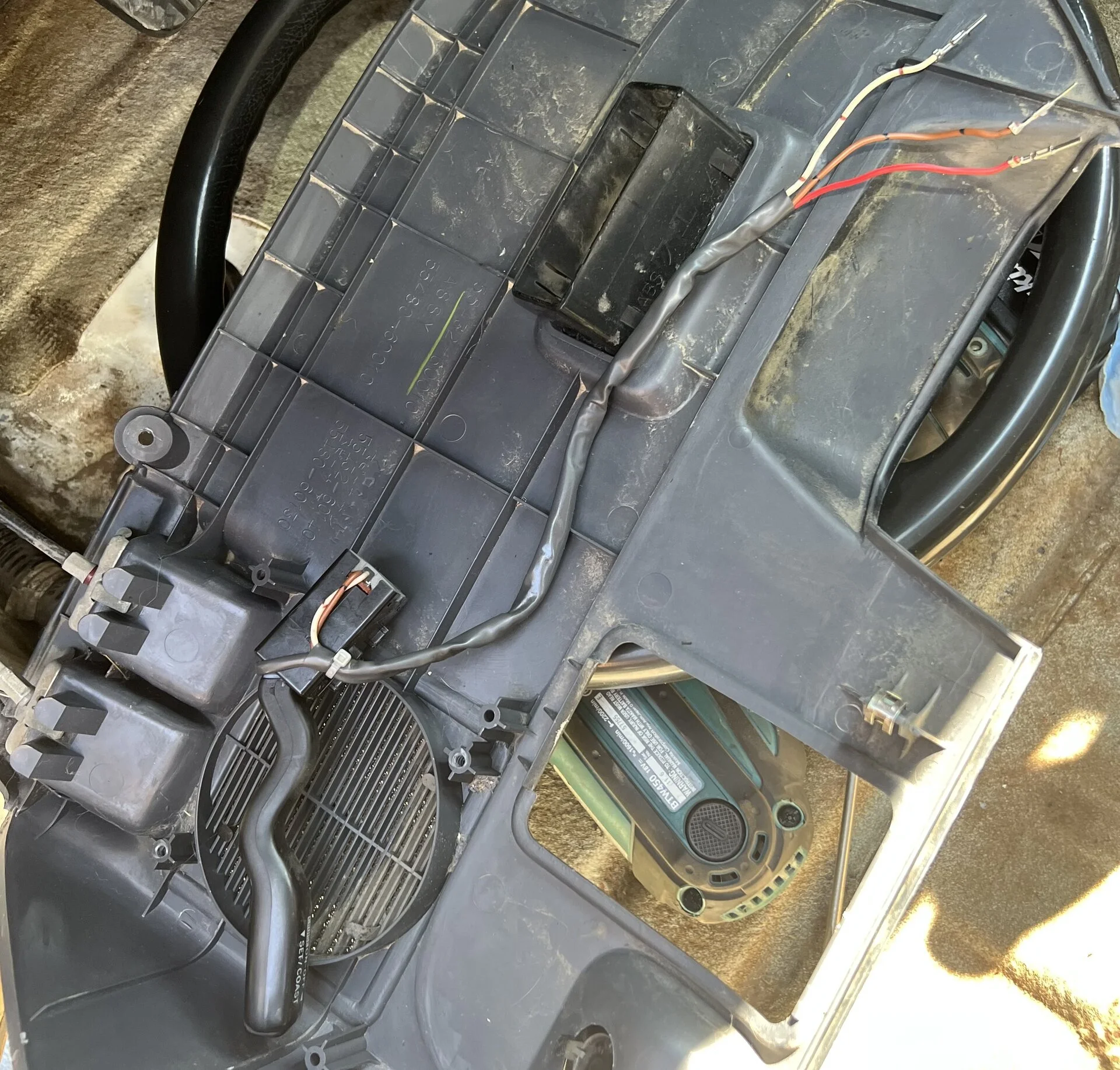

Just got it off.
For ease of access, I removed the trim panel below the steering wheel.

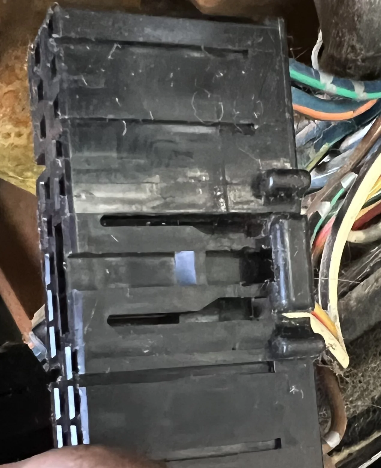

The combination switch has two connectors plugged into the back of it, with the standard push to release tabs.
Then remove the combo switch connector from two metal tabs on the column assembly by pulling straight downward (no force required).

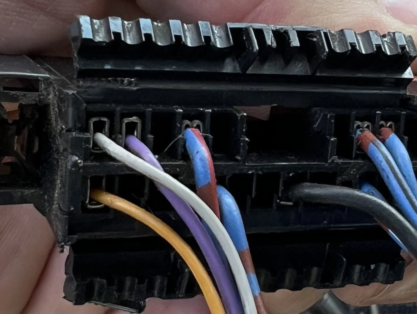

De-pin the three cruise wires. Flip the two locking bars up (as shown in the FSM) and insert a depinning tool from the pin side while pulling gently on the wire. Flip the locking bars closed.
