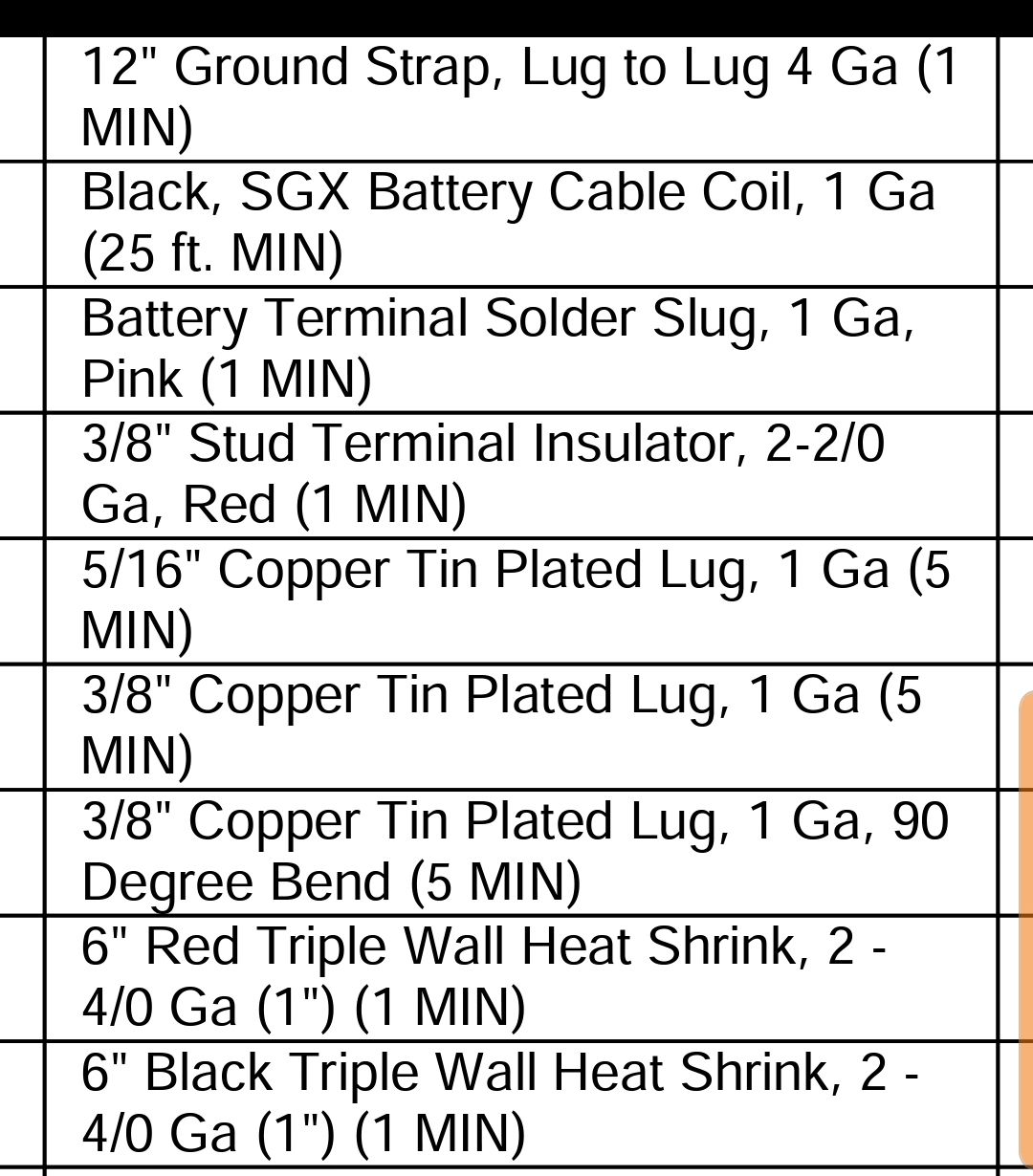

I just replaced my engine block ground cable and starter cable. The stock gauge for those two are 2Ga, but I bumped both of them up to 1Ga and put in military style battery terminals.
Del City is the place to get electrical components. Welding cable is definitely affordable, but it's insulation is not designed to withstand the heat and fluids for automotive applications. SGX cable has a more durable insulation designed for automotive applications. The caveat is that SGX cable is not very flexible.
Here's a screenshot of the items I ordered from Del City:

I picked up soldering lugs, but didn't end up using them. I just crimped the lugs to the cables with a hammer lug crimper (about $20 on Amazon).

Thank you very much for the detailed reply! It will sure save me a couple of trips to the hardware store looking for lugs.
