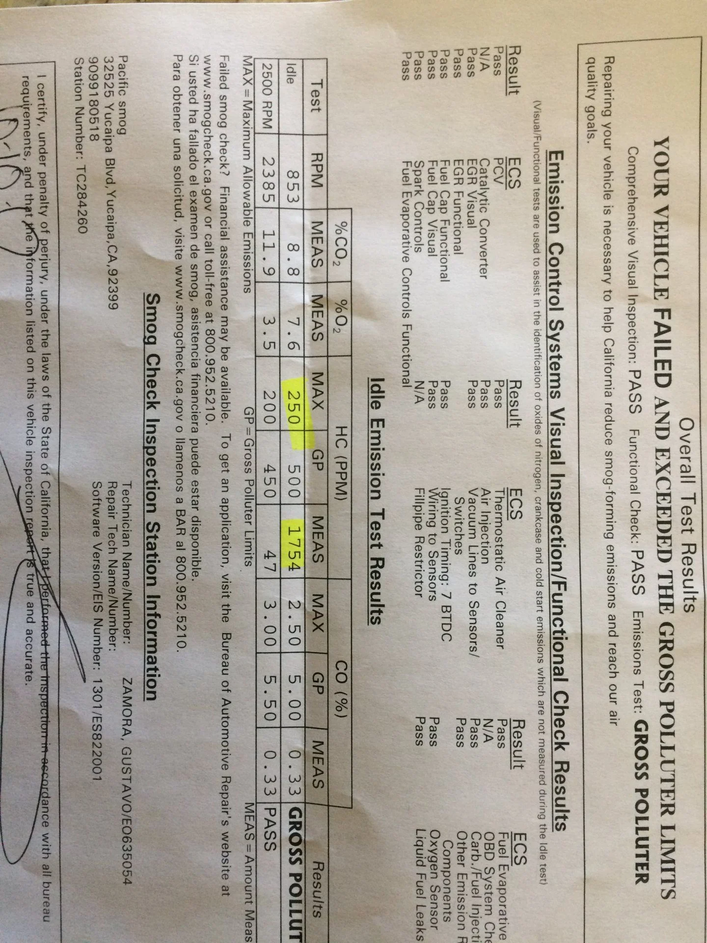

Hi guys, it’s me AGAIN... in short, my smog check failed for high HC at idle (see pic). Prior to test I did a major tuneup consisting of carb rebuild, points, plugs, rotor, cap, vacuum lines and timing. I just did a compression test and the results are as follows: #1-120, #2-125, #3-110, #4-125, #5-118, 6-118.
I’ve readjusted (lowered) the idle mixture and set idle at just below 800 (will not idle any lower). Oh, did I mention that I had to buy and install ALL of the smog equipment as it had none? Any ideas on how to lower the HC at idle? I’m going to recheck my valve adjustment to see if that has any impact on #3 compression. Thanks

Hydrocarbon HC comes from misfiring or a leaky exhaust valve. Your measured level is way too high for the air injection system to deal with (even if you had a catalyst). Misfiring at idle is often due to lack of idle fuel or a manifold vacuum leak. 853 RPM is not idling and it should not have been tested at that high. The tech can adjust the idle speed. Maybe it won't run at 650 RPM, in which case start looking for vacuum leaks and plugged idle circuit.
Thanks I’ll look into that. If a valve(s) is either too tight or too loose, would proper adjustment have any impact on HC and/or compression?
Latest update... did a vacuum test with steady reading of 12 ( I’m at 3000’). Checked for vacuum leaks...all good. Checked my most recent valve adjustment... no bueno... too tight. Did a readjustment using the proper measurement this time and.... holy molly, what a difference that makes. Also I advanced timing a few degrees. As a result, engine smoothed out, I was able to adjust idle to specs, and....can start the beast without using the choke. I have no idea if it solved my HC issue but I bought myself another year by keeping it registered in AZ
