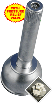

I see some concern regarding grease getting into the diff...we use PRV's or breather tubes instead of the square nuts, the tube mounts can be drilled thru the inner fenders or tied in at your discretion.
PRV's or tubes will eliminate your concern about pressurising the knuckle cavity. We use the systems only to ensure that grease in the knuckles and is visual.
Squash: do you have the details on the type Pressure Release Valve's (PRV's) that you use; model, size/thread(?3/8-19 British Standard Pipe Tapered??) manufacturer, what psi they open at?? Any photos of the PRV or how you connect a breather tube to the inspection/fill port?

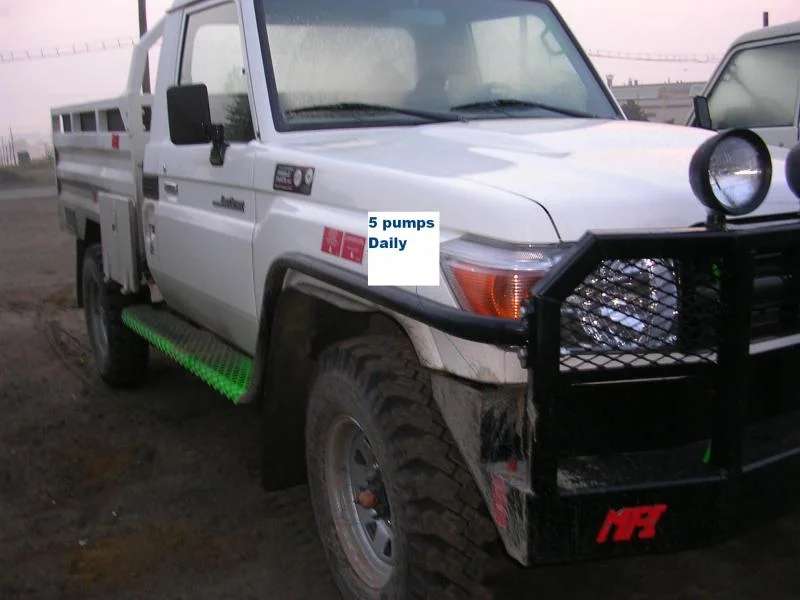

The PRV's come from Gearing Dynamics and replace the square nut. If you cannot source a PRV you can always drill and tap the square nut, some use this tap for a zerk and others intall a tube, the choice is yours. Some units grease from the axle zerk as well as the square nut zerk as the picture illustrates, others use small battery powered programable greasing units the choice is yours.
I prrrefer pumping grease till it comes out of the PRV and trust me most cavities will take more than a couple of shots every oil change...
Note the HZJ79 for underground use, same systems as our 80's Lamacoids state 5 pumps of grease daily...
Squash; Do you know the size and thread type of the zerk fitting that truck in the photo has (it would have to be a long one) and how they attach it through the grease cap, just drill a hole in the grease cap and add a washer to seal it off??
You got it...a long zerk and grease cap with a hole and rubber grommet.
8mm thread ? or what evr you choose to tap.
I may have spare caps and zerks so fire of your address and I will try to send them to you.

You need a valve that is 3/8 x 19TPI BSPT (British Standard Pipe-Tapered).
The threaded inspection hole in the steering knuckle is 3/8 x 19 TPI BSP-T. There is a company, Gearing Dynamics in Australia, that sells the correct PRV, IIRC $70 for two and about the same amount to ship to the US.
I'm too cheap to get them from Oz.
I will just drill/tap the plug or make my own DIY adapter to thread into the knuckle.
Any idea what the pressure relief psi is on the Oz PRV? Do you have the Gearing Dynamics relief plug.
1-2 psi IIRC. Not sure if a PRV is absolutely needed unless maybe you plan on completely filling your knuckles like the mines do. I just add a few pumps of grease every few months +/- to make up for the slight amount of normal loss, been doing that for four years now, no problems.
