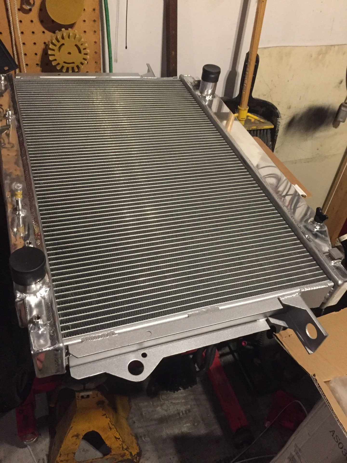

I recently had a good friend get a Ron Davis radiator. I love the idea know there potentially better cooling with thicker core and not the plastic 20+year old oem tanks. Ya I know oem is better but the potential better/additional cooling with my conversion is appealing. I resently left my steady 8-5 to start my own business and just can’t fly the Ron Davis price but needed to do something. After studying eBay options found that 4-5 manufactures sell through 30-40 venders. GPI seemed to have the majority of these vendors and had been around for some time. I spent hours with blown up pictures counting rods and trying to compare quality and decided to make an offer on an eBay GPI fj80 W/O trans cooler.

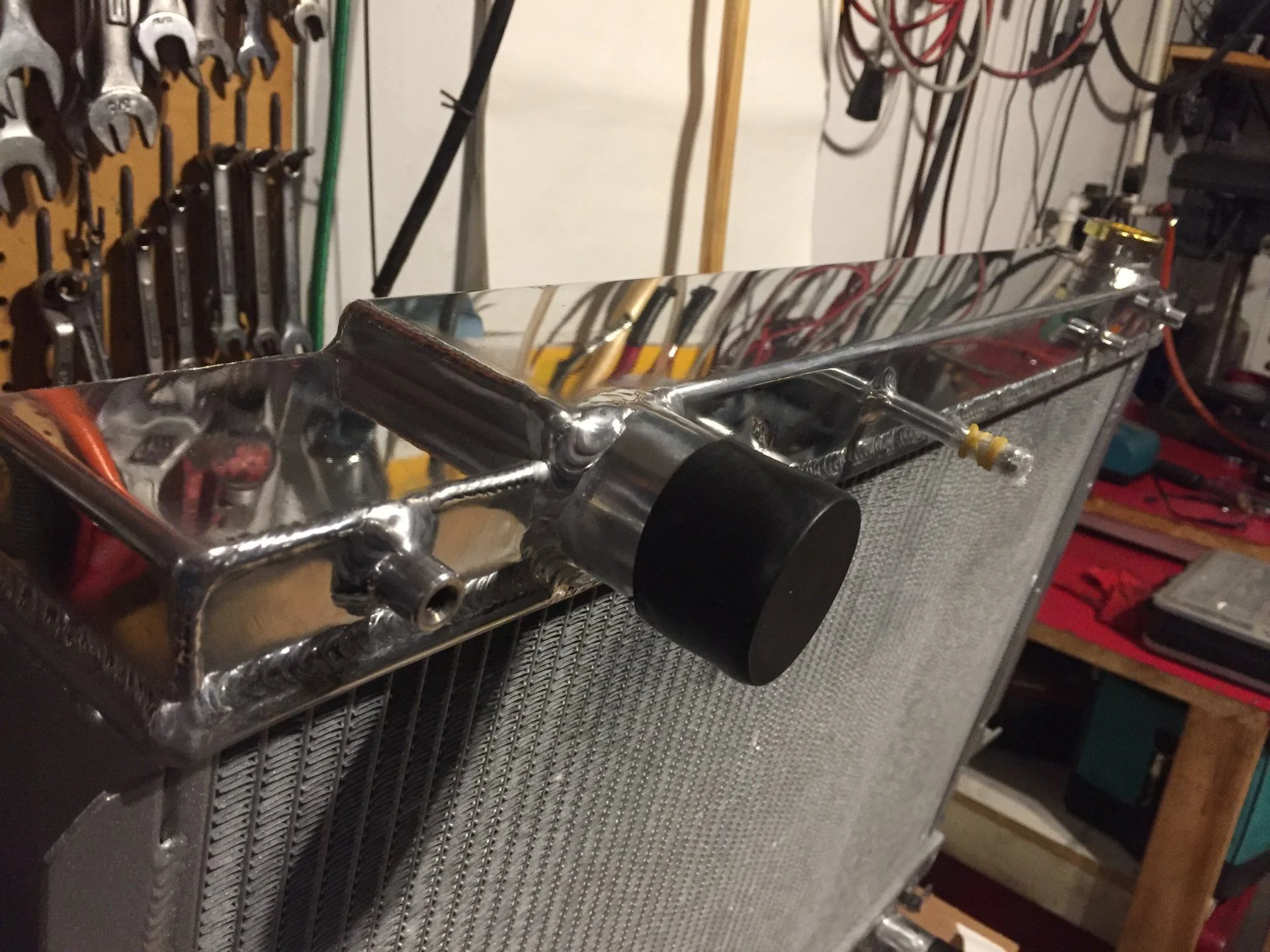

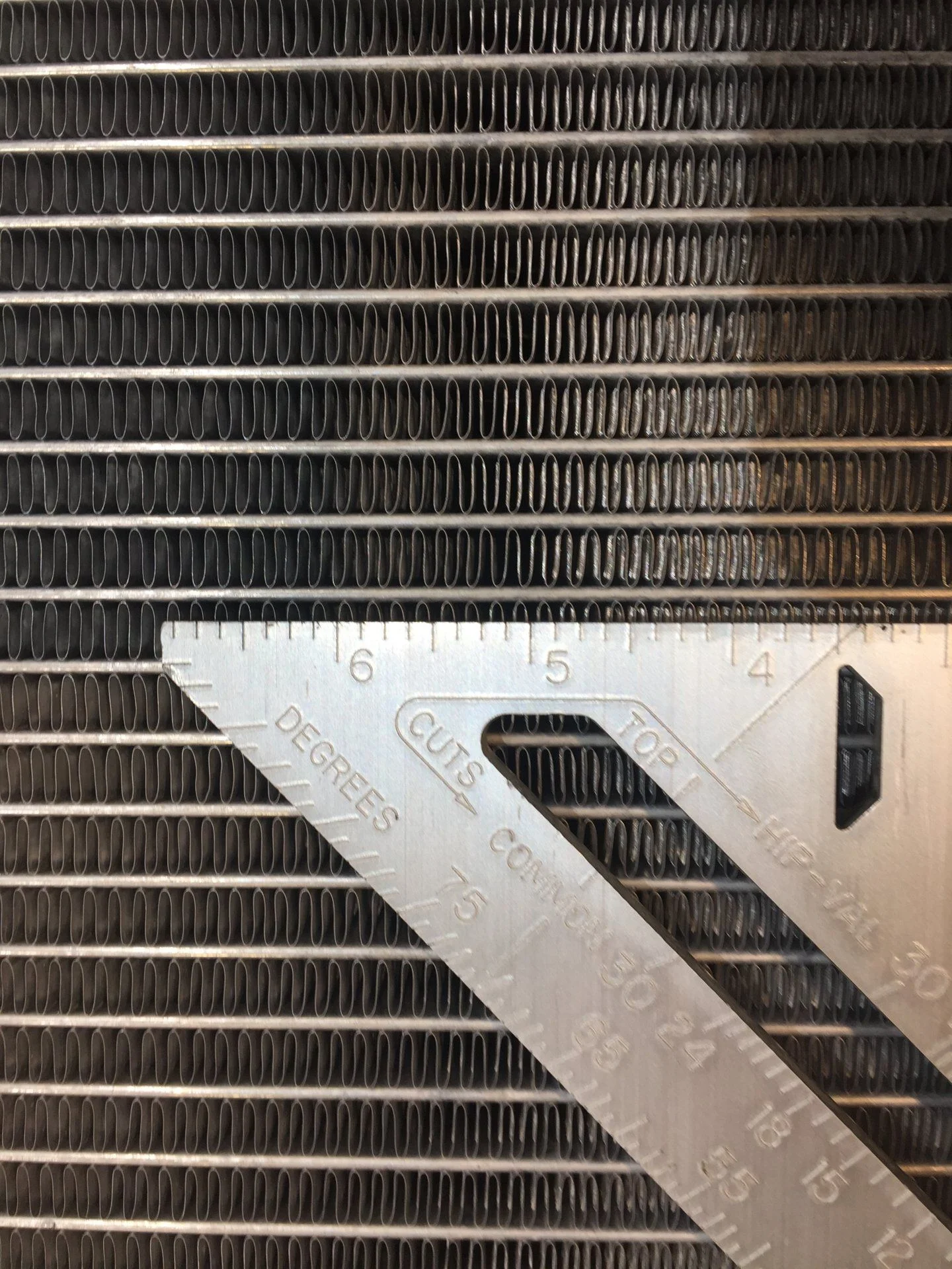

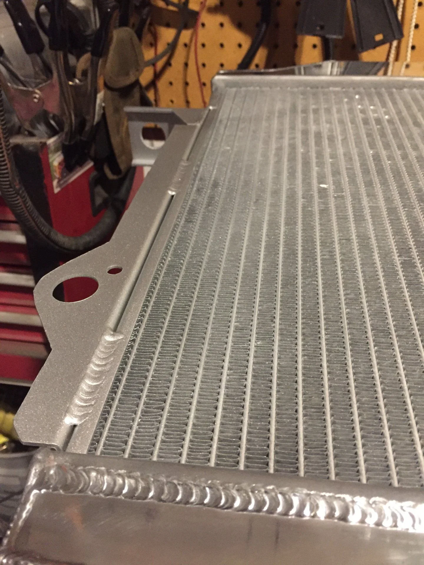

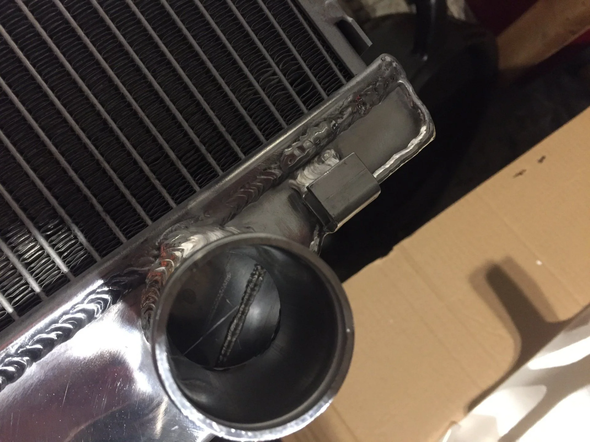

I was surprised with weld quality better than expected. Packing was nice lots of chiniese foam to protect. Lighter material than the Ron Davis but same 2 core 1” each. All of the eBay options had 67-72 rows in the 2 core options similar to oem, but thicker without knowing tube thickness . I took a gamble
Here are some pics and will try and get some side by sides with the better option.

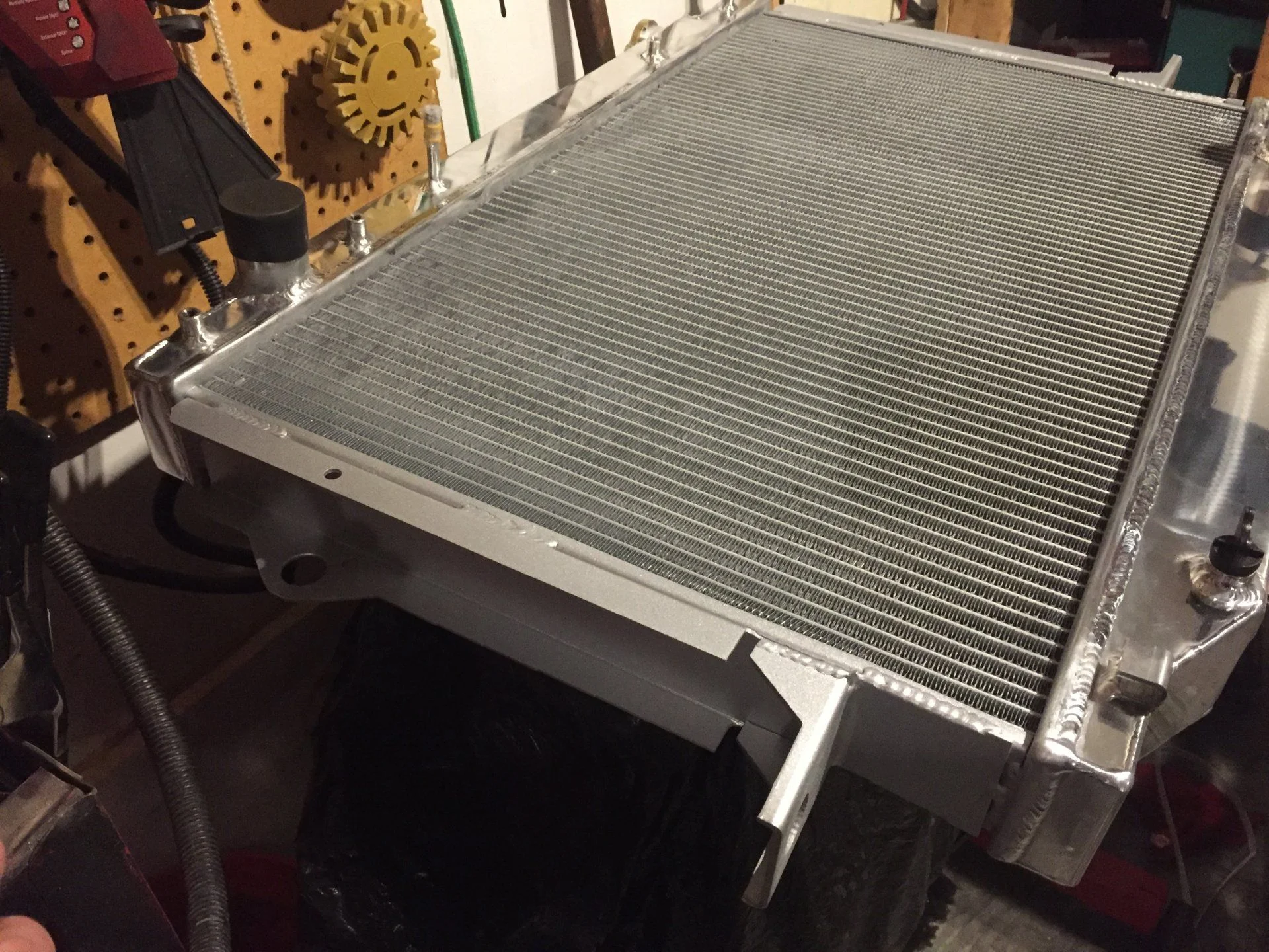

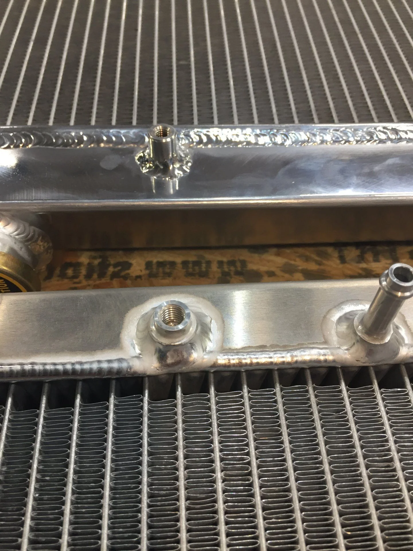

I went with this option including side Mounting bracket as the others that had trans cooler had studs just looked weak no good pics of how the studs where mounted. The Ron Davis wins on this aspect as it has nice thick welded bosses to mount the factory brackets to. GPI has options for all the diesel versions accross the globe with manual or auto trans options based on cooler options. I choose not to run my auto trans through the main radiator cooler.
I must admit I was didn’t expect much on the lower mount but appear lower quality than what I saw in pics. eBay pics show thicker aluminum brackets for hat really was the weak link in my head before purchase so really not surprised but ready to re-engineer if needed.

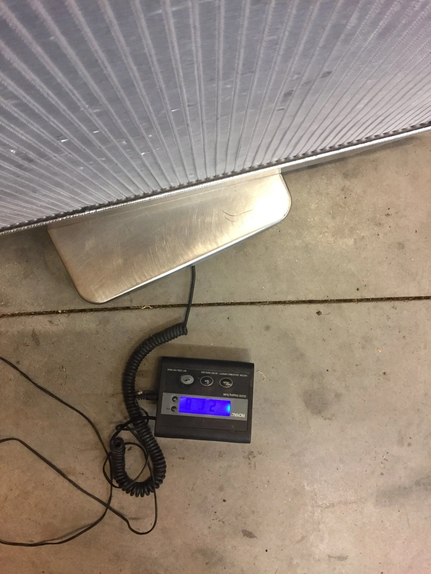

got some great side by sides. Ron Davis weights 5lbs more has an extra inch of core height and has 20 fins per inch vs 15 on the GPI. Also the core is about 1/4” thicker Both 1” 2 row cores with the Ron Davis offering more area for heat transfer due to fins and core size. Quality is very nice. Obviously better/thicker materials with weight. Great side mounting bracket points. GPI has combo mig and tig. Ron Davis is all tig with serial so my guess is they can trace it back to the welder.

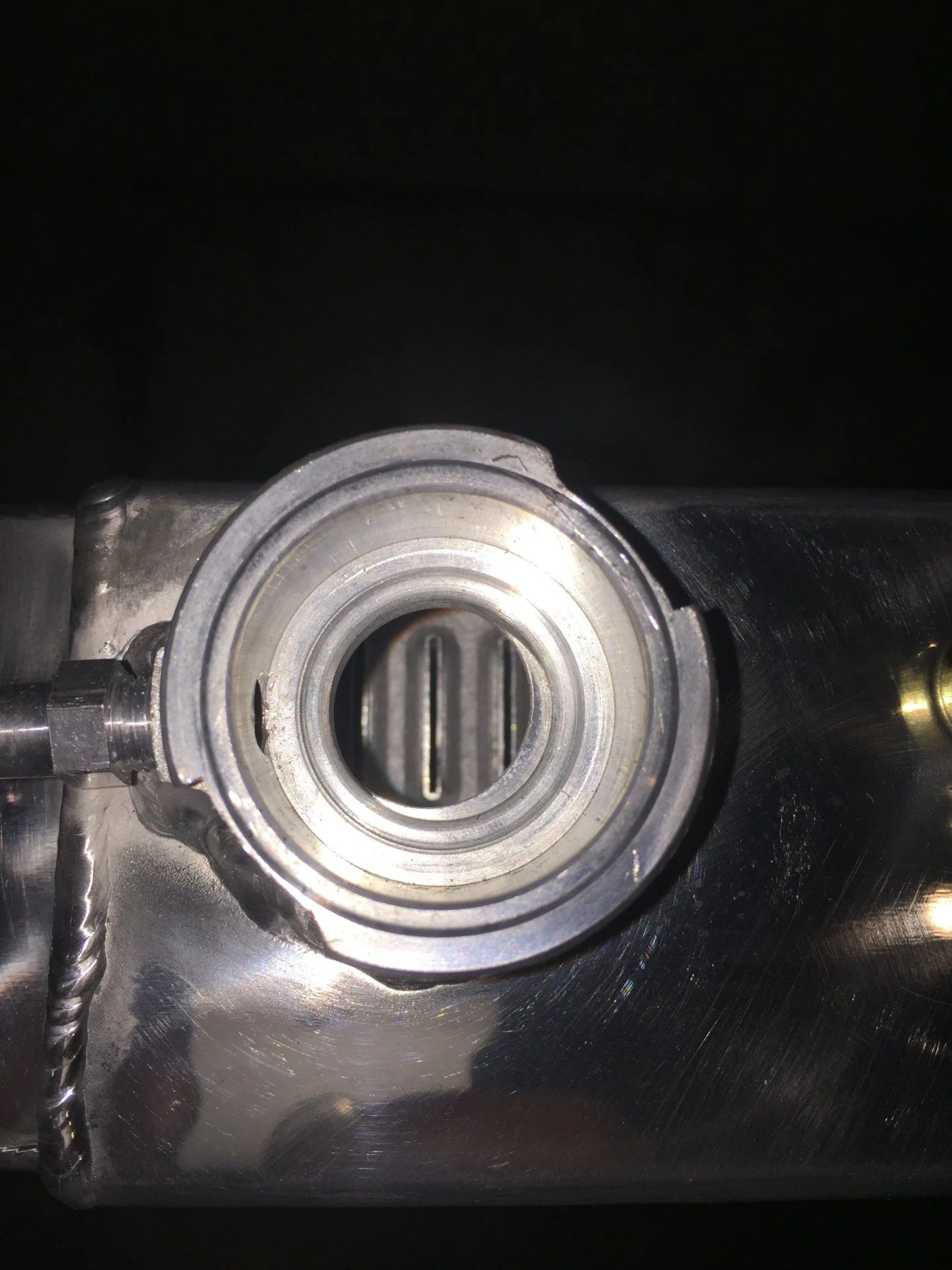

Also noted very different core end tank/ solder joints noted took pictures of both for reference.

Updated 2nd and 3rd posts to include Ron Davis references and pics. More cooling capacity in it for sure. Will compare to stock at some point in the near future.
