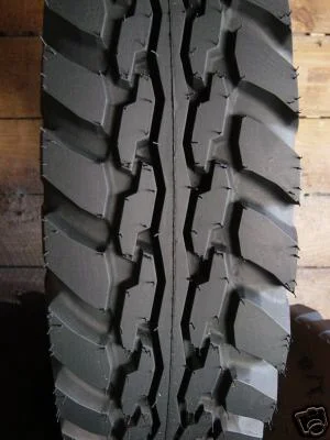

those are the bias ply military tires and are 36" tall. They suck. Terrible pattern to them is instantly obvious they will and do pack up in mud. Better off with the 37" radial tires they used, they still pack but not half as bad, the ones they use right now are 37" BFG baja's and are a much softer pattern and look to be a great tire by the pattern, but since they have only been using them for a couple of years are not as easily available yet.

Old style radial. Great deal. Hmmm...
Goodyear Tire Radial 37x12.50R16.5 Take Off's

sipe them or groove them up and I bet they work a lot better, even though hard is hard.
I agree, my Swampers are grooved and they hook up a lot better than the factory tread, I think it would be a similar case with these tires. Breaking up the big tread blocks would allow the tire to flex a lot more.
reckon they are the old style, they look cooler anyway lol
twf only has old radials

The bias not only suck due to hardness but also design. You would have to 100% change the tread pattern to get them to work worth a crap.
Not worth the effort, start with a better tire such as the radials.

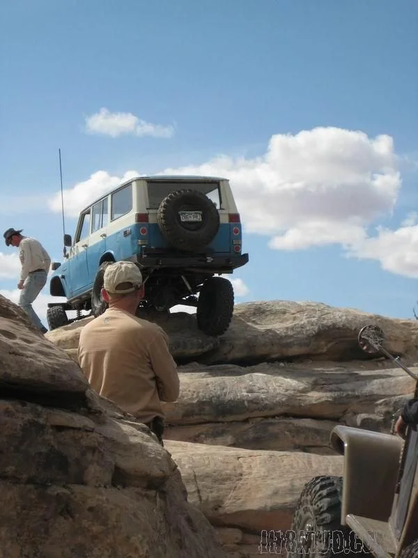

Anybody using these Radials? If so, which direction do you run them? I run a fleet of H1's for off road tours and use the heck out of these. (about 25 per year) I also run them on my FJ55 with center pattern tipped forwards. (see mid. pic.) But have not really noticed a traction difference either direction unless aired down. When aired down, and the center pattern is tipped aft, it seems to allow the outer pattern to make better contact. Which is nice on stone but tough on sand. Anyone else tried these both ways? If so:
- What surfaces offer best traction in either direction? (sand, bedrock, slickrock, gravel, etc.)
- What kind of tread life do you see? (I get 2 seasons, maybe 5000 miles, all off-road at max H1 capacity, Center pattern tipped forwards)
- Any intolerable vibrations with mixed directions on same vehicle? ( The H1's do not mind much, but none are balanced anyway so they all shake a little...)
I once used the old bias ply 36"'s and they just did not hook up on much of any surface unless grooved. Then they just wore out quickly. IMO the radials offer better wear life and traction for about the same investment. All the military tires I am discussing here are surplus 90 - 95% tread life on purchase.
