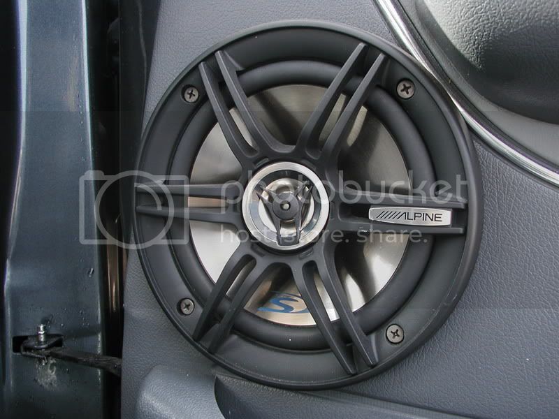

The CD player in my '93 didn't work when I bought it. First thing I did was to put in an Alpine and some new Alpine 6.5" speakers in the doors. The fronts fit just fine and the rears will take a 1/2" spacer and some metal trimming. This setup rocks!! And, if your sub woofer still works it even sounds better because they can keep that working if they know what they're doing.

outback....You don't by chance remember the model # of those front door speakers?
One more spearker questions....Seems like most of you are putting 5.25 in the front doors and the online places are telling me 6.5. Do the 6.5 fit with the stock grill? the top mounting depth of the speakers I'm looking at are 1.875"
