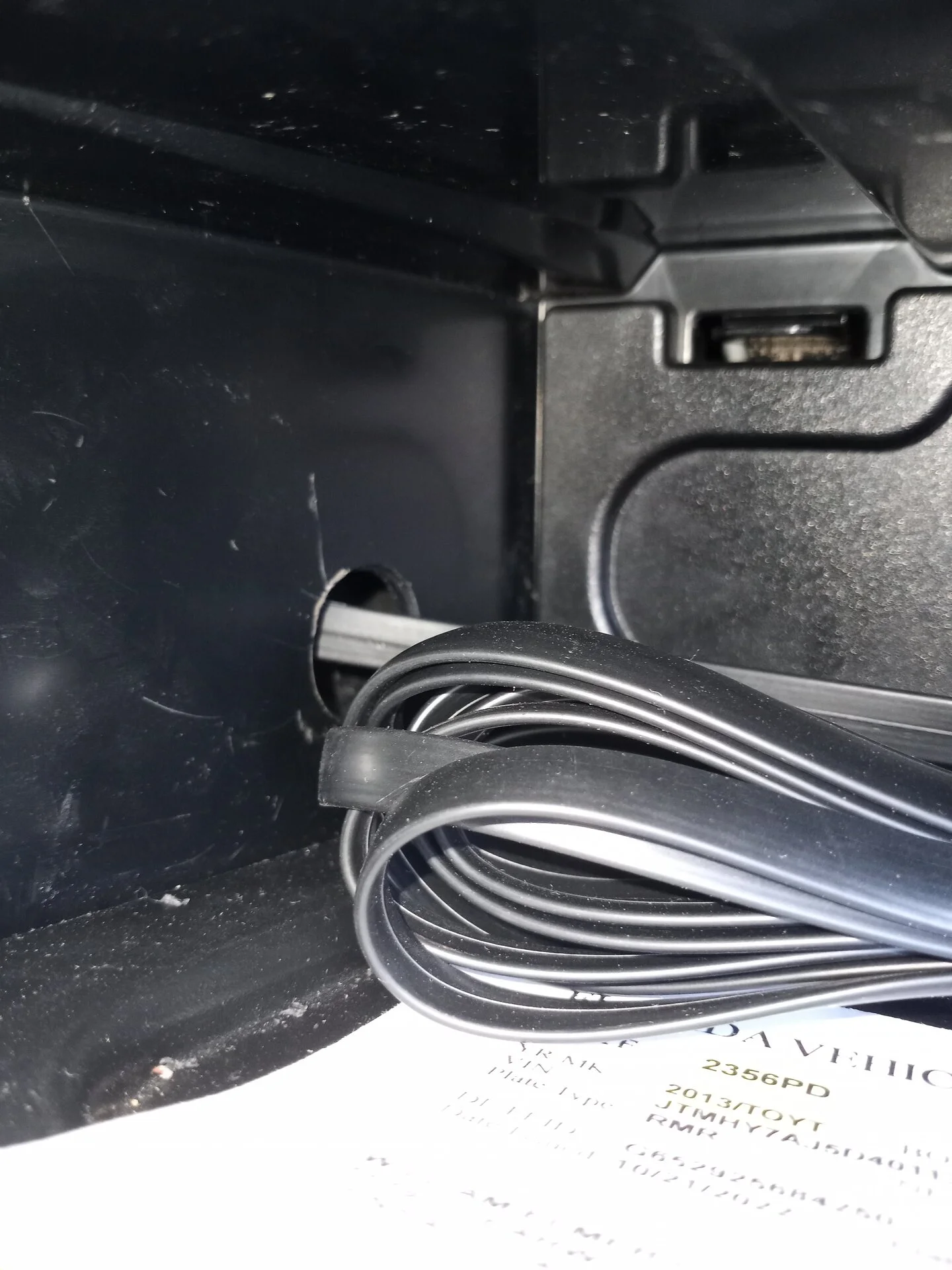

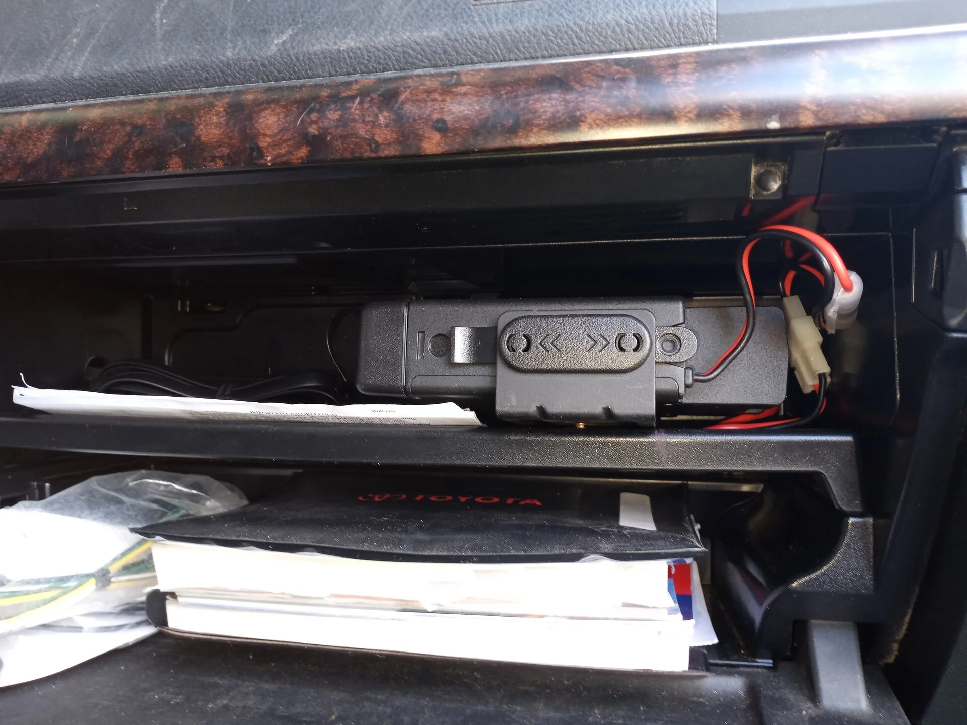

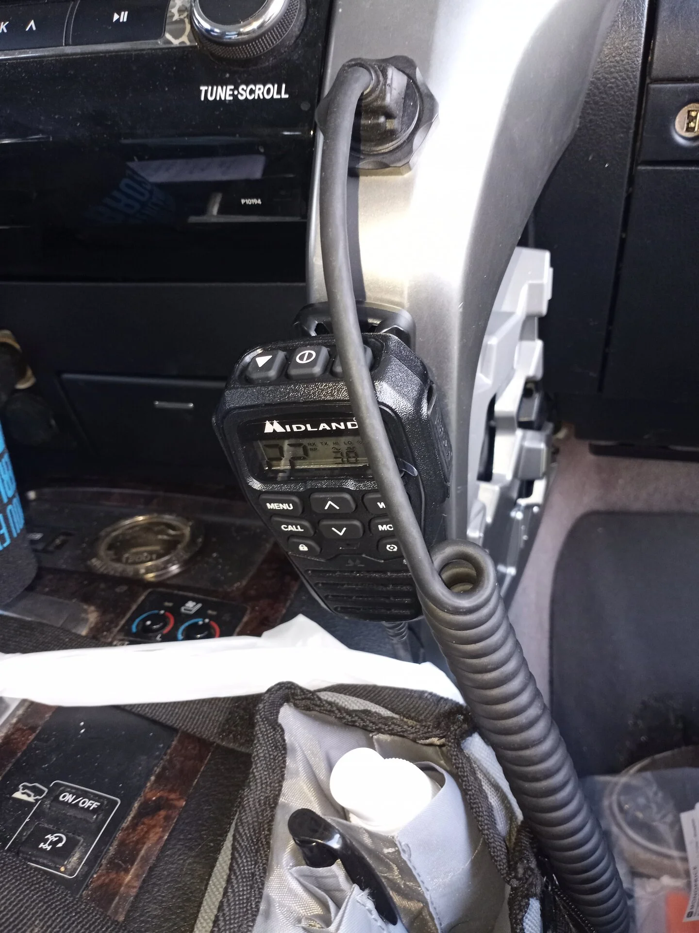

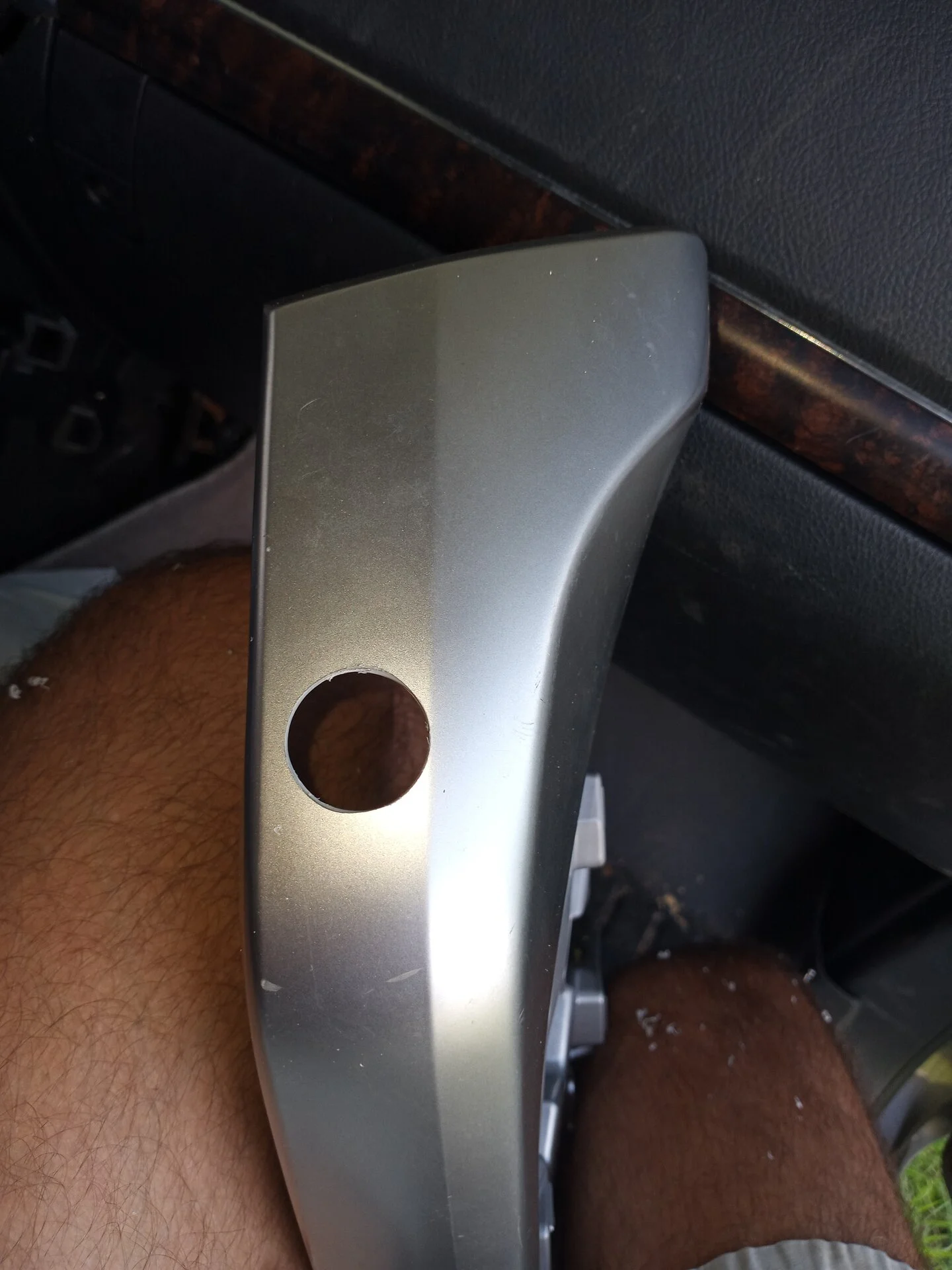

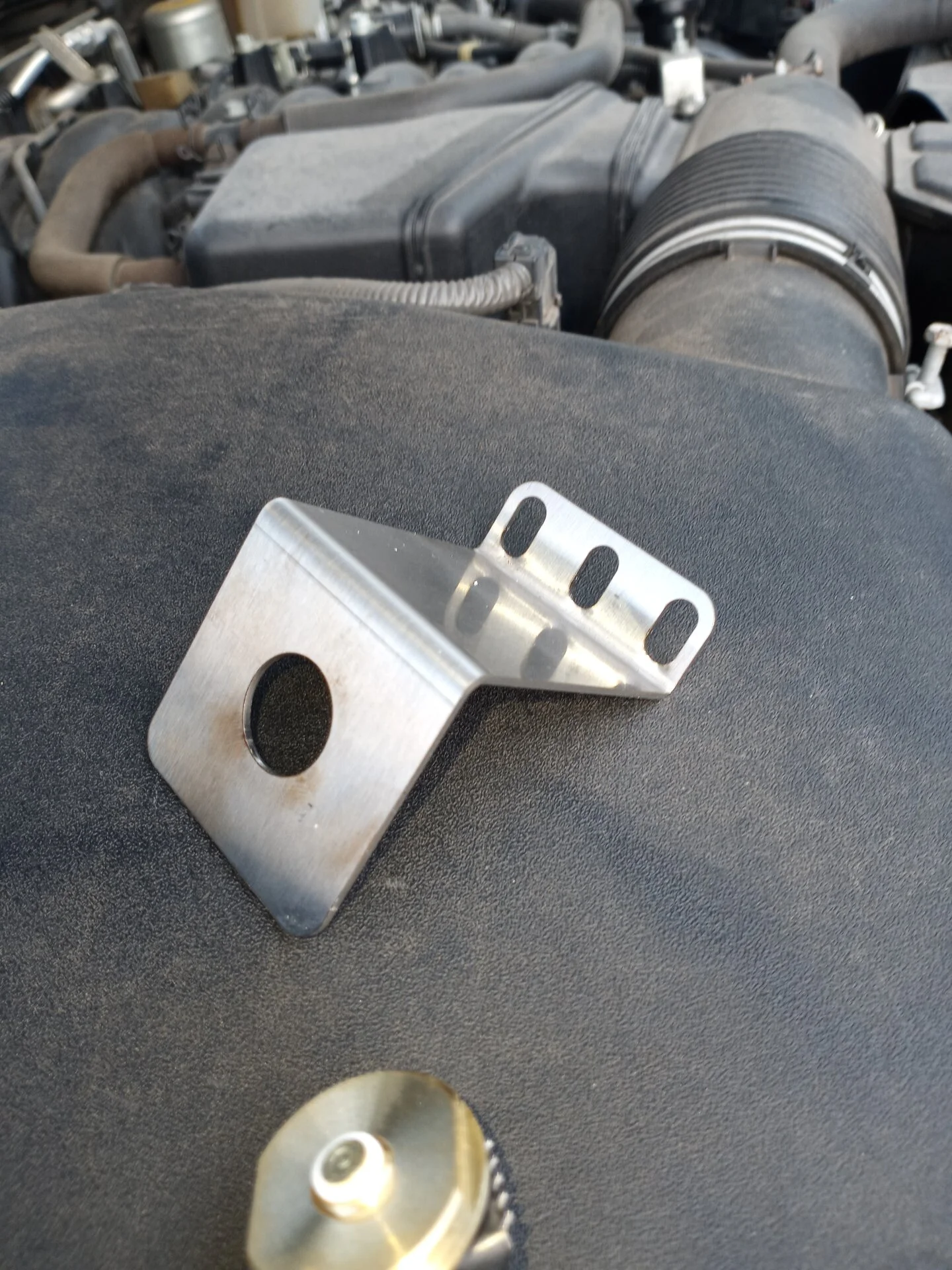

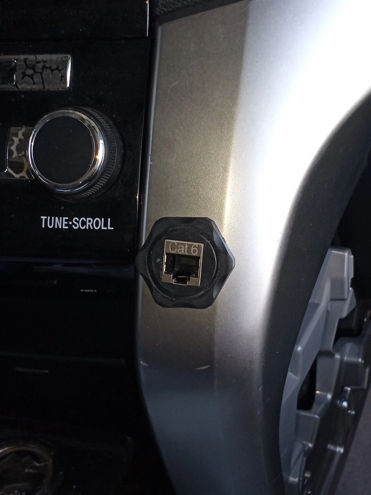

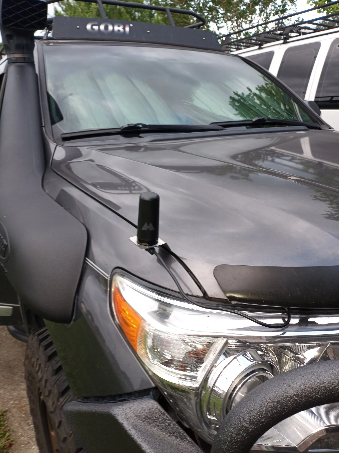

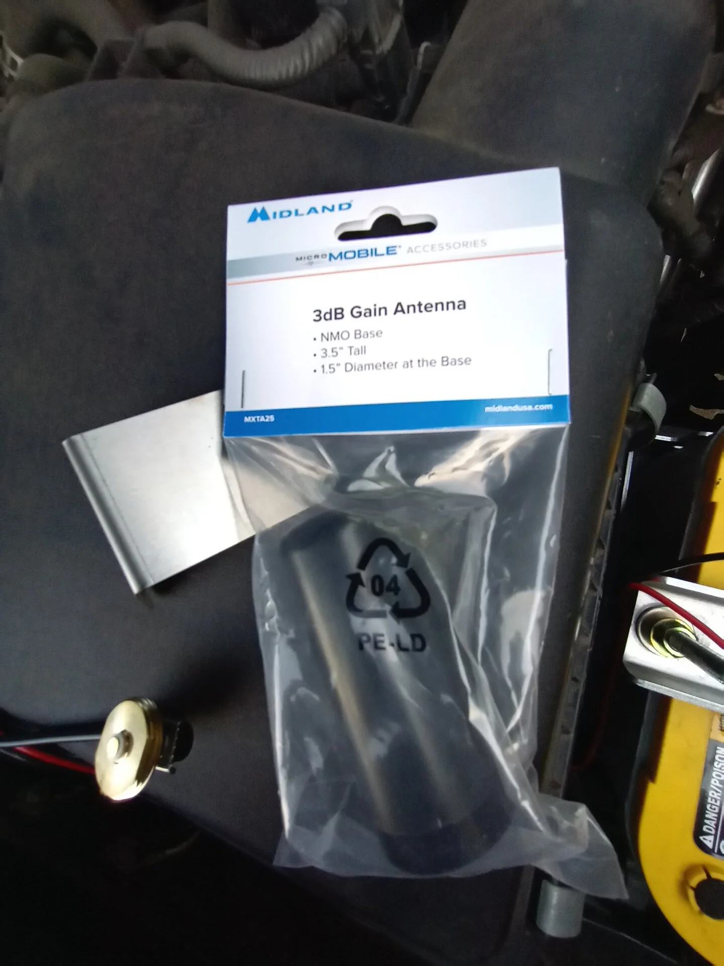

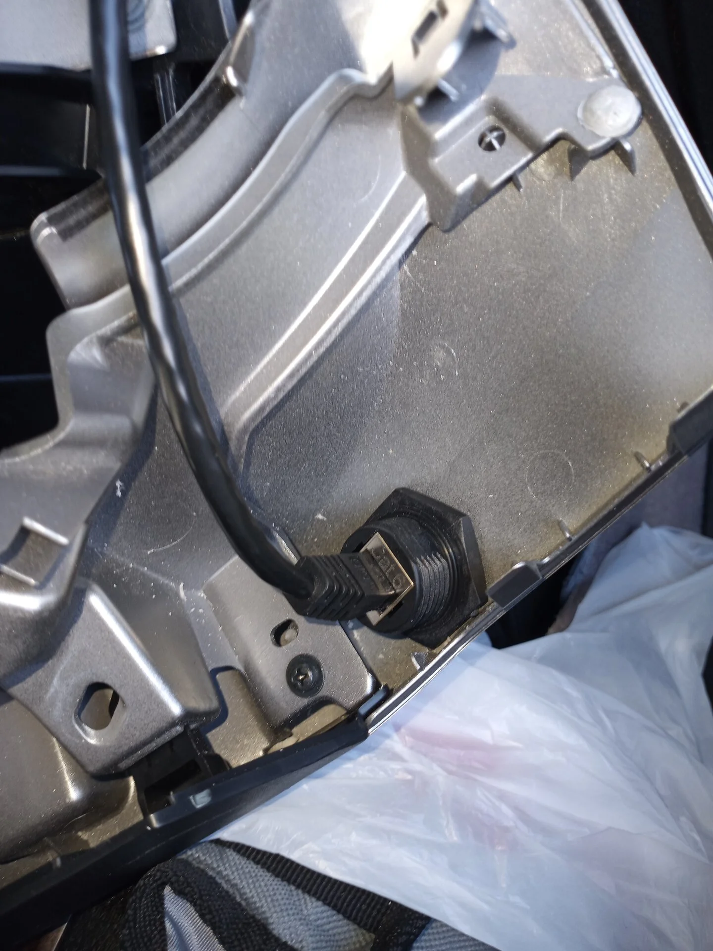

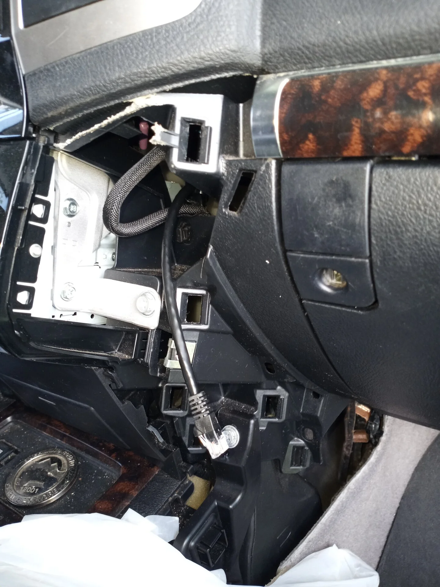

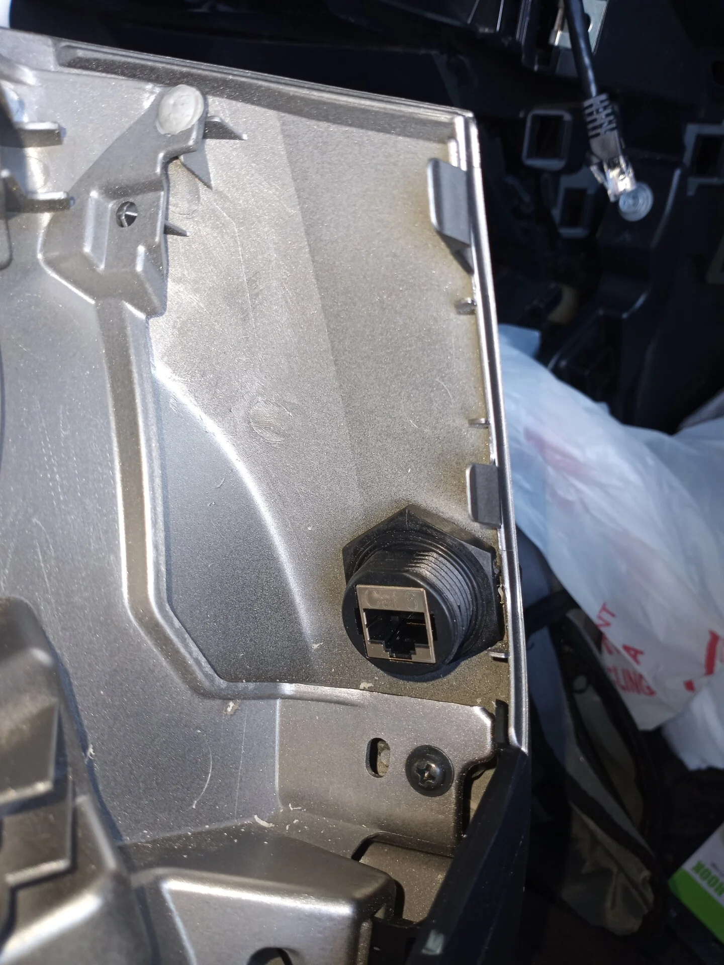

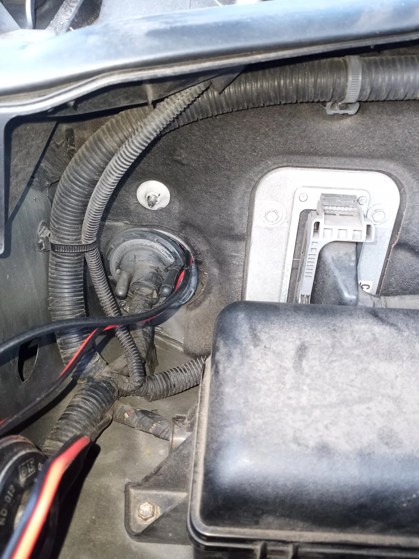

Just wanted to document this to hopefully make it easier for others. The 575 is in large units so it was very hard to find a space to install it. I completely tore apart the dash and removed the entertainment center along with the radio and found no space large enough. Other units are smaller so this could be possible for those units. Also checked under the seats same result. Ended up doing a glove box install. I also did the antenna mount at the front of the hood. I didn't like the wires coming out of the side of the hood for clearance issues. I used a ghost antenna from Midland
Pics..
