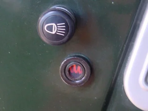

Your controller glows way too bright. Don't you smell the paint burning up?
It should look like this, which is the same as Tom posted

And how many seconds did it take to get your controller that hot?
Here are our two glow controllers side by side:
View attachment 852675View attachment 852676
I wonder if yours is standard or whether it has been modified/repaired over the years?
It looks so bright I wonder if you are at risk of burning it out?

Damn! So your new controller also glows too brightly and too fast (same as your old one)?

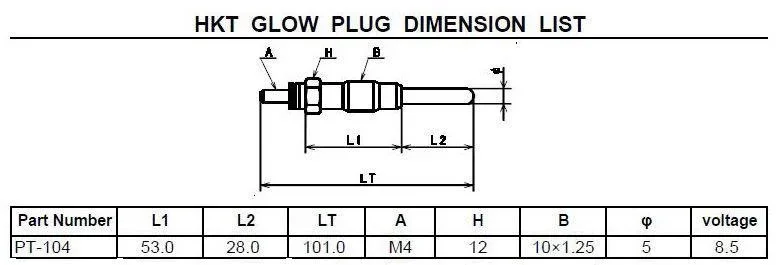

Here's a cut-an-paste I've just done to place your PT100 plug alongside a PT104 plug:
I was thinking the dimensions of the two plugs were the same and that therefore
there must be a difference in their performance/current-draw.
But the above image-comparison suggests the terminal threads are different!
Unfortunately the HKT catalogue I have only supplies the dimensions for the PT104 plug so until I did this image-comparison i didn't notice:
So can you confirm that your PT100 dimensions are the same as shown above for the PT104 except for the terminal thread being M5 as opposed to M4?
Interestingly, the original plugs for my 1979 BJ40 had an M5 thread so my busbar holes are sized for that.
Up until now, I thought plugs with the M5 thread were obsolete and no longer made!
So now, rather than thinking your PT100 plugs are wrong, I'm thinking perhaps I should be running them too?

Hi Tom
Yes the PT100 has 5mm thread terminals.
I will try and contact the company and ask them if there are sure they are the correct plugs and attaché some of the images from this thread.

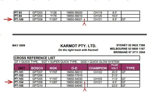

The difference between the PT100 and PT104 is the date that Toyota changed the part number.
If I run both numbers through the Toyota EPC it will show that 19850-56021 is pre 1980 and 19850-68030 is 1980 and later.
Since Jespers HJ45 is a 1978/1979 model the correct plug should be PT100 according to the HKT catalog.
And that leaves the question: What is the difference between 19850-56021 and 19850-68030.

..And that leaves the question: What is the difference between 19850-56021 and 19850-68030.
Rudi
And I'm now thinking the only difference could be the busbar connection thread-size. (M5 for 56021 and M4 for 68030).
In which case, the PT100 plug would be better suited to my 1979 BJ40 too because it originally had the plug on the left (below) fitted by the factory and my busbar holes are designed for this larger M5 thread..

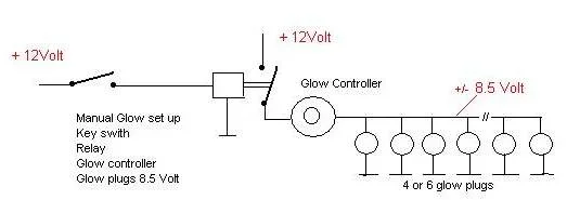

What if someone has altered the wiring in Jesper's truck to wire his glow controller in parallel with all his other plugs (instead of the way you've shown it should be)?
That's likely to be Jesper's problem!!!!
(Sorry - I'm slow on the uptake and your post was probably telling him already that he's likely got his wiring all wrong there.)
:beer:
Sooooo..
Jesper... Our cruisers are roughly the same vintage and therefore their preheat systems should be very similar...
Here is my preheat wiring setup (simplified from the FSM):
I'd expect yours to be very much the same (except for different part numbers, 2 extra plugs, a more powerful starter motor, and perhaps a few other tiny things)..
You should definitely check that your controller is correctly wired IN SERIES with your "parallel-connected glow plugs" rather than being wired in parallel with them (as though it were an extra glow plug).
