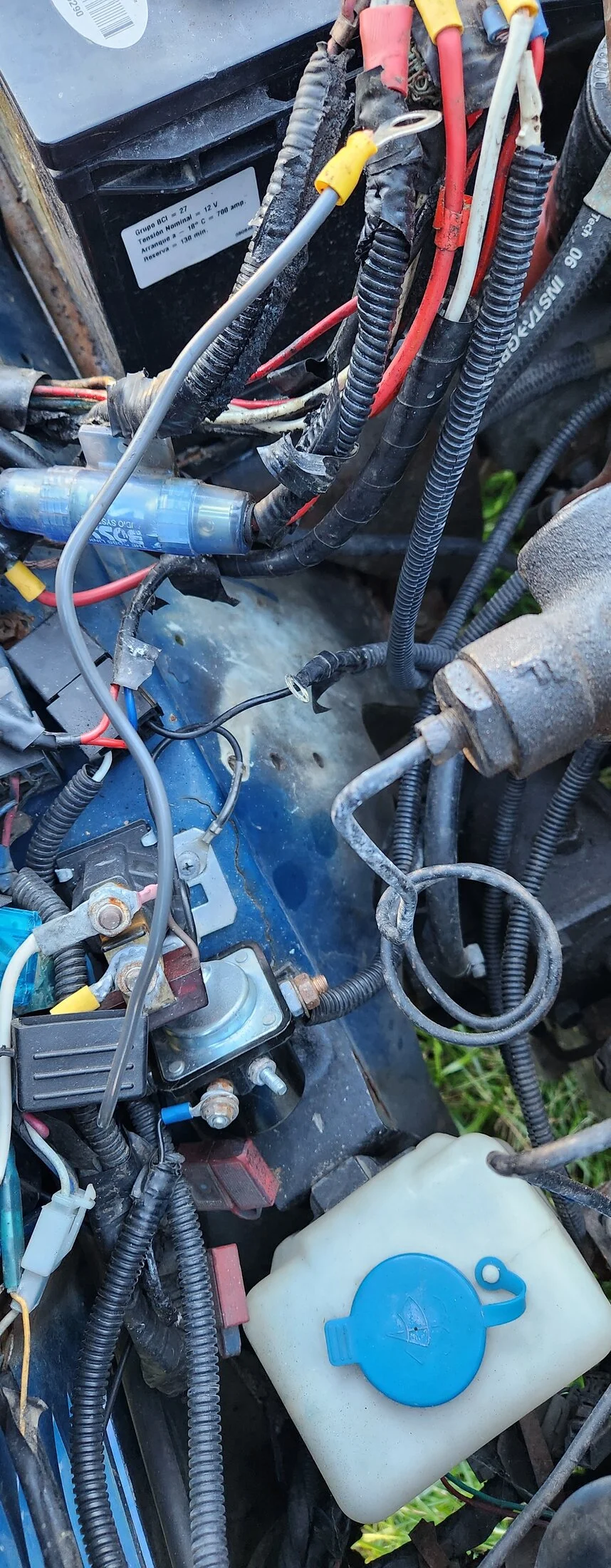

My system has that Grey wire that I used to replace the burnt one going to the solenoid pictured. Then a wire from a button on the dash going to the terminal. And a wire on the other side from the power going to the glow plug rail.
I see it's insulated, but it's capable of carrying, what, 50Amps? (half a kilowatt).
If things go wrong (e.g. a sharp metal edge rubs through the insulation) that could quickly become a fire... Consider adding a fuse close to the battery at some point :)
If that feed wire melted before, it could be that the solenoid got welded closed and it stayed on for a long time. It happens when the inrush current to the glow plugs is too high.
You could try wiring the "glow controller" in series if it isn't already (the glow thing on the dash under the headlight knob). This will increase your cold resistance and reduce the inrush.
Otherwise, connect a lamp to the output of the solenoid so that you at least know when it gets stuck on...
