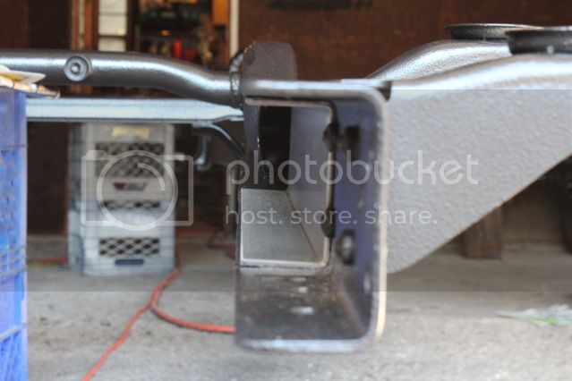

I've been making slow progress, focusing mainly on painting the frame, axles and other bits. I got the final coat of paint on and turned my attention to replacing the rear c-channel.

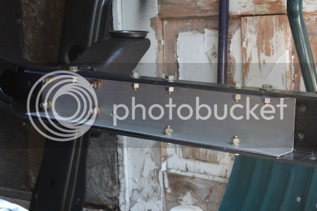

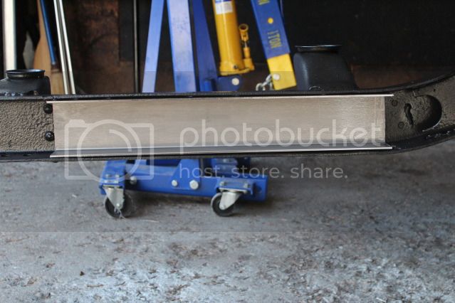

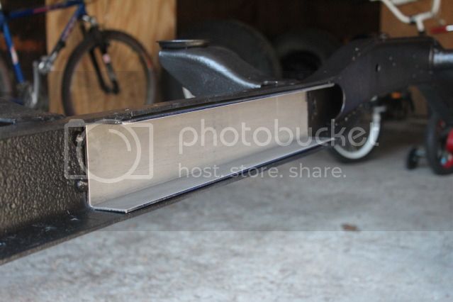

A local shop bent up two pieces of 3/16" steel to tuck inside the frame rails. Before I clamp them in and drill holes for fasteners, I'm wondering if I should be at all concerned about the possibility of a hard line on the frame due to forward edge of the inner channel? I was planning on having the pieces sit as they're pictured here because angling them forward like the original pieces, and the little weld at the forward edge, didn't seem to add any real reinforcement. Am I missing something or making a mistake by locating them where I have them?
Thanks!

Are you talking about the gap where the rear "C" changes into a box frame?
In my experience, using a seam sealer like an expanding foam or similar usually only causes more trouble when against steel. It is hard to get a solid fill without air pockets and cracks that quickly become water pockets and cracks, especially in a humid environment like Michigan. Spraying a rust preventative (wax and kerosene works pretty well) can be much more effective, though it will require annual application

I was thinking about putting a thick coat of something like polysulfide - a product I use aboard our boat to seal fasteners and fittings - on the back side of the new C-channels before bolting them into the frame rails. If I did it right, the polysulfide would fill any gaps and excess would squeeze out around the edges, hopefully preventing water from finding its way back in there. The stuff is a mild adhesive and dries to a flexible, non-tacky finish. Perhaps I should leave well enough alone!

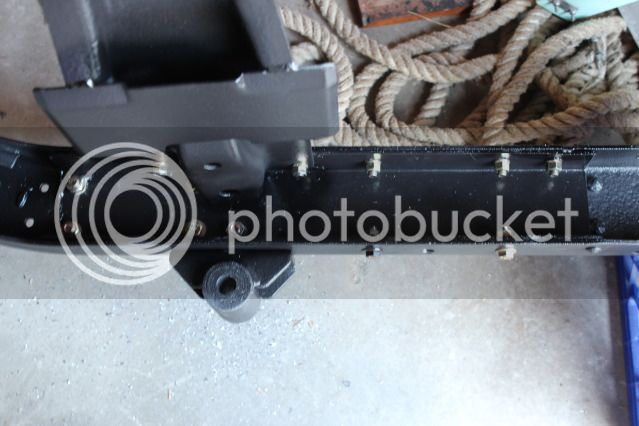

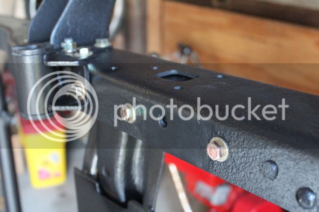

C-channel is drilled, painted, and bolted in. I used 3/8" Grade 8 fasteners everywhere except the four body mount bolts and the rear spring hangers - those got 7/16" Grade 8 bolts. I had to notch my spare tire carrier a tad to get it to fit past the new fasteners.
I had to flip two of the bolts to get them to fit past each other inside the frame rail.
Getting ready to drill the two bottom holes for the spring hangers.

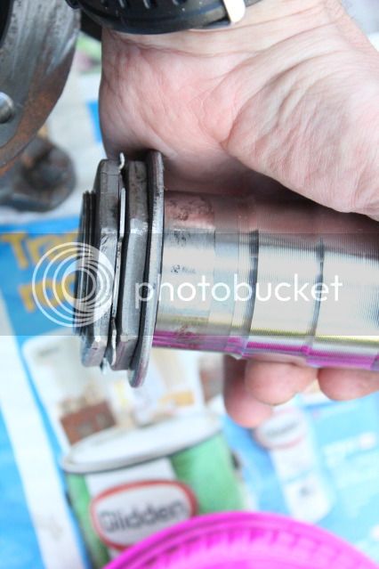

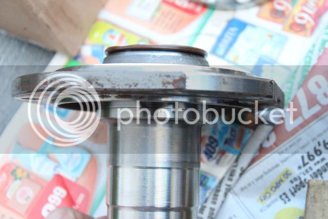

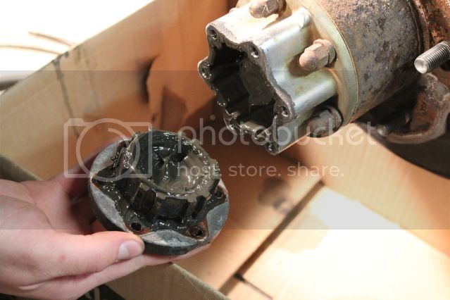

Also tore the front end down. I'm going to do a spring over, so I'll be rebuilding the axle at the same time. Turns out my oil seals were bad, so my hubs ended up with grey, gooey mess.
What do you guys think about these spindles? It looks like the bearings may have spun just a bit on both of them. Is that what I'm seeing signs of?
And is this line where the seal rides normal? I can't imagine it is, but...?

Those spindles look fine man. Run them and don't think twice about it.

Just a personal opinion: I would weld the stuff that used to be hot riveted. A least a few small welds provides some assurance.
You're talking primarily about the spring hanger, right? How about a bead along the front and rear of the spring hanger under the frame and one right over the top of the flange that attaches to the side of the frame? You think that'd be sufficient?
Thanks for the suggestion.
I would say yes, but also I would do the body mounts.. some beads along the rounded corners.
Maybe some of the suspension guys will chime in on where to weld the spring hangers. They move those frequently on SOA's.
MichiganFJ60 said:
Purely academic, but do you think the body mount is subject to that much load? I'm not arguing, just asking.
I seem to recall there was a weld along the top surface of the body mount along the frame, is that what you see?
When I did mine, I reasoned that the purpose of the rivets was to keep the arms from spreading under compression (heavy load in rear) and from pulling away from the frame under tension (hard cornering or jumping). Even if there is some element of shear involved, the increased strength from your grade 8 fasteners and the friction between the body mounts and frame under increased clamping force make some welds seem like overkill, IMHO.
The spring hangers on the other hand, might be worth welding...though 7/16" bolts are pretty hefty.
