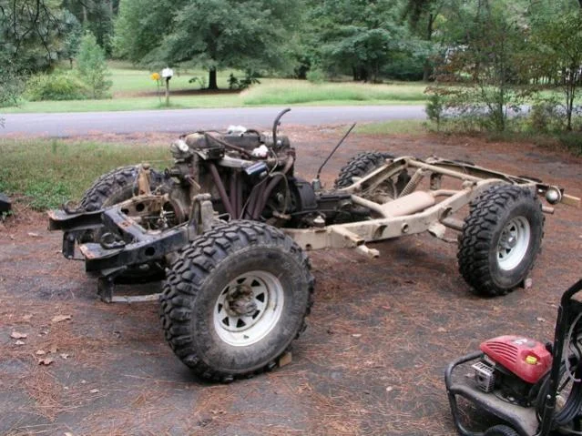

Started two years ago with a tear down and refresh. I got it to the point where I put gas in it and tried starting it. After messing with the dizzy...Success!!!
What it is -- Nov 1969.
What I did: minitruck PS, 96 4runner disks up front & geo metro MC/booster, carb rebuild from Mark's, non-USA dizzy with pertonix, 2F waterpump, fan & 2row pulley.
I also did some other things like clean & recoat the gas tank, clean out the heater, new brake & gas lines, etc, etc...
I would've done a rebuild thread but wasn't sure how it would all turn out so i waited till i got it to the point i pulled enough together to get it started.
Thanks for all the info on this forum! :beer: ty

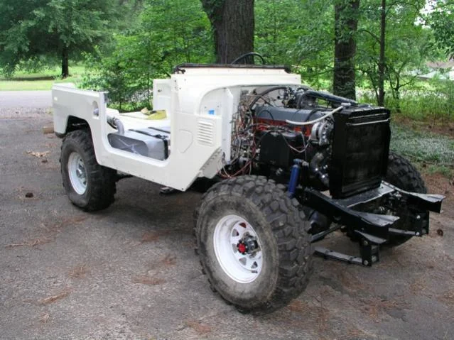

pretty much there
So here it is with all the body parts on. Some electrical work to be done but drivable. :)
ty :beer:
Great looking 40!! Love the color...
