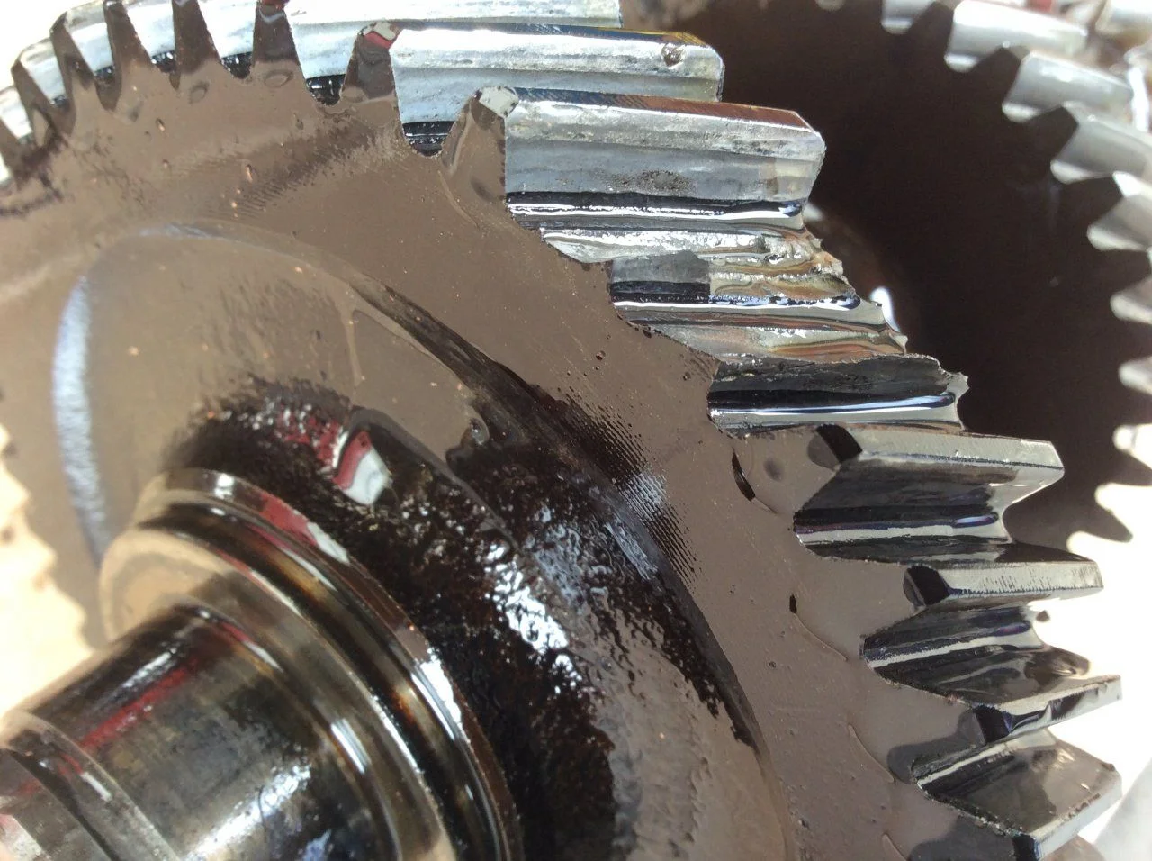

After some alarming noises from the gearbox, my HJ61 has been sent to a local gearbox specialist. He removed the gearbox (5 speed) and opened it up, apparently it needs a new:
Input shaft
lay gear
another gear (on the main shaft just into the transfer case)
"bearings and gaskets"
It also needs a new clutch.
While the gearbox and transfer case are off the car and in pieces, is there anything else I should get him to do while he's there? For example, there was a fairly loud whine in all gears but 4th as long as I have had the car (3-4 years), easy fix?
