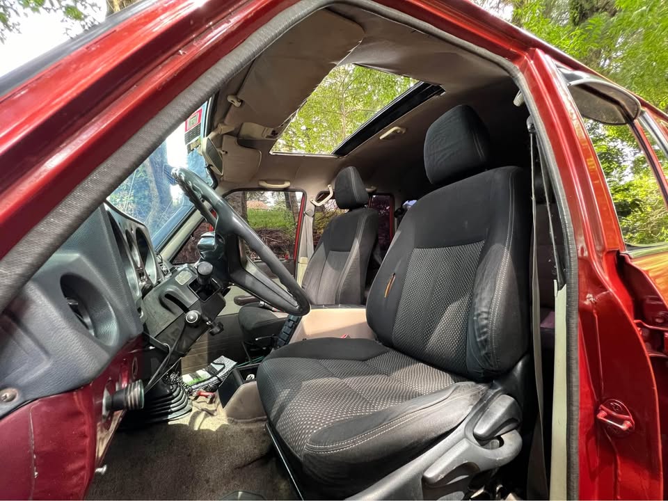

Been shopping around for something bigger than my BJ40. Found this 1984 60 series:
  • 1HZ 4200cc diesel engine (2016)
  • 5th gearbox
  • American rims with 33 MT tires
  • 2-1/2 muffler with high flow
  • 4-row radiator in new aluminum
  • Wincher with wireless control
  • 3 rows of seats
Wdyt??

However, I’d give my right arm to possess that “grab rail” above the rear side door in that interior “ glamour” shot.
