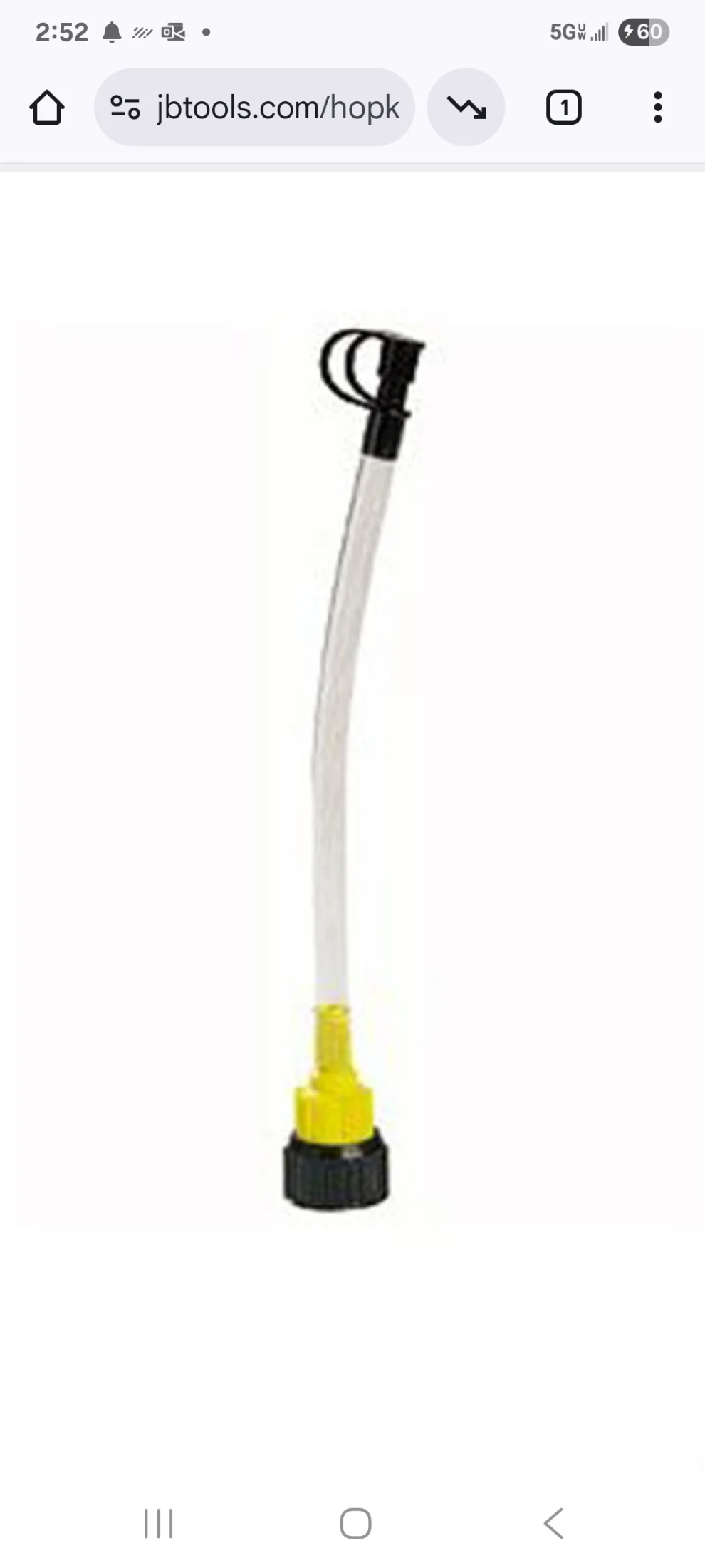

I'll buy a gallon of gear lube and 1 quart bottle too. I have a spout with a flexible hose that screws on the quart bottle. I fill the qt bottle then tip and squeeze it. I tip it a bit so I'm not pushing air. I'll use the same qt bottle for several years some times. It can get a little oily.

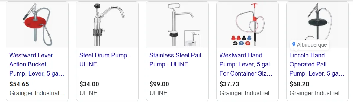

I buy gear oil by the 5gal pail and use a standard pail/bucket lever pump to transfer oil into diffs and tcases. I swapped the hose with a longer one so that I can pump from the side of the vehicle on the ground vs laying under the vehicle. Each stroke delivers a decent amount of oil and the effort is minimal. Even laying under the vehicle on a creeper, this process won't bother your shoulders/arms.
