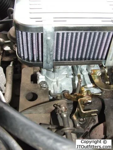

there should be a spring on the carb like the one pictured.(i know you have a cable hooked up not this linkage but the return spring is the same) if not than thats your prob. next remove the cable from the carb linkage and rev it up by hand and see if it still sticks. if i doesn't stick, it could be you pedal spring. i have had that happen to me once. good luck fyi pics of the carb would be great

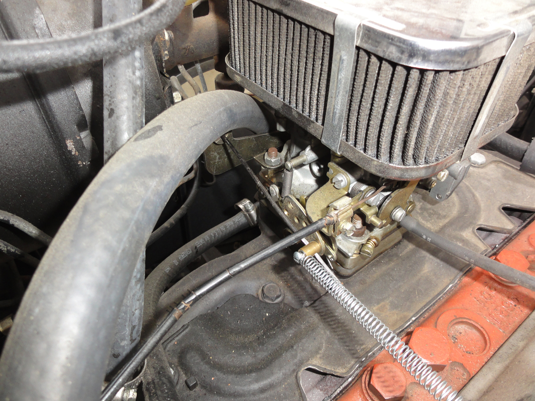

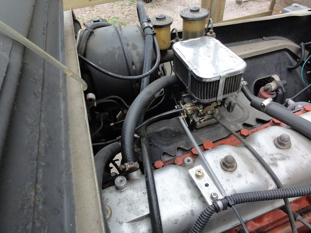

After I climbed into the engine bay and had my wife hold some hoses back I was unable to see a spring as you showed above, and I could not see any type of torsion spring that might be being used..... so.... I solved the problem this morning with a $2.50 coil spring from Lowes and a ziptie, the throttle lever closes now, lol (Not pretty but it will solve my problem in the short run).

Here's my hack:

that's just a temp fix right . cause that ty-rap is gonna just break cause of the heat in the engine compartment .. just an fyi
