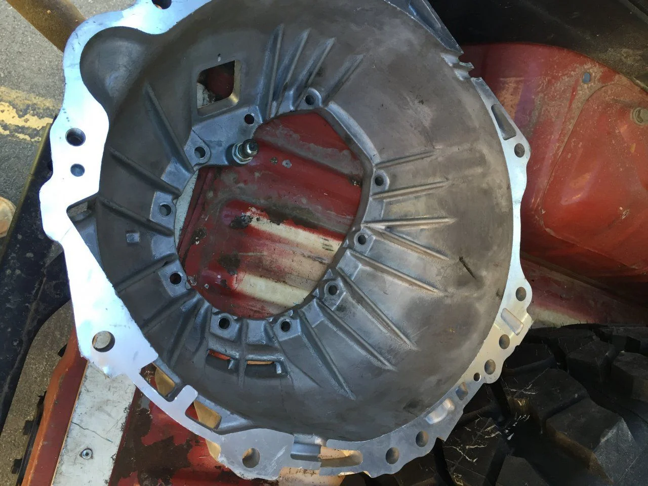

Credit for the bell housing is really due @joekatana , who acquired it on my behalf, for this very purpose.

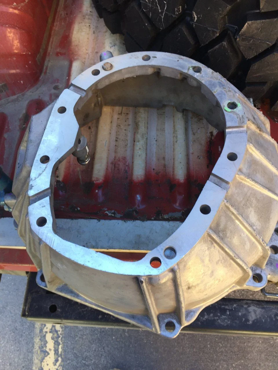

Yes, in order to adapt the 6 speed, I cut the flange off the A440f bell housing and welded it to 6er. This allowed it to bolt up, but pushed the trans, and thus the input shaft, rearward 1". There may be additional info about somewhere in thread.

@bjowett I need some measurement if you still have them documented somewhere. So I decided to adapt an NV4500 using the A440F bellhousing. Got that design done and now I need to make the flywheel but really dont want to take it apart just to measure since I do drive it around. Do you have the distance from the crankshaft face (where flywheel is bolted) to the bellhousing to engine plane? I'm trying to figure out how thick my flywheel has to be. Thanks in advance!!!!
