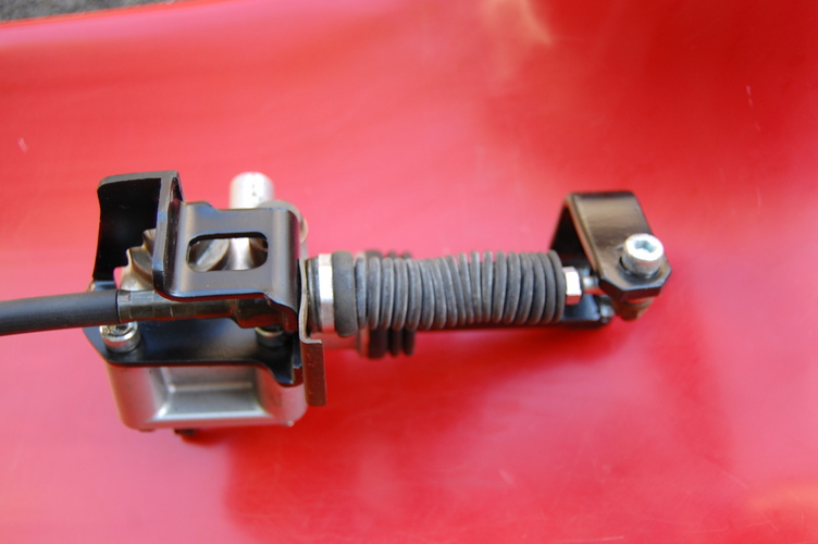

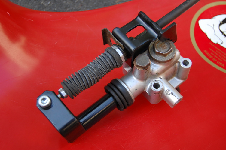

Cable shift conversion for 2/4WD on the Orion.
A picture of the cable for the H/N/L range is somewhere in the last page or so.
Again, these are shift cables and modified brackets from a Suzuki King Quad produced 1987 to about 2001. These items are all over ebay.
