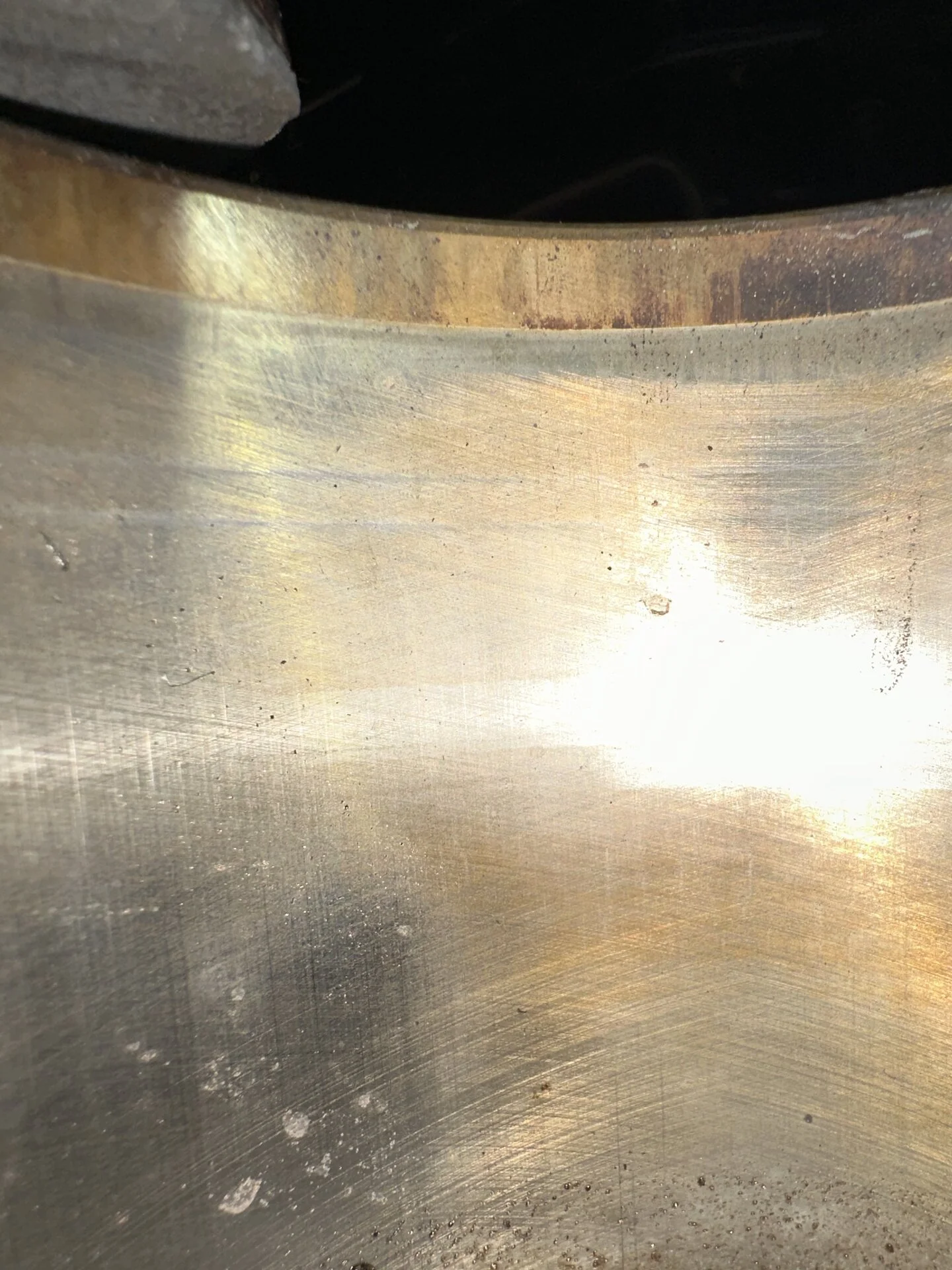

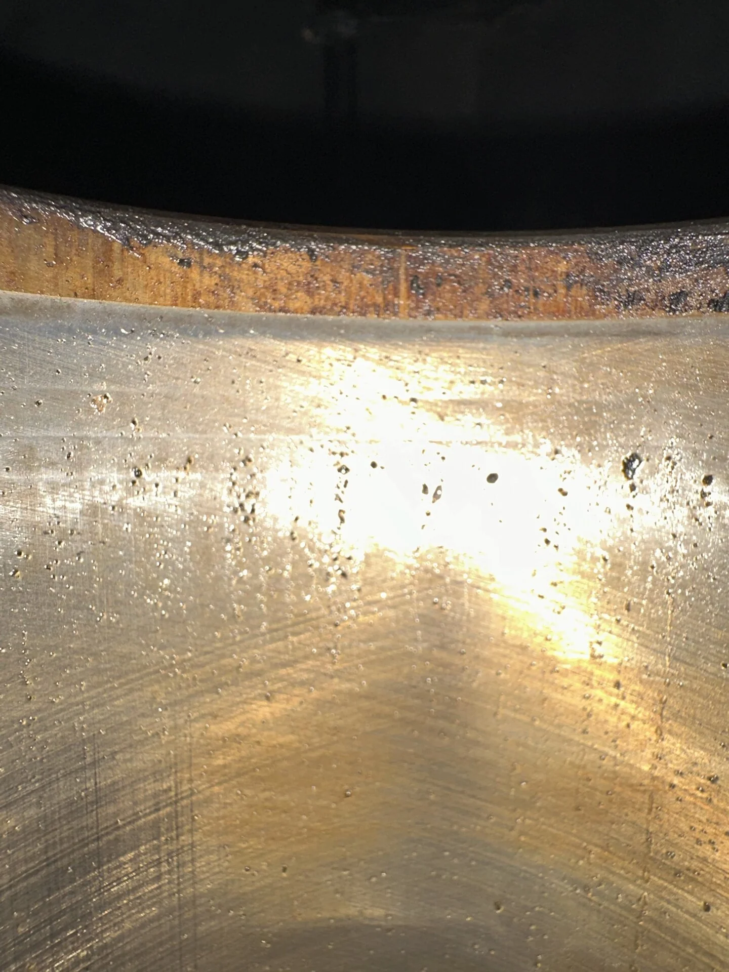

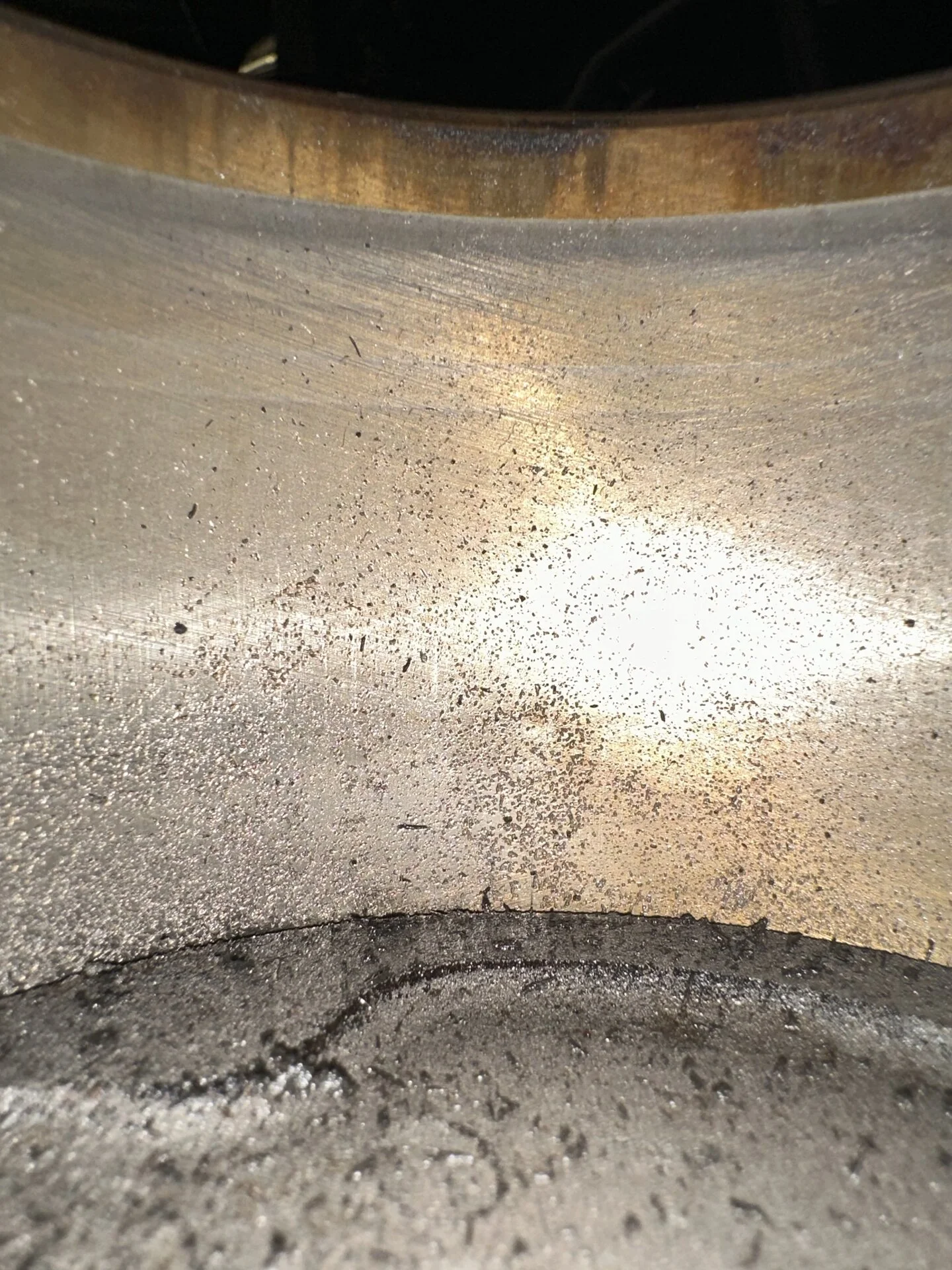

I'm having an in-person mtg with the current shop re: ridges. So i'm clear (as I'm no engine expert), ridges are only a problem if they catch a fingernail but not otherwise?
Is there a distance from the top of the block which makes it ok to have ridges that catch a fingernail (ie how high in the block does the piston travel) or if there's any fingernail catching the block needs to be rebored? Thanks in advance.
There is no "fingernail catching" engineering standard. The cylinder walls must be smooth (honed =<16rms), however, this practically only applies to the areas within the movement area of the piston rings. To be clear, if the metal defect in the cylinder wall is either above or below the extreme positions of the piston rings, it doesn't matter.
In your case, the "ridges" your shop identified, as far as I tell by the photos you posted, are not metal defects, but carbon buildup on the top of the piston/cylinder wall. Typically, shops remove this hard carbon buildup using a ridge reamer because it's hard, and because when the cylinders are honed, any area that is not "ready" for honing (in other words, the surface was nearly "as honed" before starting) need to be "cleared" of defects in order to preserve the hone (stone) surface. Shops don't want to break their hone stones because they aren't cheap.
Honing operations are cheaper for shops because they are quicker; time is money. In the instances in which the cylinder has to be bored, the ridges don't matter. The tool is designed to cut metal, it'll cut anything that gets in its way.
In your case, the shop wants to use a ridge reamer to clean the carbon off the cylinder, and since they don't want to get that trash in the gaps between the rings, they want to tear the engine down.
While this may be a good thing to do, if money and time were no object, it's not absolutely necessary, in your case, based on the photos you posted.

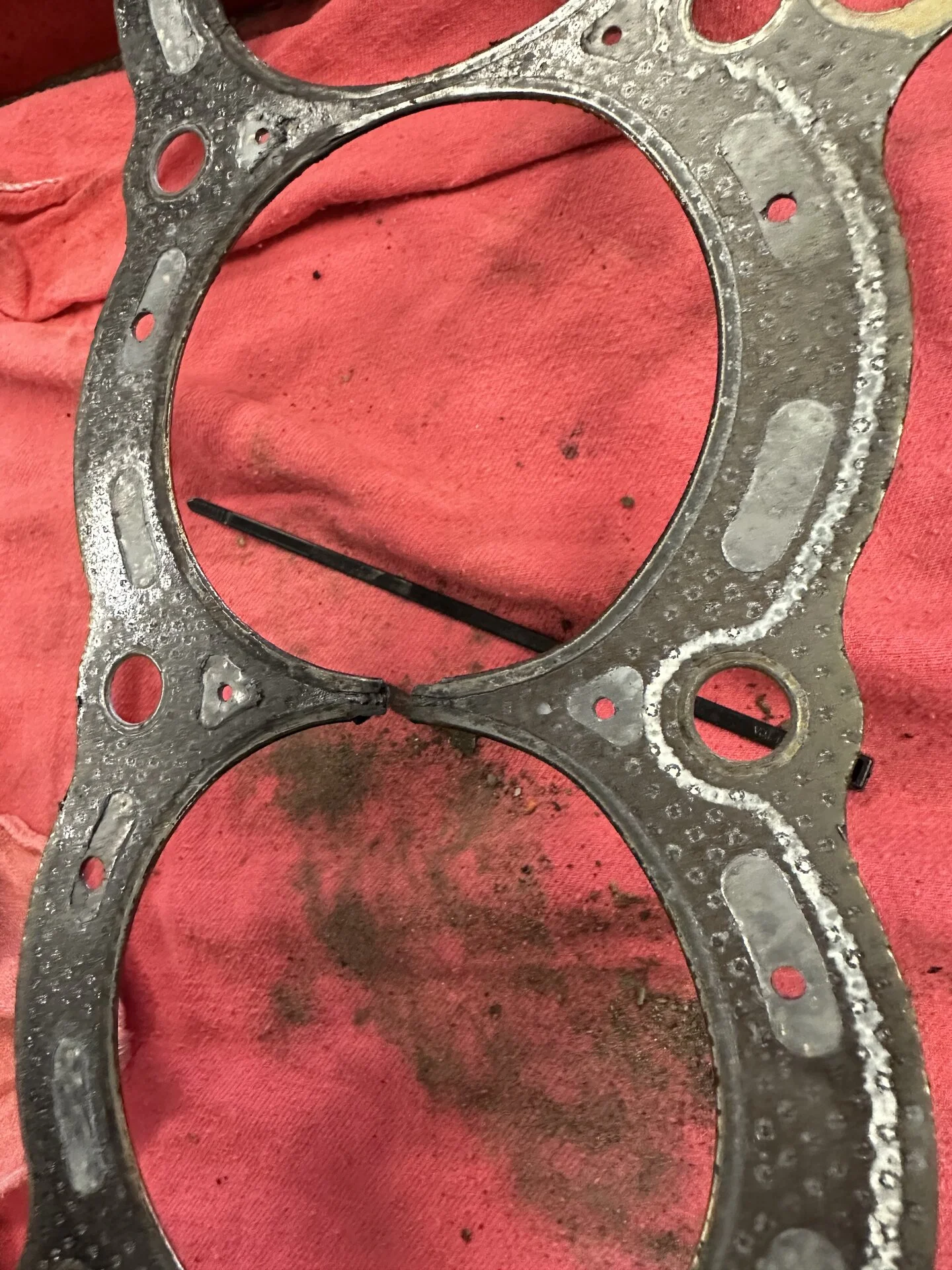

update: i visited with the engine shop and took photos and videos which I will post below.
- Ridge lines in all cylinders were ~3/8" from the top
- Ridge lines on one side of the cylinders were simply different color and didn't catch a fingernail. The other side caught my fingernail in a minor way
- The diagonal cross hash lines were still visible in each cylinder
- Black soot marks on the the head gasket and corresponding locations on the deck of the short block potentially indicated severe loss of pressure or blowouts
- Tech said the engine block studs were quite loose when he took off the head, potentially indicating insufficient tightening caused the blowouts (recall this HG had been redone not too long ago)

Solution:
- Shop will lightly shave the bottom of the head then install a thicker head gasket
- Should be minimal scope creep
- I told the shop the ridges are light enough that I can live with them
Thanks to all of you on this thread for giving me the confidence to insist on the path we are taking, which should be around $3k instead of 14.
Photos below. Thoughts on the ridge?
