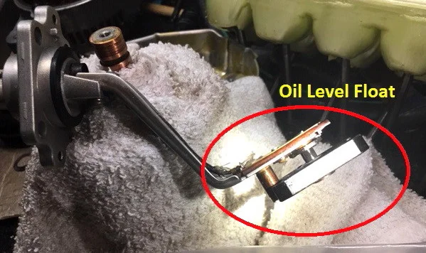

You might want to pull the oil level sensor and clean it well. Inspect to see that the float is not sticking in any way.
The float on the sensor....(as installed) is situated roughly parallel to the oil pan but works in a perpendicular fashion (float moves up and down). When your vehicle is level and the oil pan full....it is working at its best. IF you were on a 45 ° angle (100% grade) which is doubtful, then there is some amount of friction the float against the shaft must overcome. IF there is build up on the float/sensor shaft then that could be your issue.

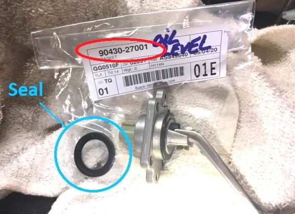

Your oil seal for the level sensor is probably leaking if it has never been changed....so this might be a good opportunity to pull the sensor, give it a good cleaning and install a new seal.
