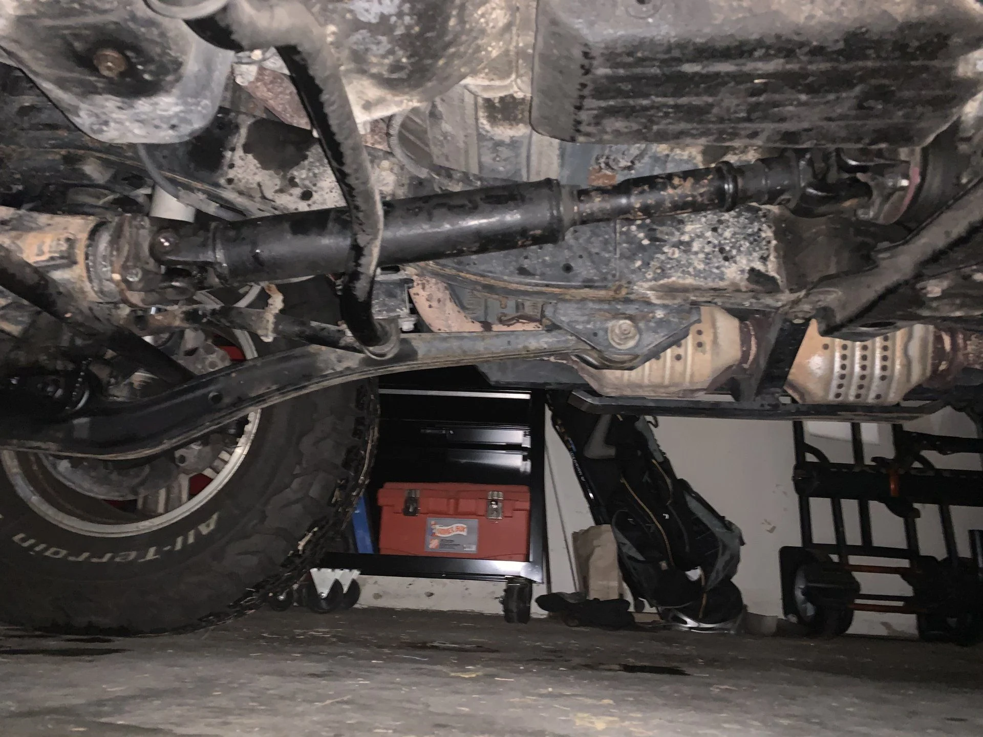

Here’s a picture of it right now. Looks to be 90 degrees “out of phase” so that’s good.
Yes, it does appear to be correctly out of phase, but it DEFINITELY needs to be swapped end of end, as the clearance to the sway bar is also an issue.
Any evidence of the sway bar rubbing on the DS?
Slip yoke needs to be to the front.
Ok swapped the driveline around the right way now, and.... same metallic high pitched clunking wining sound on the freeway at 70 MPH. Right in the sweet spot off the throttle between acceleration/deceleration when the drive lines are or should be “slack” or free of accel or decel forces.

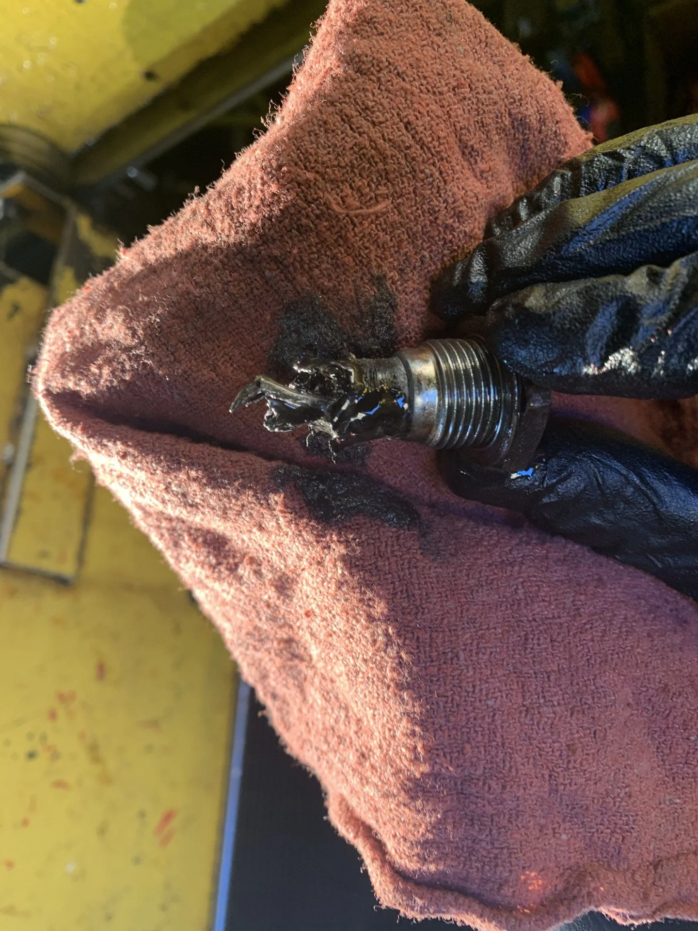

Metal shavings from front diff oil change a few months ago. None in the rear at all.
That looks like a little more than metal shavings, looks a little like pieces of something. I would check it again, take some other pics.
