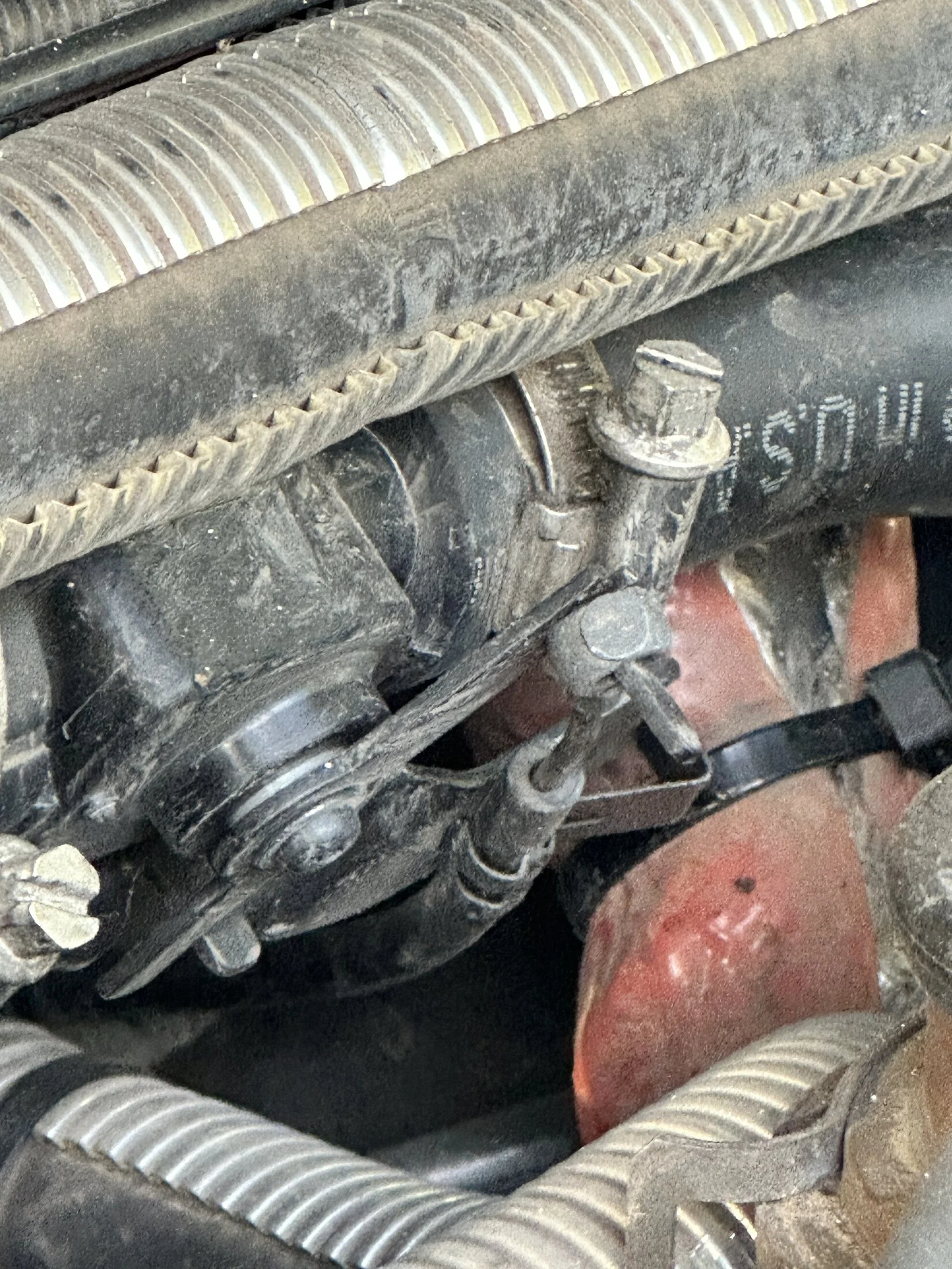

I just posted under another thread on this, but it's an easy thing to check to see if the Heater Control Valve cable sheath isn't captured by the clamp properly. If its arranged as shown in this pic, the outer cable sheath can slide around with vibration and possibly allow the Heater Control Valve to open.
You mention that cycling the Hot->Cold slider corrects it, which I'm speculating may move the cable back into a position that prevents hot coolant from circulating, at least for awhile. Take a look at the other thread, which is likely more info than you need: Adjusting water valve to maximize A/C performance - https://forum.ih8mud.com/threads/adjusting-water-valve-to-maximize-a-c-performance.173731/

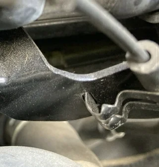

I had a similar problem and it turneed out to be the "temperature control switch". This is the slider at the bottom of the control panel.
I ended up cleaning the internals with electrical contact cleaner and blowing gently with compressed air.

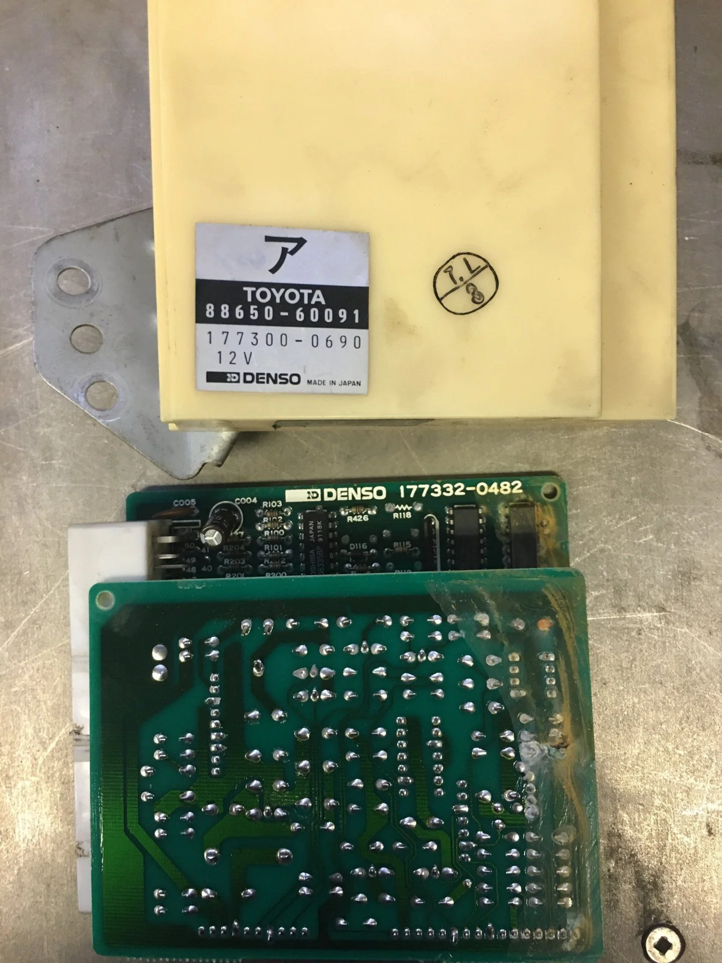

Others have found water damage/corrosion on the "AC Amplifier"
