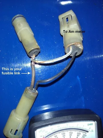

Long story short, had to take off the alternator to replace a radiator hose. After I got done I tried to reconnect the +iv back to the battery, as soon as the connection was made, smoke came from the fusible link area (not sure if it was the link or the fuses). All fuses in the picture (two in the black box, one in the while tube) were blown as well, and of course no power when I tried to turn key. Tried replacing the fuses and reconnecting one more time and one of the black box fuse blew again... and here I am for help.:confused:
I have a three questions...
1 - What is the correct amp and purpose for each fuse? Since I tried replacing the blown ones I am not sure which amp goes where, know all three are different amps.
2- How do I test the fusible link? to check if it survived.

It sounds like you've got a dead short somewhere. Why you are blowing both the fusible link and two different fuses, I don't know. Testing the fusible link is pretty simple if you have a volt-ohmmeter. Put it in resistance/ohm mode. Measure the resistance across the FL. 0 is good. Open is bad.
What do you mean that you " grounded the idle solenoid"? This doesn't sound right. Why would you do that?
While I have no idea what you have done, the fusible link should be easy to test. It burns up if you have a short, so just test to see if you have continuity on both sides of it.

That connector is part of your fusible link.

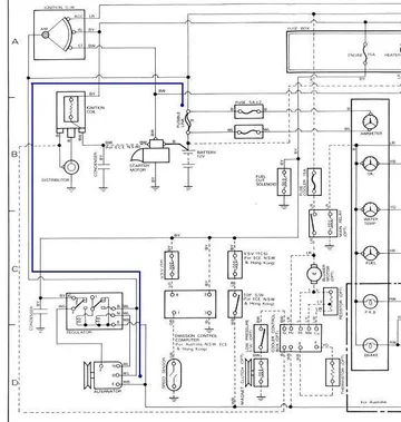

The WL (White/Light Blue) wire on the bottom side goes to the B lug on your alternator.
The other side is the fusible link and ends up at your battery + post.
See/follow the blue line in this pic.

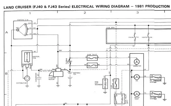

Just to be clear.
Something you did created a big short-circuit that blew your main fusible link when you reconnected the battery. So, as others have said, you MUST find that short-circuit and remedy it first. (Positively and not vaguely)
Blowing one of the little 5A ammeter-protection fuses was just an inevitable result of the blown fusible link. Because with a gap in the fusible link wire, all the current that was previously flowing through that link would have tried to flow through your ammeter (which is only rated to take milli-amps and so the fuse blew to protect it).
