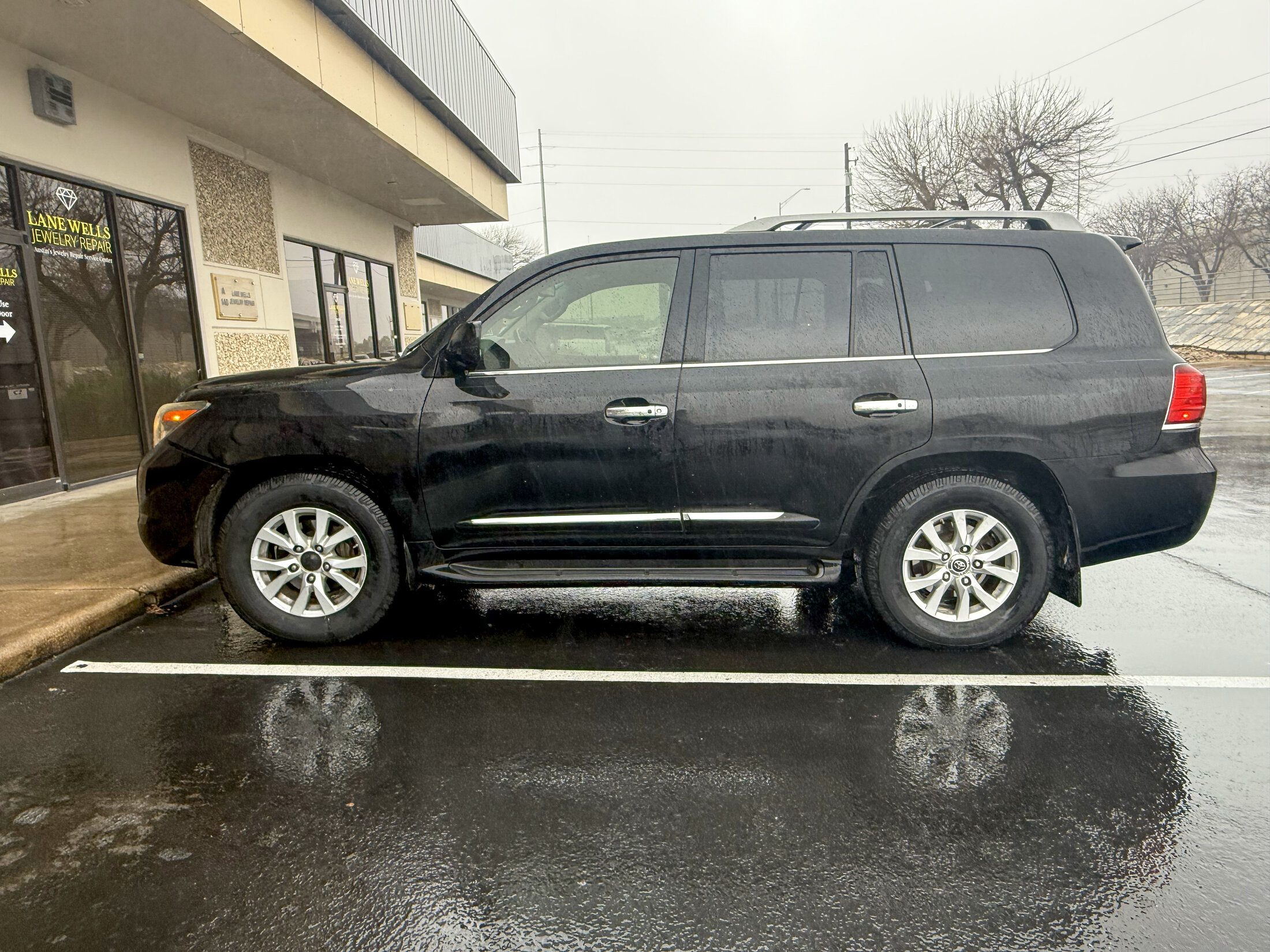

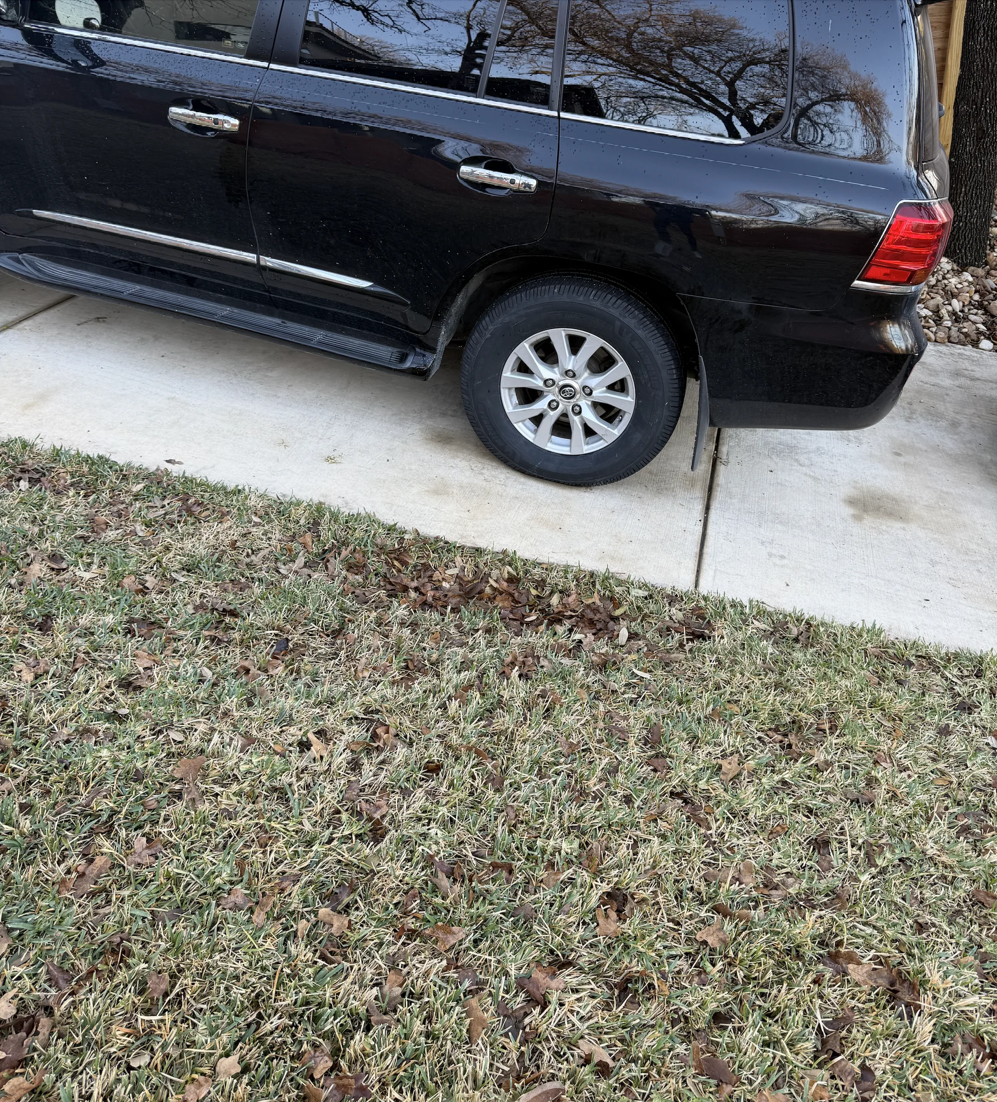

Is this really the largest tire i can fit on stock suspension? 285/65/18 Or does the LX have more clearance than the LC
Suspension has nothing to do with tire fitment, with exception of KDSS ram on Land Cruiser.
If you want to push fitment and keep a spare in stock location, 295/70-18 is your huckleberry
I'm running 35x12.5 on stock suspension, but a little plastic clearancing. The LX has lots of room for more tire.
