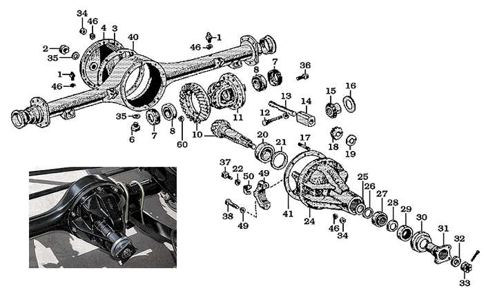

What I meant to say was the spacer is no longer need.
#14 on the picture below.
