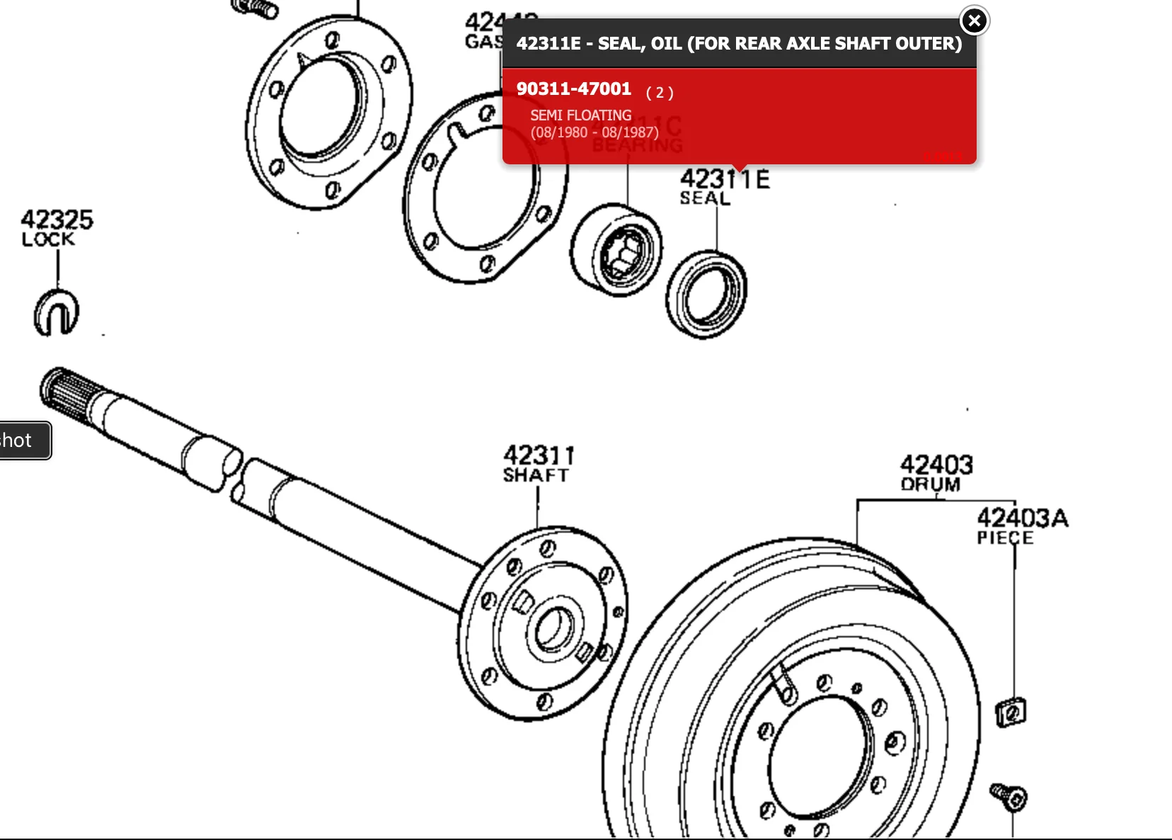

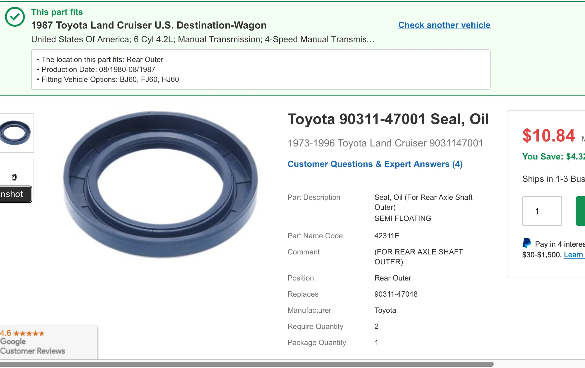

I don't think so.
According to these guys and the Toyota drawing, the correct part is:
Toyota 90311-47001 Seal, Oil
