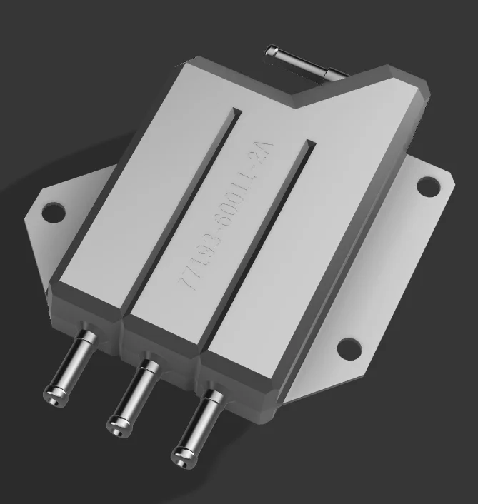

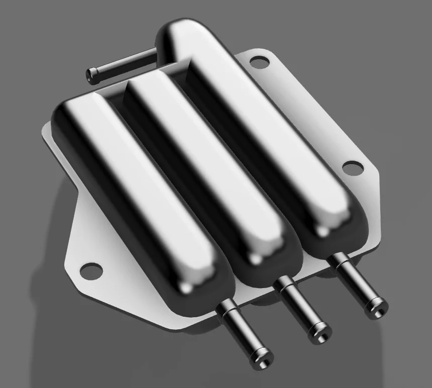

I have a few mockups I've put together in Fusion 360 so far, let me know if you dig it, and if so, if you like option A or B best!
Option A (faithful reproduction):
Option B (designed for easier 3D-printing):

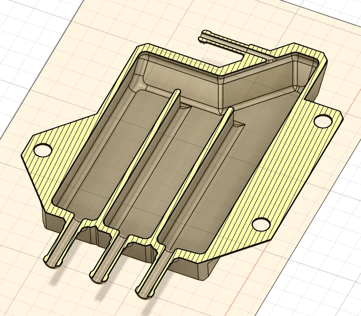

Here's an idea of what it looks like on the inside (the latter version):
I still have my OEM 72 unit. Gas/alcohol resistant/proof plastic printing a must. Plug and play for fit and function would be more important to me as neither is OEM. Both look nice to me - Cheaper is better, choice is always good too.

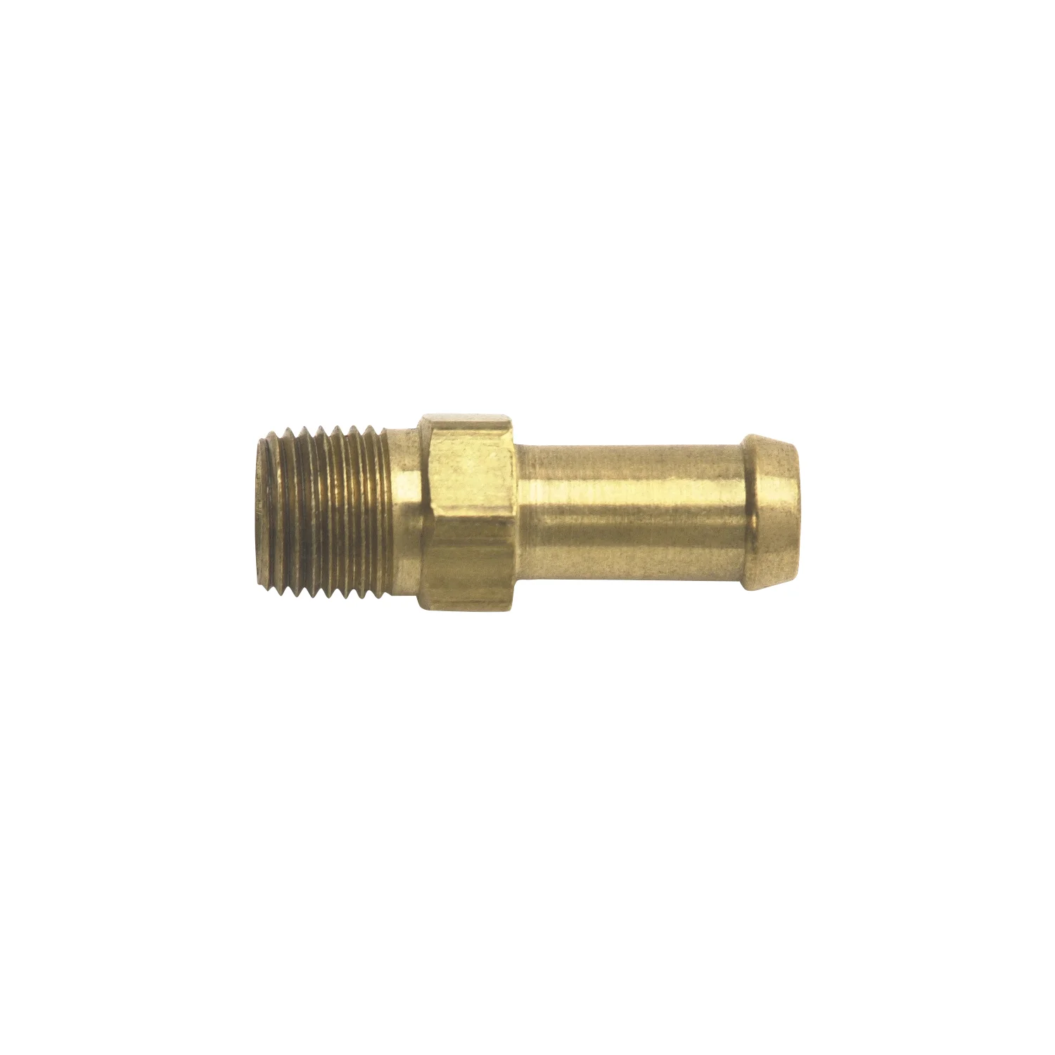

Going with a reputable source on these might price folks out is my guess, I'll look for some chinesium equivalents. Here's what I found at McMaster:

So it looks like 1/8" NPT (or 1/4" NPT) to 1/4" (1x, upper) and 5/16" (3x, lower) hose barbs will work to be compatible with the OEM part (6.3mm and 8mm diameter, respectively). Brass fittings are pretty easy to come by, but I'm hearing brass is no-bueno for fuel systems as it leeches zinc. Stainless steel seems to be the way to go. Been finding a lot of fittings in the $7-10 range that I think would fit the bill.
Looks like it would be about $40 in fittings alone, but it would be a pretty bomber setup.
To me having a thicker tapered base to screw into is the ticket to the superior design/build. Brass barb at Home Despot are like $5 each in the 1/4-1/4 size
My own experience I have used brass fitting for fuel systems with no issues, the amount of zinc or other material contained in a fitting is negligible compared to the amount of fuel in a tank. These parts will normally never see direct contact with gas anyway, and they're not under any type of real load, so I don't think it would be an issue to use cheap no-name fittings off amazon.
The reasoning behind making it compatible with standard NPT fittings is you don't have to provide the fittings, just the body. People can source their own fittings locally
That all makes sense. I could see this as "buy your own fittings" vs "include brass or SS fittings for $X or $Y". Thoughts on 1/8" NPT vs 1/4"?
