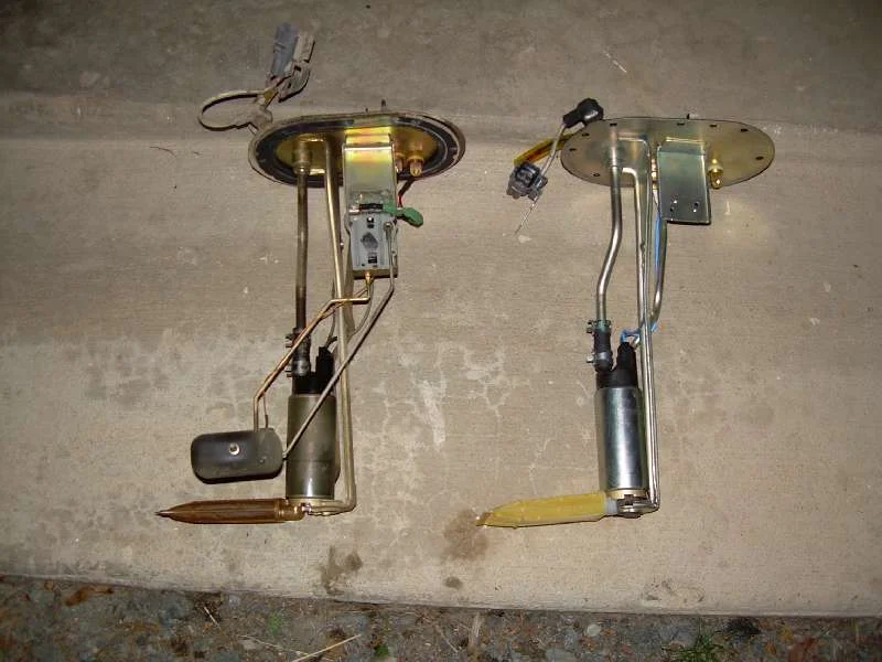

Recently i had been reading around to try and find some info on how long the fuel pumps in the 80's were expected to last. The only solid info i came across was something mentioning how it was a good idea to replace the pump maybe every 100k miles.
Well....needless to say the other day i got all the stuff ordered to swap out the pump seeing as i have several long distance trips coming up and my original pump is now at 268,000 miles:eek:

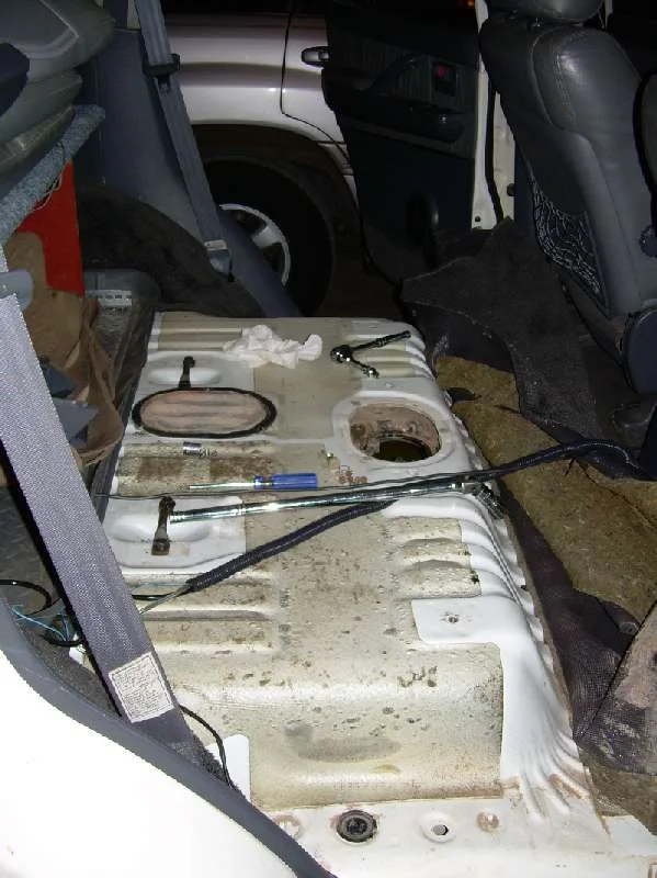

When ordering the pump i got all the necc. bits and also got the entire bracket so i could simply swap over the gauge parts from the old assembly. Right after i took these few shots i realized the nearly 12 yr old bolts were not budging and were only philips head so i didnt want to screw them up. I just swapped out the pump and prefilter and put it all back together.
Very easy and to no surprise, the truck drives and feels exactly the same. But its one more thing off the list.

Great PM Cruiserhead05! Thanks for the pictures. Post back with any mileage changes...
I realize the original pump was still in good working order but I've been stranded once with a PHH blowing in the middle of no where. I had to get a 100 miles tow to the closest Toyota dealership and have them fix it cause i didnt have the tools to do it on the side of the road.
Much like doug's ordeal, i figured it couldnt hurt and was something i would kick myslef in the but for, if it left me stranded.

For those of you who have full length drawer systems, this should be a good reminder to leave an access hole/port. Build your system with this access in mind! Otherwise, you'd have to take all of your crap out of the vehicle (like Doug's) in order to access the pump!
