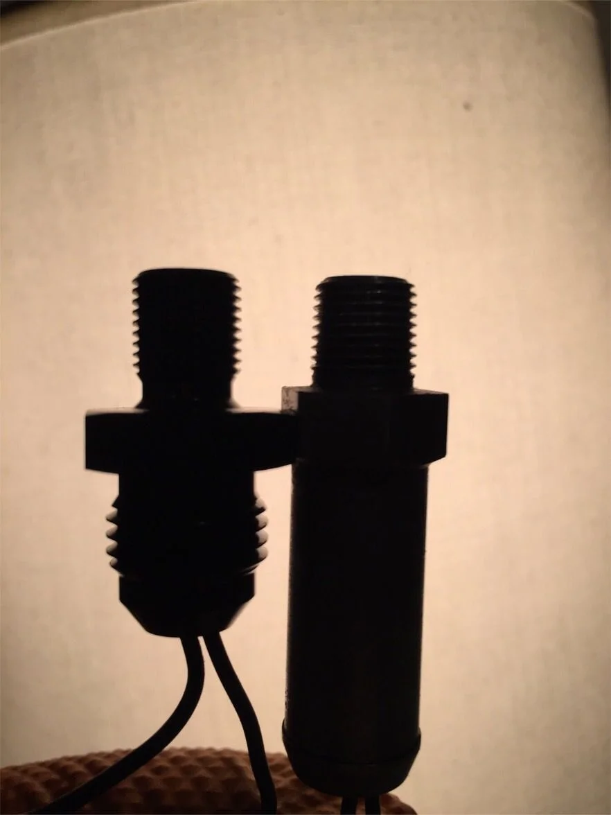

I just posted in your other thread, the fuel pump is 1/8 BSPT(british standard pipe tapered). Make sure you don’t buy bsp or bspp. A fitting described as bsp will most likely be parallel thread and if bspp is called out, it will definately be the incorrect parallel thread.
Left is 1/8 bspp or bsp
Right is what you need bspt.
The carb and sending units are also bspt. Don’t reef on the carb fitting I’ve seen those threads get buggered.
