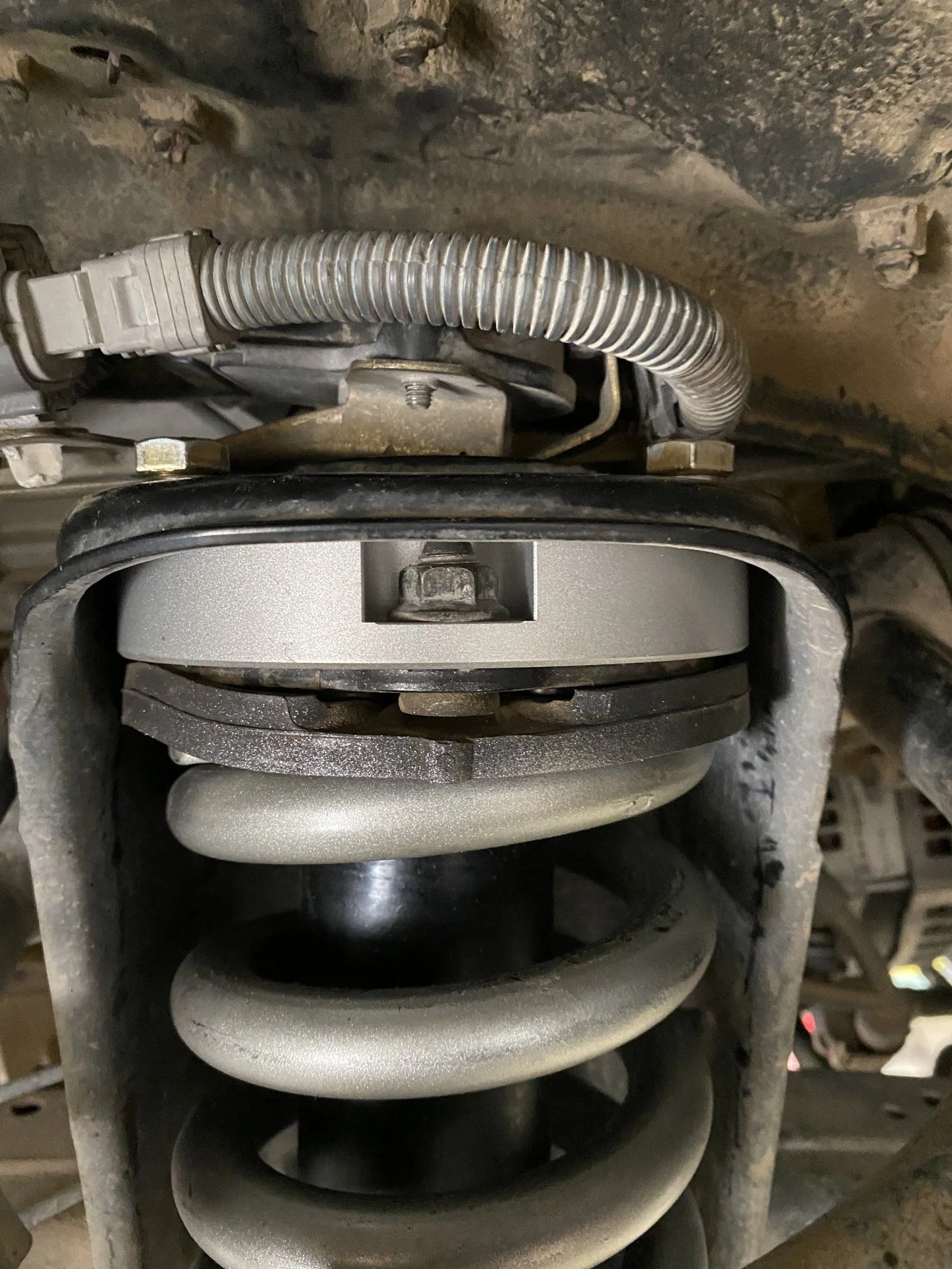

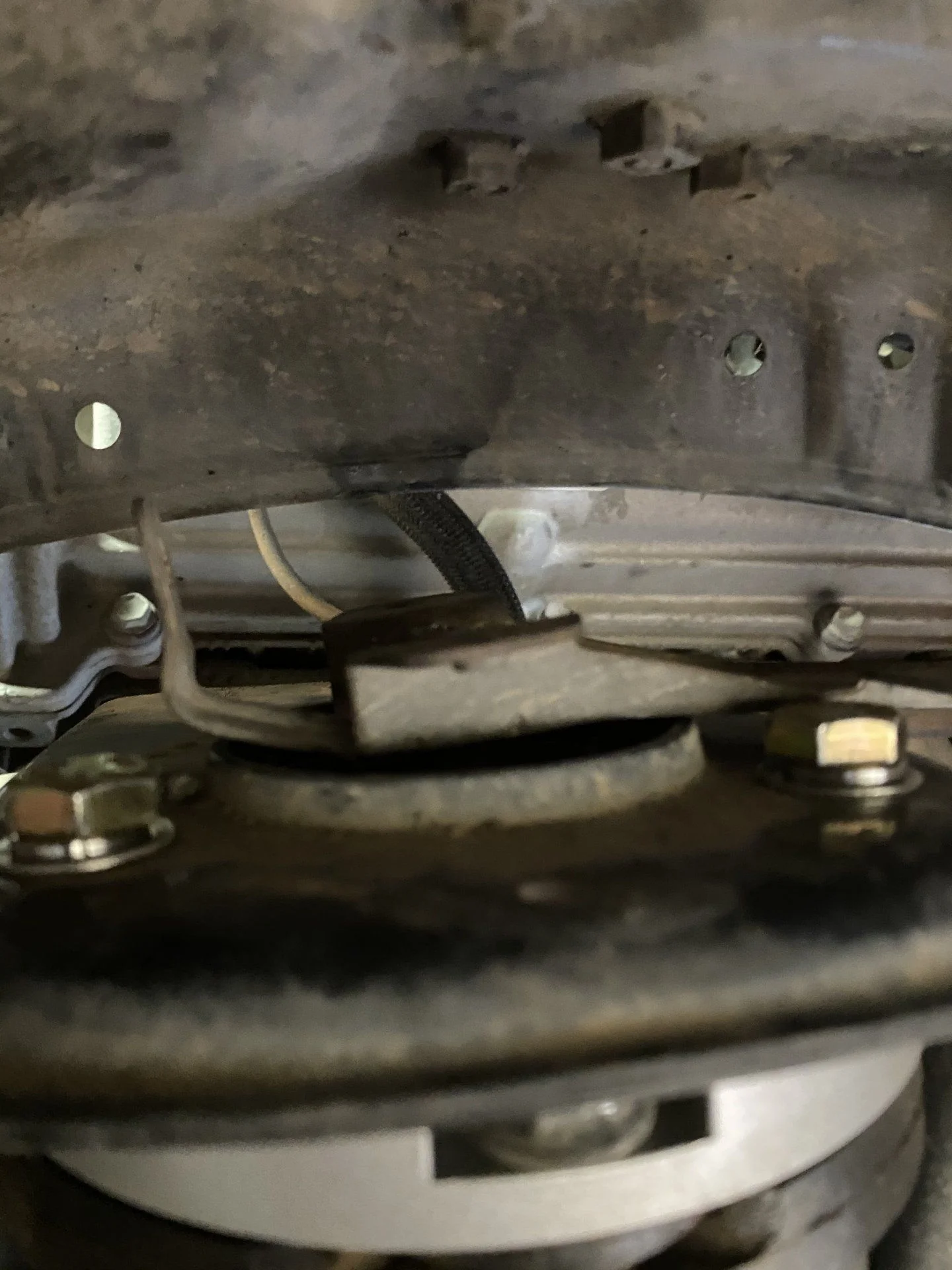

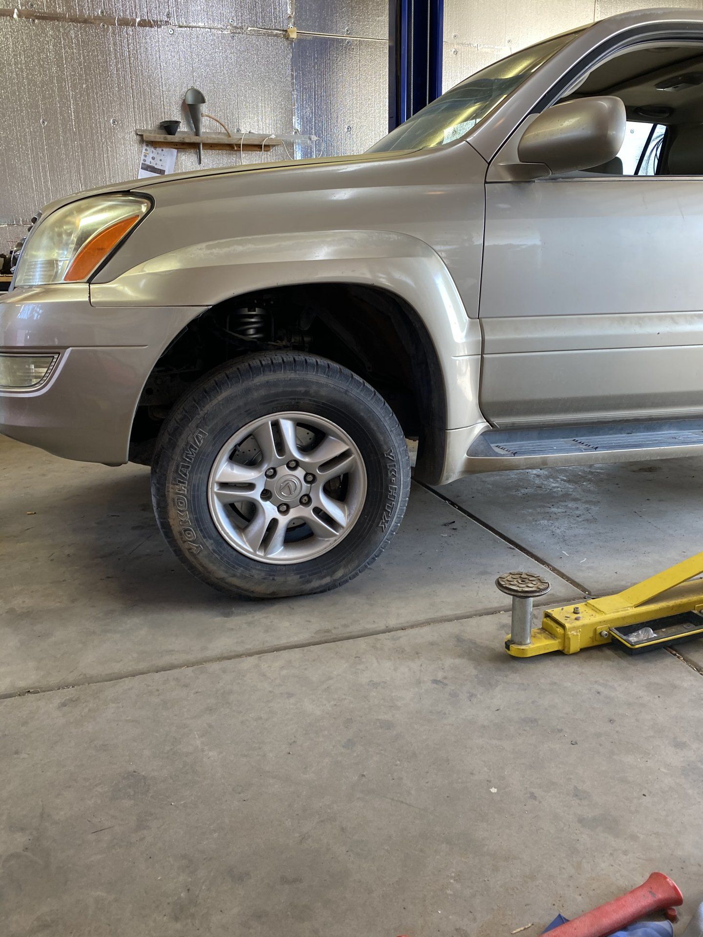

See here. This is before amd after my install of 0.75" Al spacer.
AVS actuator remounted fine.

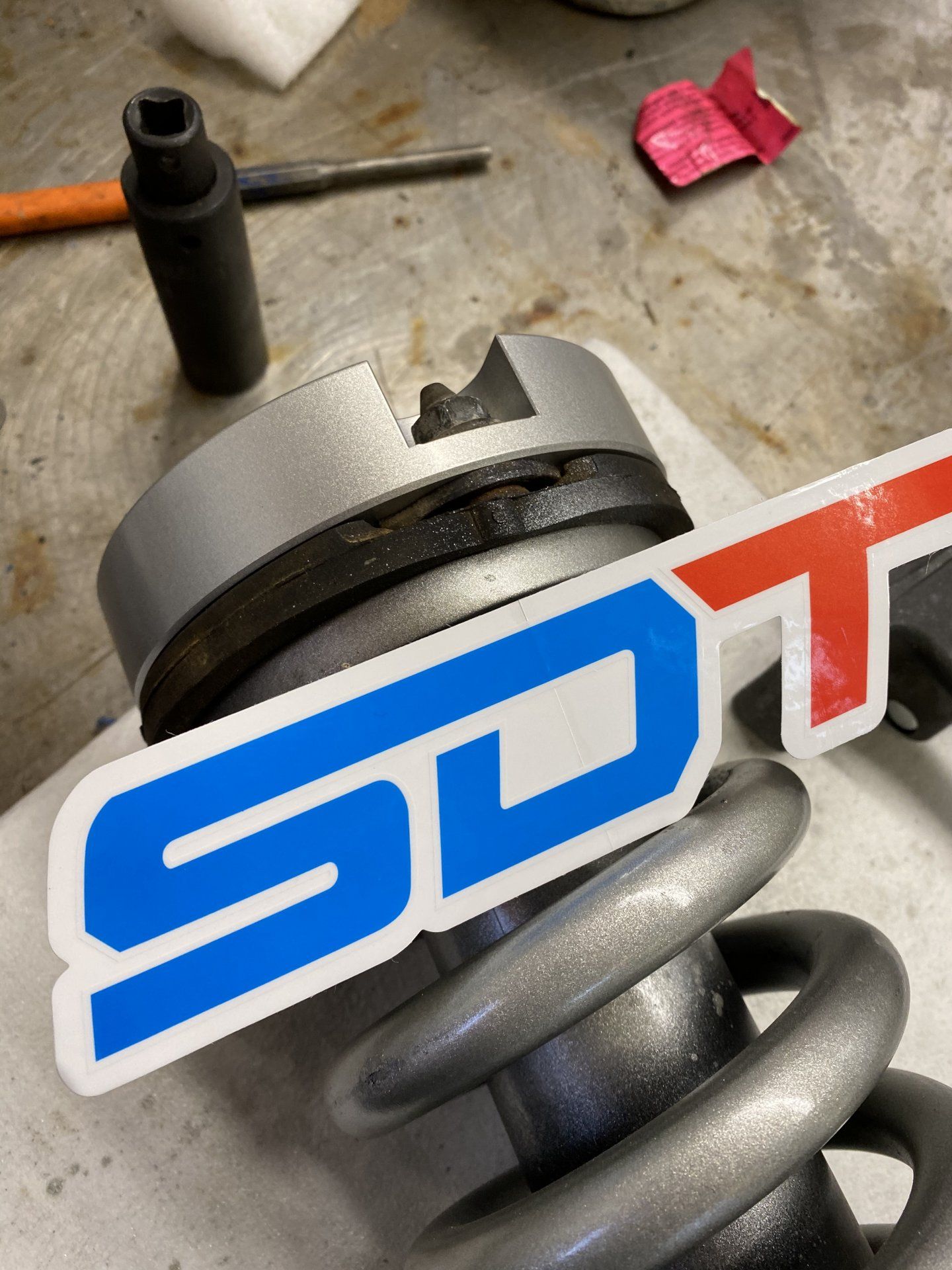

I have these same spacers. Ebay 1.5 inch lift, but made sure they were for a 4th gen 4runner and the ACTUAL thickness was .75 inches......but I also had to return my first spacers I ordered in error for a tacoma, oops. Hopefully soon my spacers will be coming out to install the Eibach front coil overs that just arrived in the mail.
It depends on the spacer. With a 1.5 inch spacer you can simply turn the bracket 180 degrees and it works fine. With a 2 inch spacer you have to trim the bracket so it will still fit. Either way, it's possible to use a spacer. I've done it, and I liked it a lot.
Spacers are totally fine for most people like me who don't do anything worse than dirt roads. A top mount spacer will not have any significant impact on your ride quality, so no worries.

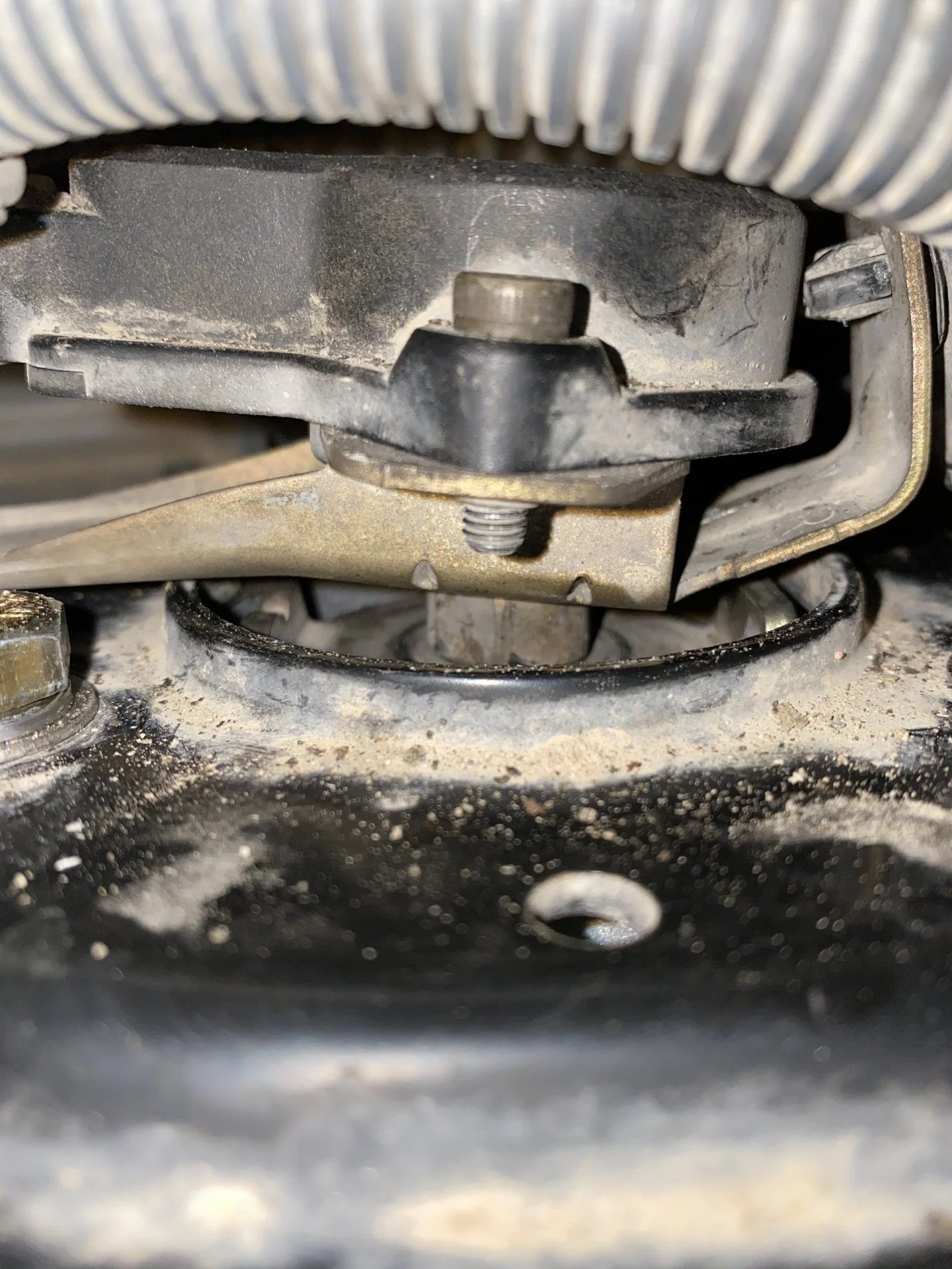

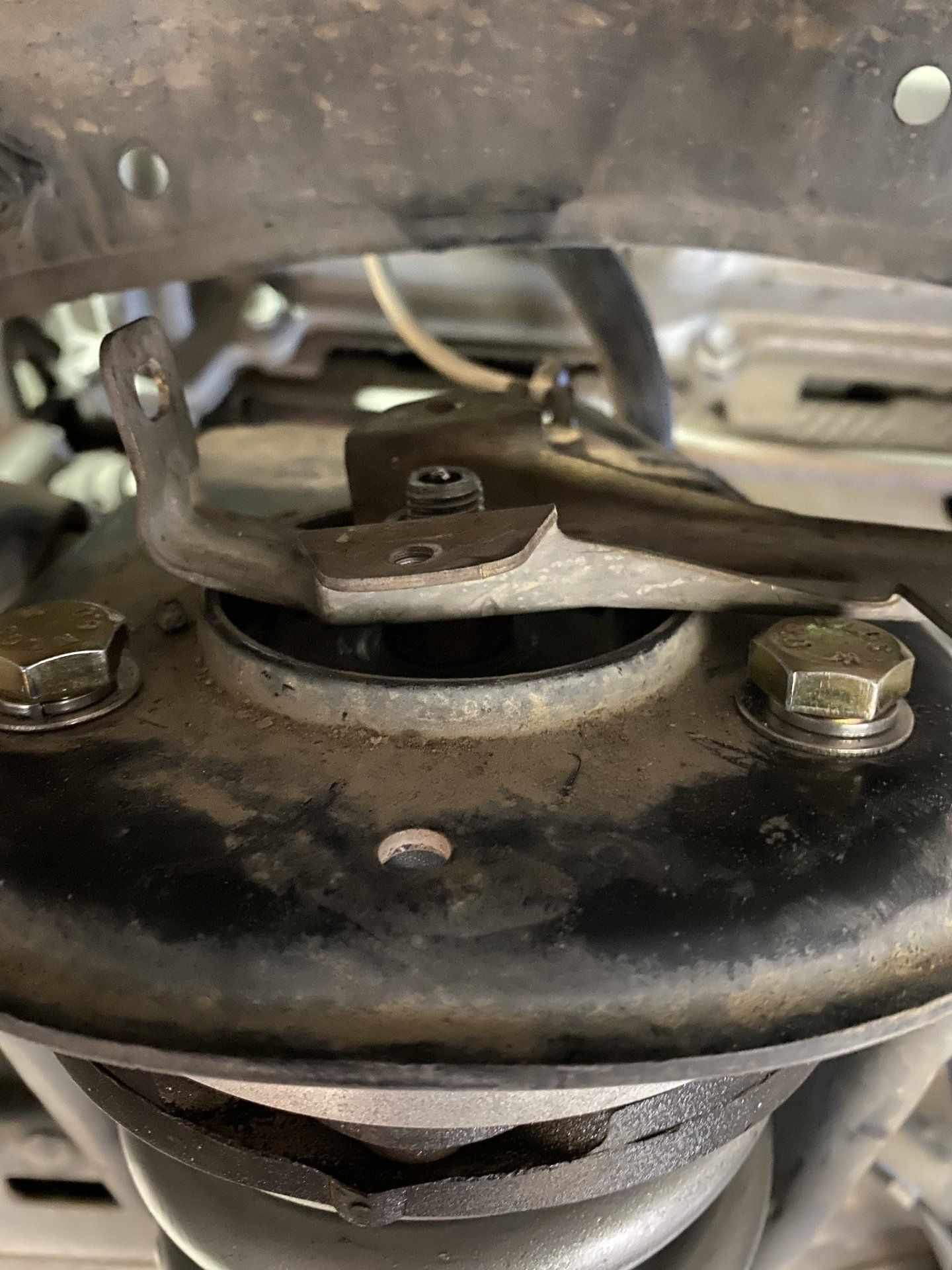

My tech said it was straight forward, plenty of room to remount the shock control module in situ. I had read that some people had to rotate the module 180 degrees (these were with bigger spacers), but that was not the case for me. Here are pix of stock and the spacer-installed each shows the shock dampening module mounted the same.

@DRANGED in your before and after pics it looks like you have the actuator bracket facing the same way. How did you make that work if so? I thought you had to spin it 180°. So that is what I did just because, not sure I tried it the original way. Also I could have looked at your pics wrong too 🤷‍♂️
I had also read that too, that it needs to be spun 180°, my wrench was able to install it the same way as original, I was surprised by that. I wonder if the taller spacers require the rotation. I think the post that indicated 100° rotation was a 1" spacer.
He said it went on just fine as is

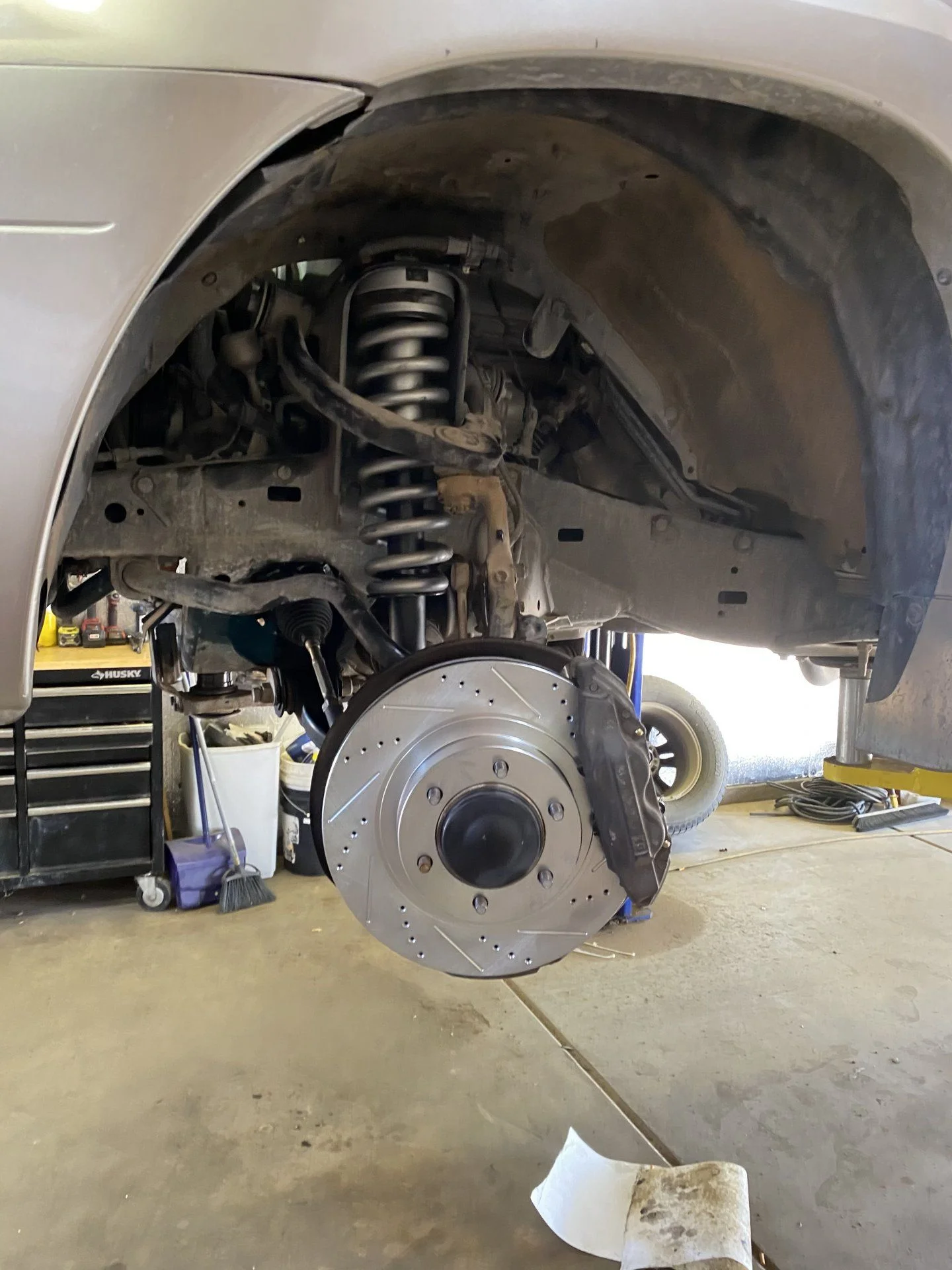

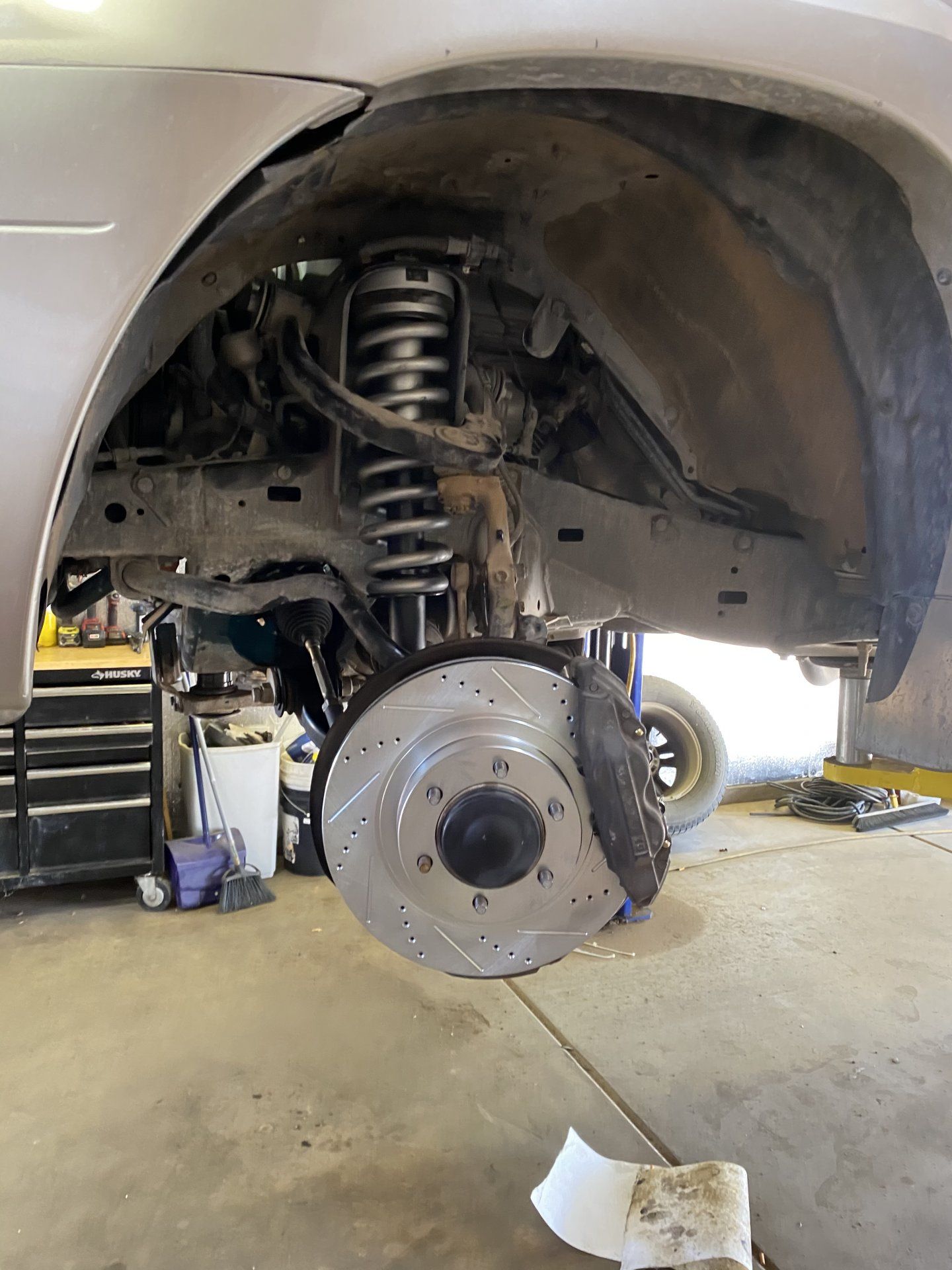

Here are some pics of the lift I installed this weekend
Is that new springs with the new shocks?
looks great!
My stock springs have certainly sagged and my one and a half inch lift is true, yours looks like a bit more than one and a half but I would suspect new springs are giving you that stance. 😈👍

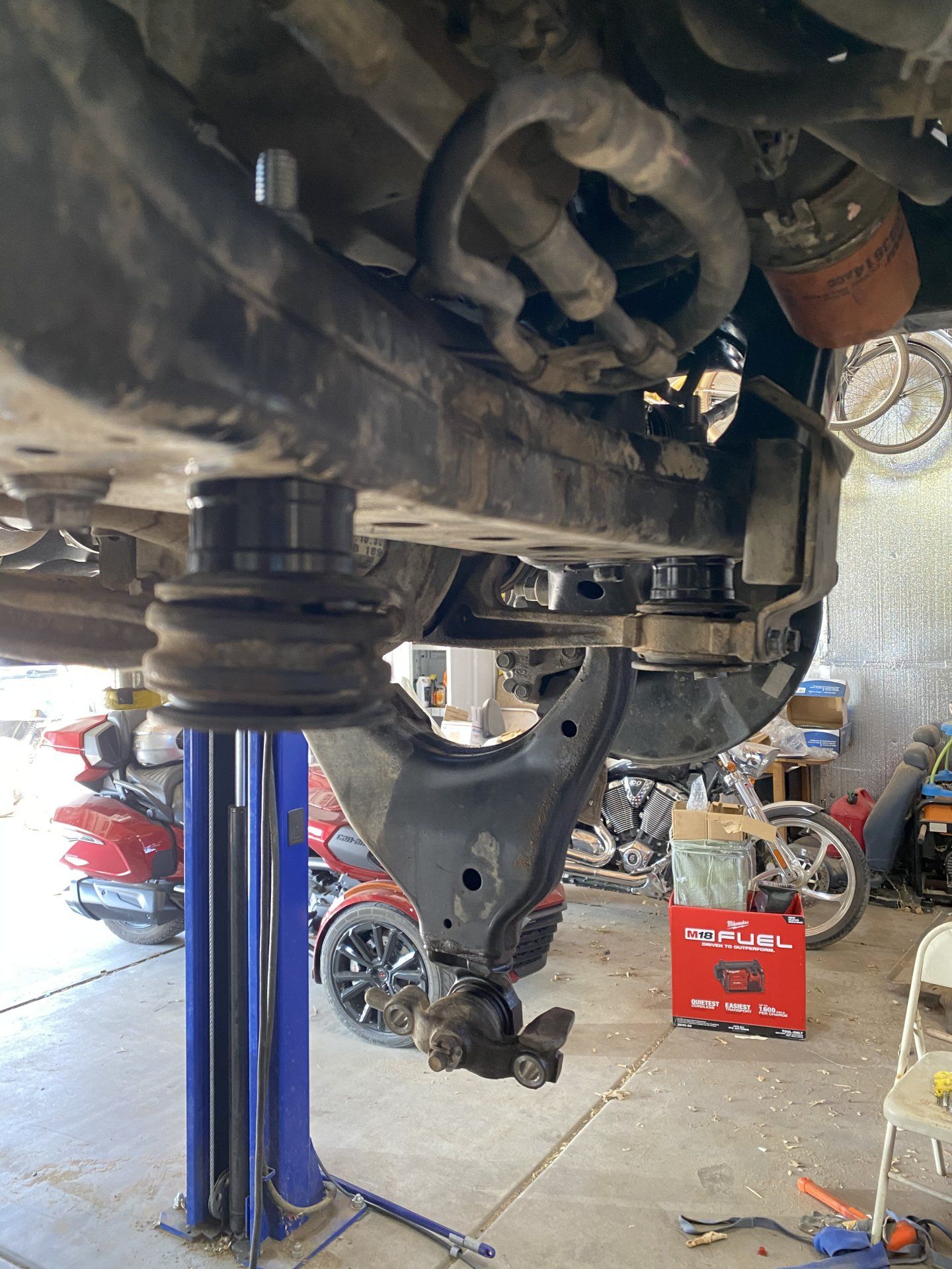

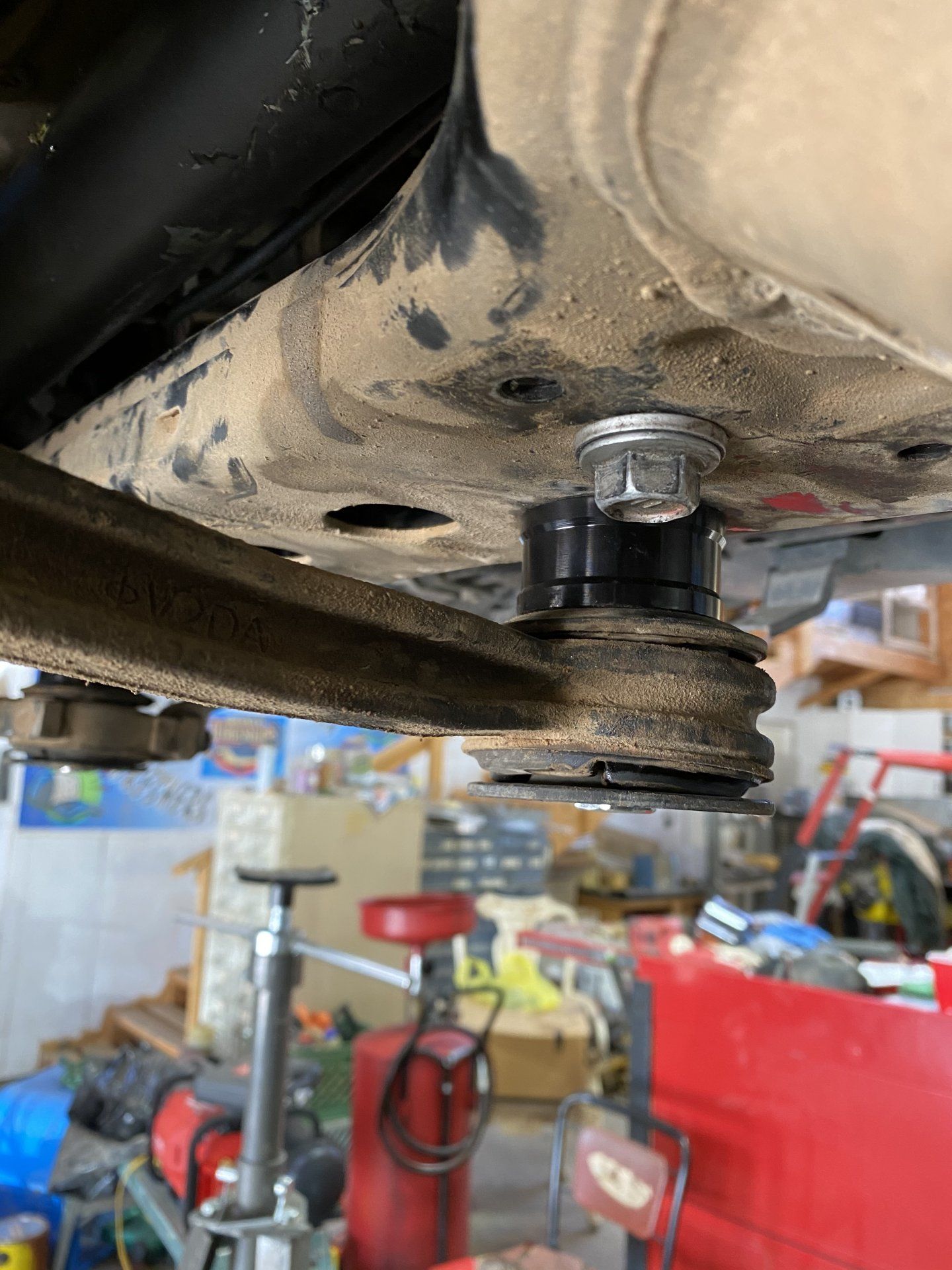

Based on others experience's, I would heavily reconsider the diff drop portion.
Those tend to be recommended over 3-in lift, and reliable word suggests more can of worms than gains....

The Drivers side bracket I had to grind and bend the long piece up to get it to seat on the shock nut, Ill take a pic of that tomorrow.
As far as the Power Stop rotors, I have only did a small drive as one of the splash guards is rubbing so I have to put it on the lift in the morning before I take her to the alignment rack.
I got the rotors and pads from amazon they are Detroit Axle.

Interesting on the diff drop, I saw a few videos and a couple posts about using them with 2" lift to retain the CV Axel angles.
those are the original springs I just painted them. The Spacer is only about 1" thick netting 2" at the spindle
I will take another pic when I get back from the alignment.
