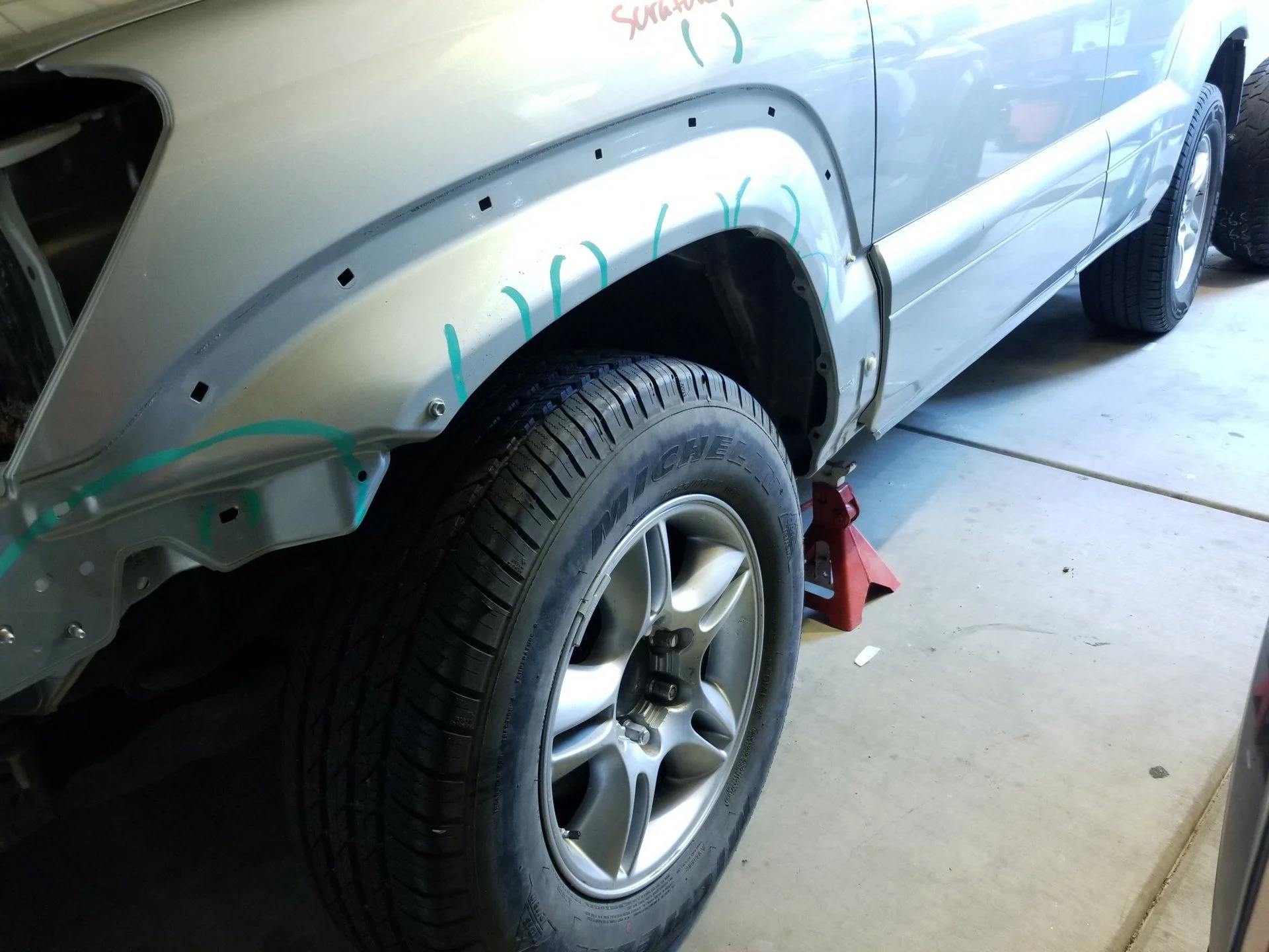

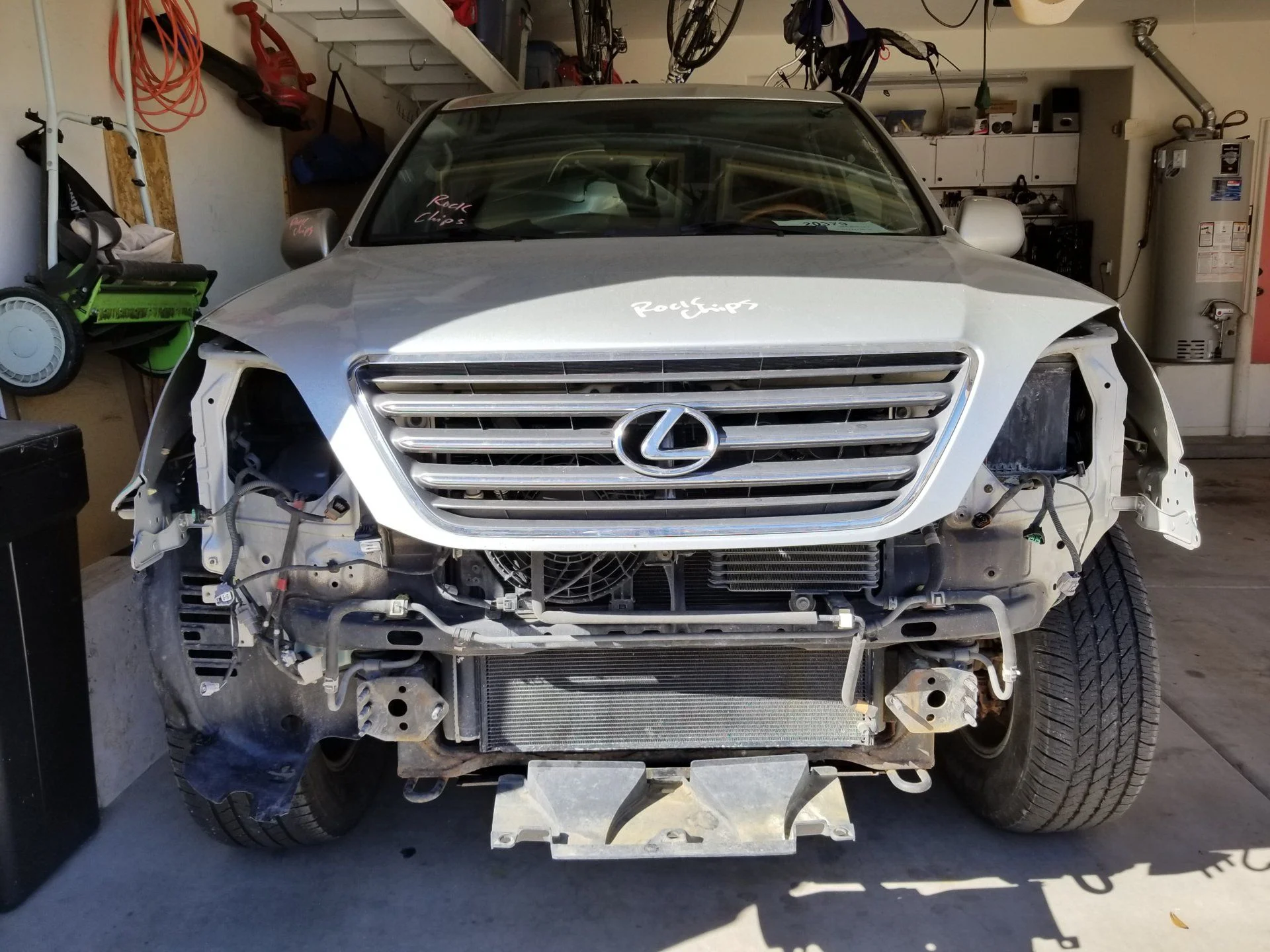

@DRANGED I finally bit the bullet and bought eBay special 1.5 inch leveling spacers for the front. I am peicing the GX back together after my accident. (insurance totalled it out, mechanic torn it down, I retained vehicle and am now peicing the body cladding, bumpers etc back on) An alignment may fix the 8nly toe-out issue that was caused in the steering, soi figured I'd reduce my alignment to 1, and put these spacers on first. I'll know better next week after arrival and install..... Fingers crossed it all goes well, in the mean time I have some serious access to knock down some surface rust with a wire brush and coat with some new black paint...
Holy fu!! Totaled out? Hell you could cough out for a real aftermarket lift..... but, I really think you lose some great GX awesomeness by fully committing (but that's just speaking from perspective of family rig that's capable needs)
Maybe a good time to peal off the fender flares @Vlad style. Go prado!
1 down 3 to go i guess.....
but really I wish I could pull the trigger on a nice aftermarket ARB bumper set. That's not going to happen yet for me. I'll put all the plastic back on minus the running boards which were also damaged and I wanted but I wanted to take off anyway, I hit chain link fence in the snow that had entry and exit wounds so both front bumper and back bumper was damaged. I think front bumper is beyond help, but the back bumper I'll be able to trim up and make do. I don't know where I'm going to find all the tiny little various-sized clips to put everything back together, Orwell find a donor bumper piece up front, a well-used one on eBay is $150, a new one is 300 or more. So I might be doing the used one, as there are very few if any GX models in a salvage yard anywhere close to me. I found the part I needed at a yard in California, call them, but they don't ship parts.... Here's my lovely front bumper as it looks now. But again I think an alignment will do it and I'll be back to running as it did before slightly different looks.
wow, Well I guess you could trim down the front bumper to the line below the vents at least, if ARB's (or other) not in the cards now. If back is jacked a bit too, trim it down for some AA and DA clearance @Bluetribal style (pre coastal bumper)
