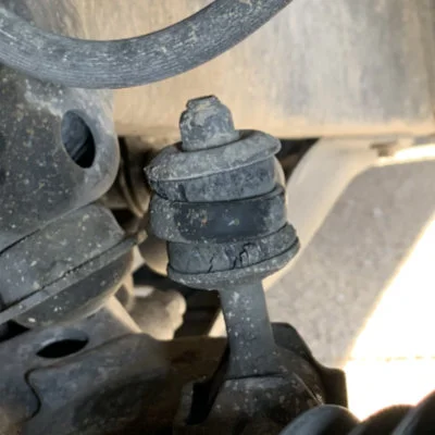

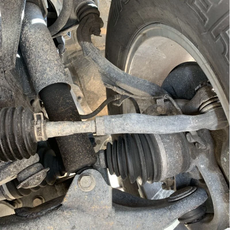

Hi All,
I'm sorting out my new-to-me 05 LX, and after doing all the normal preventative maintenance (all fluids, filters, brakes, belts, tees) I am wondering what if anything is needed related to the front suspension. I've driven it about 500 miles on and off road since I got it sorted out, and it is generally very smooth, responsive and well behaved.
I have on a couple occasions gotten a light pop from the front drivers side when going over a small speed bump slowly. I can replicate it by doing the pry bar under the elevated wheel check (again driver side only). If I think about it hard enough, this may have been after only driving in water and sitting. I get nothing of the kind off road, and it won't do it twice. For example, it pops on speed bump #1 or pry bar test # 1, but not if repeated. I feel no play (side to side, in/out or vertically) and I see no torn boots. Oddly, small bumps seem to upset the smooth ride more than larger ones.
Based on what I have read, I would guess the most likely candidate is an LBJ just starting to show its age, but I'm hoping someone more familiar with these trucks can offer some input from the attached photos?
Truck is all stock and has 135k street miles on it. Thoughts?

Yep, understood. I don't see any (upper or lower). I suppose they could be early stage as @2001LC shows?
Thanks for the input guys. I'll check the diff bushings tomorrow. If nothing else comes to light, I am assuming a pair of 555s for both lowers is the recommended course of action?
@vman07 - you were on the money. Thanks for the pointer, I would have never suspected. The driver's side front diff bush is toast, and the front lower is bad enough I am just going to replace all three. Let's hope this fixes it, or I will be back for ball joints.
